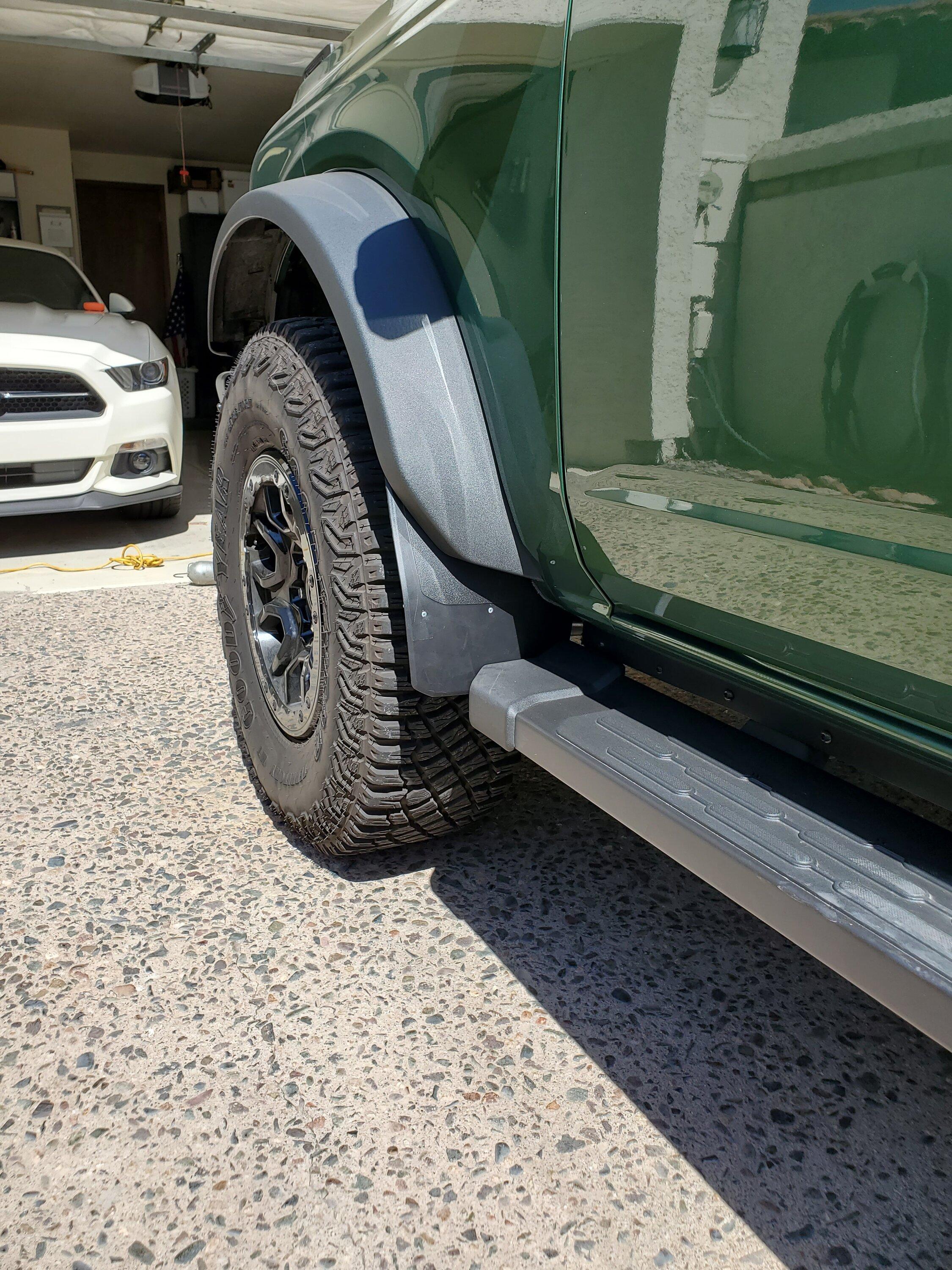

Fronts only. Going to add rears.Not in a hurry for them.

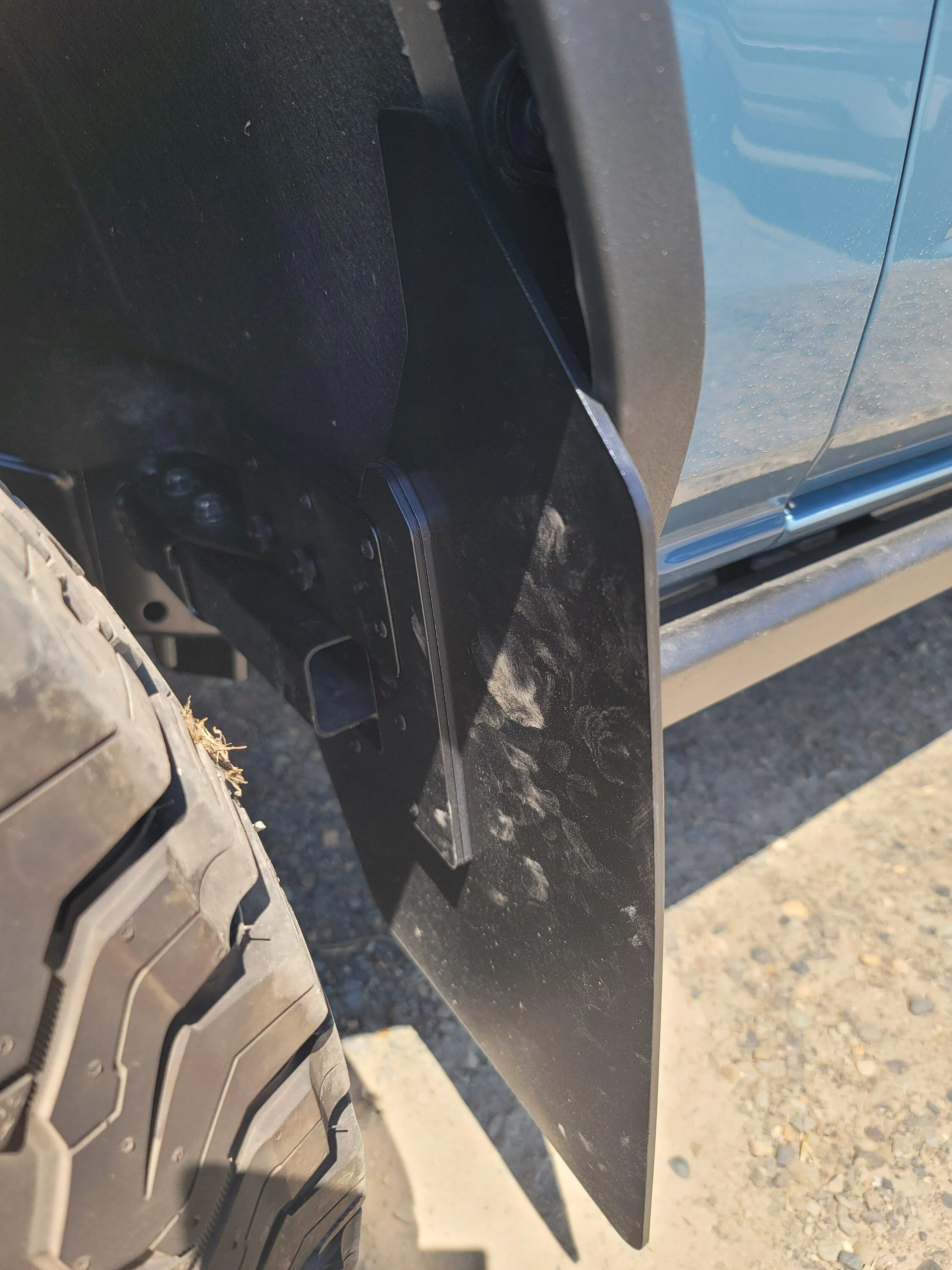

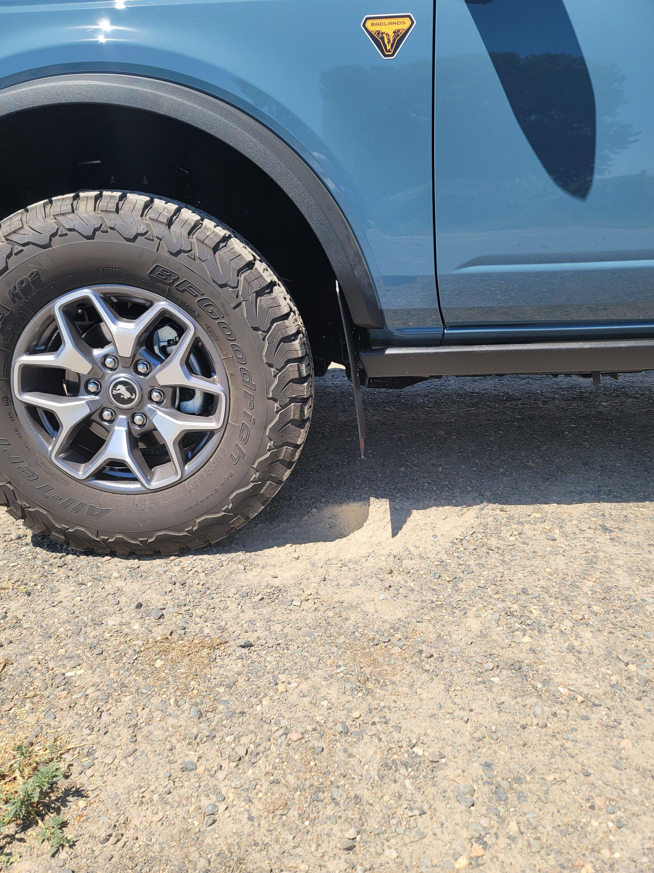

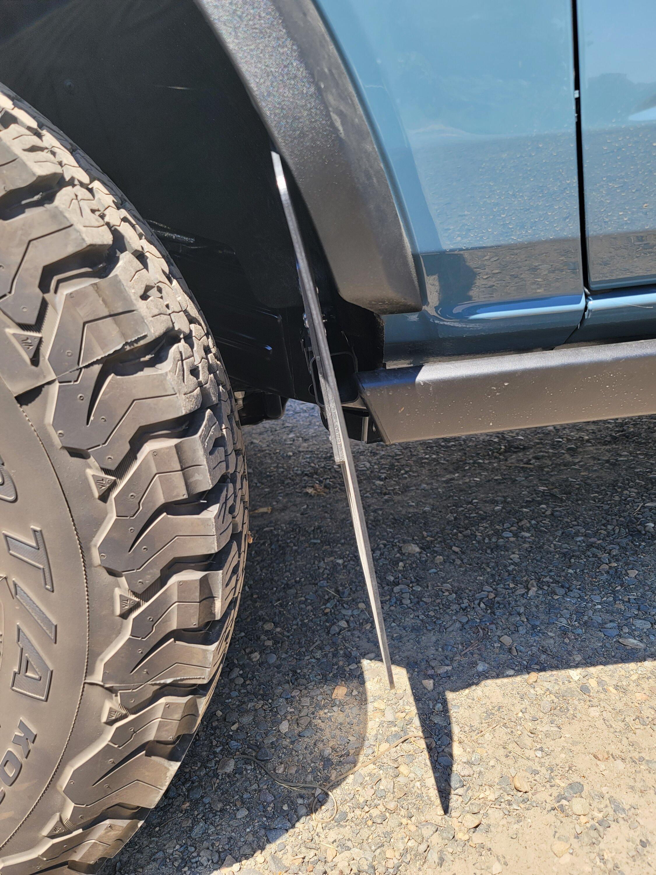

I hope you like the RokBlokz! I just installed mine this past weekend...we'll see how they hold up. I initially installed all four flaps to the letter of the instructions, but the next day, I decided to experiment with the front ones, swapping the brackets from side to side. Doing this actually seemed to improve the stability of the flaps for me, as well as reducing the "buzz factor" where the upper edge of the flap rests against the fender flare. Plus, this swap repositioned the front flaps more perpendicular or "square" to the body surface of the vehicle than they were initially. I have the smaller tires of the standard Badlands, and even with the brackets reversed the whole flap assembly is at least flush with the crash bars, so I have no interference issues.
Ford Bronco Mud Flaps -- install all 4 or just the fronts? 1660131398867
Is the closeup pic after the bracket switch? Looks good šŸ‘

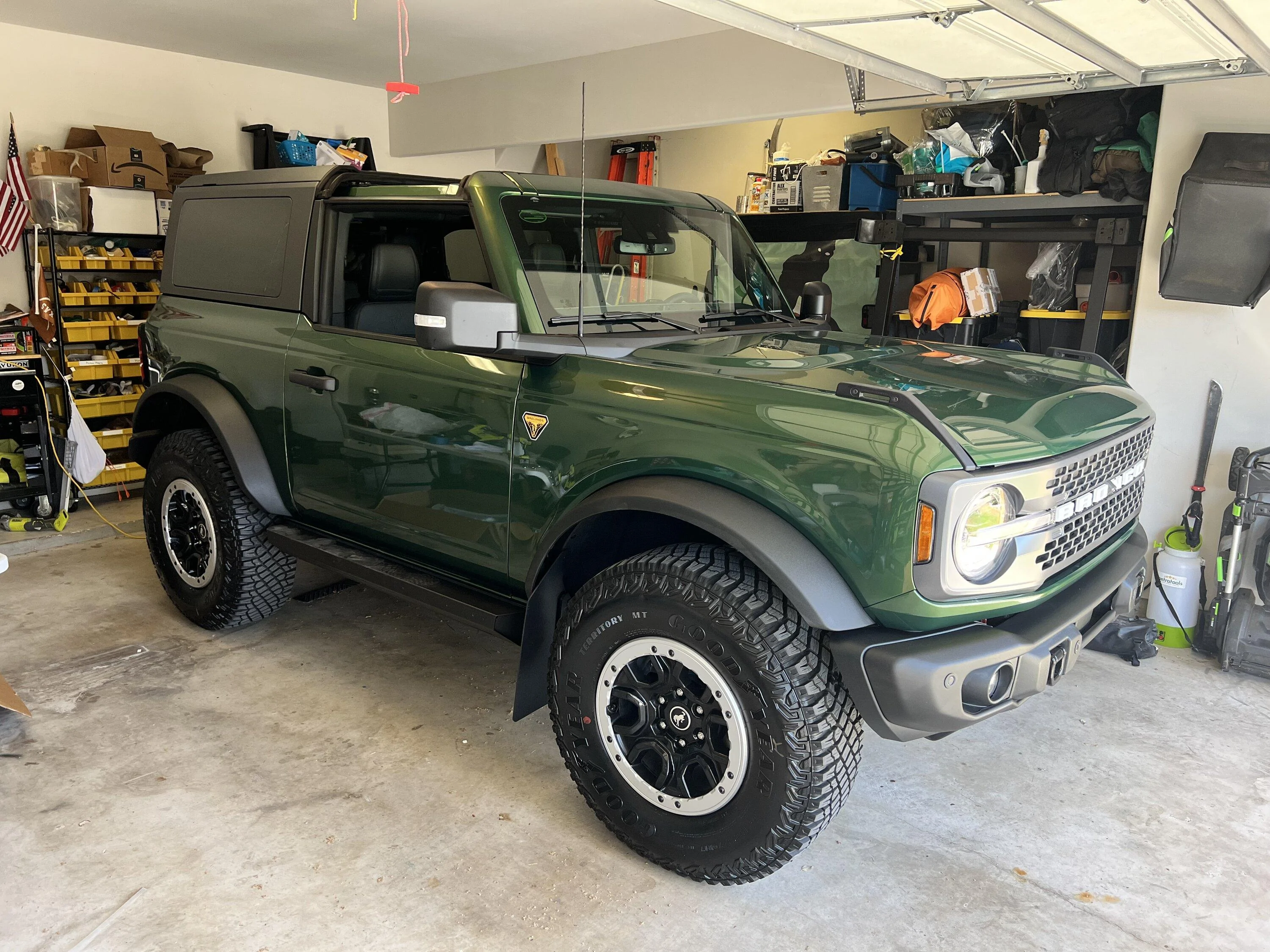

Ford Bronco Mud Flaps -- install all 4 or just the fronts? IMG_2838

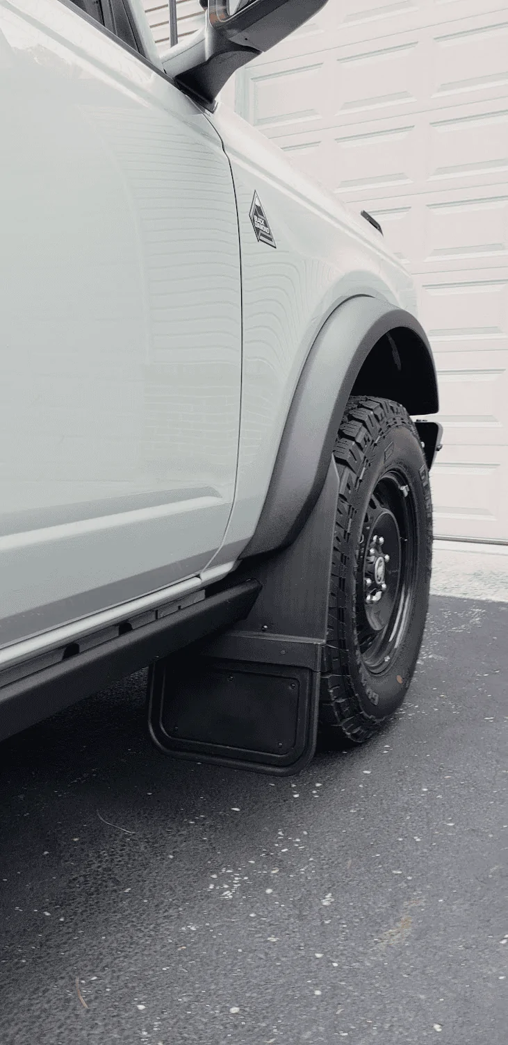

Front only, rokblox

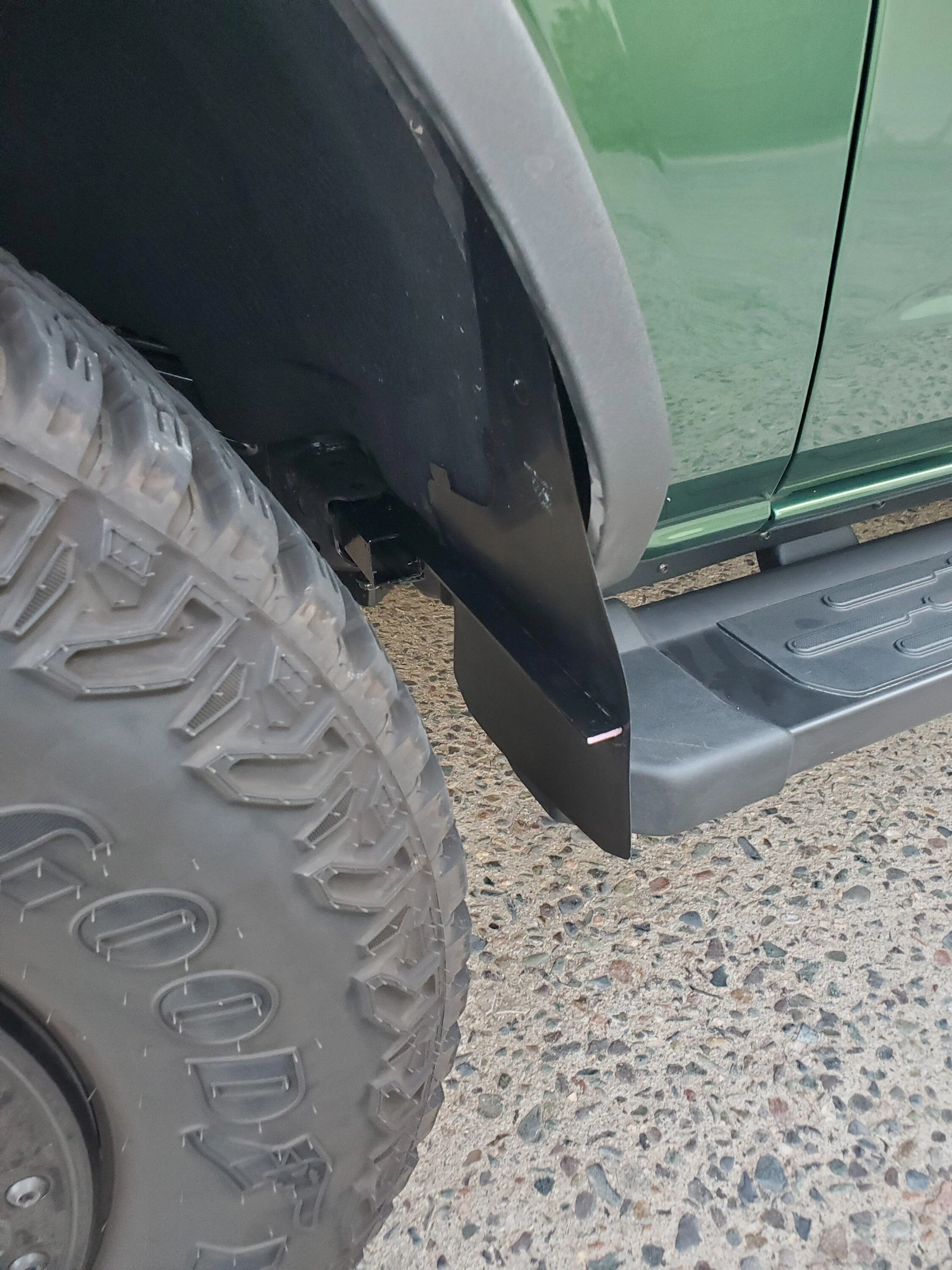

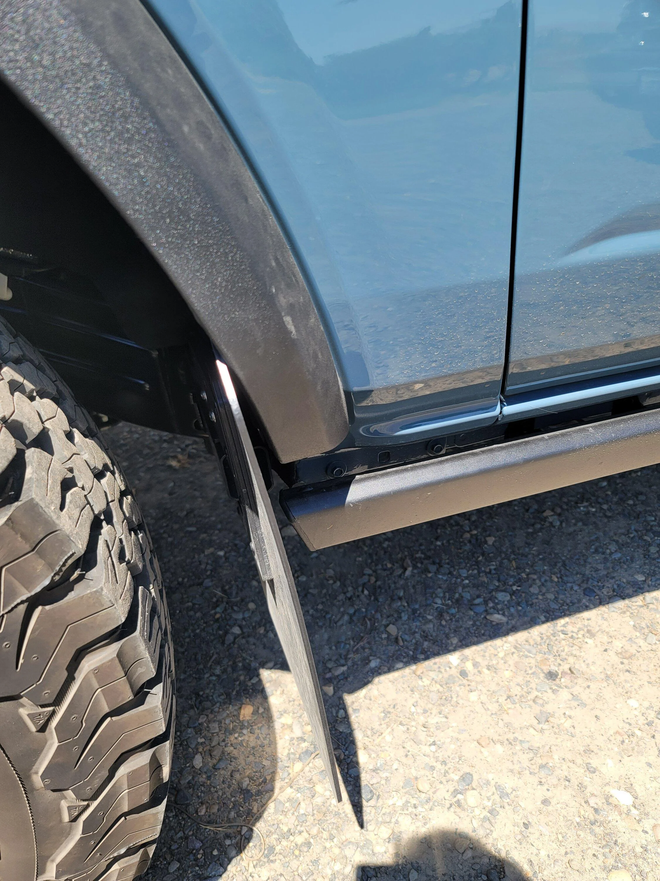

Indeed it is a closeup of the "after bracket switch". And here is an image of the same flap before...
Ford Bronco Mud Flaps -- install all 4 or just the fronts? 20220806_132256
At first glance, there appears to be little difference. However, RokBlokz instructs you to place the whole assembly against the fender liner. In my case, this made the flap(s) rest in a somewhat twisted position so that the inner flap surface was not parallel to the tires tread surface, or - for that matter - the crash bar. The brackets have slotted holes allowing some fore and after adjustment with regard to the crash bar mounting bolts, but I decided to just swap and reverse the orientation of the brackets, then move them rearward to the degree allowed by the slotted holes and flush with the leading edge of the crash bar. So now, after swapping things, the mud flaps are essentially parallel with both the tire tread surface and also the crash bars.
The main advantage for me, beyond the slight cosmetic advantage, was affecting the area where the flap contacts the fender flare so as to reduce vibration potential.

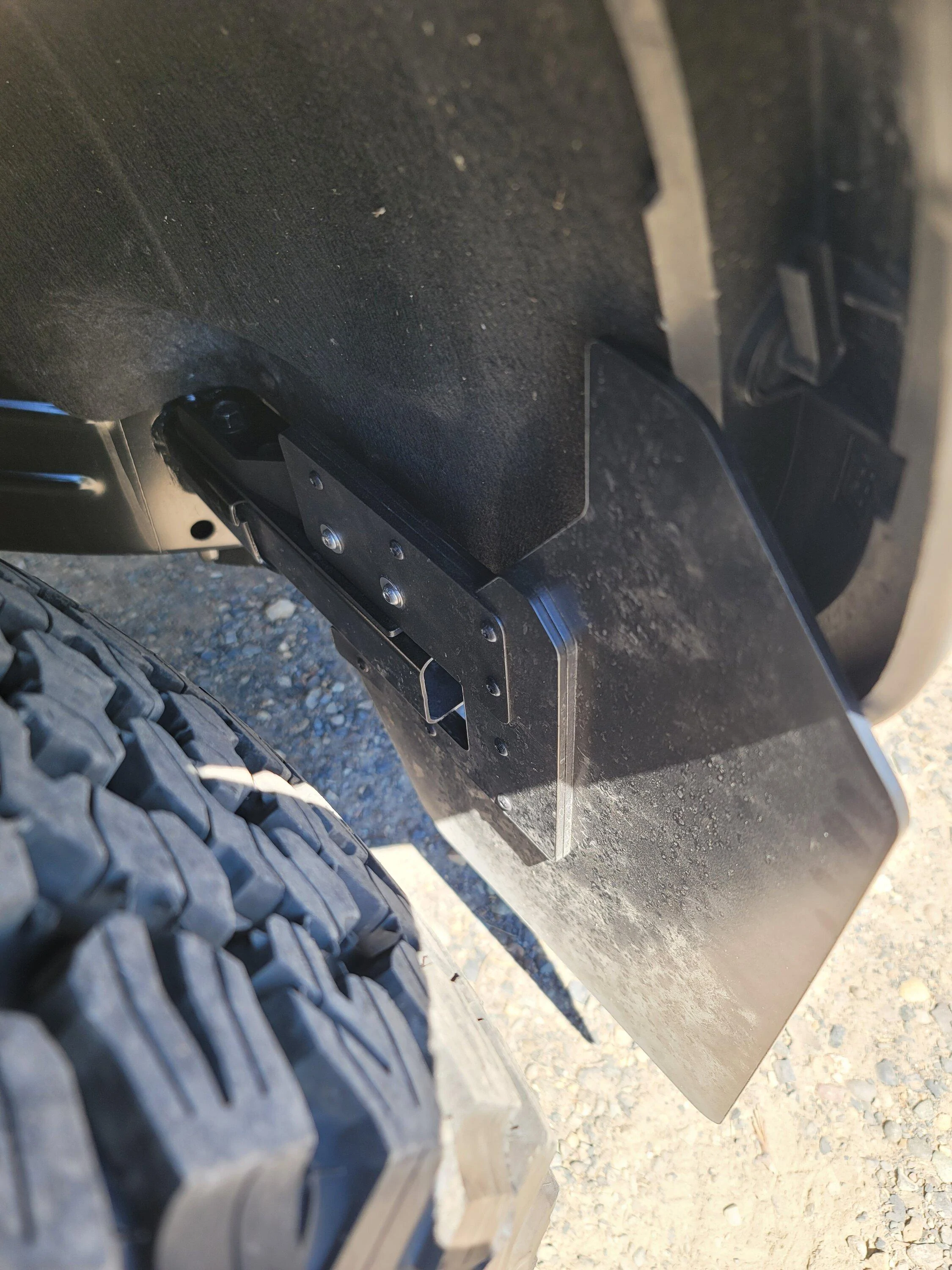

Here are before and after views of the bracket placement. In the top (before) image, the flap contacts both the inner and outer edges of the flare, which lead to a vibration issue. Reversing the orientation of the brackets rotated the flap just enough to avoid contact with the inner edge of the flare.
Ford Bronco Mud Flaps -- install all 4 or just the fronts? 20220806_131958
Ford Bronco Mud Flaps -- install all 4 or just the fronts? 20220807_130454
Ford Bronco Mud Flaps -- install all 4 or just the fronts? 20220807_130521

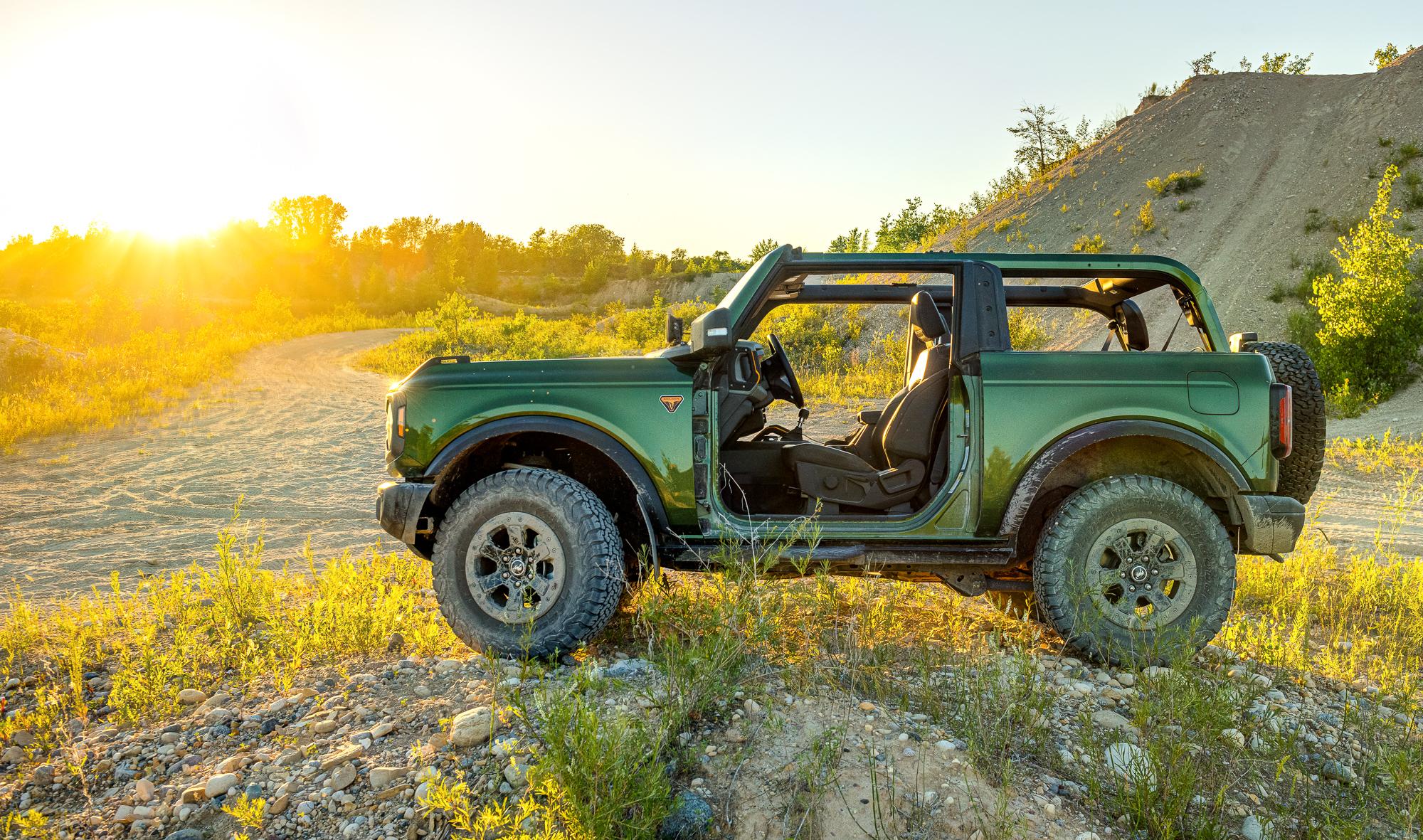

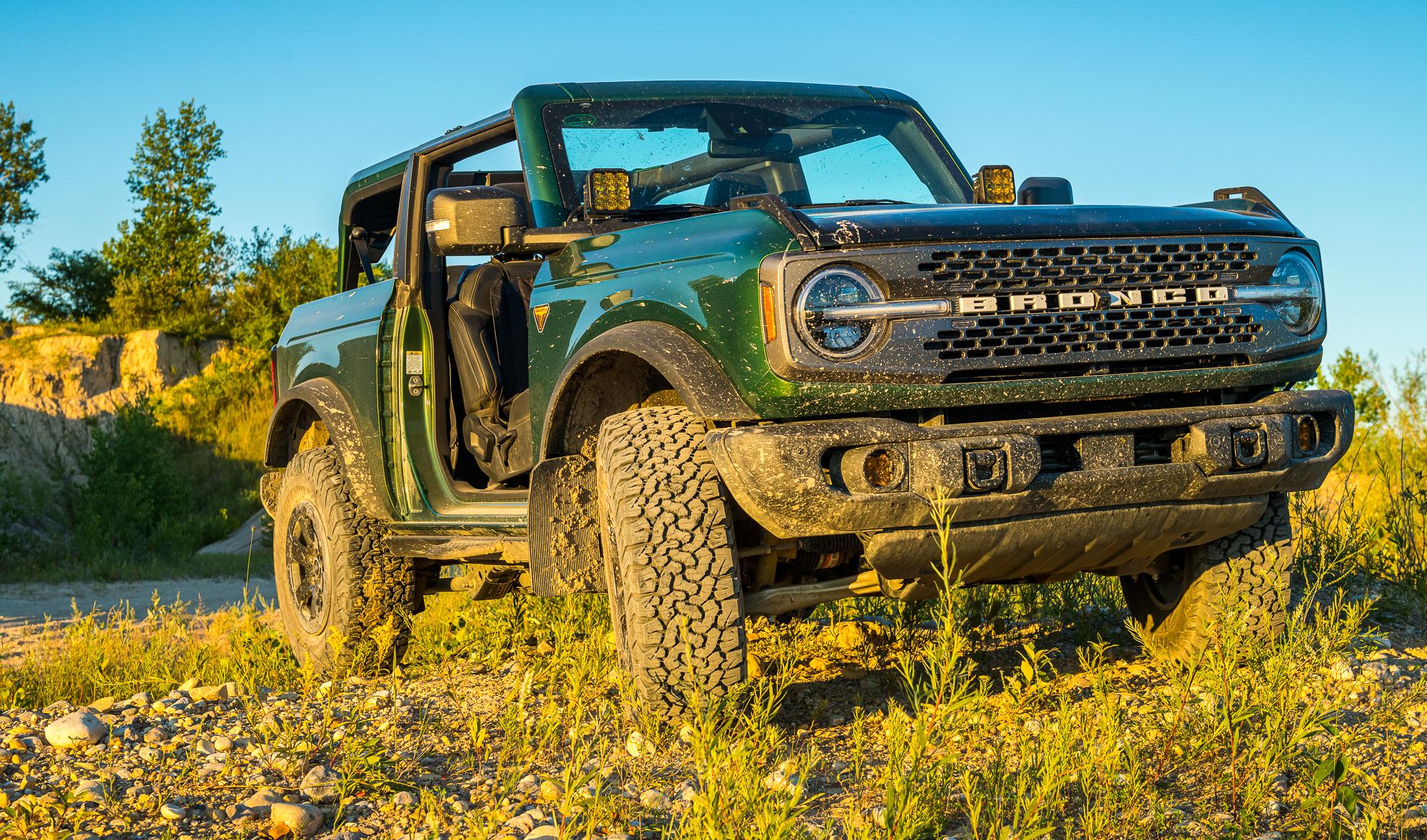

Rekgen Trophy Flaps, Front Only! I was hoping to reduce the door dingers on gravel roads and it did exactly that! About 98% less rock impacts ~ give or take. Still some mud up wash, but Itā€™s meant to get dirty
Ford Bronco Mud Flaps -- install all 4 or just the fronts? FF5B237B-62AA-4370-8DF6-7BB3AD43CBA0
Ford Bronco Mud Flaps -- install all 4 or just the fronts? BA363EF2-31D5-48B8-89C8-54A9C676B161
Ford Bronco Mud Flaps -- install all 4 or just the fronts? DF59DFBD-A874-42EE-8D44-E324024B9FA6

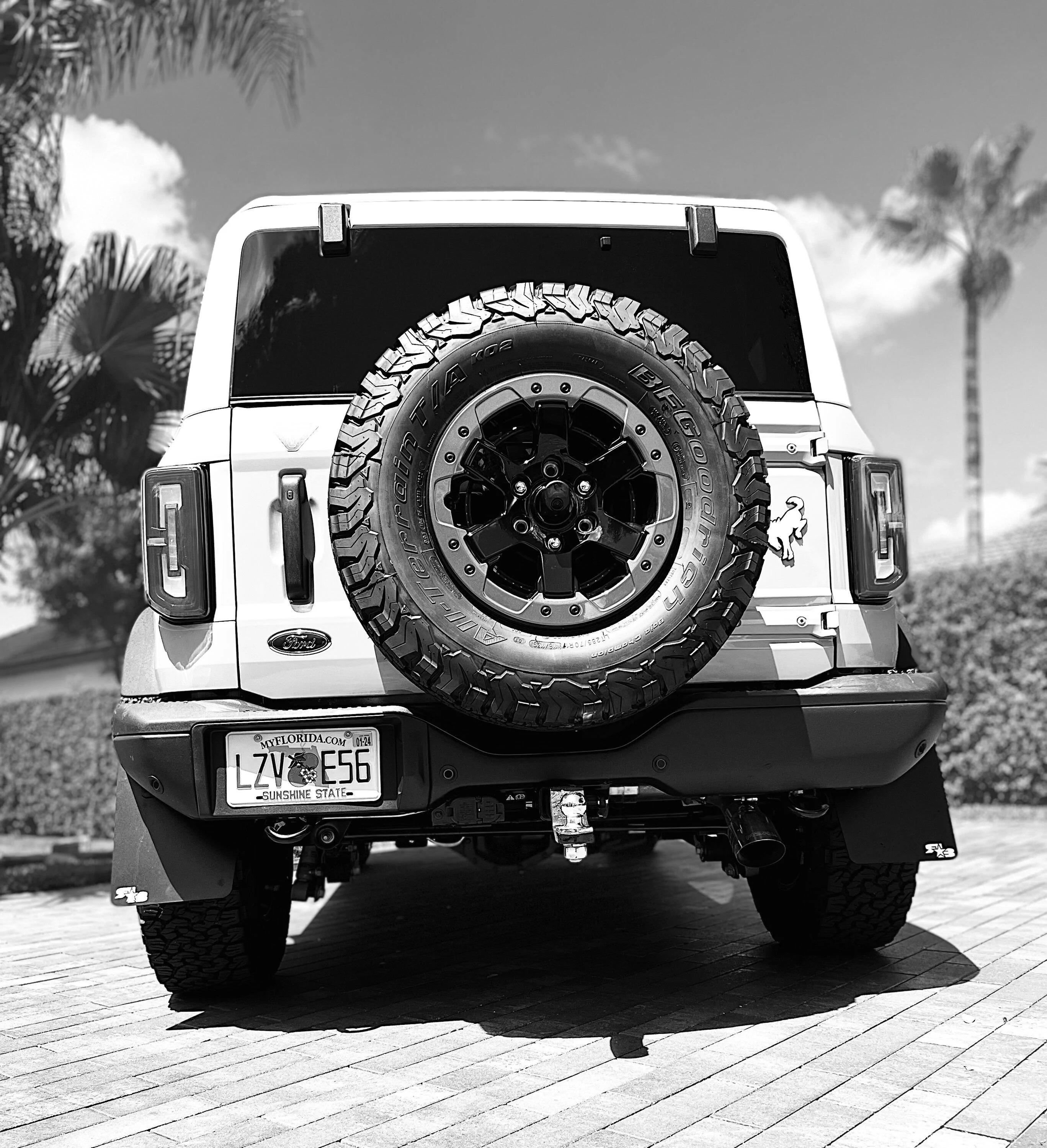

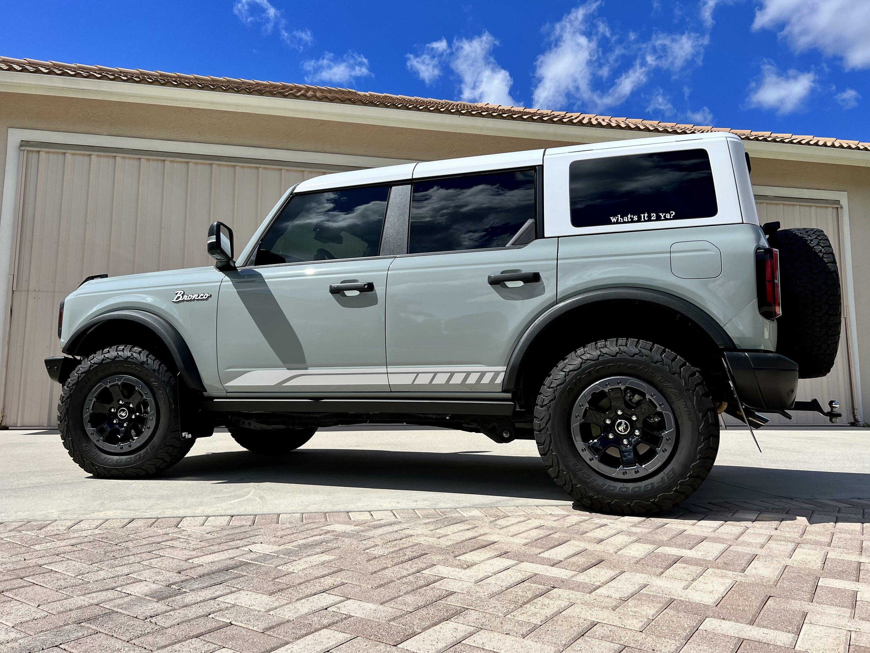

Ford Bronco Mud Flaps -- install all 4 or just the fronts? 5471ECDF-D16E-4D47-8426-C9EF80493862
Ford Bronco Mud Flaps -- install all 4 or just the fronts? B448EFB0-AF8C-4F58-9402-15F710BE53FE

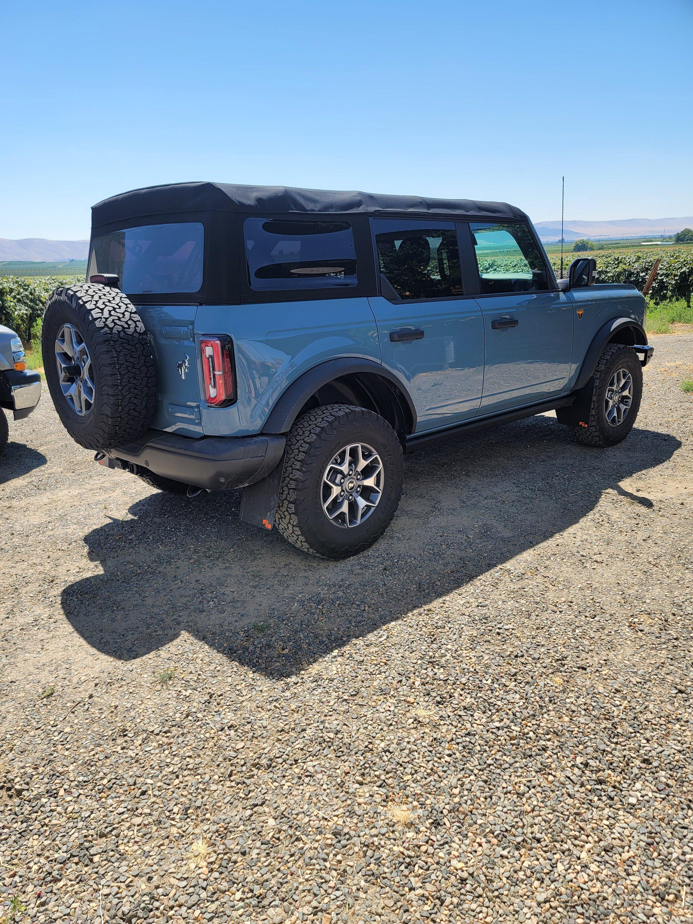

all four installed. Happy with results. Daily driver
