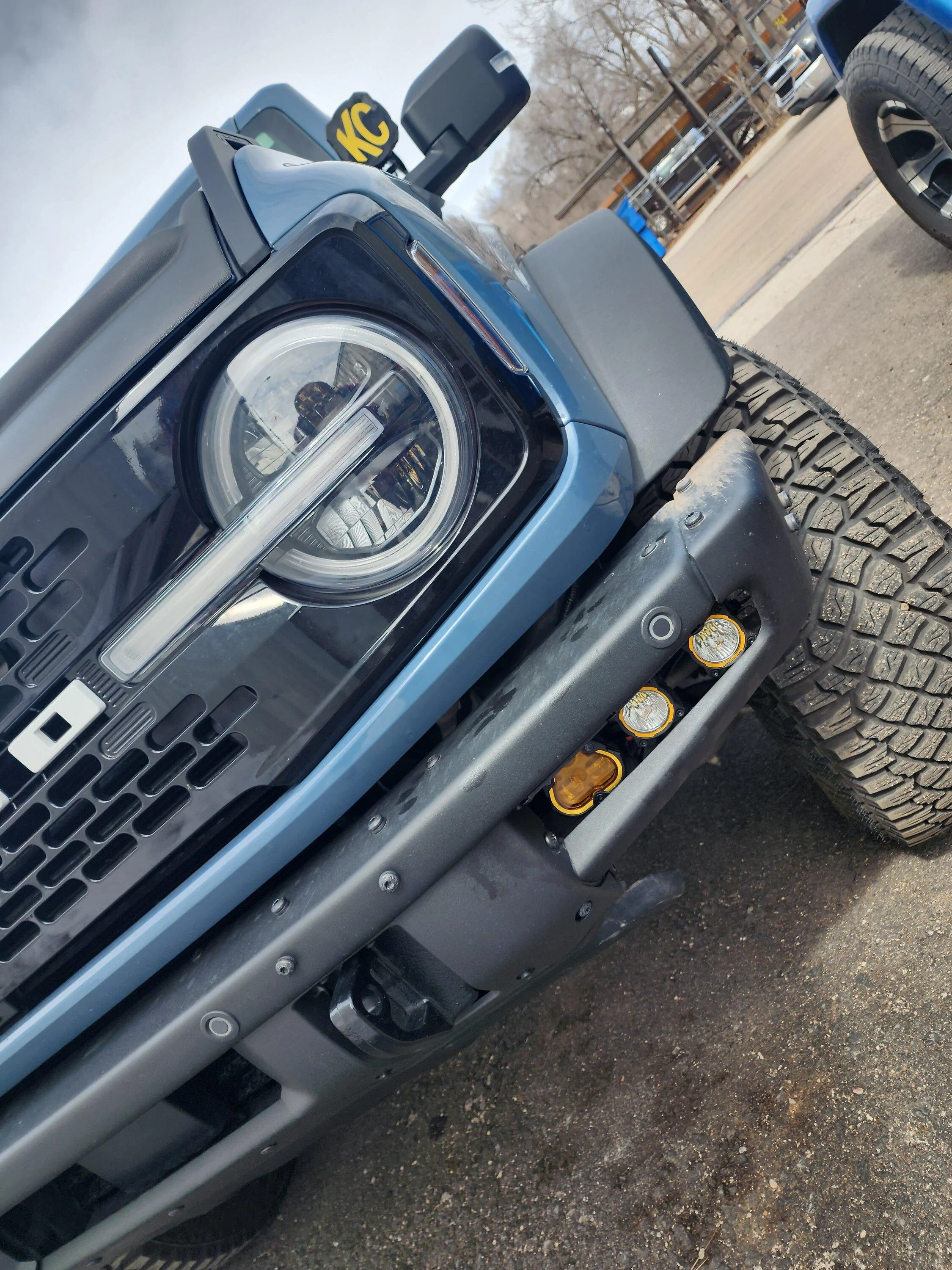

I had been waiting for these to become available for a minute, and sure enough my kit arrived yesterday. The bracket was beefy but the open ended slots in it allowed for super quick mounting. Still getting the wiring figured out, but couldn't wait to bolt them on. As always good stuff and worth consideration.

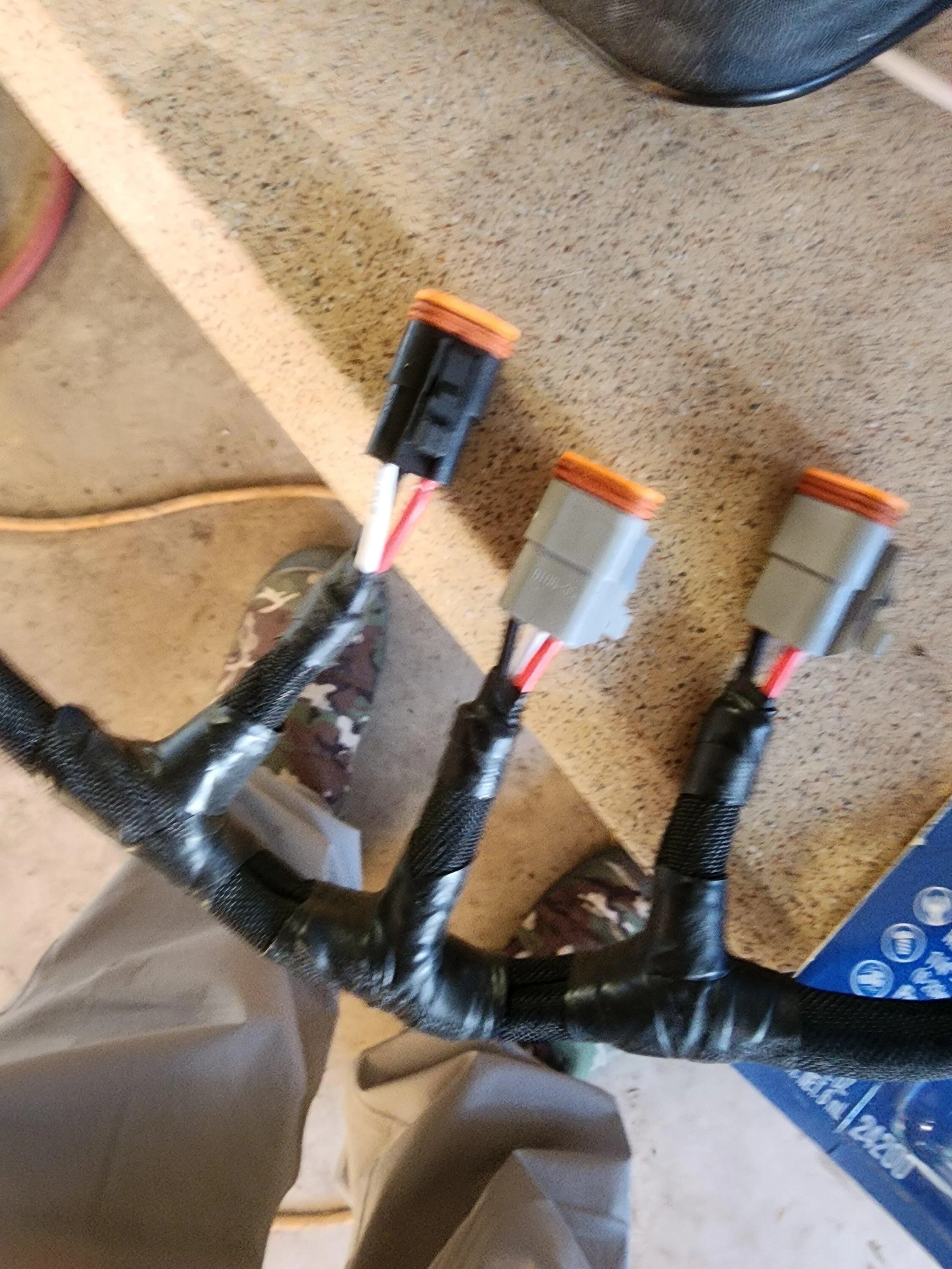

Hi CC. I've got my KC Flex Era kit installed. I'm trying to use the factory fog light circuit for the SAE street legal fog mode and and an upfitter switch for off road mode. Upfitter off road mode works great but the fogs turn themselves off about a second after I turn them on using the factory headlight switch assembly with the fog light push button. I think I've got all the Forscan settings right and reviewing the specs on KC's website suggests if the factory fog circuit can handle at least 10 amps, I should be OK. Did you wire yours to the factory fog light circuit? Any suggestions? Thanks!

I did everything through factory aux switches and believe the street mode will need more than 10 amps. I had to switch a 10 amp fuse for 15 amp fuse cause I was blowing fuses on mine. The KC tech told me they would draw more power so my 2 cents I don’t think they will all power for street mode on the factory fog switch unless you change fuse. When I had it on 10 it would only power the flex 1s and that was with the flex 3 unplugged. Moment I plugged in it was blowing fuse every time. If you find out you can and are able to make it work with factory fog switch id love to know how to get a aux switch back! 😎

I used all upfitter switches. I was just surprised to find the wiring, and didn't have a plan or the parts to try and make use of it. Overall though the fog light kit does draw allot of power.
