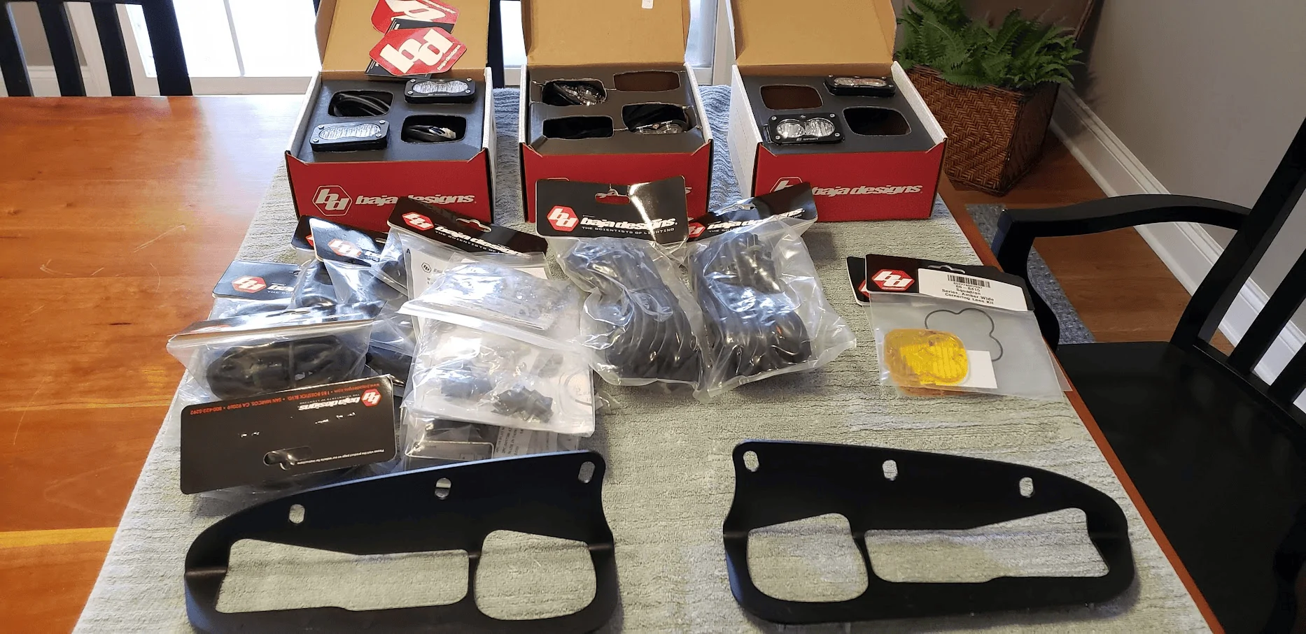

I got the Baja Designs fog pocket light kit and installed in my FE. Watched a few YT videos on install so was pretty straightforward. I did end up missing some of the parts just like a few of the YT videos I watched but the seller (RD Parts on Amazon) was very responsive and overnighted me the missing pieces. I think the missing parts is the fault of BD, not the seller and I've seen others with the exact same problem so they should know better by now. Anyway, other than that, it went off without a hitch.

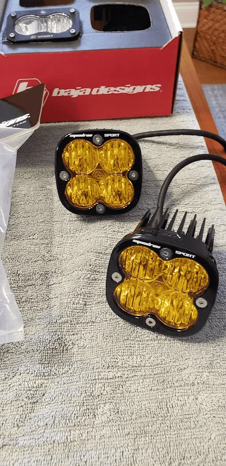

Here are all the pieces. The kit I could find available had the white fog lights and I wanted amber so I also got a pair of amber lenses and switched them out (man, those things were expensive for a piece of plastic...).
Here are all the pieces:
And the lenses switched out:

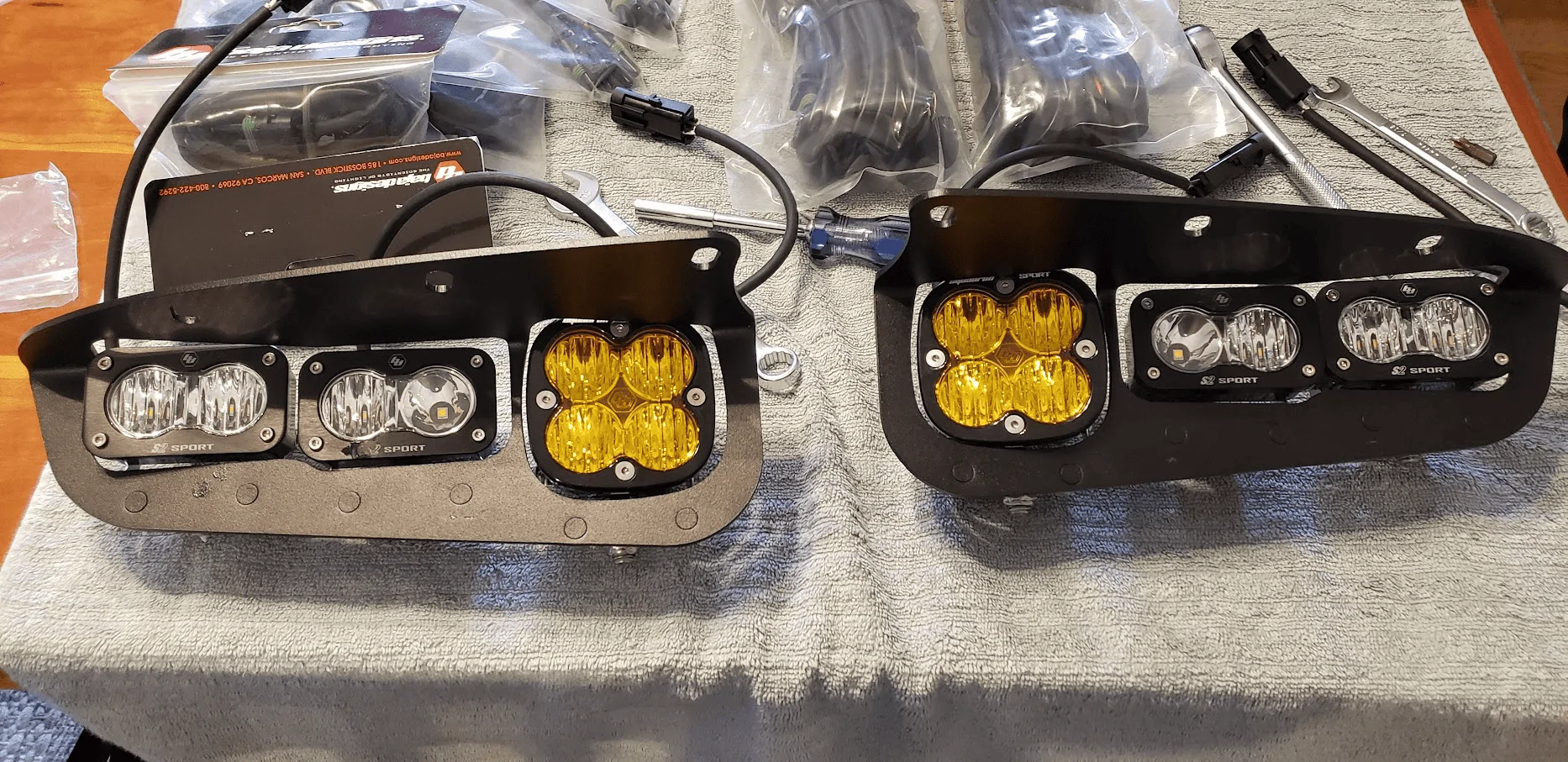

Everything assembled into the fog pocket bracket:

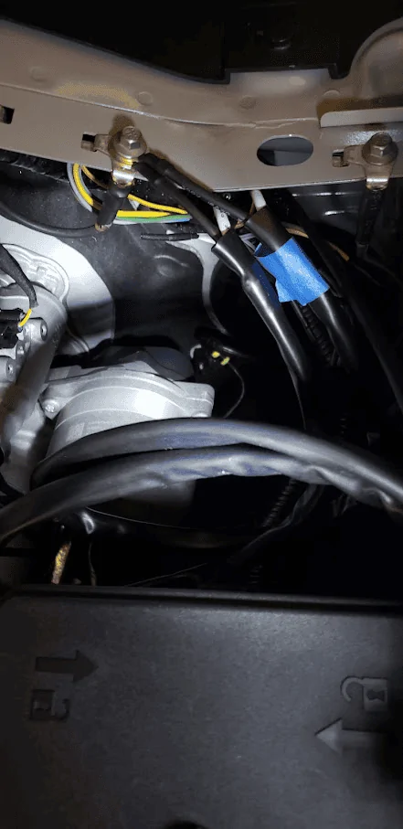

The FE obviously has the upfitter switches so tying into those was very simple. My kit came with an upfitter interface. Only issue I found was that my switch #6 appears to not work. I re-tapped it twice thinking I just didn't have a good connection but moving to a different switch was the only thing that worked. Still haven't chased that down. Don't think it is the fuse because the light on the switch is active.
I wanted to go to 5 and 6 but ended up on 4 and 5.

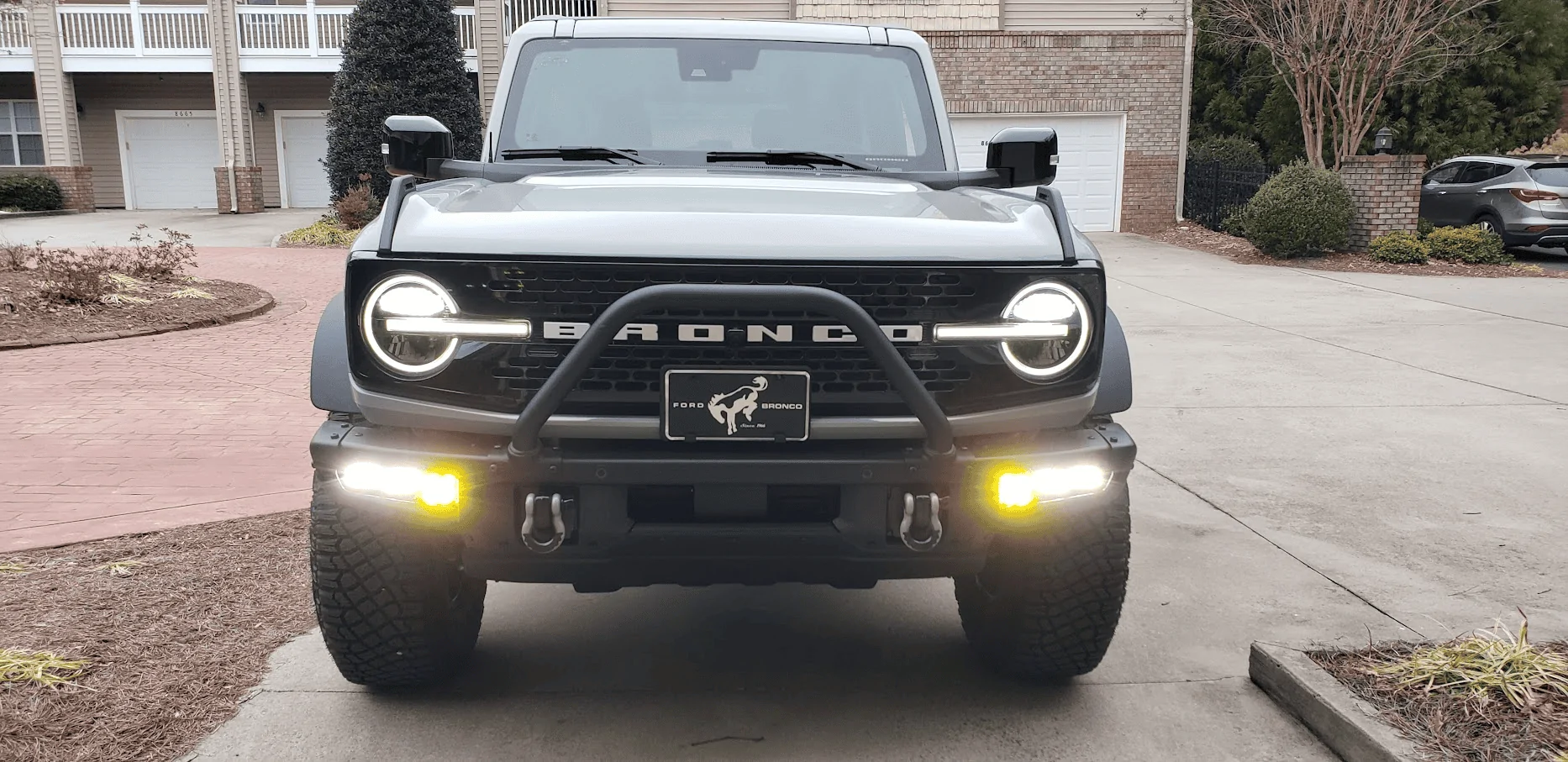

And the finished product:

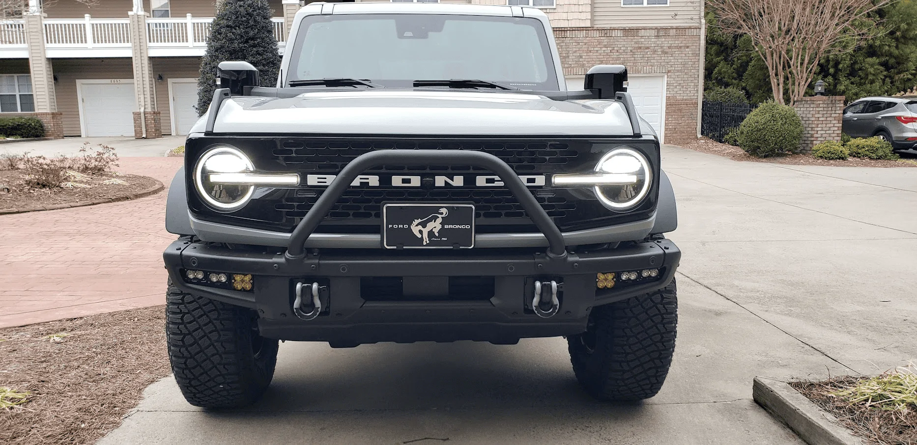

That looks really clean. How are you enjoying it?
I like them. Haven't been called into duty much yet however.
If I decide to add lights in the same area to the Black Diamond, I will likely try the Diode Dynamics from 4x4TruckLeds and then I'll have some good comparisons.
