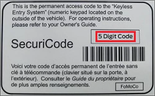

Ok, this is pretty wild, however, while installing some electric yesterday, I found the attached card inside the dash... I believe this is the card for the keyless entry code. However, the code on my card is not working... Any ideas?
Ford Bronco Keyless entry keypad OEM cod
I don’t know how many times I have to say it in one thread, but what is one more time going to hurt lol
The card found on the BCM is not the correct card, or the correct code for your stick on keypad. The SecuriCode card is for something completely different, and would only work if the vehicle had an integrated keypad.
Yes, I understand that, however, I viewed this FoMo page.. suggesting it:
Where can I find the Keyless Entry Code?
If not it, what is BCM code for?
