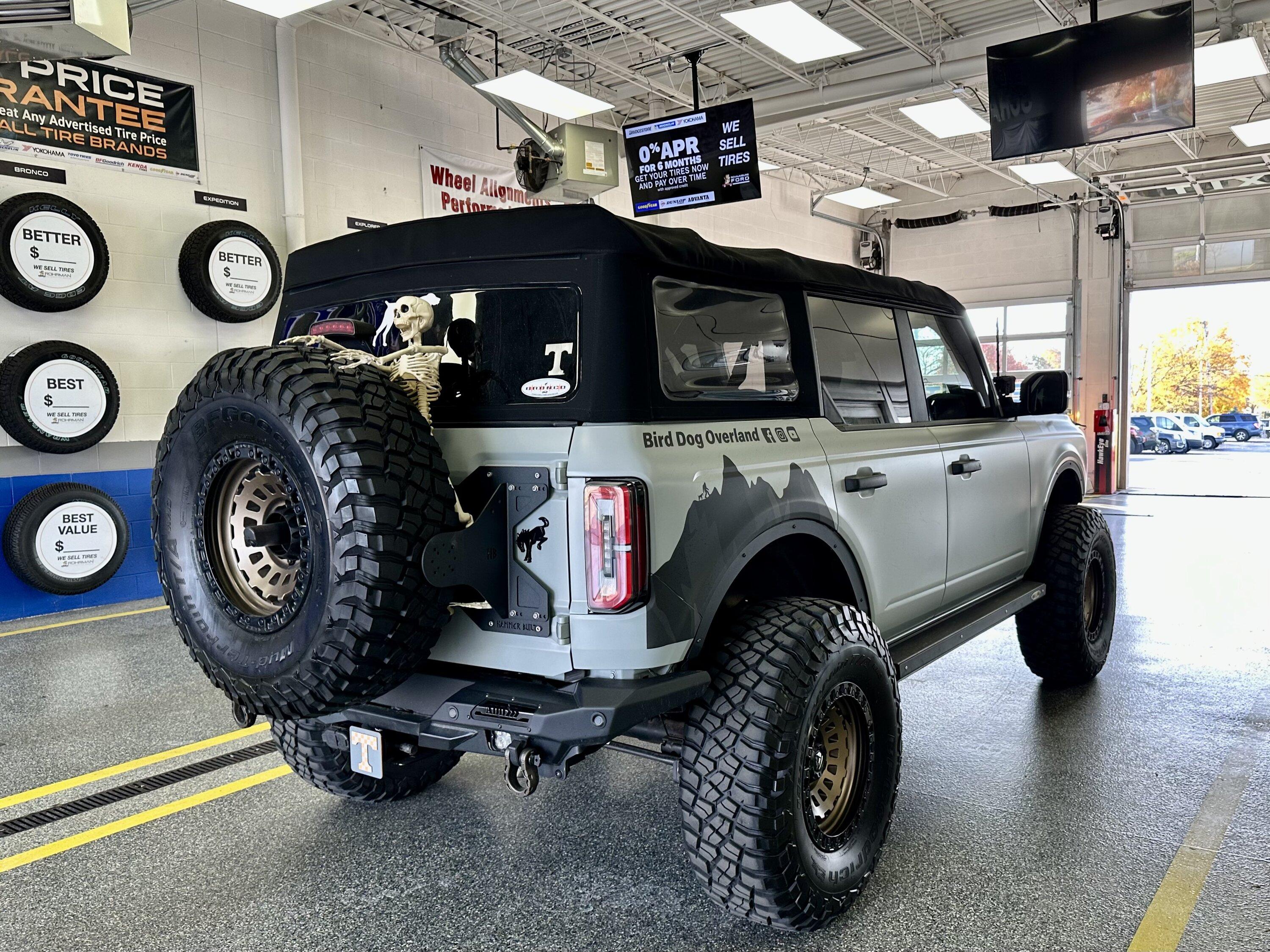

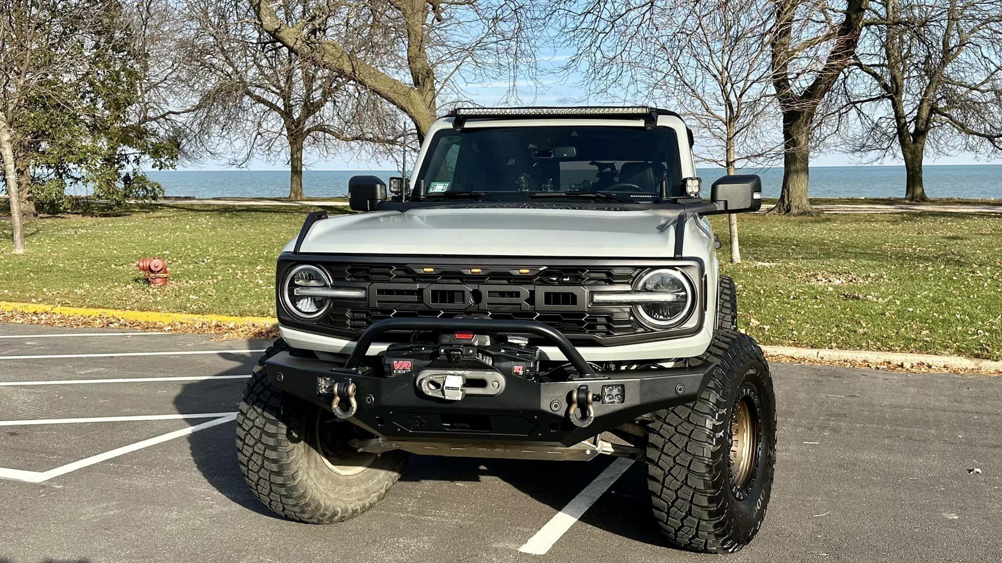

I have 37" KM3s, but either are an improvement over the stock sasquatch tires. I love the KM3s and had them on my old 4Runner as well, but they are pricey. I've heard a lot of good things about the Nittos as well. Either would be a good choice IMO. Something I'm always mindful of when buying tires is weight. The heavier the tire, the more rotating mass and therefore, more strain on the drivetrain.

Thank you sir….and Go Vols!

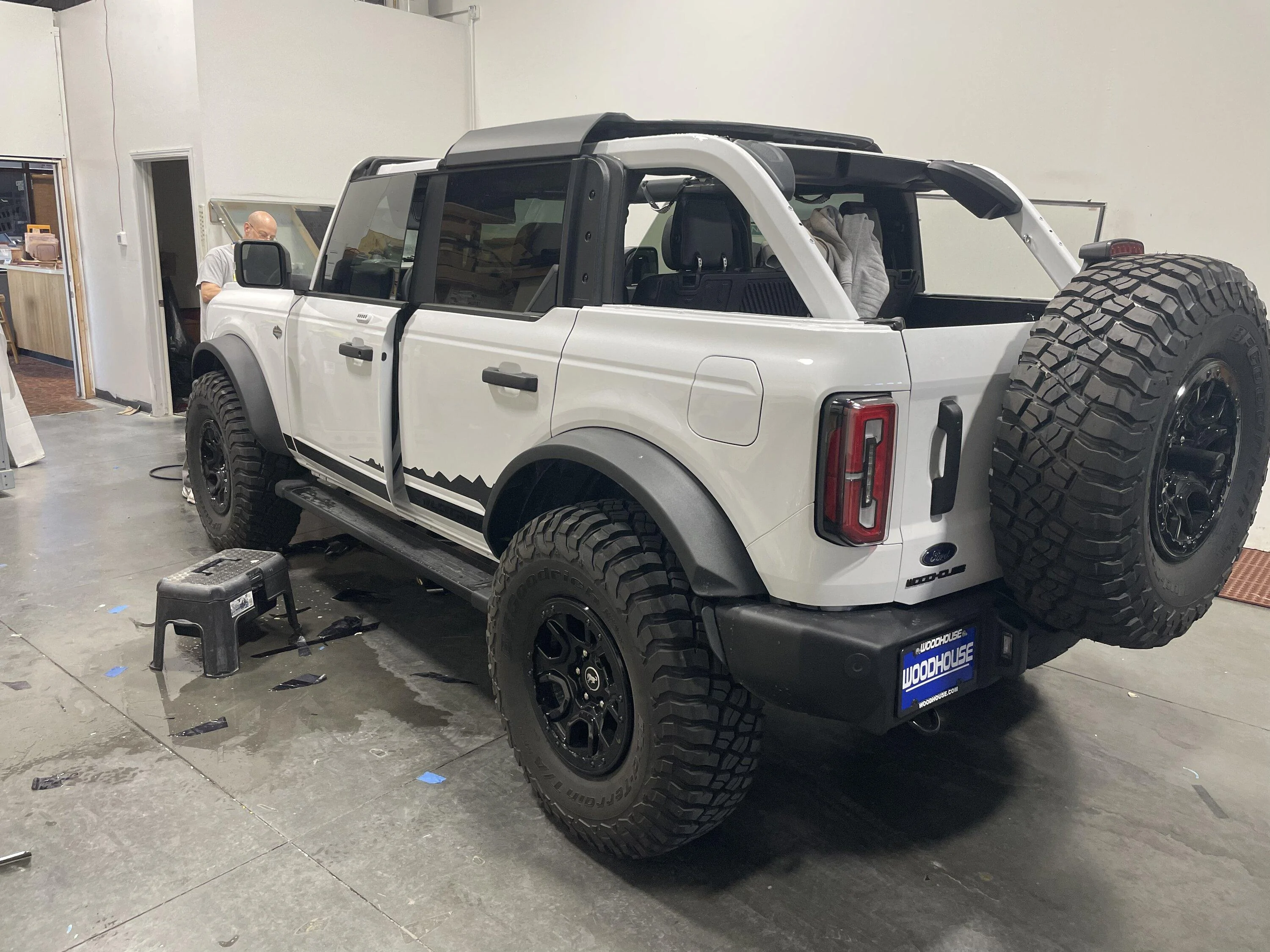

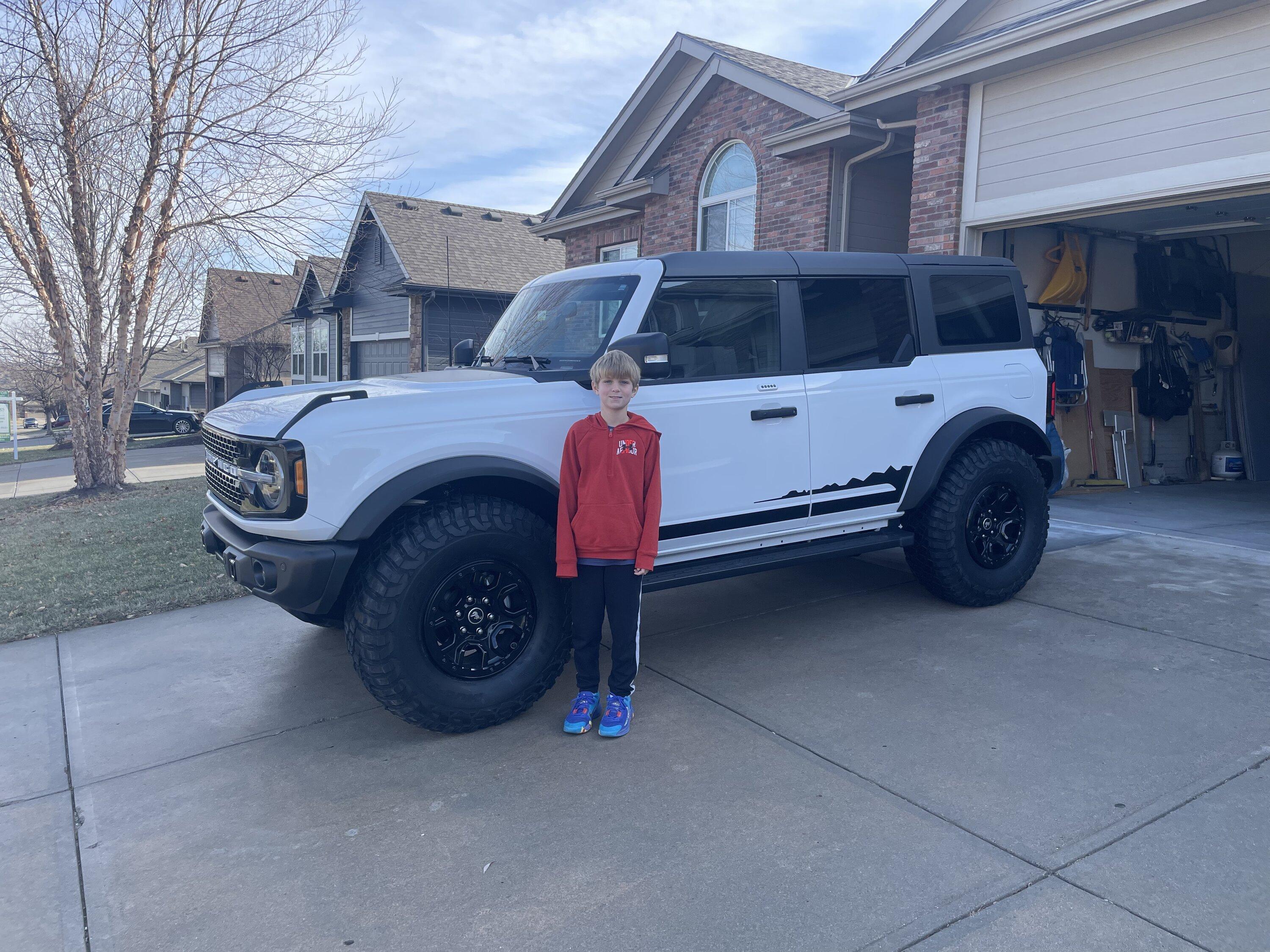

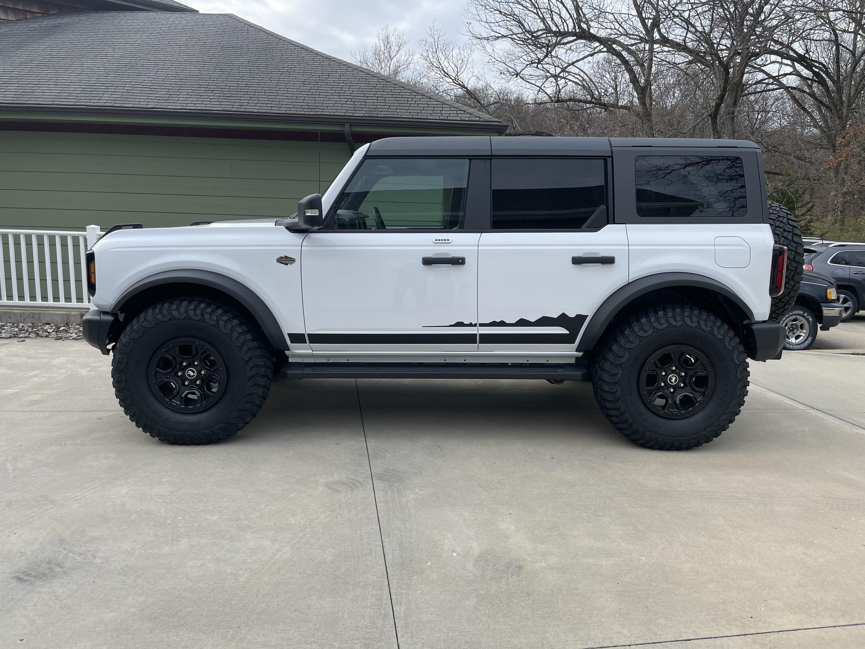

It’s was kind of weird as I was going to put on a 1.25 Bora spacer to give it the look I wanted, however it look about a week to show up and during that stock 350 mile week i had no rubbing that i noticed.
However after the 1.25 spacer was added i did have a little rub on the tub steps on both sides, but that was minor and was easy to fix with a heat gun. Also on the driver side at articulation it rubbed in the wheel well next to the tube step. that was also easy as their is just a 4" thick chunk of plastic that was easy to trim and heat the liner with the heat gun and push in an inch.
You just reminded me I need to take more pics too :). The side shots are before spacer and the one with the top off is after spacer when I was getting some PPF installed.

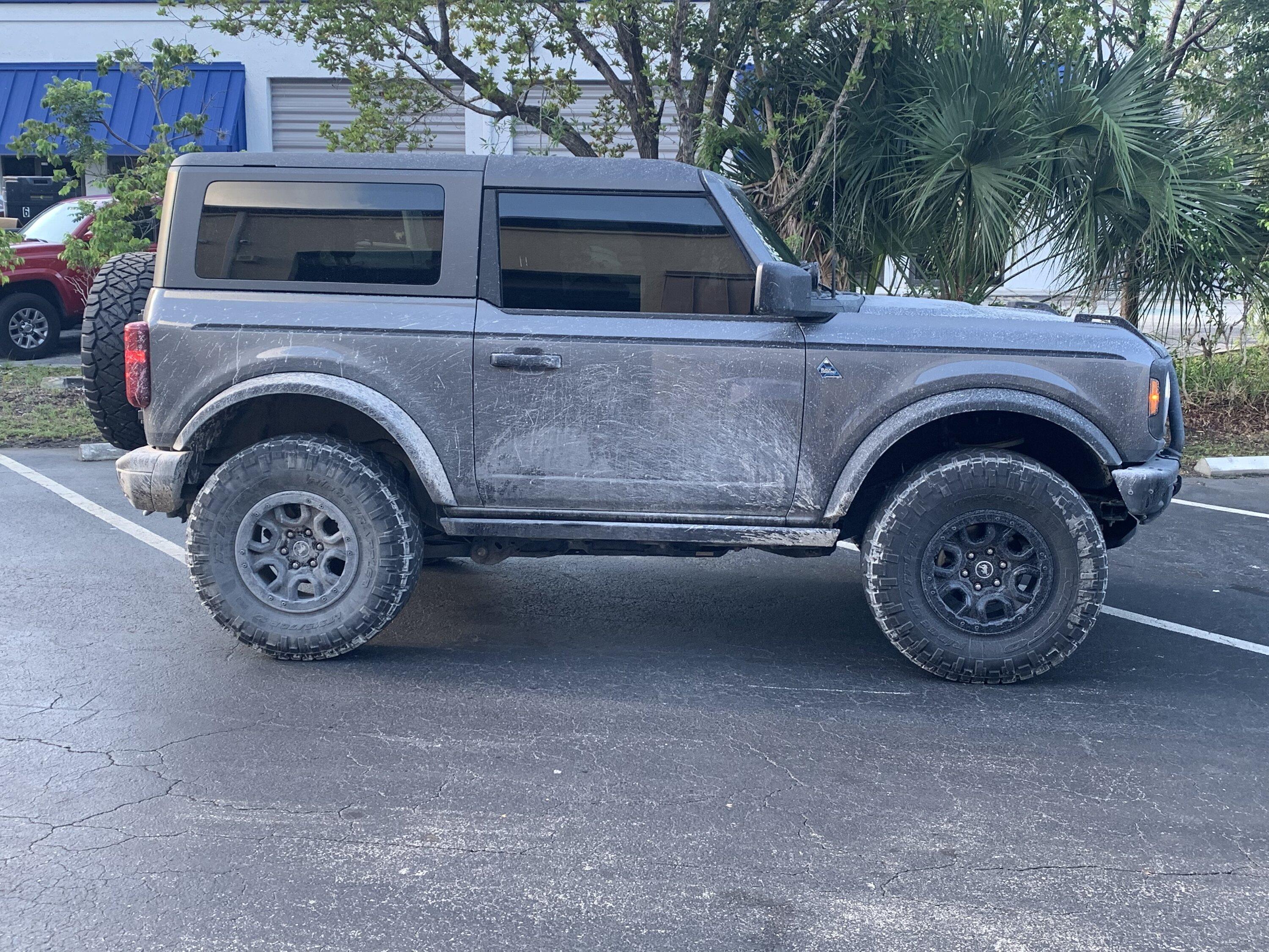

Which front bumper is that?
