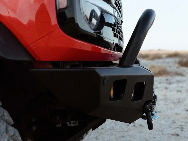

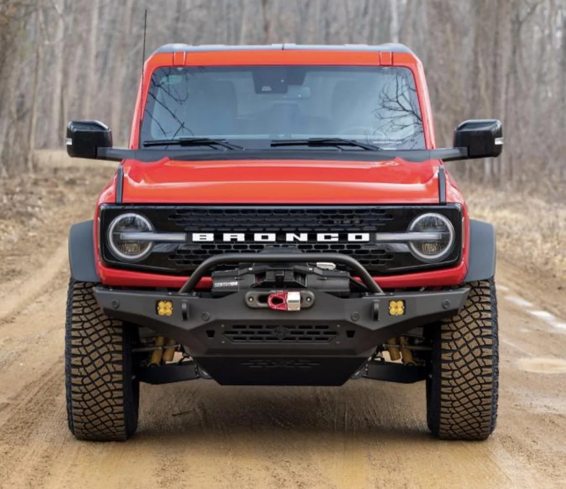

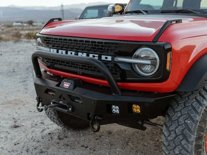

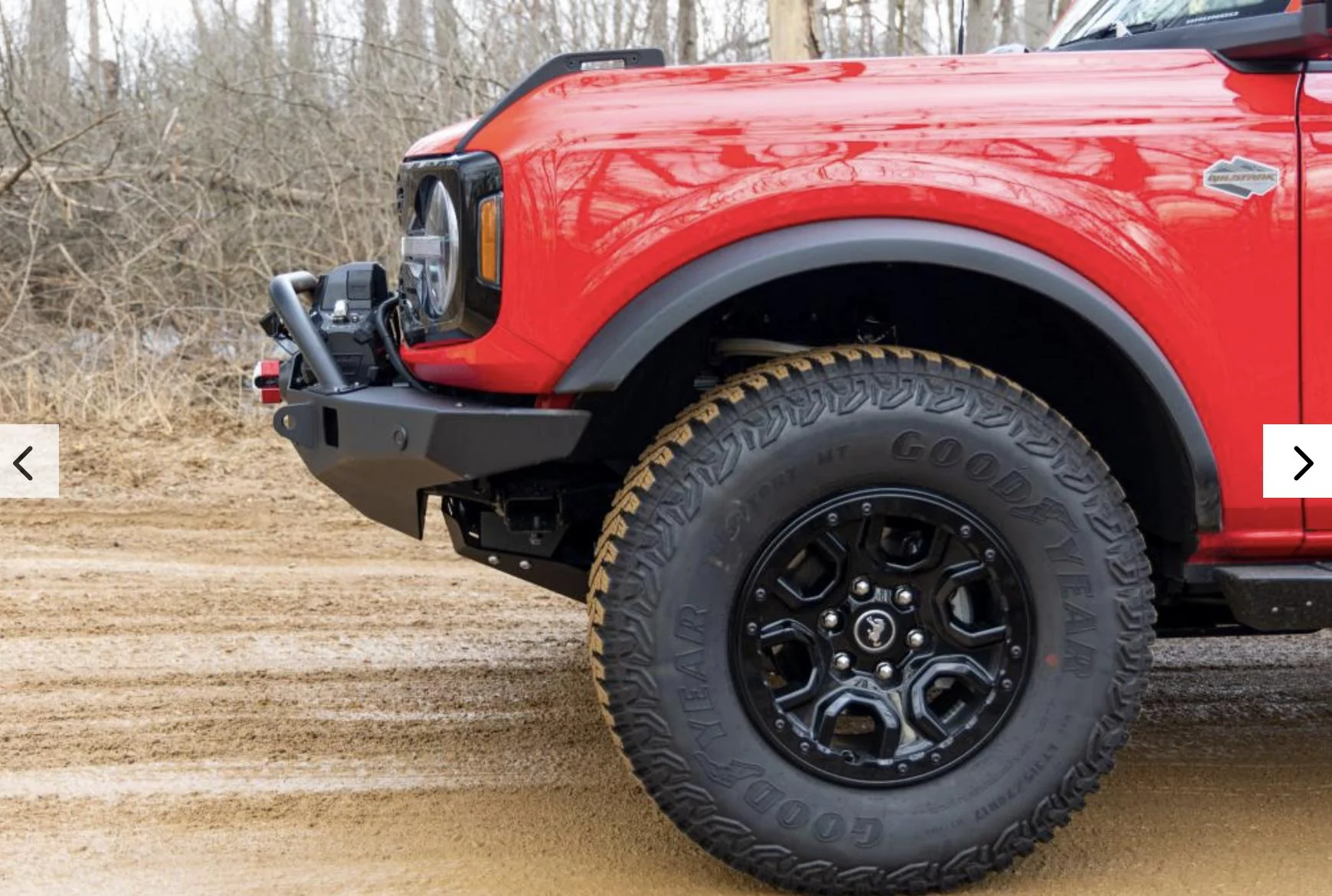

I have a 2 door Badlands non SAS high package and love the way it drives and handles. I’d like to add a winch for self recovery, but I’m concerned that adding an extra 100+ pounds on the front bumper will cause the front to drop on braking and could impact the feel of the steering. I have the Mod bumper with the JCR prerunner tube currently. If the weight weren’t a concern I’d use the Icon winch bumper (122 pounds :oops:) as I love the look. I’m thinking that I need an aluminum bumper that weighs around 50# to replace the mod bumper and JCR prerunner tube, then the additional weight of the winch would net less than 25 pounds. A secondary concern is keeping my front camera usable.
My current setup is 100 pounds:
Mod bumper 80 pounds (https://www.bronco6g.com/forum/threads/oem-modular-bumper-and-skid-weights.44823/)
JCR prerunner tube 20 pounds
Aluminum winch bumper options:
JCR Vanguard , 50 pounds, $1699 plus the front camera relocation kit for $249. Looks good, will probably require a narrower front skid plate, the one from JCR is $519 for aluminum.
https://www.jcroffroad.com/product/BR6FV.html
Aluminess, 50 pounds, $2000. This one mounts the winch lower, but has the “overbite” on the approach angle. May also need a narrower skid plate.
https://www.aluminess.com/products/...22-bronco/?page=1&vid=4196491200&sku=210636.1
For winches, the Warn M-8000s is the lightest I’ve found at 55 pounds, it’s $1120 and probably a little short on pulling power for the Bronco but does meet the 1.5x weight of the truck guideline. The Warn 9.5XP is over $2000. The Warn VR Evo 10-S is 72.4 pounds. The Smittybilt X2O GEN2 10K is 63 pounds, not as well proven as Warn but on sale for $468 currently.
If anyone has any other aluminum winch bumper suggestions please post them.

Looks good from the front but your approach angle is terrible with that. I dunno what the option is but good luck

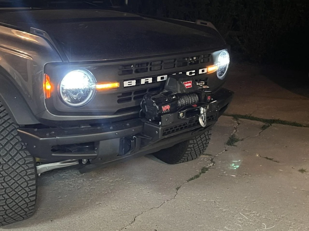

If you’re looking for excuses to buy extra bumpers go for it, but I simply added a $200 winch plate and a warn 9.5k winch onto my mod bumper and there is zero noticeable effects on driving/braking.
The Aluminess approach angle (last picture) doesn’t look good. Compromises have to be made in design to get the winch lower. The JCR looks acceptable to me.

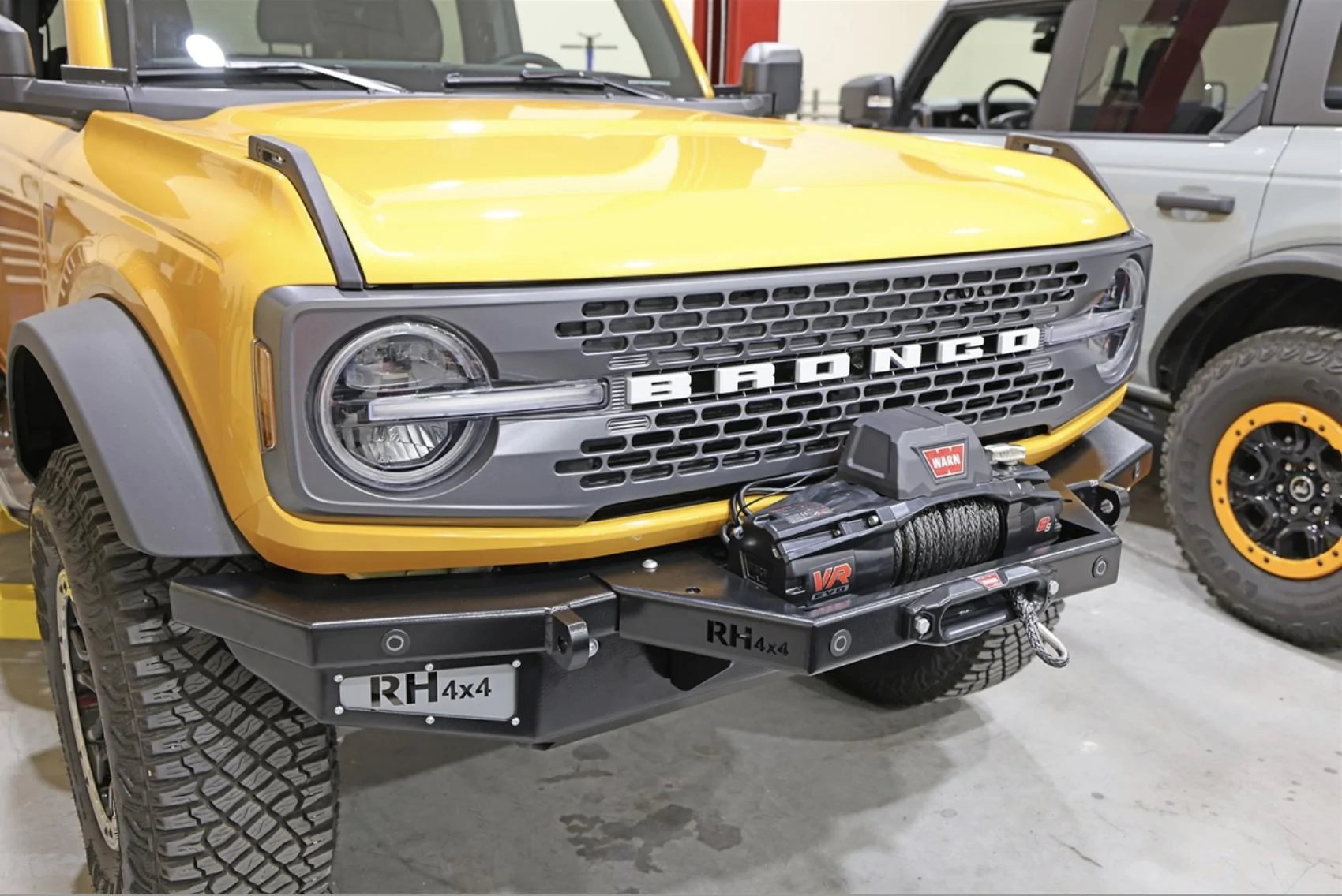

I like that setup and would consider it, it’s cheap and effective with a good approach angle. With the Smittybuilt winch I’d be all in for $750 instead of over $3000. Others in the thread for it are commenting that they notice the weight in brake dive and heavier steering on the 2.3L like I have. The recommendation was to swap the 2.7L springs onto the 2.3L truck to compensate for the weight. I’ve seen conflicting reports on the weight of the mount, but I think it’s 49 pounds. I also like the Lobo skid plate replacement, but I can’t see how the winch would function well if you can’t see the cable spooling to monitor it packing up on one side and can’t easily reach the freespool handle.
I saw their bumper on the spreadsheet. There isn’t a weight listed on their add on steel winch mount, but it looks pretty minimalist so probably under 25 pounds. There design is a little too home built looking, but I like how tucked in the bumper is and the winch mount is a little lower than others. This is a lame reason not to consider it, but honestly I couldn’t live with their logos predominantly on several surfaces. Everyone is going to logo their products, but RH goes over the top with their 1990’s inspired logo.
Ford Bronco Lightweight winch/bumper combo C38327A7-EB33-4E0F-8C8F-2BBA411B1CE0
Looks good! Link for winch plate?
It’s just the Rough Country high clearance plate. Lots of threads here about it. Great product and value
