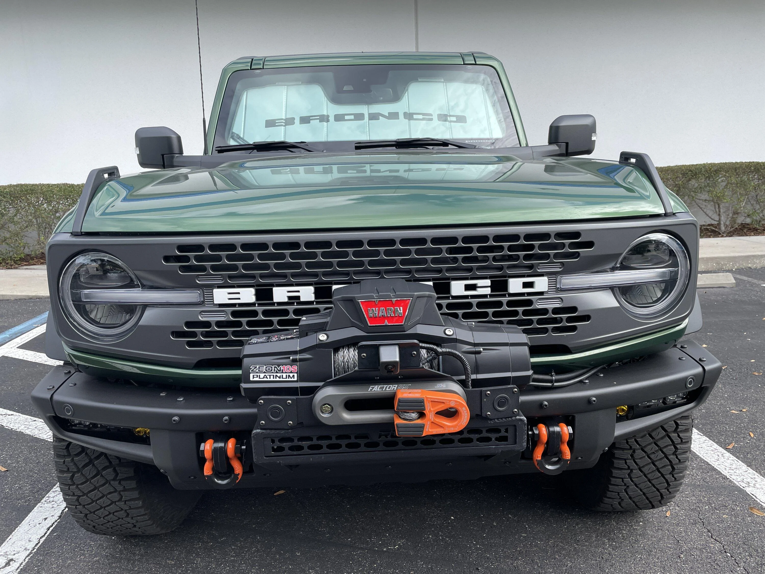

I have the RC high winch mount with a 10k Zeon Platinum on stock SAS, I could measure front clearance now. 🤷‍♂️. Doesn’t look nose heavy but who knows how much was lost, if any.

11.25” Lost a 1/4 inch I guess. 🤷‍♂️

WOW.....that's a NICE winch. Thanks for the details and measuring. so the WAN was direct bolt on to the Rough Country bracket? No modifications? How HEAVY is that winch you have? I'm considering a WARN EV 12s, BUT also the Badlands APEX. Warn is 54 lbs. and Apex Badlands is 67 lbs.
Any pics of it on your Bronco? :) DO you also have the Light bar?? DRL version?

Direct bolt, it’s typical 10”x4 1/2” bolt pattern. It’s a heavy sucker at 80lbs. I have the non drl version.
Ford Bronco Winch + Bumper Solutions - Lightweight 7D9A9AC1-AD66-4F96-BDD2-49A17CBCEF65

WHOA...that is a BIIIIIIIG Boy winch. so far happy with build quality and fitment yes? Thanks for all the info btw - and if later on today you can take a side-shot.....I tried looking but I can't see how much it sticks out when looking from the side - So I can gauge approach angle. Thanks man! NICE color btw!!!! (of the Bronco)

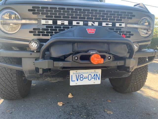

I wasn't a fan of the look of the JCR or RC, this worked perfect for me!
Ford Bronco Winch + Bumper Solutions - Lightweight bronco

So what mount is that? For Performance factory-Warn solution?
