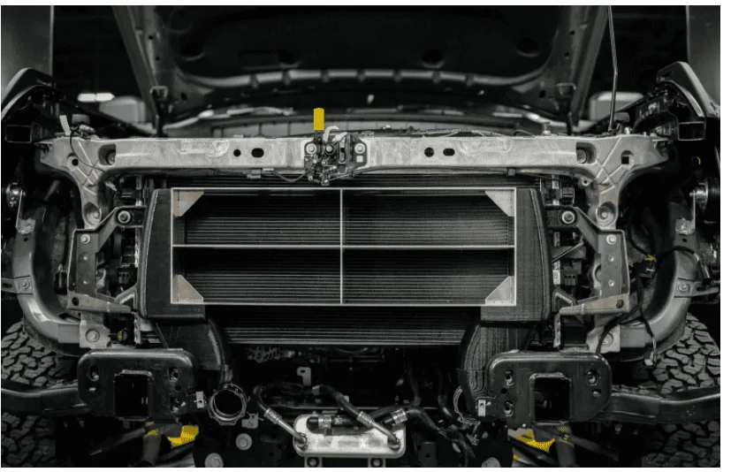

We don't know if it works with the steel bumper at all and neither does Rough Country because they don't have one to test.
The RoughCountry hidden bumper for the plastic bumper might not work as-is for the steel bumper and the skid is light-duty (1/8" and doesn't protect lower arm mount), but we now know that it is trivial to mount a hidden winch, if you are willing to cut the unused manufacturing tabs off the frame to make room for it. The intercooler doesn't even have to be replaced (just shifted slightly). Hopefully we will see some nice options become available.

I pulled my skid off, here is the result:
https://www.bronco6g.com/forum/thre...skid-plate-kit-51054.24466/page-6#post-863406
What this tells me is that we won't have a winch option that fits every build, doesn't impact the ACC, and doesn't impact the camera. The only way it'll work for Lux builds is if it sits upright like the one Ford provides, but pushed high enough and tucked in enough to not impact the ACC. I suppose the camera could be relocated, but the work involved in the lower mount is substantial for whatever reason.

I spoke to 4 Wheel Parts on the phone today. Their bumper is 6-8 weeks out (give or take, their words). I've seen photos of these on a few Broncos and they seem nice, I wish I had jumped on it while it was available.
I also asked the ACC question. Apparently it comes with a bracket that moves the ACC sensor forward a bit, but it does work according to them. They also said that it would require some adjustment during install to ensure it works. I like this solution because it roughly keeps it in the same spot, as opposed to moving it the side, but it will block the camera.
I have also emailed w/ Lifestyle Offroad, they are working to get ACC working with theirs as well.
