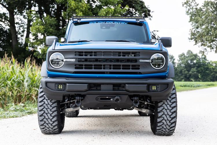

Not sure if this one has been brought up before, but while browsing through light options I noticed this hidden winch rough country's site but not seeing it on any product listing.

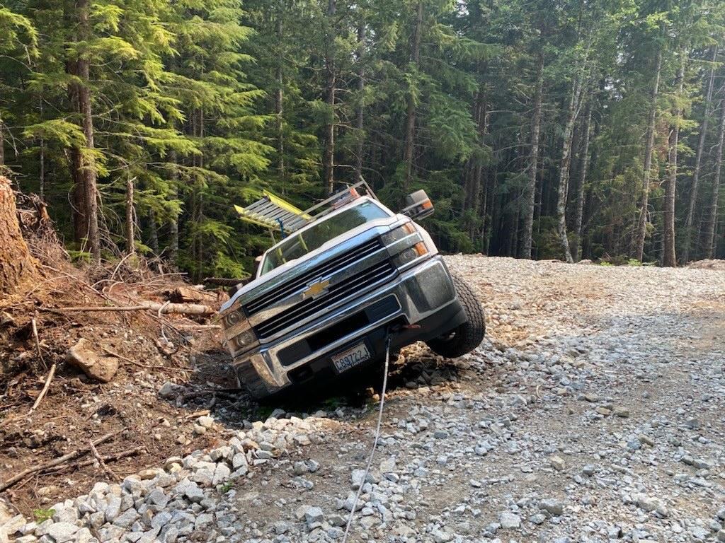

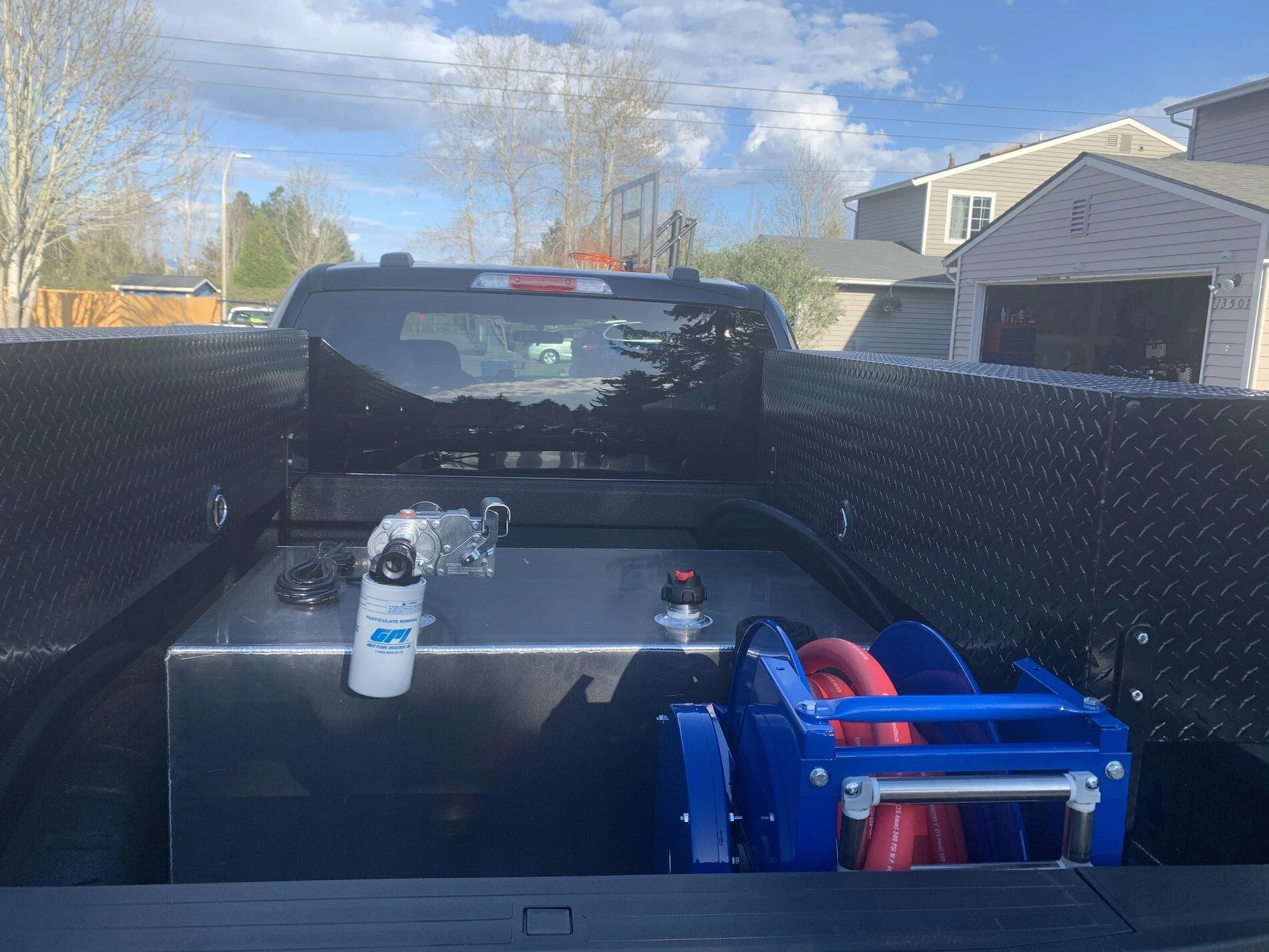

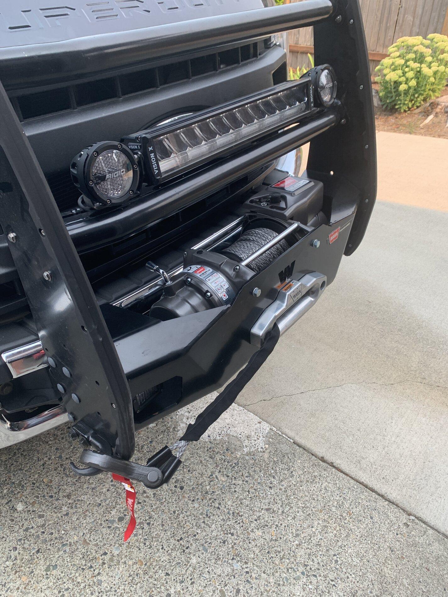

Exactly- I carry a kinetic rope, soft shackles, multiple pulleys, static straps, winch extensions...and a bunch of tools. My truck weighs 8750 when I have the in bed fuel tank full.

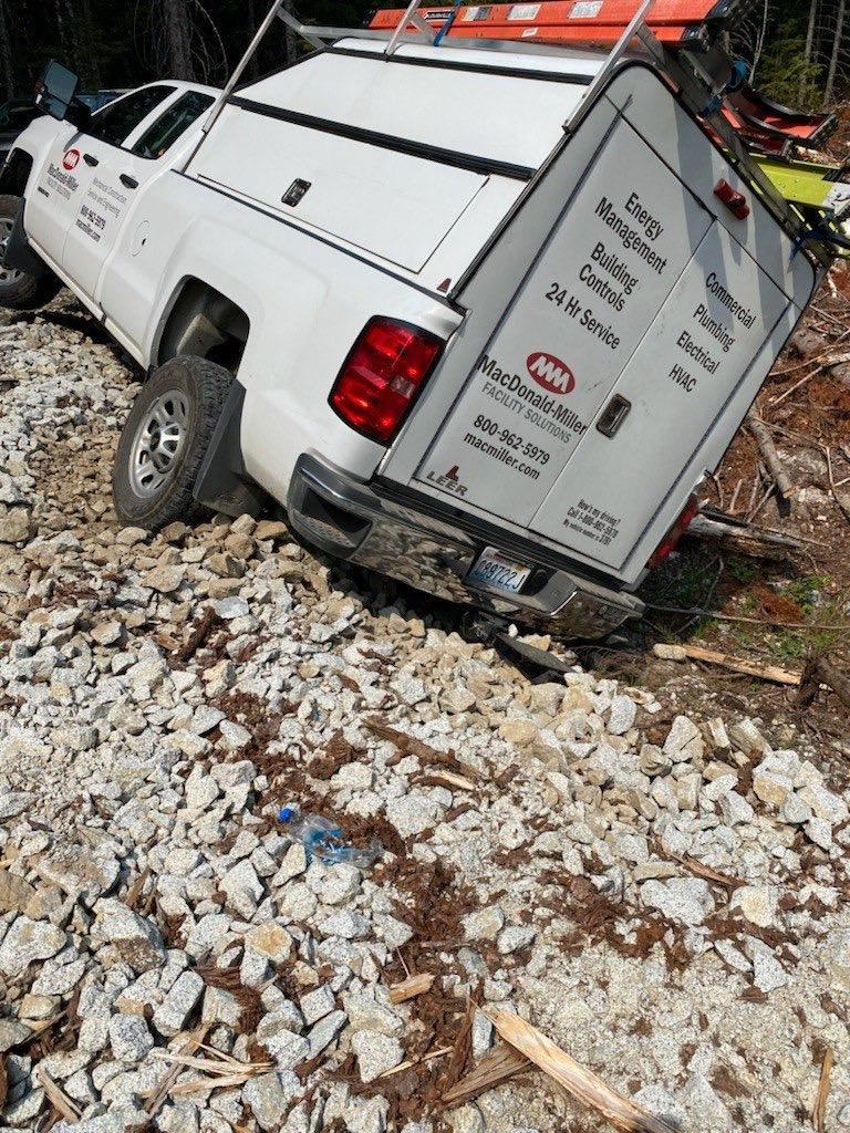

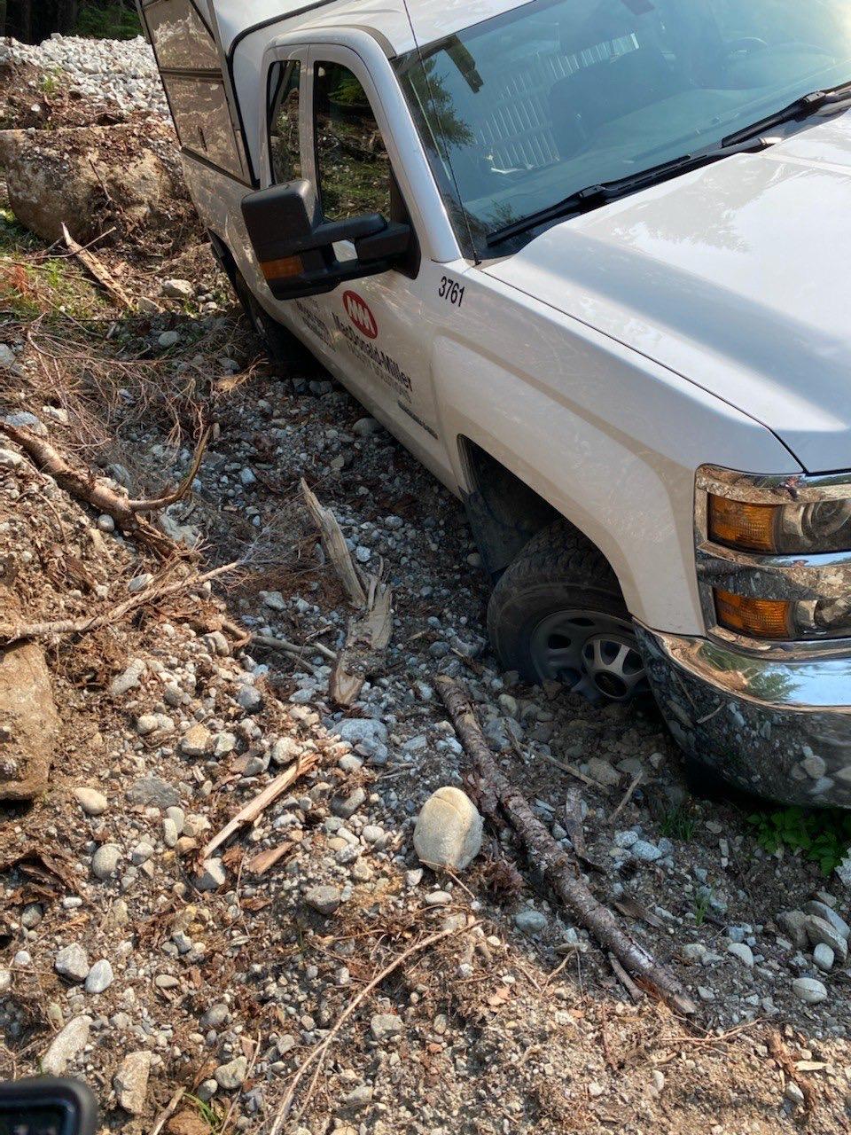

I did this recovery about two weeks ago. Only way to get a straight pull was to redirect off a tree, the length of the pull(distance from truck to tree to stick truck) necessitated a winch line extension. The stuck truck probably weighed close 9k. The pulling truck was sliding even with foot on the brake and rocks used as chocks. I had to strap a second truck to the winch truck.
wish I took more pictures, but it was a Friday night and I wanted to go home from work.

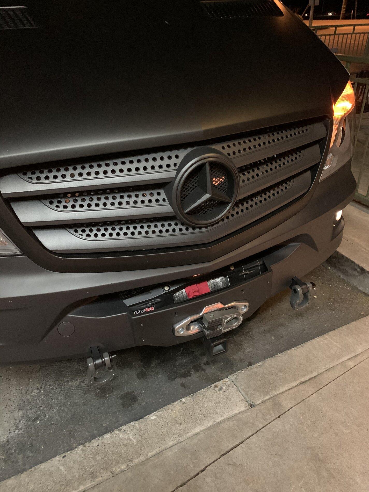

I'm just hoping aftermarket will have a front hidden hitch soon to put my receiver mounted smittybilt xr on
Absolutely love this set up on my van. Integrates the winch, receiver and recovery points in to the factory plastic bumper.
This looks ideal since it doesnt interfere with either the camera or the ACC. It must be under development right now, I sure hope they have a version that is compatible with the modular bumper too.
Here are some more pics I found on their site https://www.roughcountry.com/imagegallery/2021-ford-bronco-4wd-3-5-inches

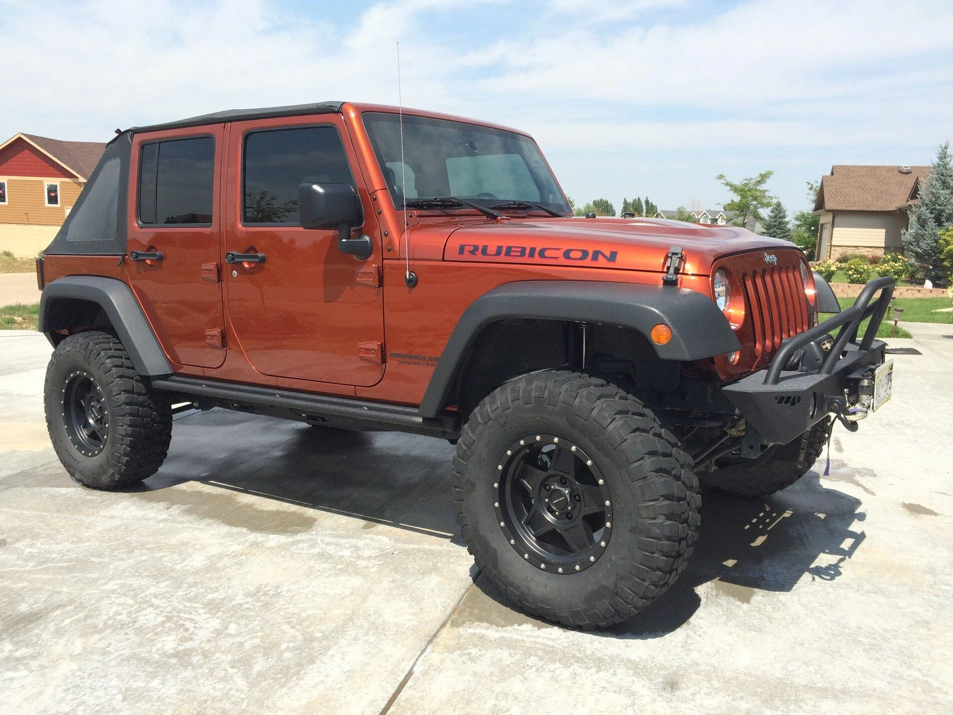

I drive a Rubicon on 35's with a front winch and it has saved my ass off road (and various random others) quite a few times. Frankly, it's an essential tool for the Bronco if you want to compete with Jeep. I ordered a Badlands/Sas/Lux and had this very discussion with the Bronco reps last week. Disappointingly, they do not have an answer right now. I implored them to take the message back to Ford that Badlands/Lux is an EPIC FAIL without some kind of relocation bracket for the radar antenna and front camera allowing a winch. The aftermarket guys are pretty good at this stuff, but Ford would clean up if they "fixed" the design to solve this problem. I'm just hoping that they're on it .... cause I'm not selling the Rubicon until the Bronco provides me the full functionality I'm used to with my Jeep. I WILL sell the Bronco if they can't fix this. And I'll be real pissed about it because the Bronco is near perfect in every other way. I can't help but believe they're on it and a solution will be at hand by the time my Badlands/Sas/Lux finally ships.
I pretty much agree. For me tho Id like the lux package but I definitely do not need cameras. I've been wheeling over the toughest stuff in this country for thirty years and oddly enough never needed a camera or spotter. Picking lines is a learned craft that most everyone will get soon enough. The cameras are a novelty item that most people will quit using within their first year of wheeling. I'd love a camera delete code. You will all see that approach angle and a winch are a thousand times more useful than any camera. If I need to remove the camera to gain a high clearance winch bumper than so be it. Like I said,.. It's a gimmick or novelty item not necessary to survival, recovery or trail completion. My JKU below still hits on some rocks and ledges. matter of fact, I recently hit my fairlead roller on a rock and pinched a hole in my license plate. You younger people grew up watching videos (Virtual reality) wheeling is total reality. pull away from the video feed,....live in the reality. you will see it's very easy and fun. If you put a low winch bumper (Bottom pic) on your Bronco, the Jeep guys really will laugh at you. That one posted a day or two ago is hideous.

This the exact solution I'm waiting for.
Full camera view and the ACC will still work. Make it happen Rough Country!
