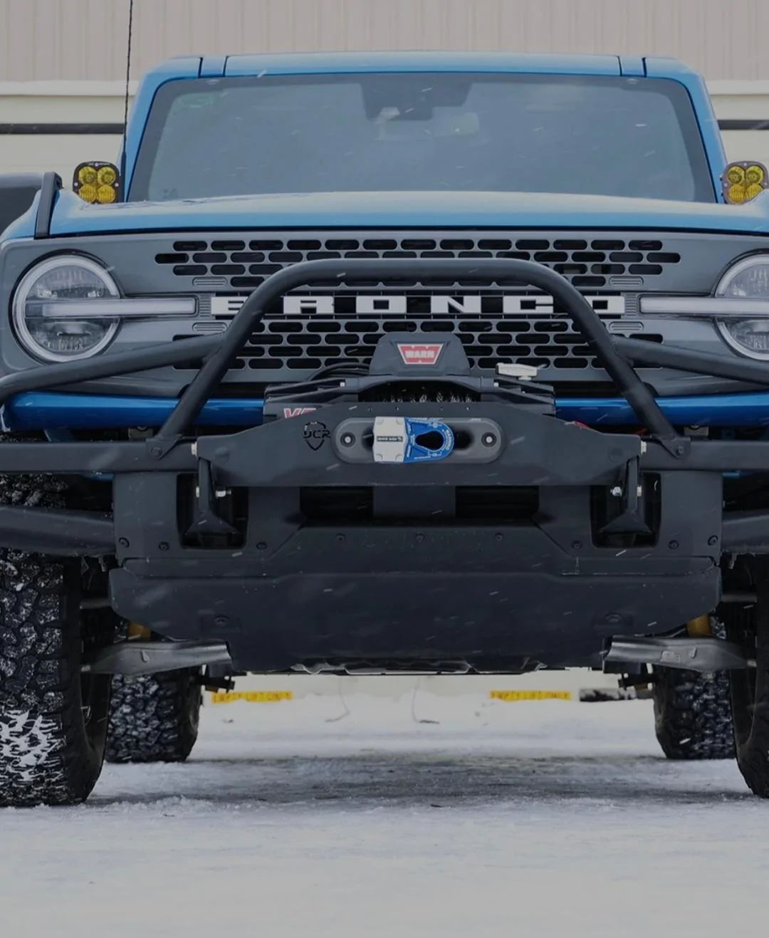

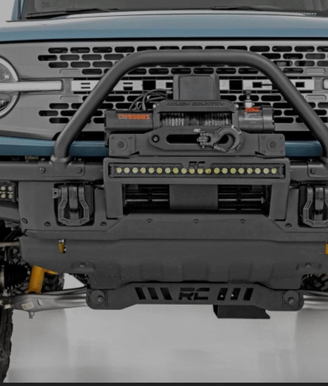

RC and JCR front height pics side by side....
The RC looks to be an inch or better higher but the winch is completely different too making it look really tall. Just from this thread they might run out of the first run of these lol!

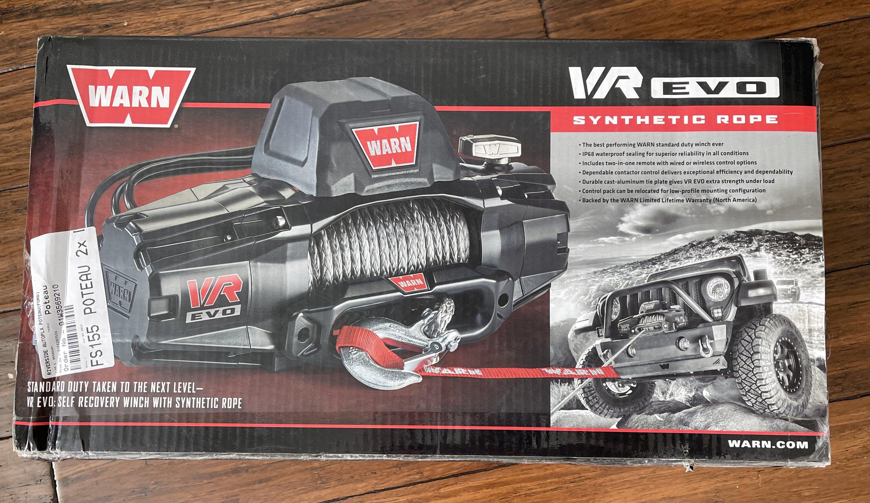

My $795 eBay Warn Evo 12s winch showed up yesterday, looks like they are selling them as overstock from Poteau Ford.
Ford Bronco Modular Bumper Winch Mounts A640897D-D4B2-43C1-A738-EF7752F6F486
Winch mount will arrive Tuesday and a separate shipment for the sensors come Thursday. Just waiting on BAMF to send me the under hood relocation bracket. Hope to see how others turn out.

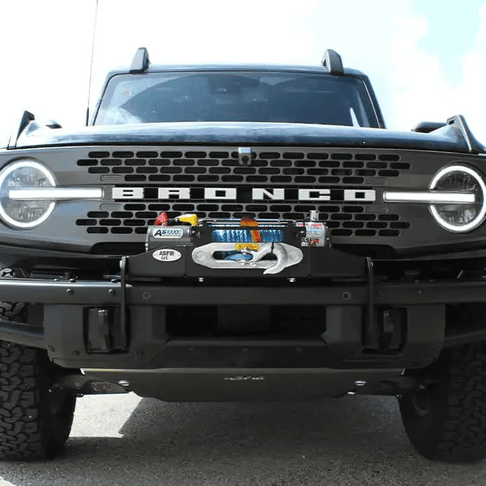

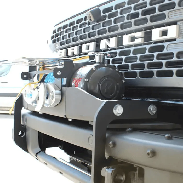

Just came across the ASFIR winch mount.
https://www.asfir.com/winch-mount-599620.html
Ford Bronco Winch Mount | for OEM Steel Front Bumper
Fits only on vehicles with the OEM steel bumpers and 2.7L engines
  • Manufactured from 6mm (1/4"") zinc-coated steel.
  • Corrosion-resistant finish.
  • Fits on the OEM bumper without affecting its structure.
  • Mounted on the OEM bumper using factory mounting points only. No drilling is required.
  • Allows the full functionality of a recovery winch with minimal added weight.
  • Engineered to support winches up to 10,000 lbs.
  • Includes all required mounting hardware. Does not include winch lips.
  • ā€ŒWeighs in at 40 kg (88 lbs).

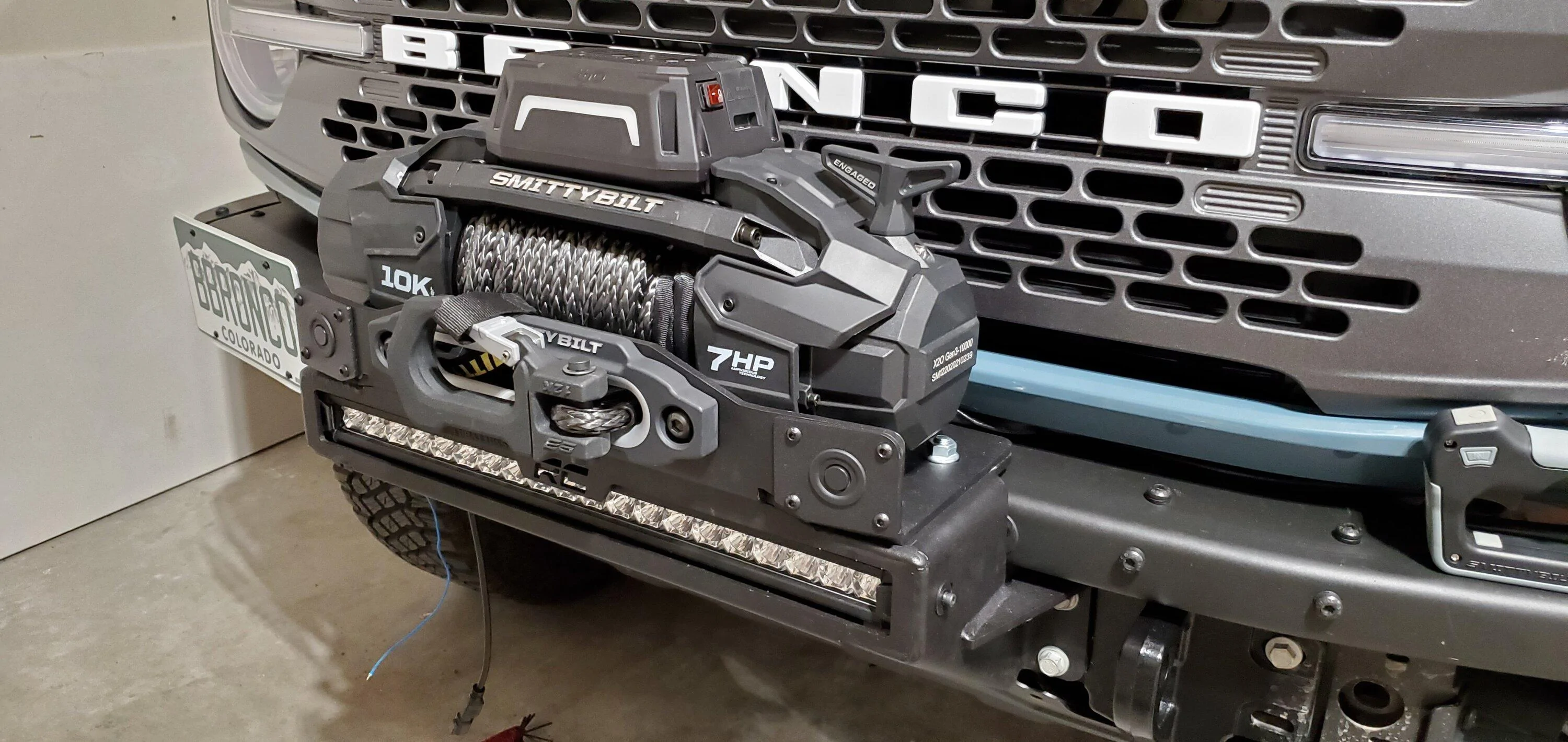

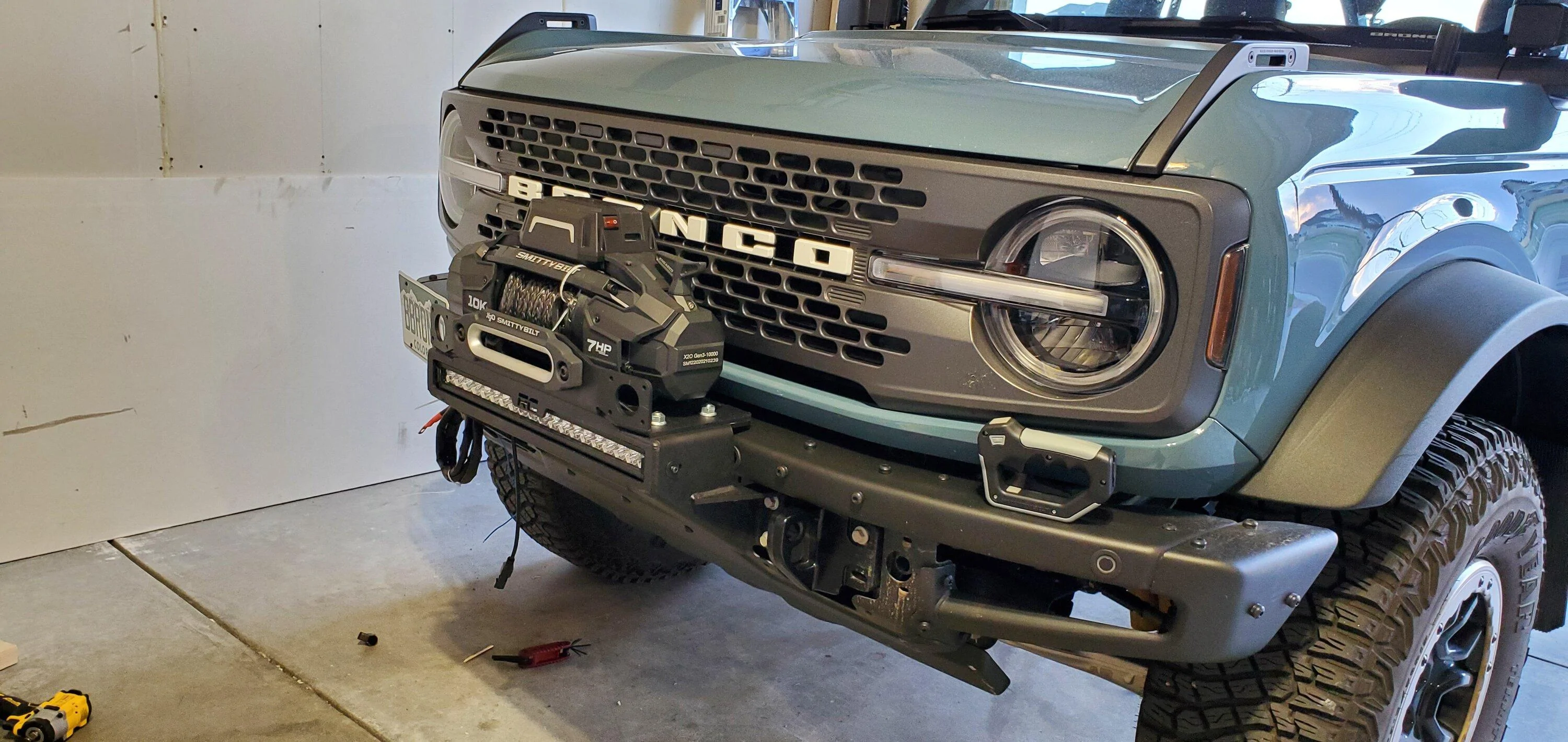

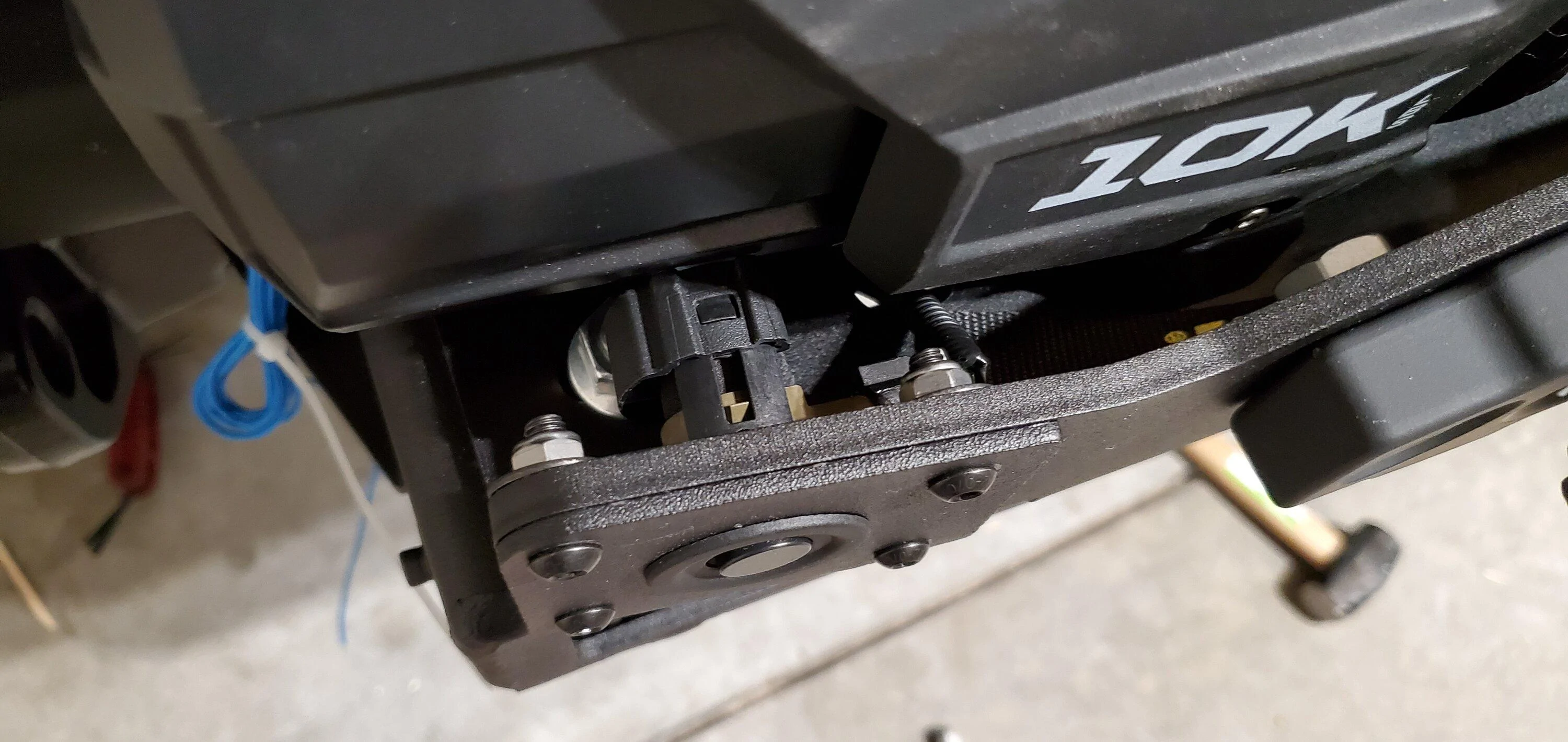

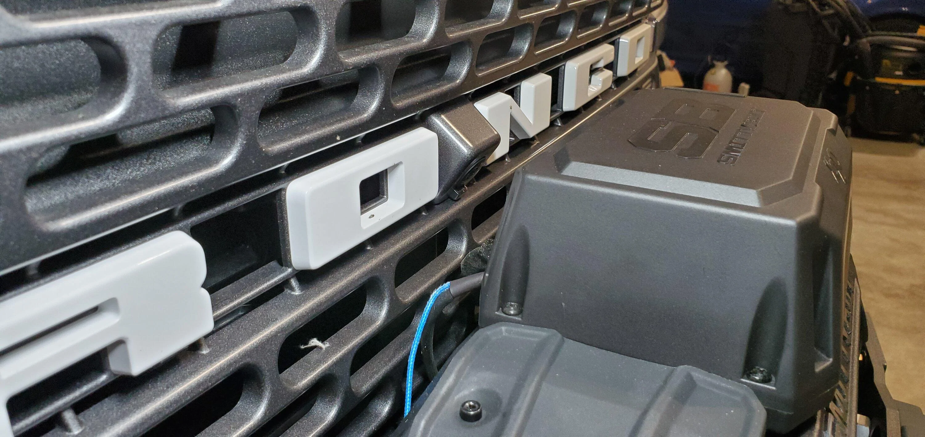

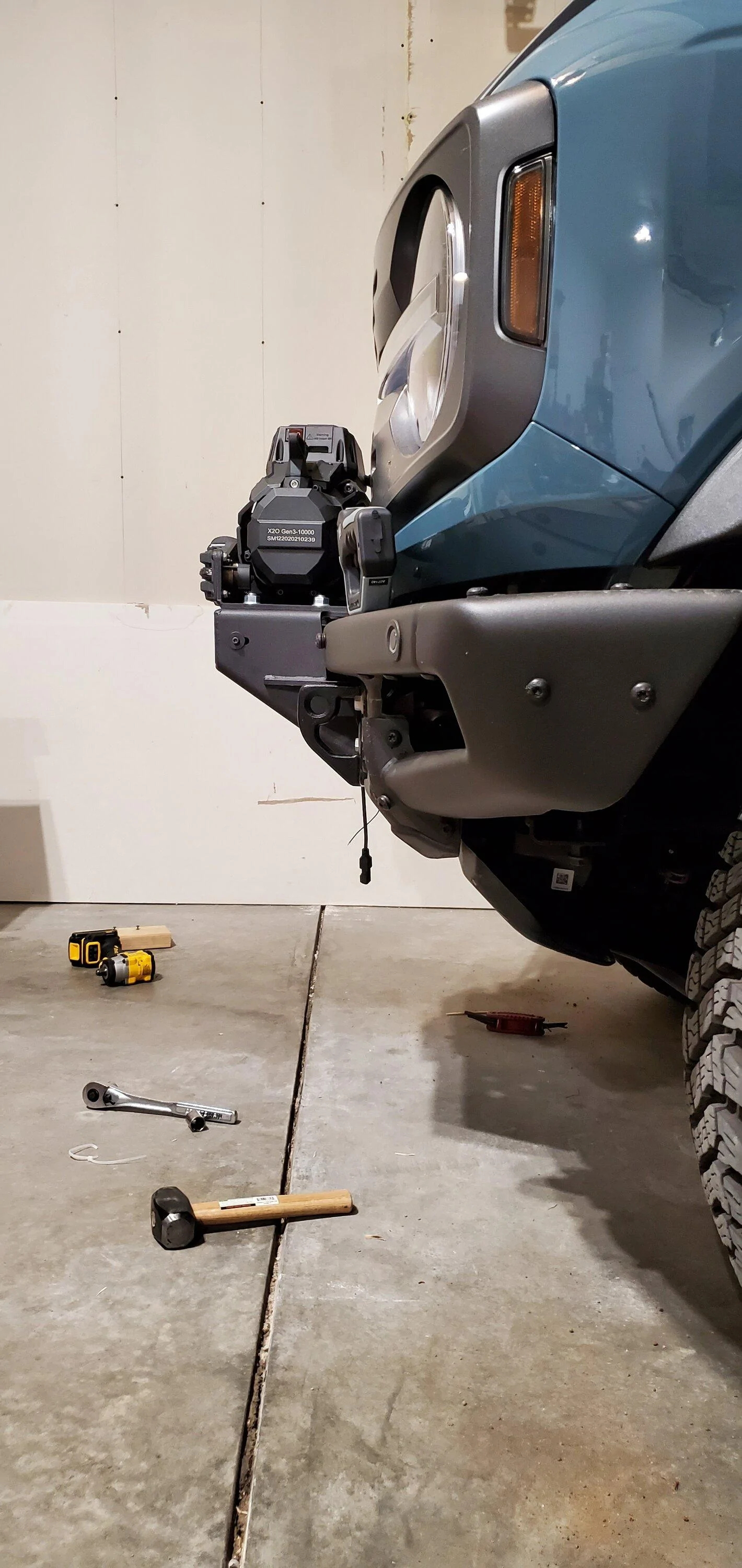

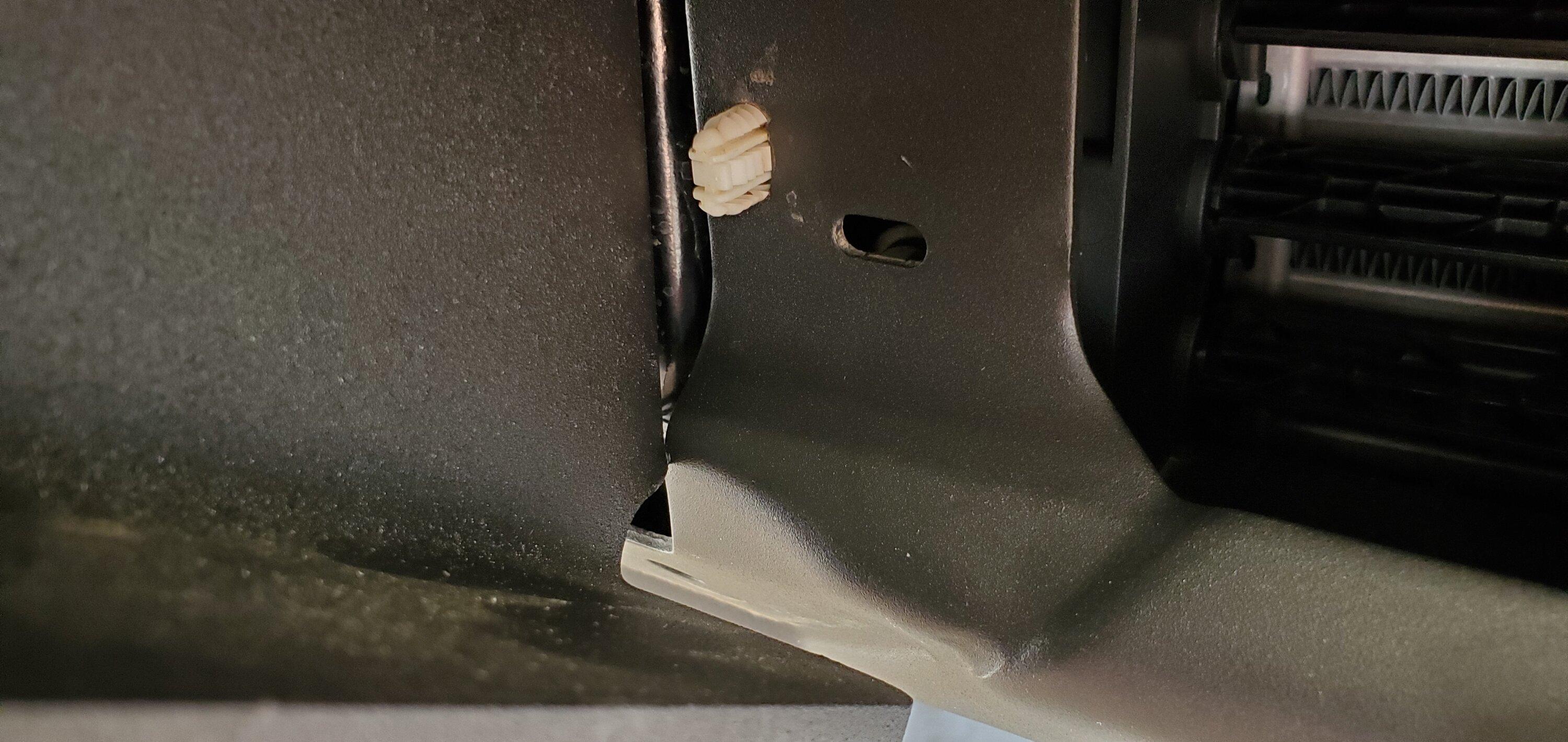

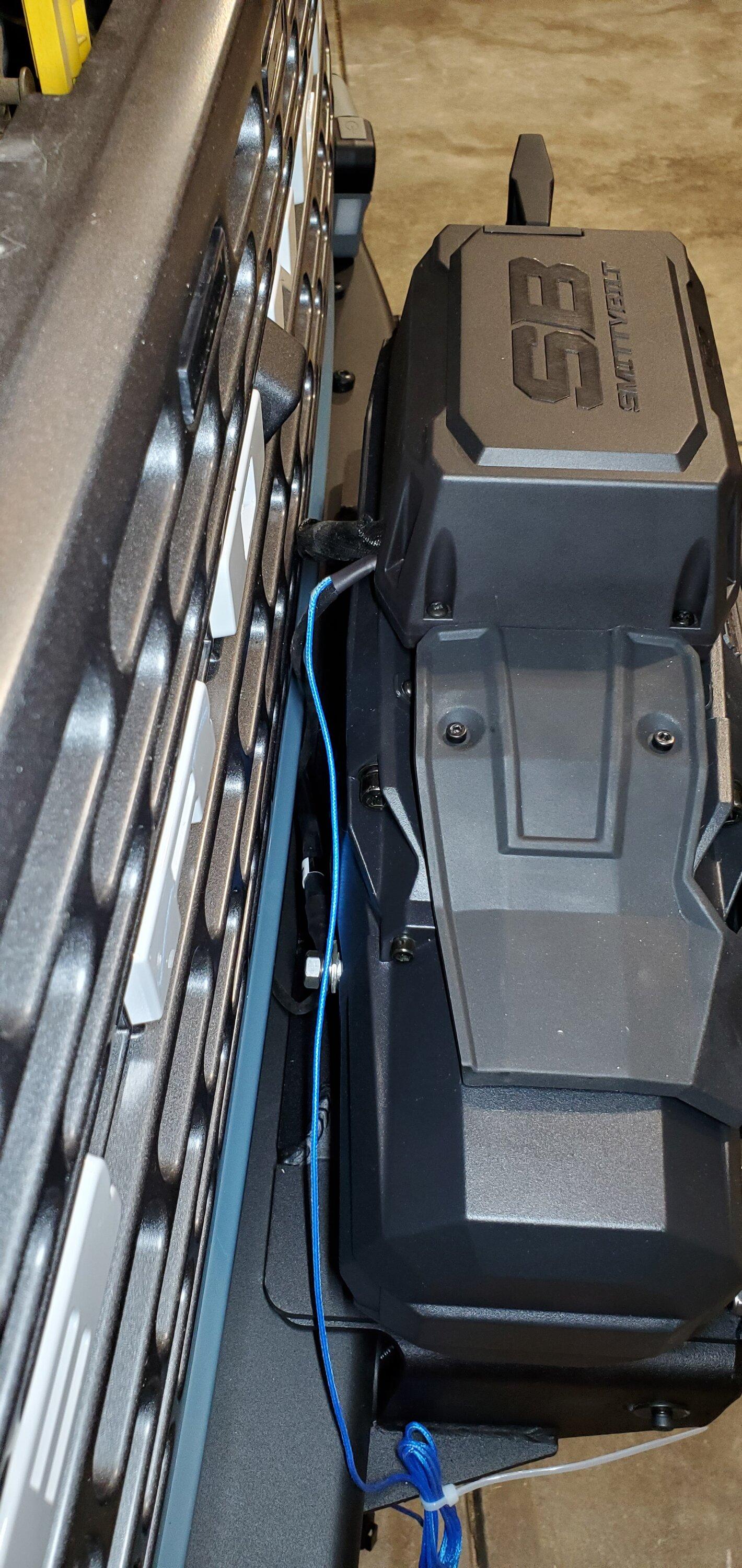

I got mine all done
I got mine installed except for trimming the plastic tow hook covers and wiring up the lights. You can mount up the mount to the bumper before attaching the winch and winch plate. Make sure you install the sensors before putting on the winch because it's difficult to put those screws and nuts on after. I didn't need to trim anything for my X2O gen3 winch.
My only complaint is it presses on the bumper face a little in the corners by the lower mount bolts (4th pic). It also completely blocks the camera, even if I were to relocate the control pack. Definitely needs a camera relocation kit.
I'm happy with this so far though!

@Blaylock1988 Thanks for posting your thoughts and photos. I also have the LUX package, so will have the same issue with the front camera - have you found a camera relocation kit that could work? Also, how's your Adaptive CC working? with the mount installed? Tnx.
