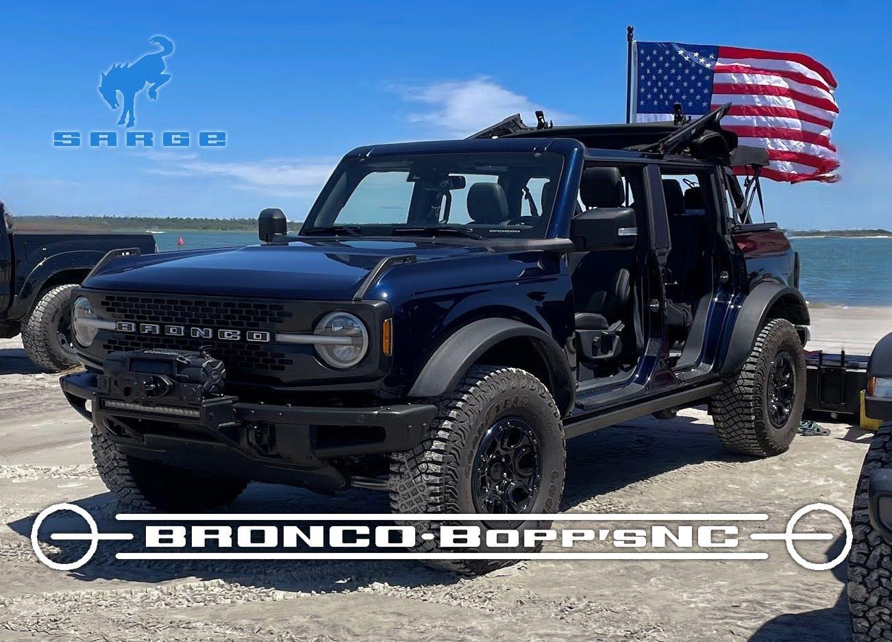

I did the RC High Winch Mount. Huge install post done with pictures. Personally the price and how it tucked in nicely was why I chose it. After removing decals and relocating the control pack, I couldn’t be happier.

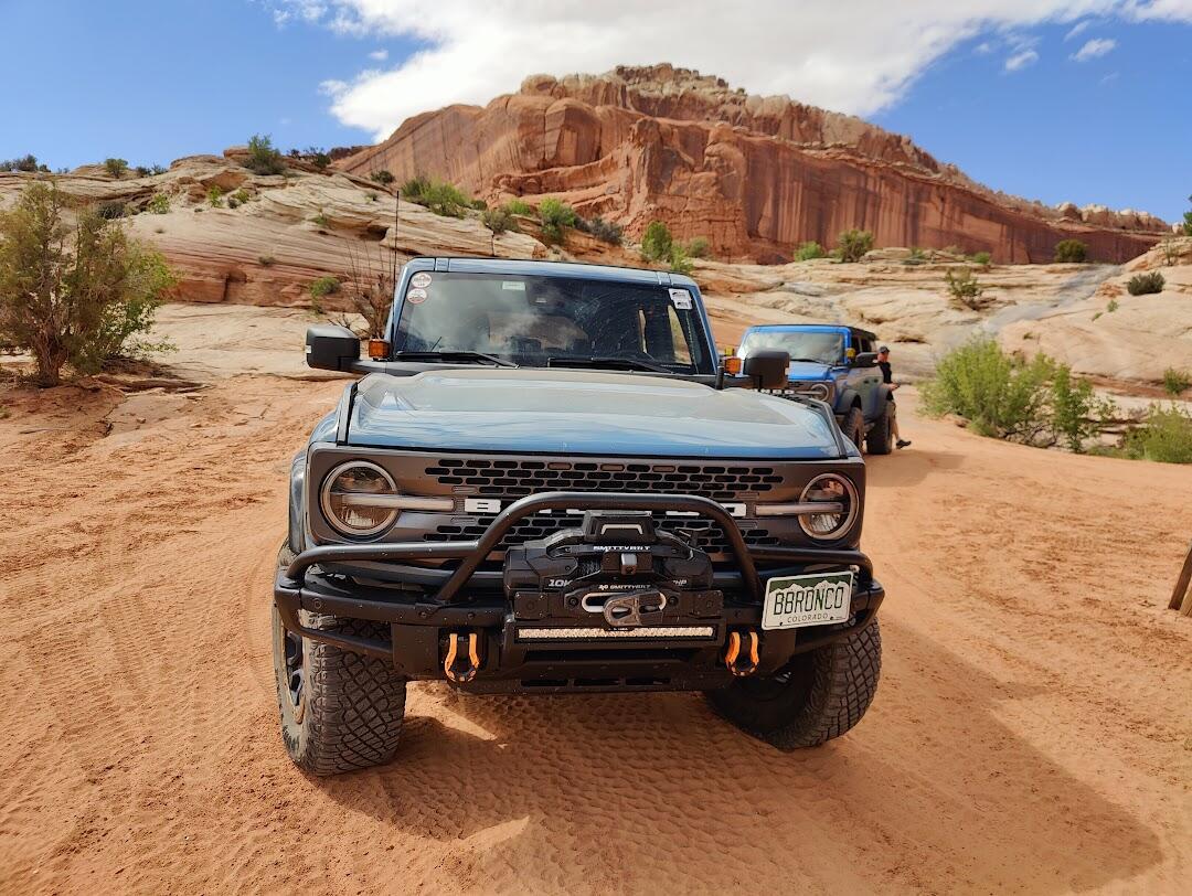

Did you end up doing the pre runner with the winch mount?
Yeah I ran JCR's with it for 2 years.
Ford Bronco Modular Bumper Winch Mounts 1722116072931-x3
Last month I switched over to 4WP front bumpers and winch plate.
