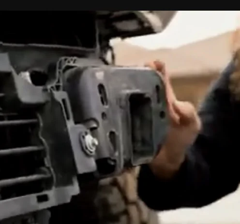

… it’s more than that
These are DV8 people same as bumper. Their design removes the horse shoe backing that ford used to hold there basic bumpers. Then turned the bolts 180* through the horn flange, into six clip-on nuts…

I try not to post off topic, the OP did post the Matt’s recovery video… and

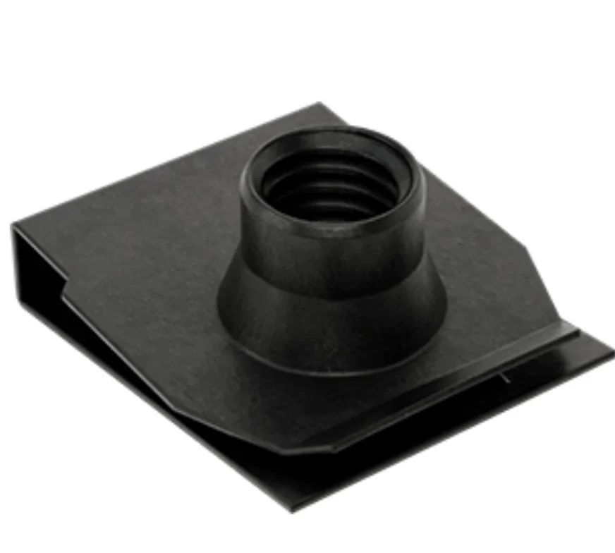

Speed nuts can

They want you to run a winch using speed nuts to bolt it to the frame.
Now, that doesn't have anything to do with the frame horns really - other than they don't use any reinforcement on there, like most of the other aftermarket bumpers. But I've never seen one actually try to use speed nuts and then tell you you can winch from it. I guess it has a Red R on it so that makes it ok. Maybe they are using special high-strength speed nuts and not just something zinc-plated from the Ace Hardware bin... but I kinda doubt it.

As long as they use the right loctite the strength of the fasteners is irrelevant. Doing things the easy way is the right way, every of the way. All the way.
