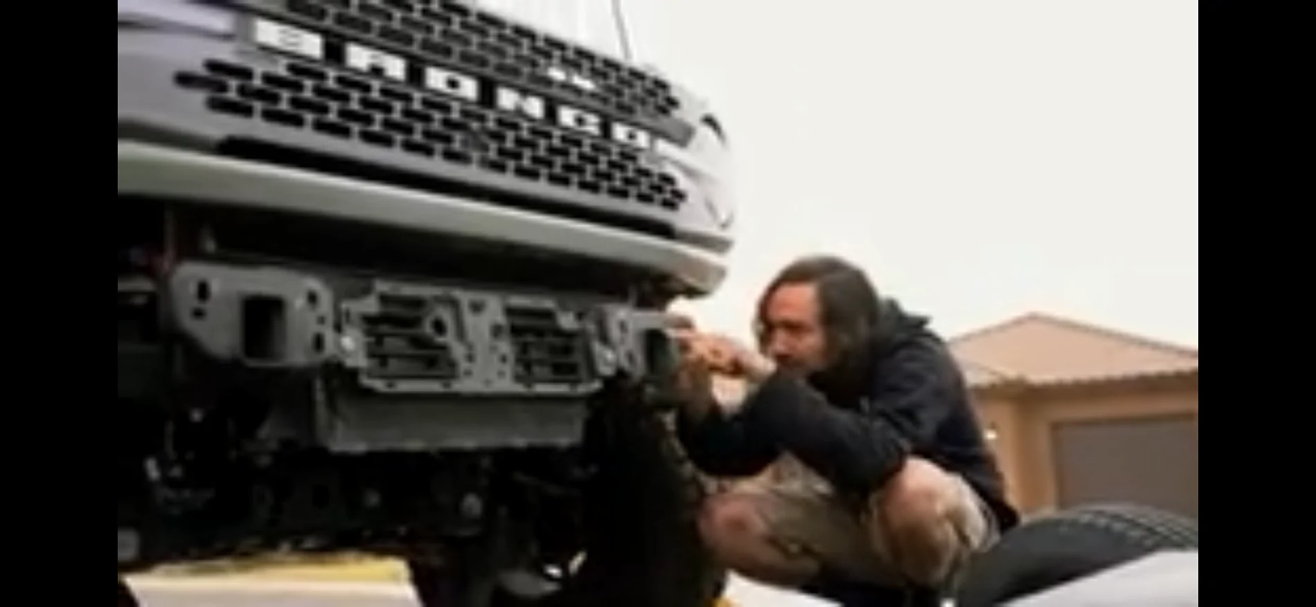

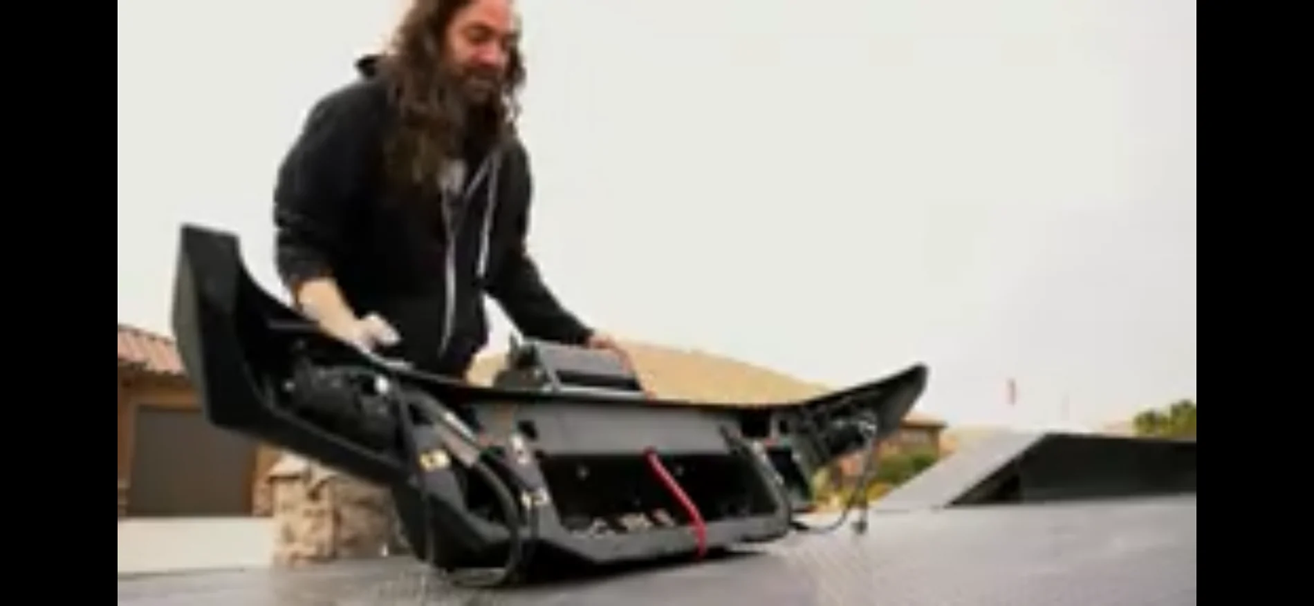

… topic is lockers BUT
The recovery guys didn’t like the aftermarket bumper (brand that is supposed to be a good one) or winch (brand ?)…
Set the tow rope to the A-Frames
Raises questions about having good connections between frame and bumper…
Getting towed out will happen more often than losing a locker
Because they've been burned in the past.
Yes… I saw that video, few aftermarket bumpers companies do what ford did in testing and reinforcement.
That one might be well built but six clip-on nuts.. holding it on the bronco is NUTS And no extra reinforcements is nuts too
The stock frame horns bend so much with the slightest force. Reinforcement is definitely needed.
