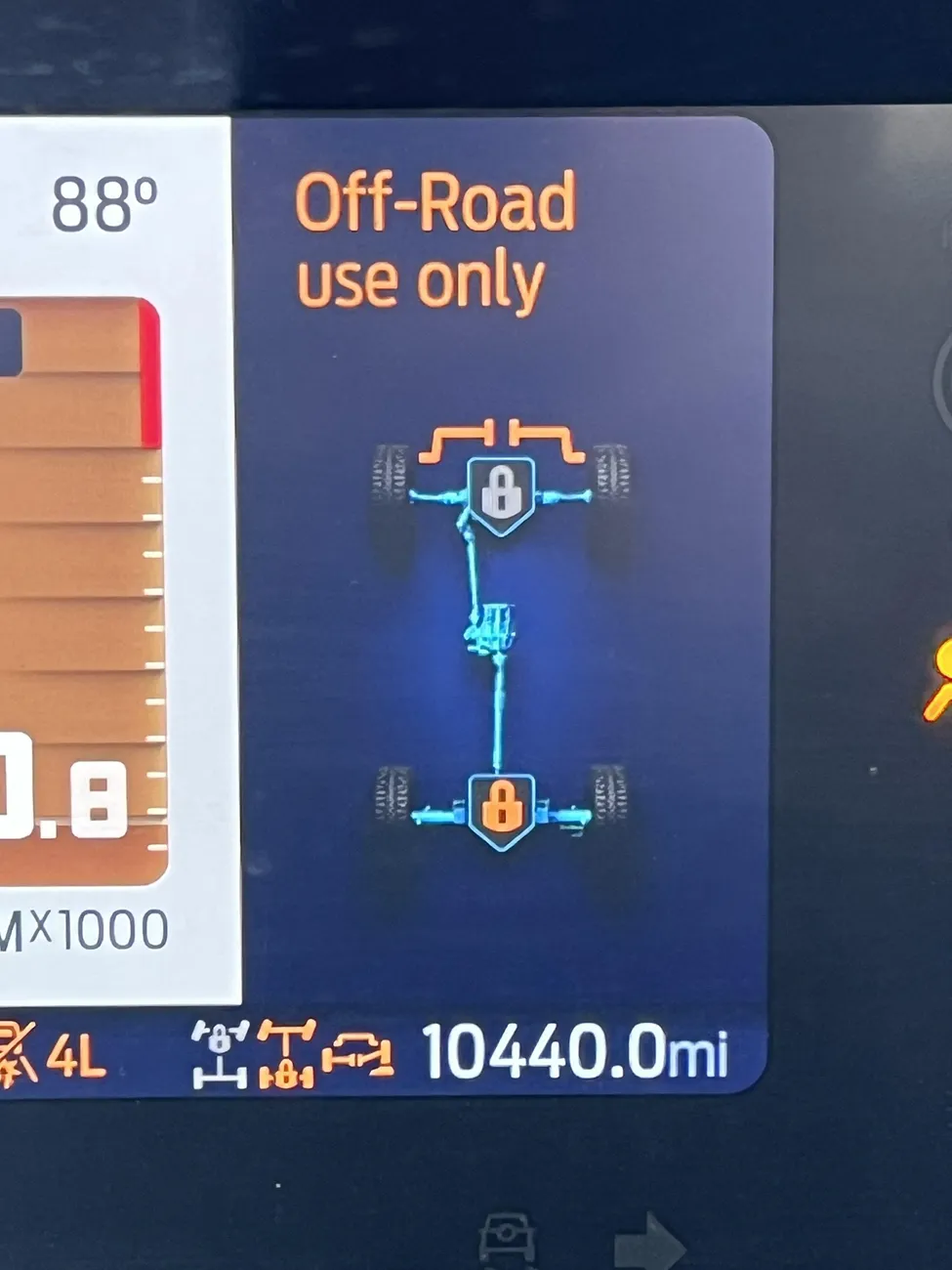

This is how I could tell my front locker was not engaging, even though the Hero button on top of dash was glowing yellow. It did not "brick" my Bronco, as I was able to continue my trail ride in 4Lo, just knew my locker wasn't going to be there.
An image reflecting my previous response. Thank you sa’ar 🙏🏼🙏🏼
