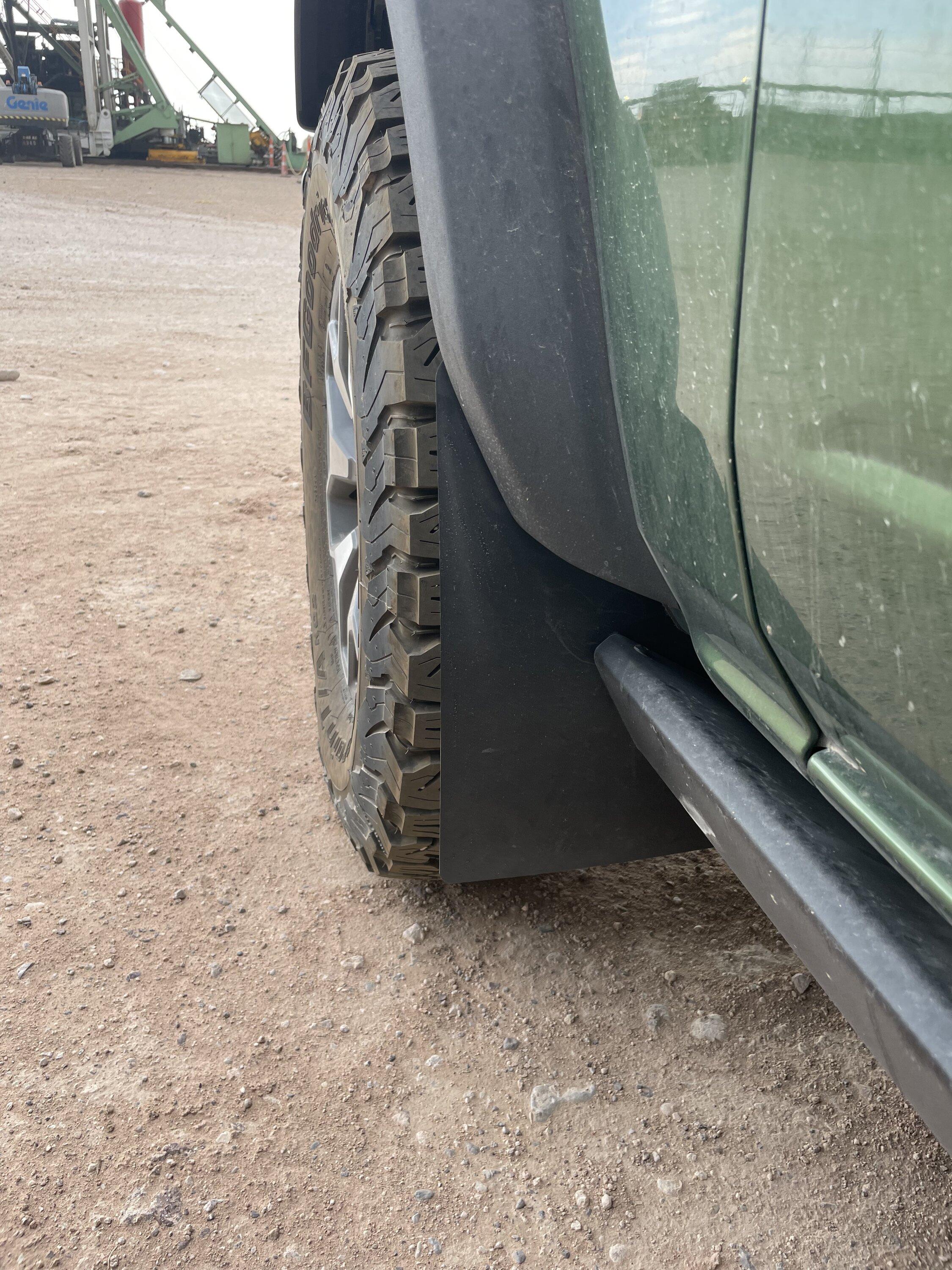

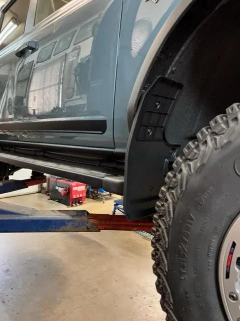

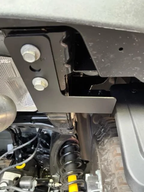

We want to protect the paint from rocks and only think I need fronts. THESE are Awesome. I’m putting ladders instead of step sides for my toddlers :geek: and think simple is the way to go. My question is will they hold up to mud splashing and gravel roads and are they fastened to more spots other the the crash bar which a Wildtrak doesn’t have?
Thanks BTW.
I haven’t installed rear yet. Had to leave for work so I just quickly mounted them. I wanted the fronts on to protect the body from rocks on the ranch roads. I’m going to add some more support and install rear on days off.

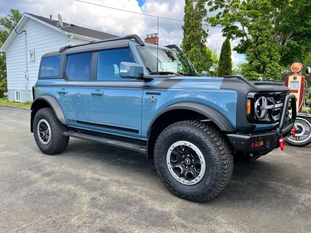

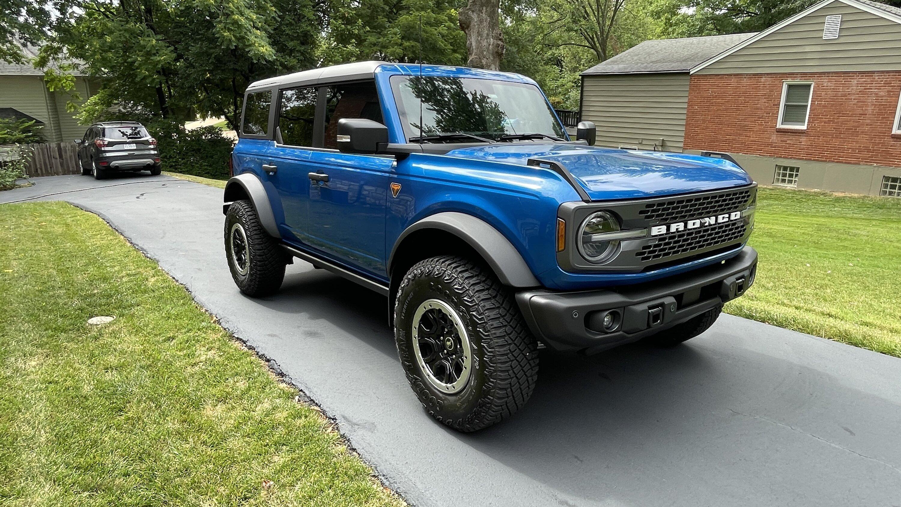

Do you think these will work with a 1 inch wheel spacer on stock Sasquatch wheels/tires? Looks like they may rub when fully turned.

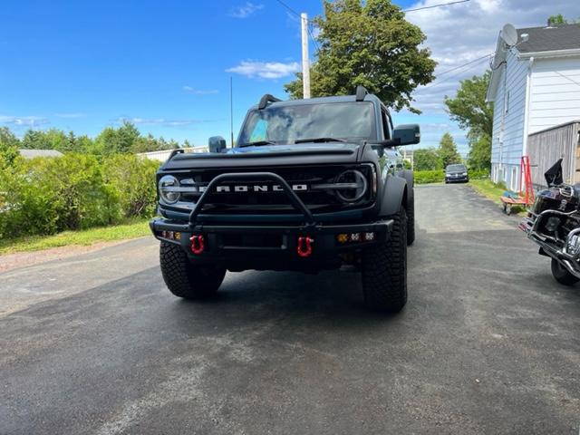

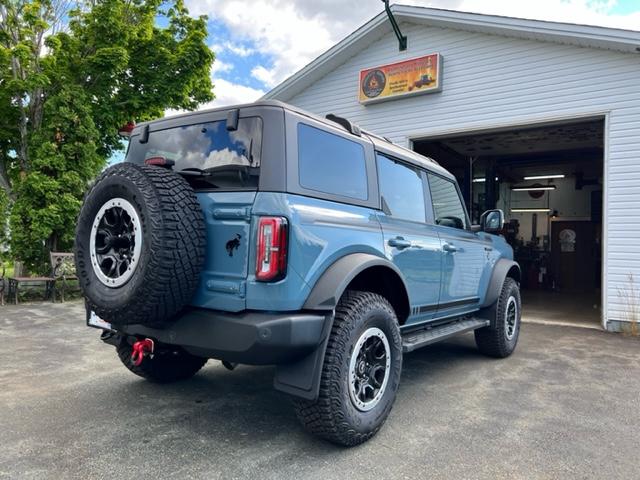

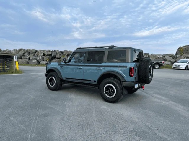

I installed the fronts on my Badlands | SAS with 1.25" BORA spacers installed. I got a little rubbing when backing out of a driveway and turning. The tire was catching the part that juts in and around the crash bar that is not there. So, I removed them and sliced off half the thickness of that gusset, only where it juts in and out. No more rubbing and I am 100% satisfied with the way these look.

Awesome - and greatly appreciate the reply. Kind of wish I had keep the 1.25 spacer. Yours looks great.

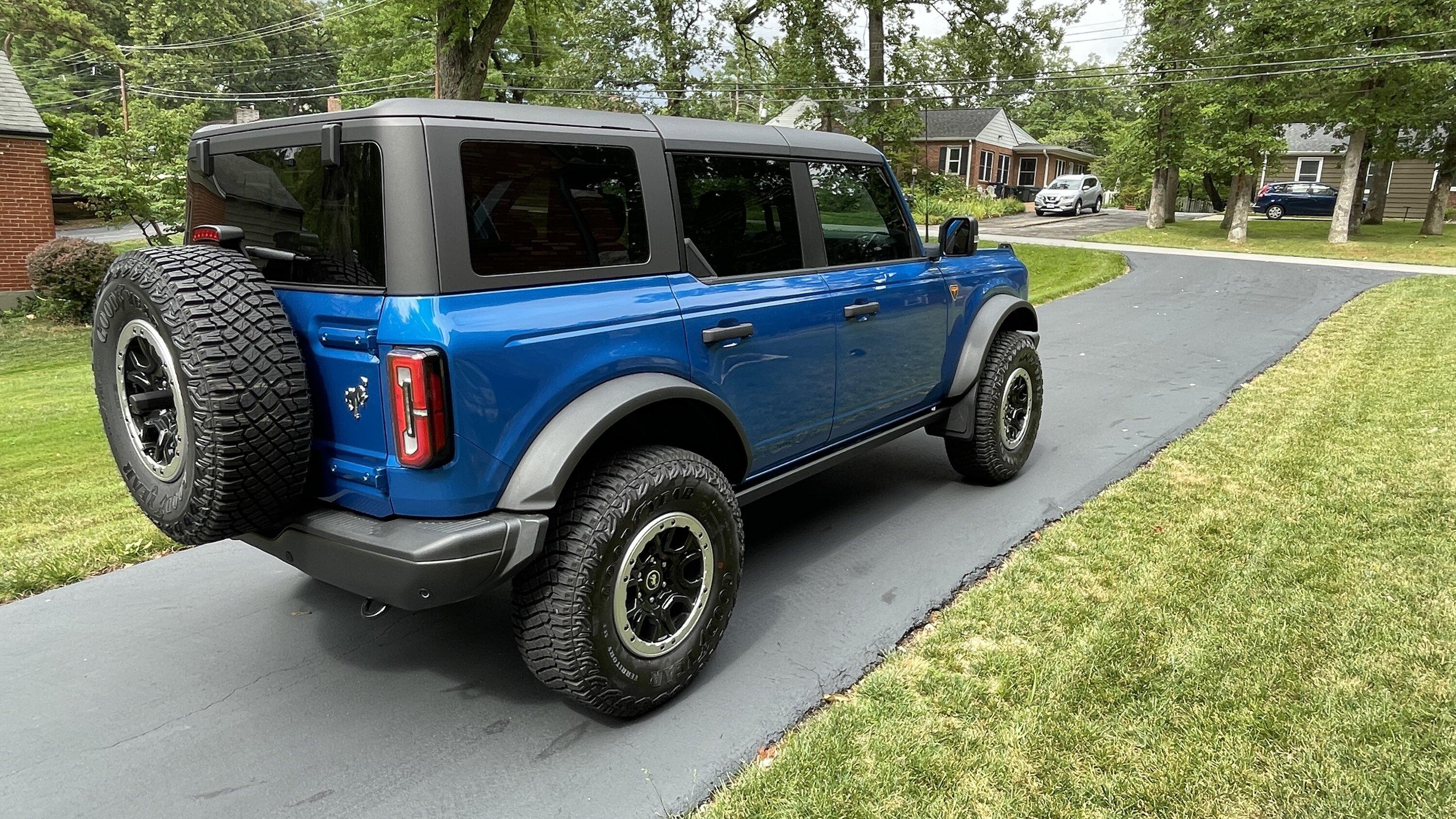

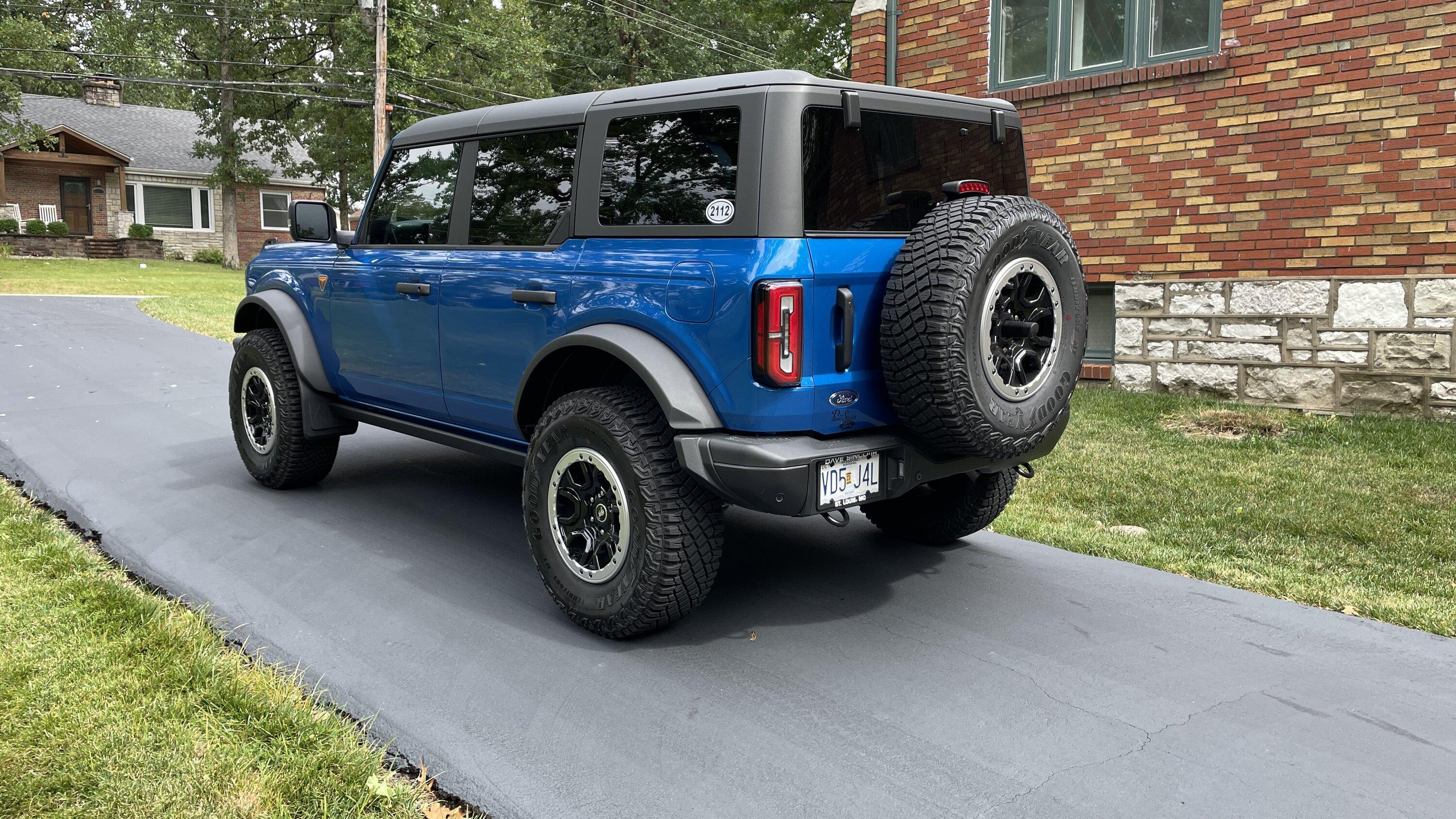

I initially feared I had overdone it with the 1.25" spacers and was wishing I'd gone with 1". They have grown on me. Plus, I'm splitting hairs at this point. The 0.25" difference must be virtually indistinguishable.

Good point - not really much difference but the stance is much better than factor. Wheel wheels needed to be filled….I guess it was the originally computer generated pics they sent when ordering that got that stuck in my head. Anyway, yours looks great. Thanks again.

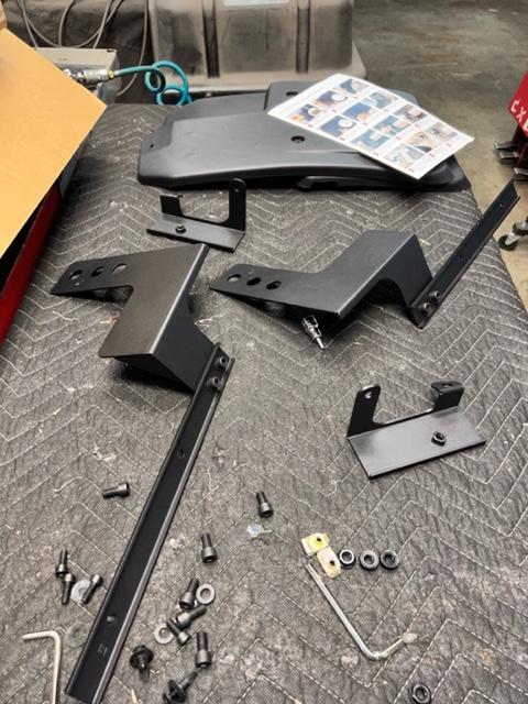

I'm putting them on, and every hole is like a TINY bit off and its making it SUCH a pain in the ass. Doable but a struggle lol

I didn’t bother it. Love the flaps other than the Alan bolts rusting.

I just finished installing them, I will say i had to shave some of the fender lining off otherwise the holes were never going to allign.

I never had to shave anything but the Tolerances were tight for a few of the bolts. It’s a great value for what you get. I’ll be replacing all the Alan bolts this week with stainless ones. Glad you got yours on.
