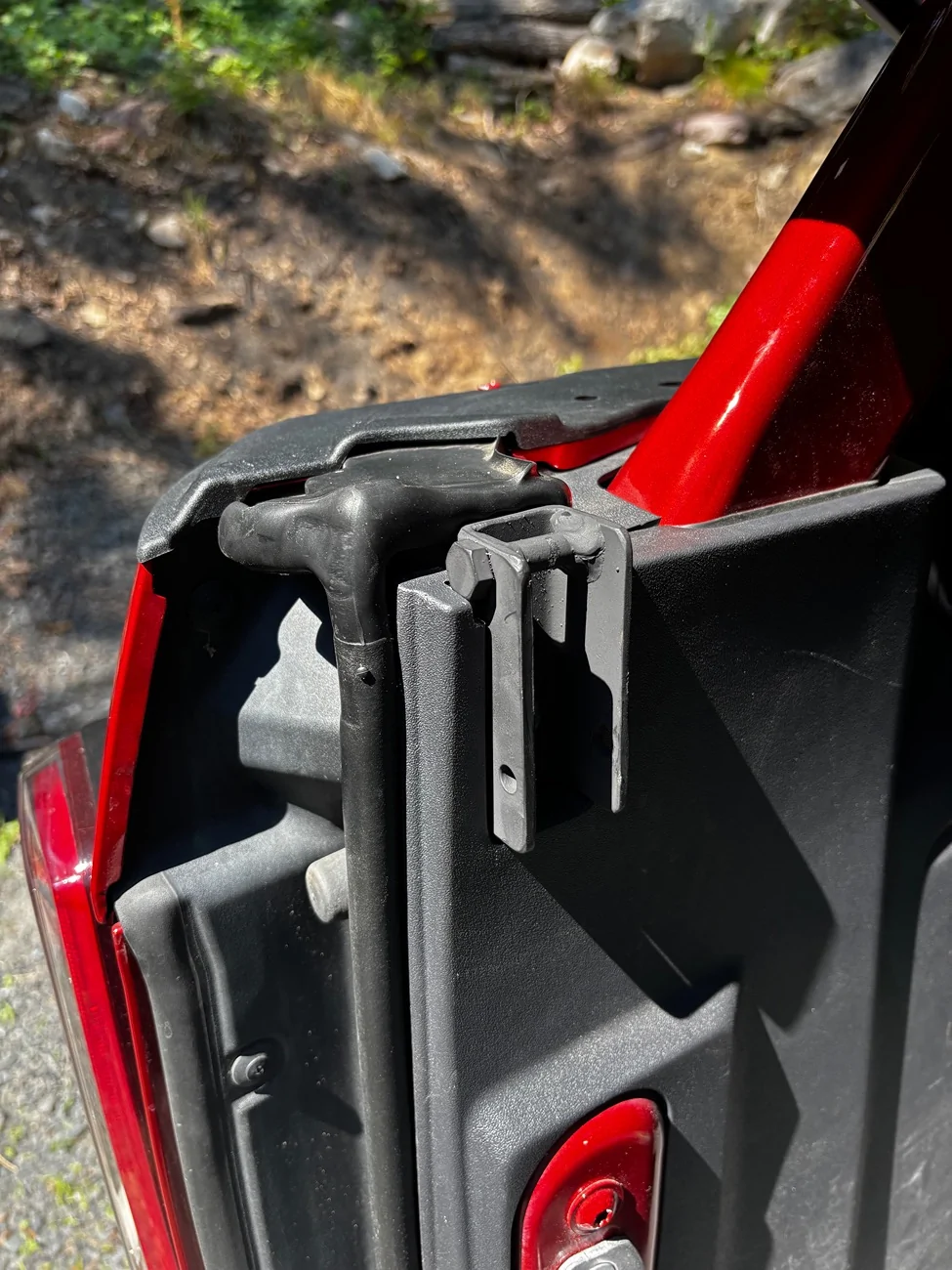

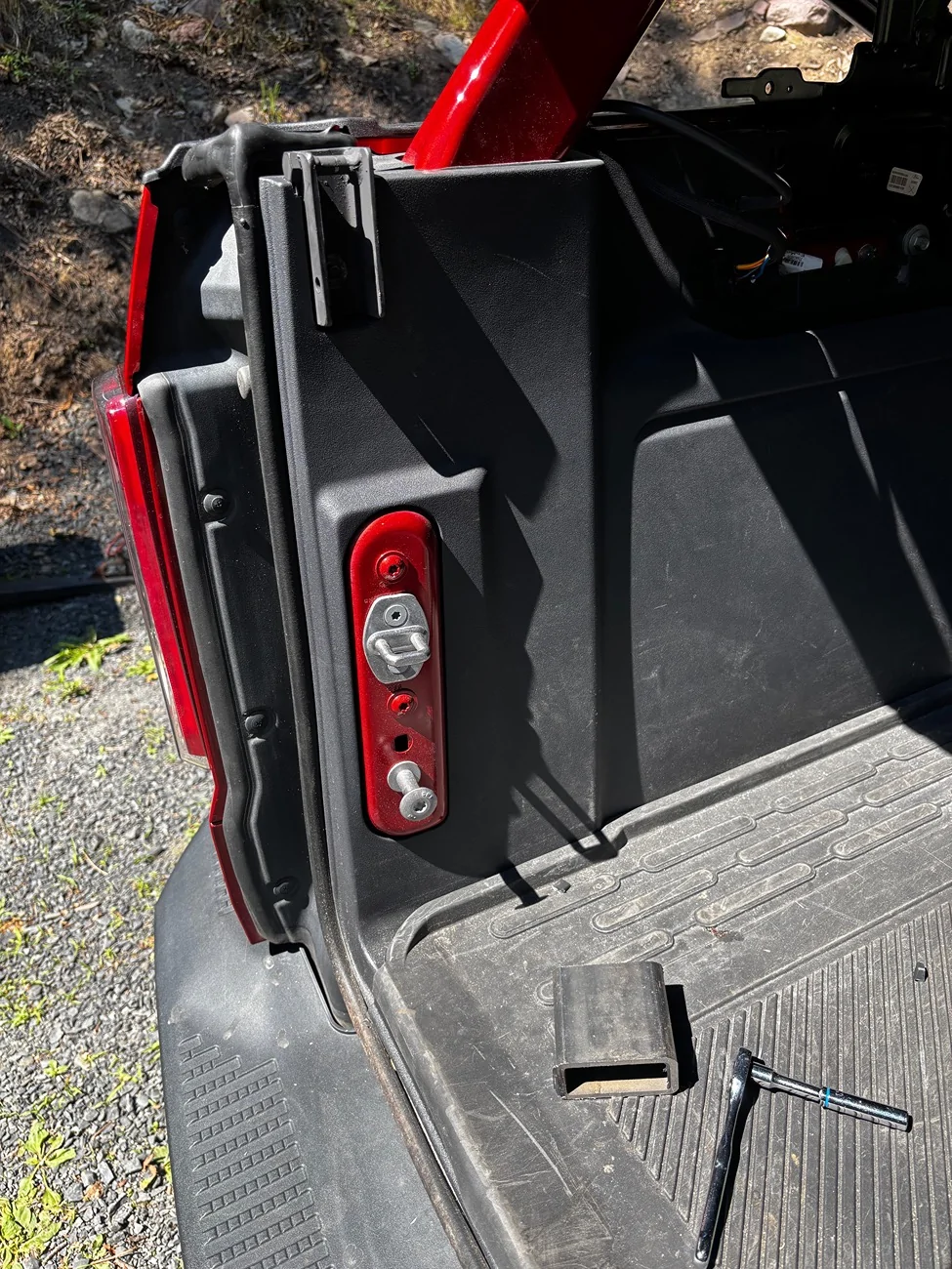

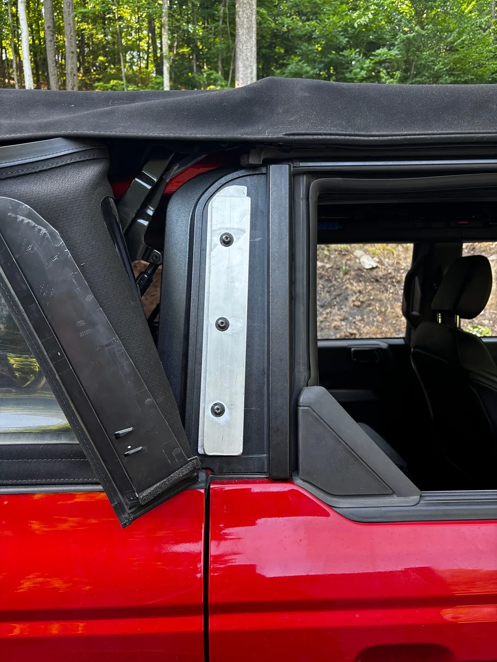

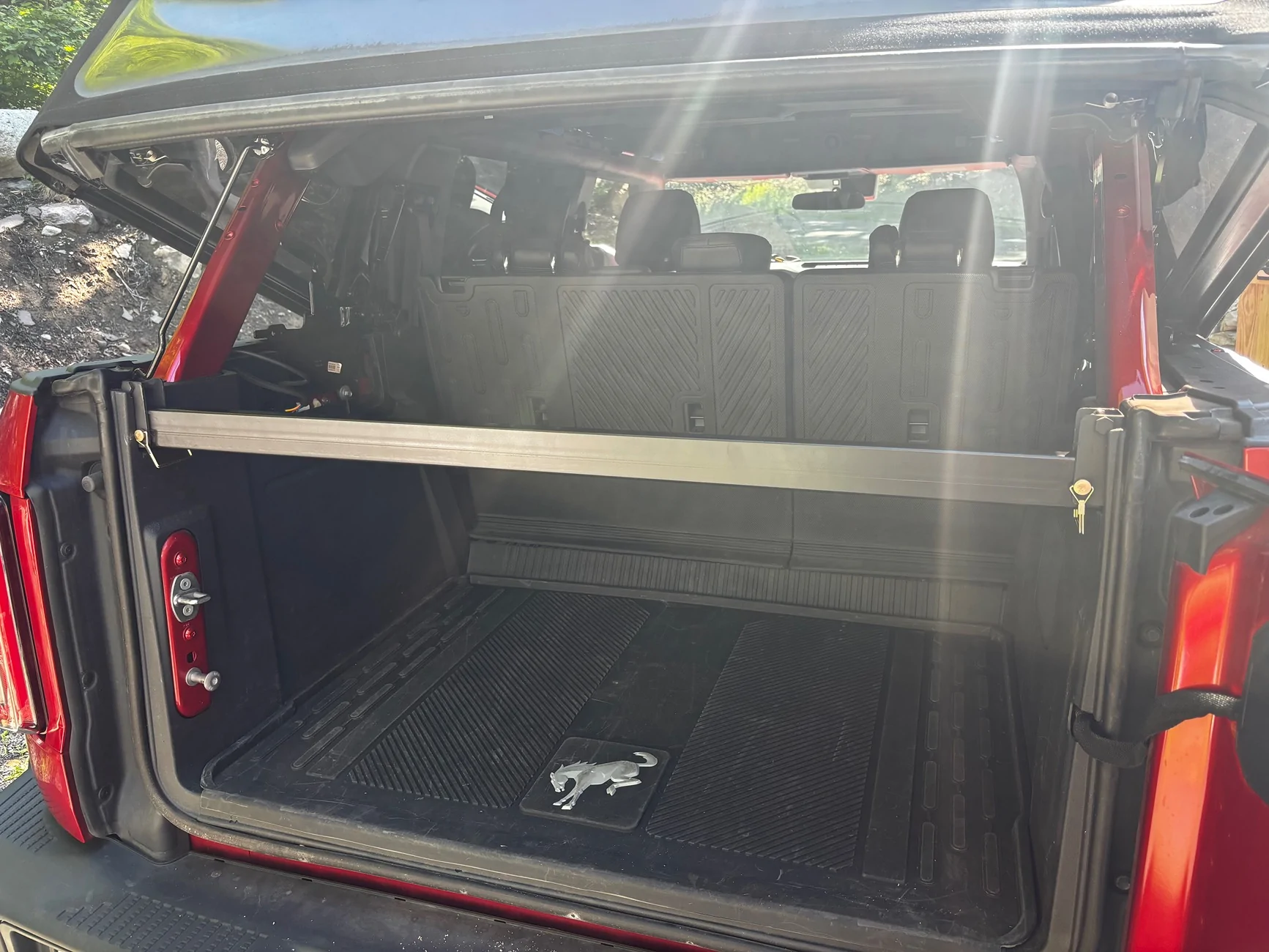

I had same problem, so I made my own also a rear support bar which helped tighten up bod noises. The cost of all the brackets combined is 1400.00 from ford..
I was wondering why you added the support bar. In your other standalone post, you didn't mention the reason for the support bar, and I thought I was missing a bar myself. LOL I remember on my '22 Jeep JL there was a support bar. Nice work! The stealerships are out of their minds for charging that much for brackets.
