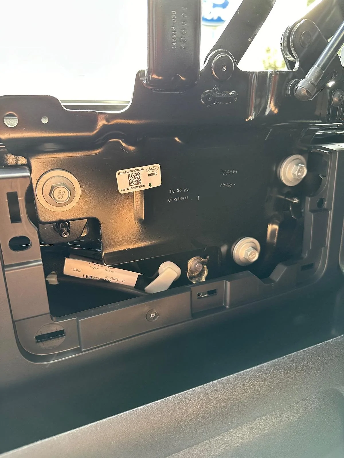

Ford Bronco Soft top install instructions? IMG_5539
Deninitly get a plastic roll bar protector, and 2 people. It's heavy and awkward. 2 alignment pins in the pic above on the left and right line things up. And you screw in the 3 screws. Don't screw them in all the way. Close the top (very tight). Latch the front then tighten the screws.
Also make sure you receivd the 2 plastic b-pillar inserts before starting. Held on by the 3 screws in the piller.
I also got the iag ezlift, much easier to close with 1 person.
I did this 2 weeks ago, so let me know if you have any questions.
