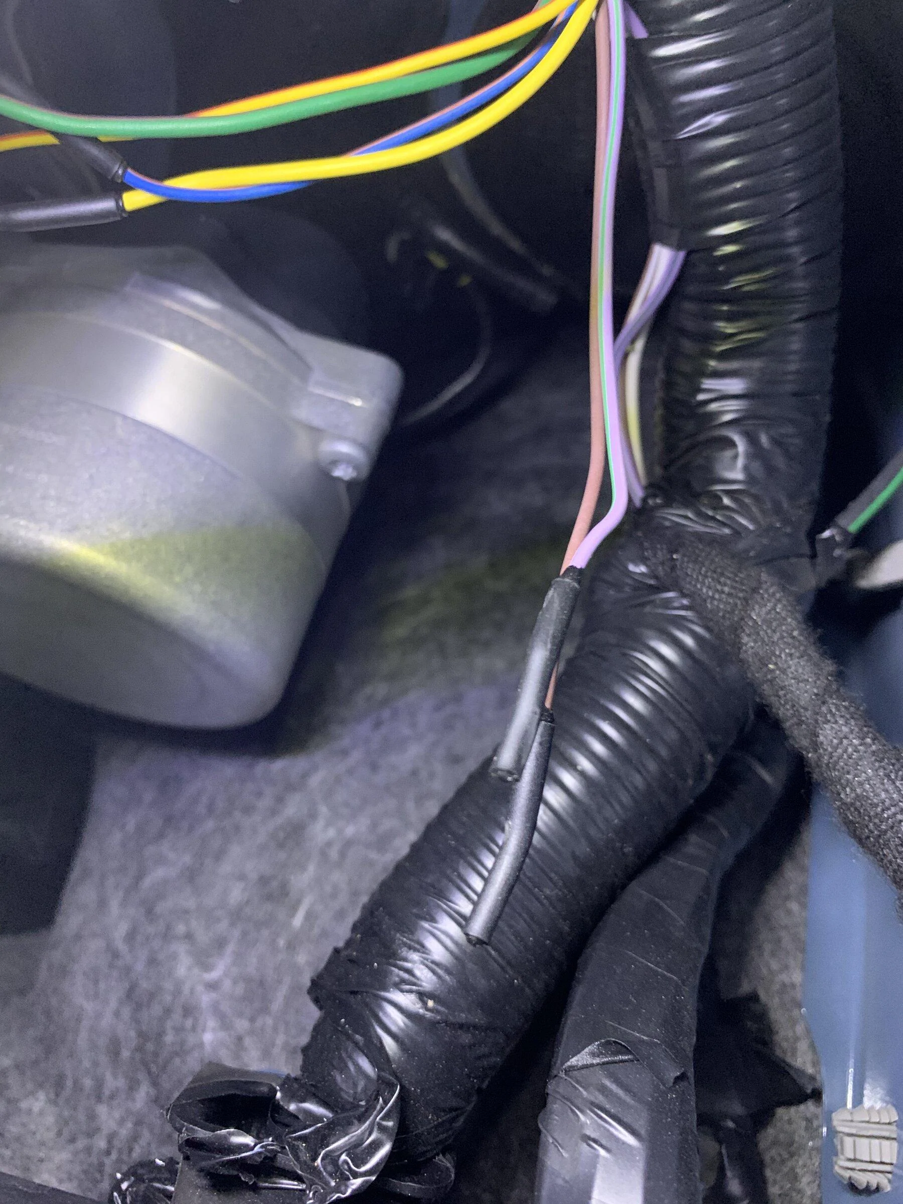

While installing the Baja Design Pocket Fog Kit, I lost the connector clamp where you connect the harness to the Bronco wires.
Can someone recommend a small pack of these from Amazon I can use as a replacement? Or even better if I can pickup locally, e.g., Auto Zone, Advance Auto or O’Reilly Auto Parts.
Pic below of where I’m connecting.

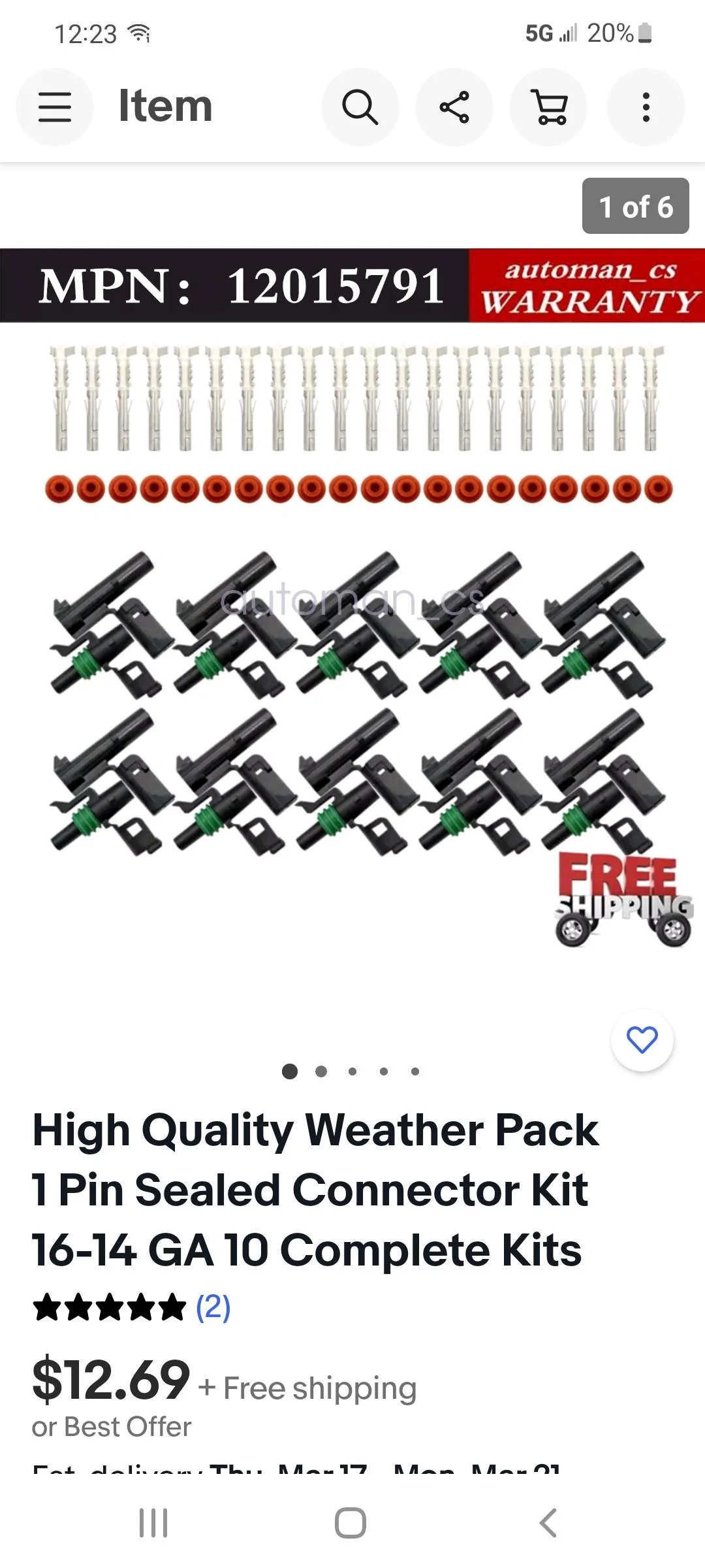

Probably not as fast as you would want but I bought mine on ebay and you can get single pin and can order small amounts.

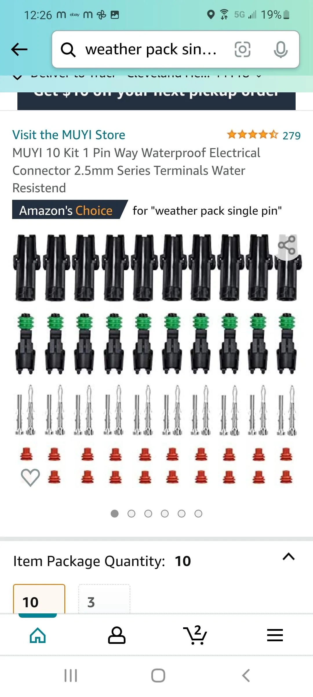

Or Amazon.

Amazon has weather pack connectors and pins/barrels but can be a bit more than other sources. Quick ship v price. I went the eBay route since no rush.

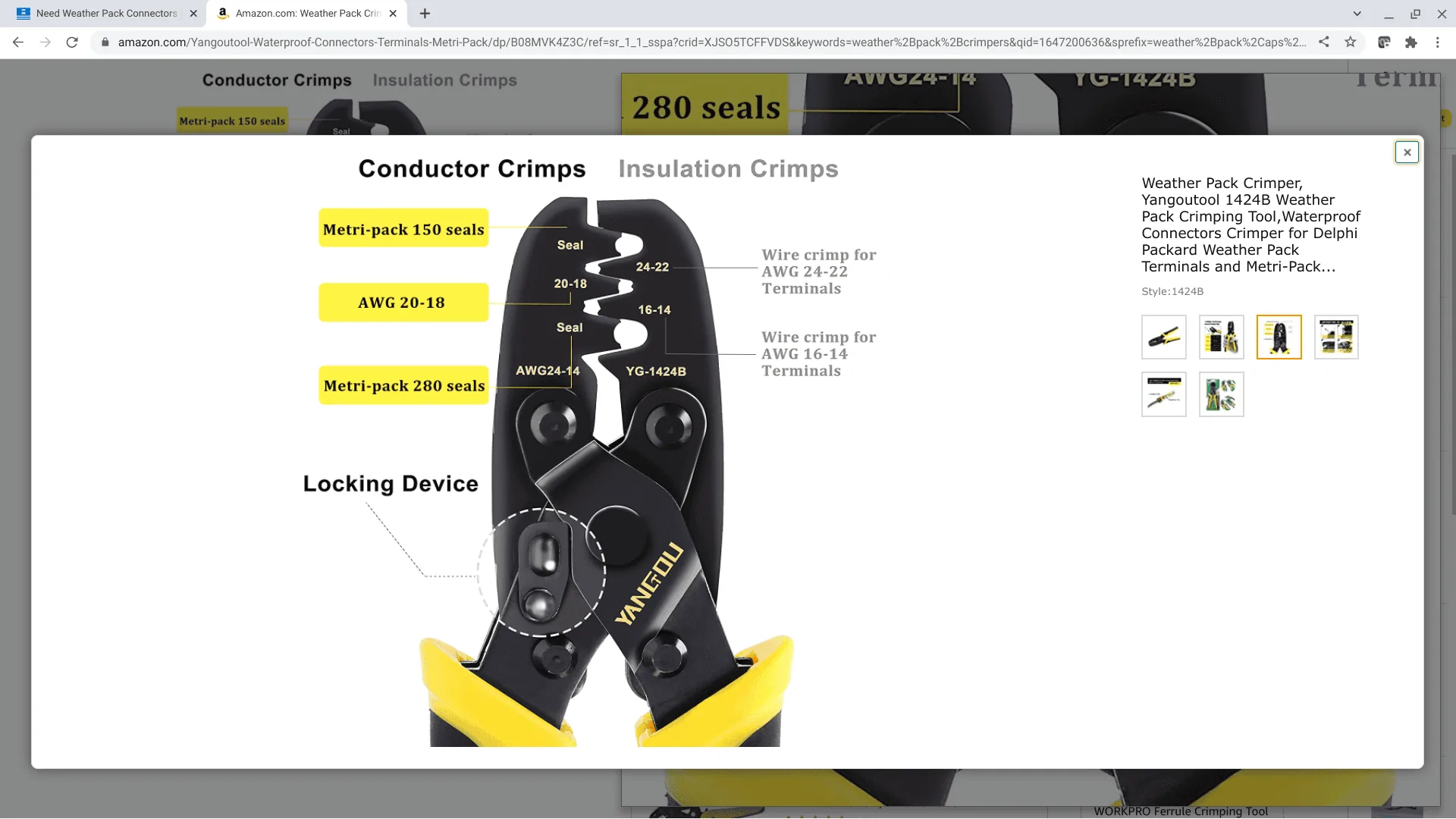

What’s the correct crimping tool for these types of pins? The few times I’ve used them I just crimp with my needle nose lol.
Something like this. Just search for Weather Pack crimper.
This particular style works really well and takes the guessing out the process. It crimps the wire part and weather seal in one action. Also make sure you get a good quality terminal removal tool. I brought a cheap one and it broke within a couple uses and then had to go buy one at my local auto zone store. The good one was made by Lisle and it allowed for removal of both male and female terminals. See below
