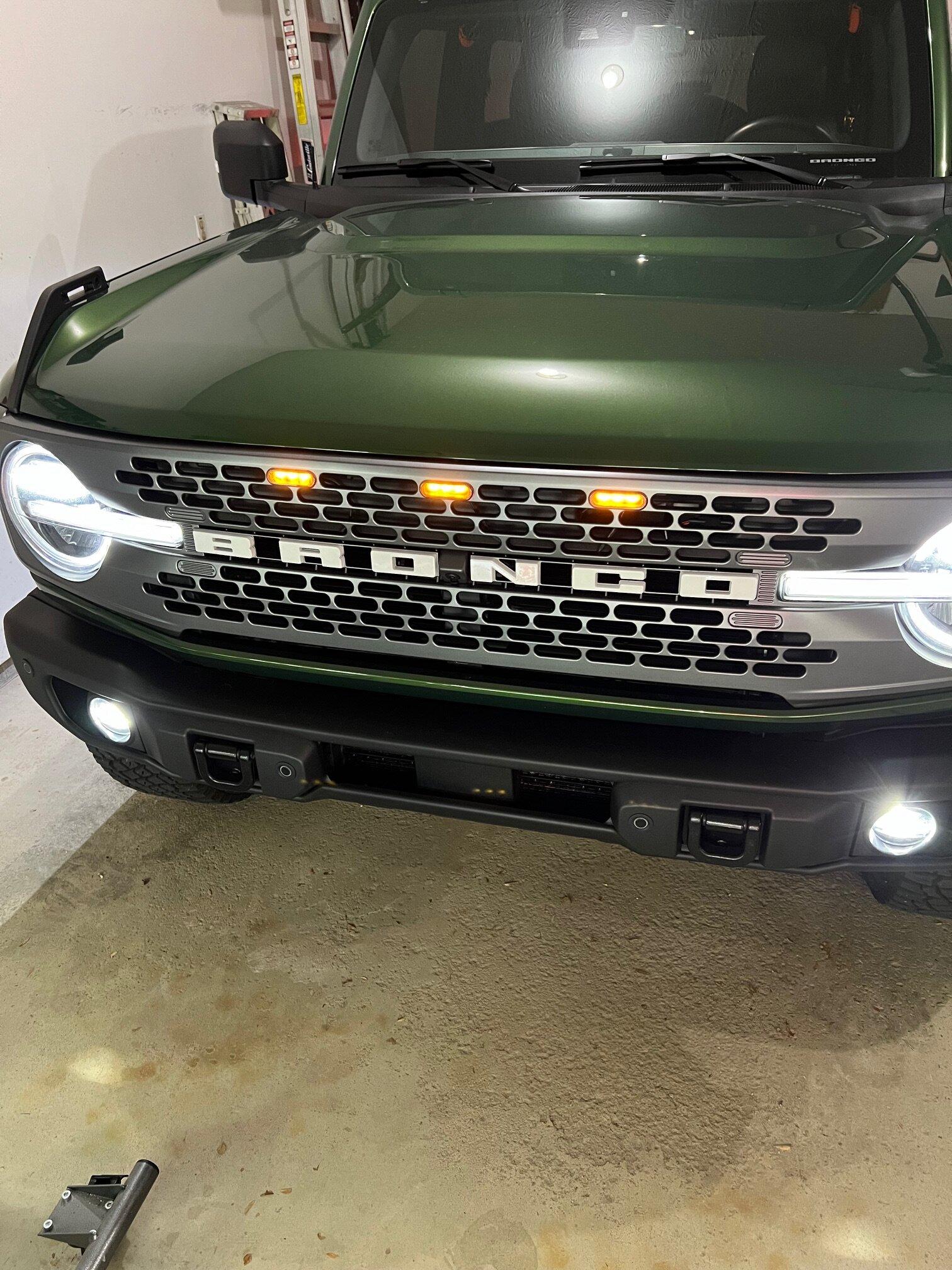

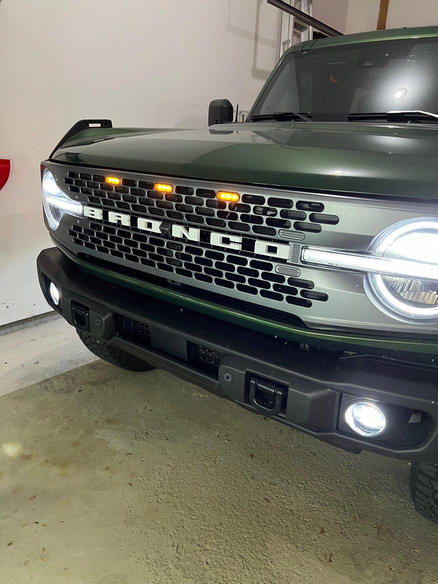

Delivered a few days ago, finally got around to installing them. Pretty straightforward install. Needs instructions for complete newbies. The badlands grill has a plastic piece on the back of the grill that's held in by 6-8 bolts, plus a couple of bolts that holds the front camera in. Also, I didn't end up using the included extension cable.

Yep. So we are shooting an install video today. So we will have that up soon. We just didn't want to hold anyone up that wanted a head start.
As far as the extension cable. Don't throw that out.
So that comes with all of our headlight adapters and what it is used for is to carry the parking light/running light power up to the switch area. So you can power amber or other backlights for your light bars, fog lights, A-Pillars, etc.
The reason we made it break/stop on the grille area was so you could add the grille lights at a later date (which is now) on the way up.
So if you add other lights with backlights. You will need your extension and then just a 2 way splitter to split right there where you have your grille lights plugged in.
