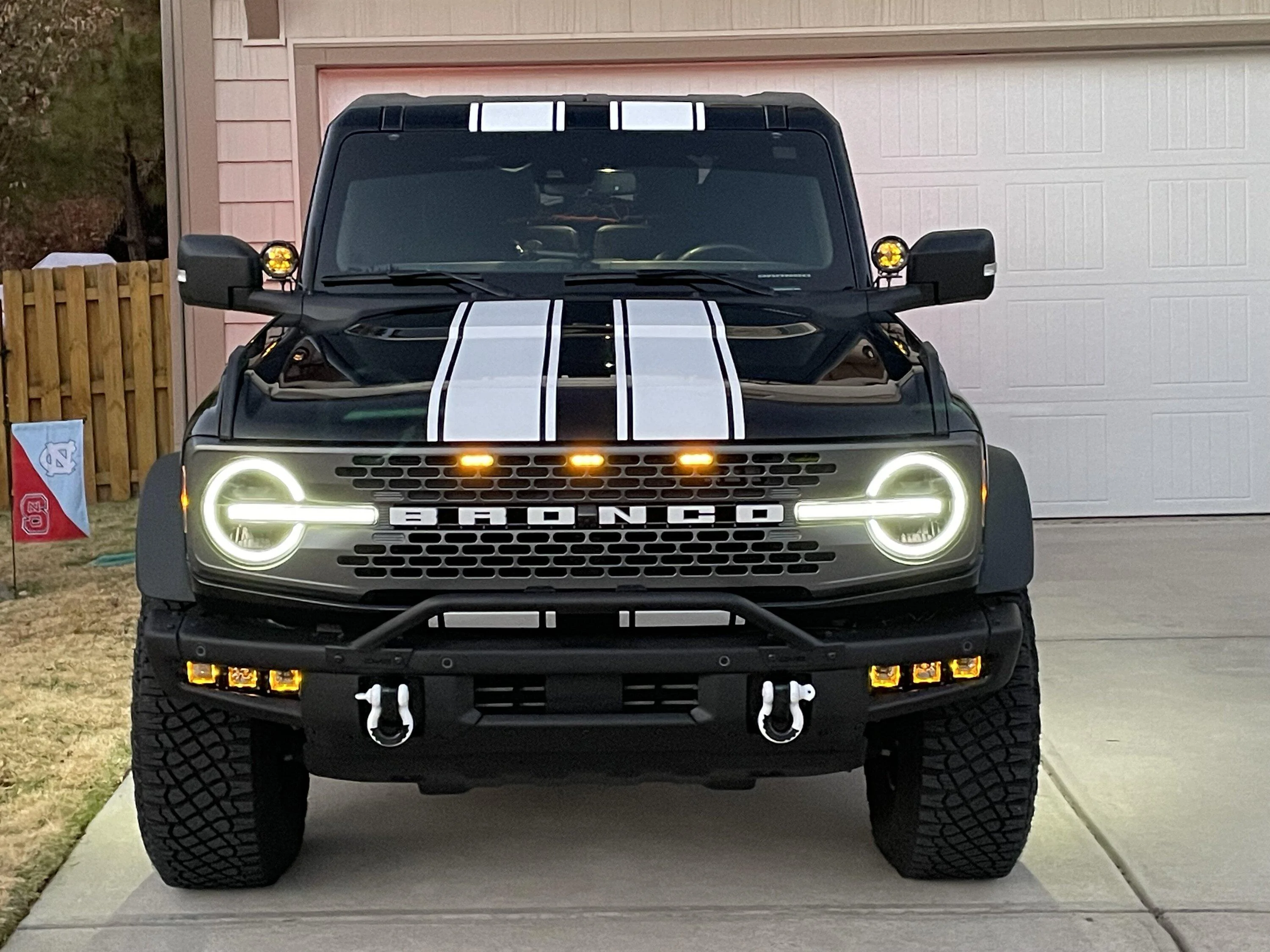

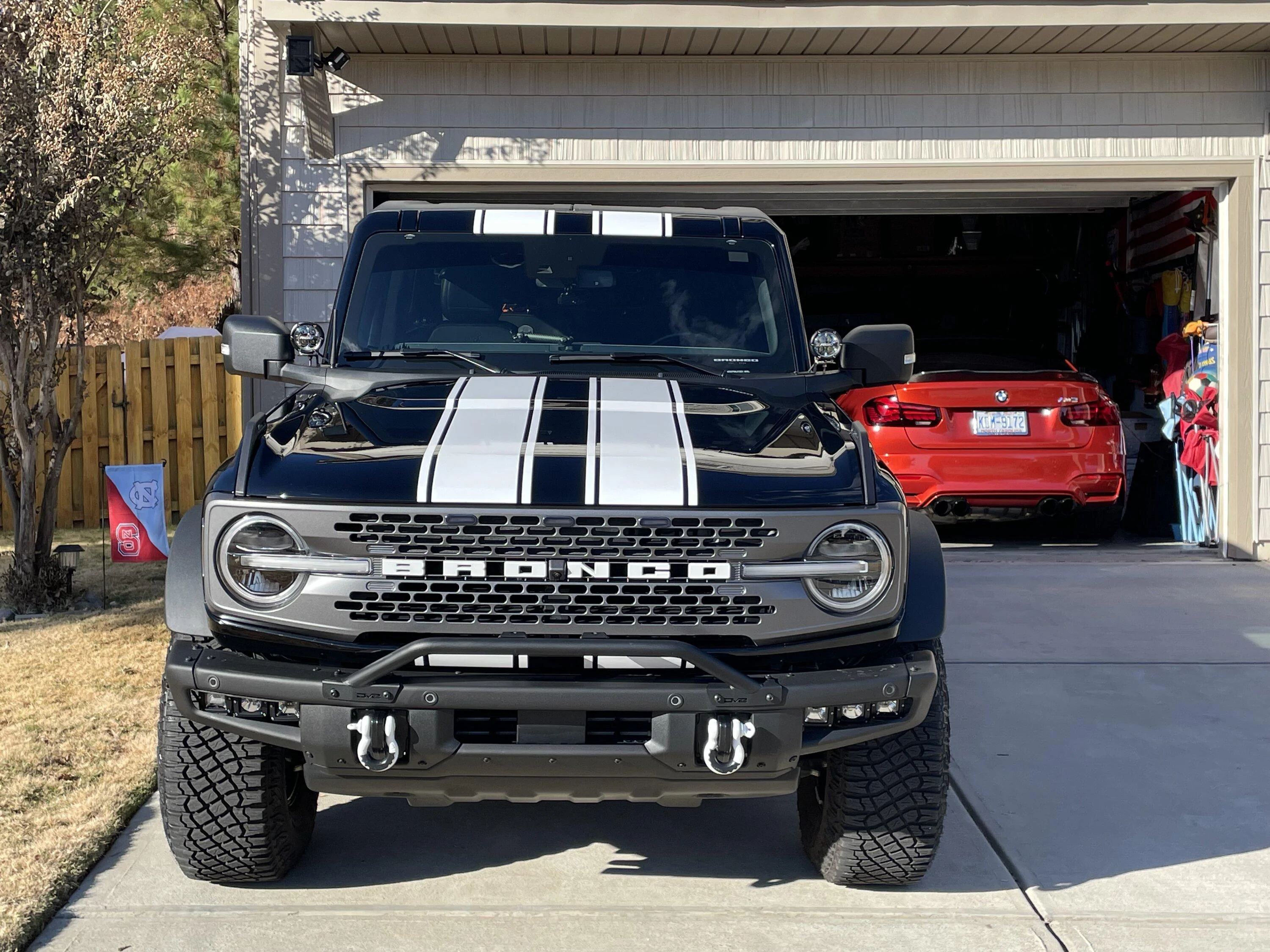

Install wasn’t too horrible, had to take grill off then the black back plastic behind the grill on the Badlands Pkg to get the lights in (small screws behind the grill). Easy plug and play with the existing light harness from SPV from the Rigid light set-up. I’m still thinking about ordering the SPV rear lights…
Ford Bronco New Product Announcement - SPV SMOKED Grille Marker Lights... IMG_1702
Lights off and lights on!
Ford Bronco New Product Announcement - SPV SMOKED Grille Marker Lights... IMG_1703

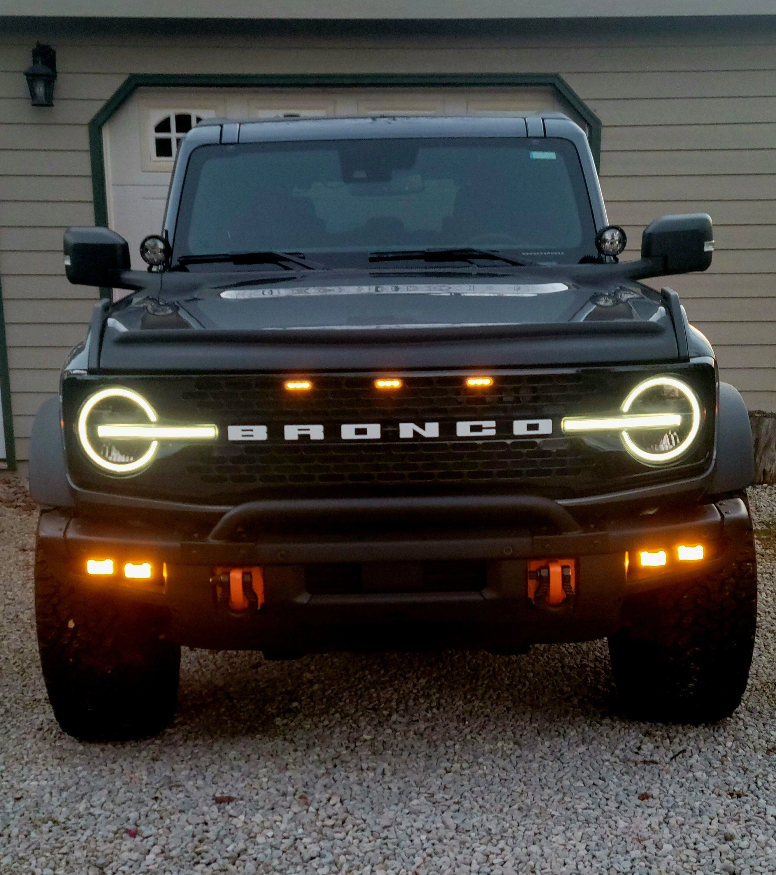

Have seen installed a couple different location on badlands grill. Seen with two hole or three hole spacing from center. What you think? Easy install, Lights look great.
Ford Bronco New Product Announcement - SPV SMOKED Grille Marker Lights... IMG_2134
Looks great on there!!
That's a GREAT looking Bronco! Love the stripes!

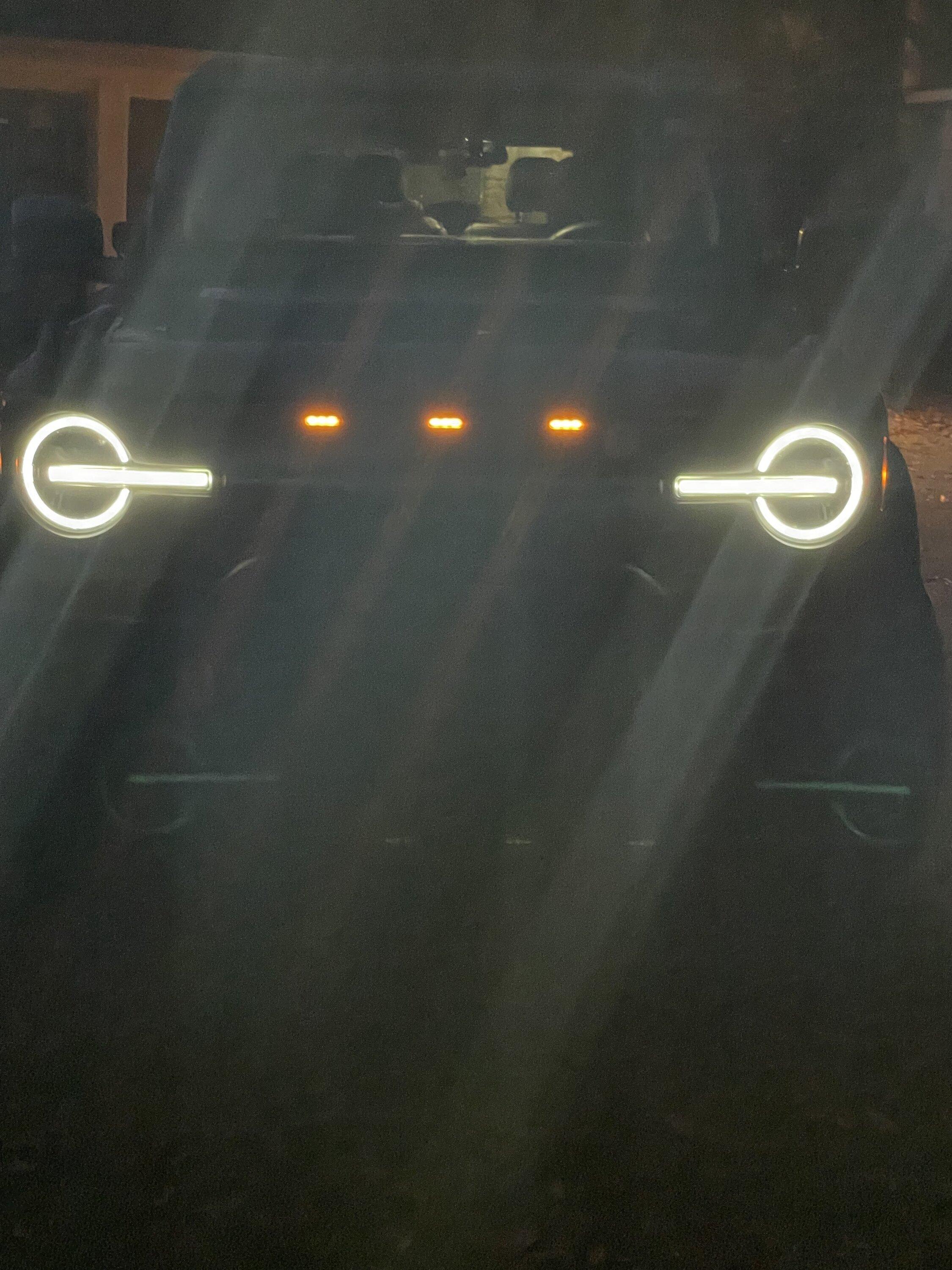

As usual a great product from SPV Speciality Performance. Easy plug and play, installed with the headlight adapter. Highly recommended. Tried to take a pic a night but had some glare.
AWESOME. Looks good! I am glad you are happy!

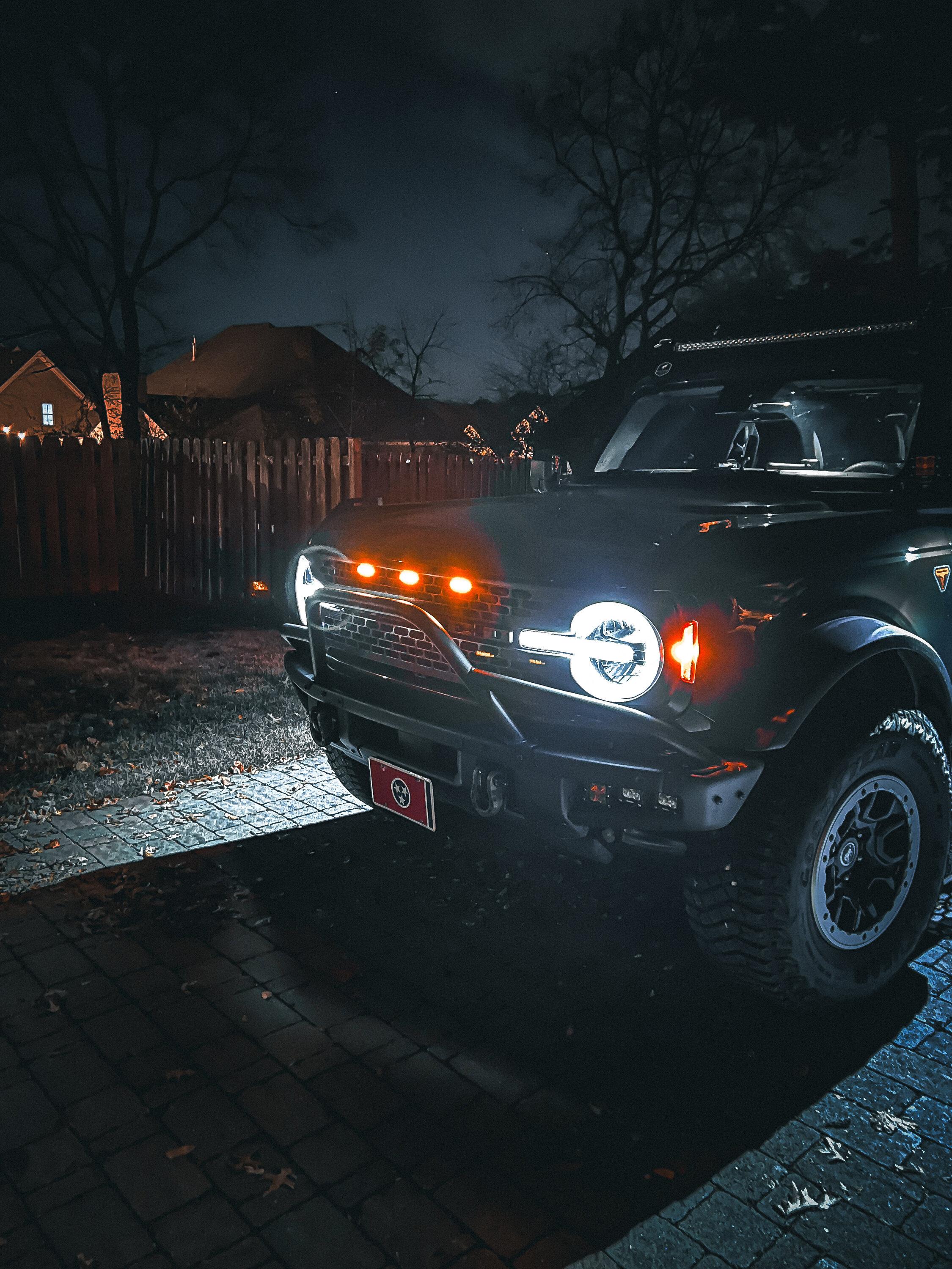

Another installed on a Badlands w Lux. Extra step to remove the prerunner bar on the bumper to remove the grill. My big hands were challenged in accessing the headlight harness plug beneath the airbox to put that in, but the kit is great. Plug and play all the way.

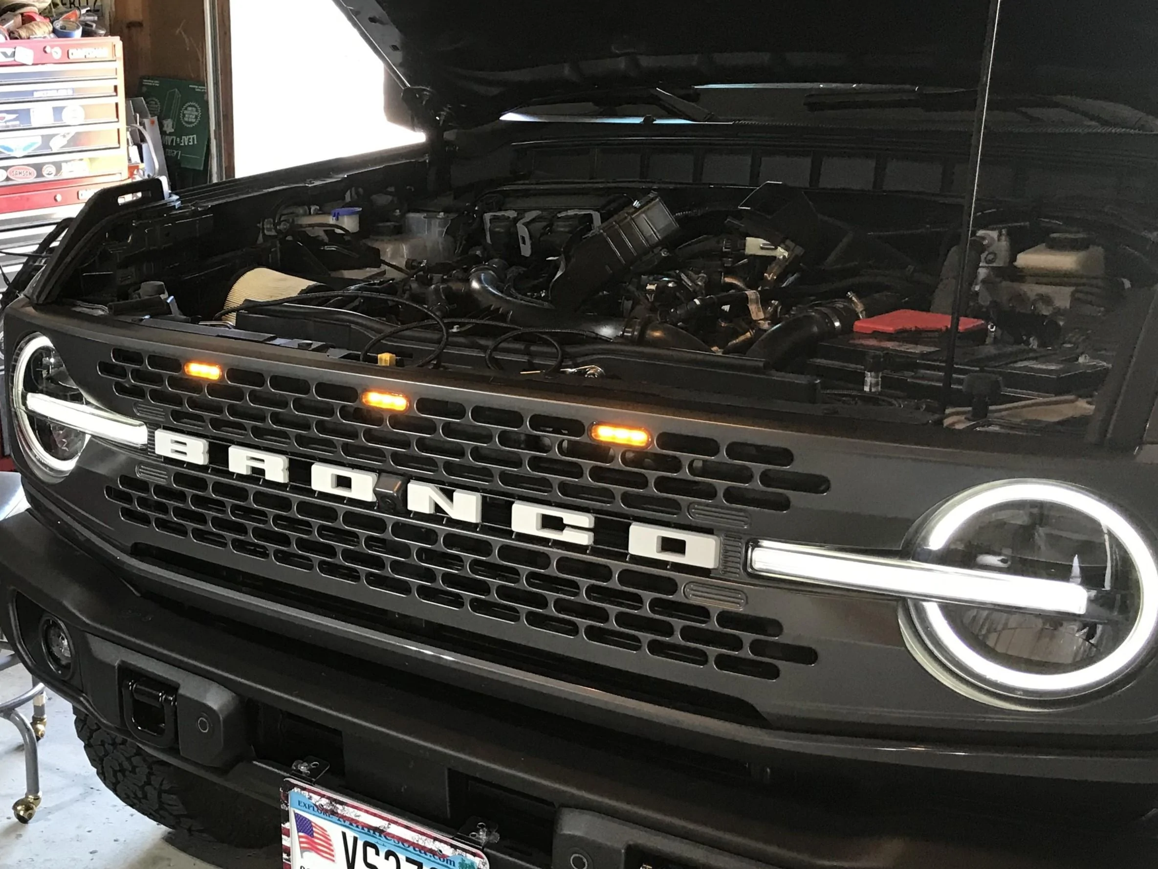

Received my order earlier this week and installed today. As @Black Stallion mentioned I had to also remove the black backing plate on my Wildtrak grill to access the top grill holes. Did not have the light harness from SPV for the Rigid light set-up so ordered mine with the headlight adapter plug. Pretty straight forward but did take some time to use electrical tape to cover the ends of some of the 3 light connectors which showed about 3/4 to 1/2 inch of red/black or white/black wires so they were less noticeable behind the grill. Note that it was about 40 degrees today and the plastic grill was pretty rigid. Two of the lights did not fully snap into the grill and seat all the way. Used a small screw driver to leverage the light frame so they clipped in firmly. The Marker Adapter video came in handy to move the air box out of the way to access the plug on the left headlight. Kind of a PIA to access the headlight plug but after pulling off two of the wire anchor clips next to the air box and pushing the wire down and out of the way I was able to get my big hands behind the headlight to pull apart the light connector. Couldn't find an easy ground access for the ground wire for the marker light loom on the passenger side of the grill so drilled a hole and tapped a screw into the aluminum radiator core support just in front of the air box. Everything hooked up and lights worked great! Pleased with the results!

Observation after day-time driving: the headlight circuit that powers these grille markers doesn’t get powered on when headlight switch is in “Auto” and the DRLs are on, rather than the headlights. The auto-DRLs are a lot brighter than when the headlight switch is turned to parking lights, but when in parking lights setting, the grille markers are powered. In the auto setting, the grille markers do light up when the headlights come on automatically.
