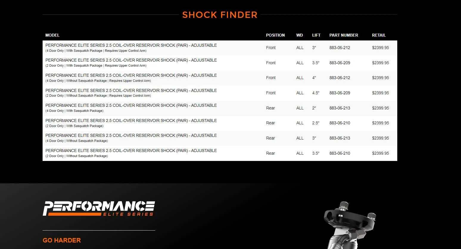

Are the Fox 2.5" Shocks height adjustable on vehicle (wheels off the ground),
Or do you have to use a spring compressor?
I know my Fox 2.0 Shocks (F150) require a spring compressor (complete uninstall / re-install required) to adjust height.
Also, it appears that Fox Specs different Part Numbers Depending on Which Set-up you have (4-Door vs. 2-door / Sas vs non Sas, see screenshot below of their website)
I am just trying to figure this stuff out. I plan on ordering new Coilovers this week for my Bronco, and want to make sure I do the research first.
I might Call Fox on Tuesday to figure out what they say about it.
We highly recommend using a spring compressor to adjust preload on an OEM fit coilover like these, especially when adding preload.
There are different part numbers yes, however the (2) fronts share the same specs and so do the rears.
Feel free to give us a call, we've been getting to know these shocks really well in the last month. 619-722-8555. We also have a bunch of these in stock with upgrade options.

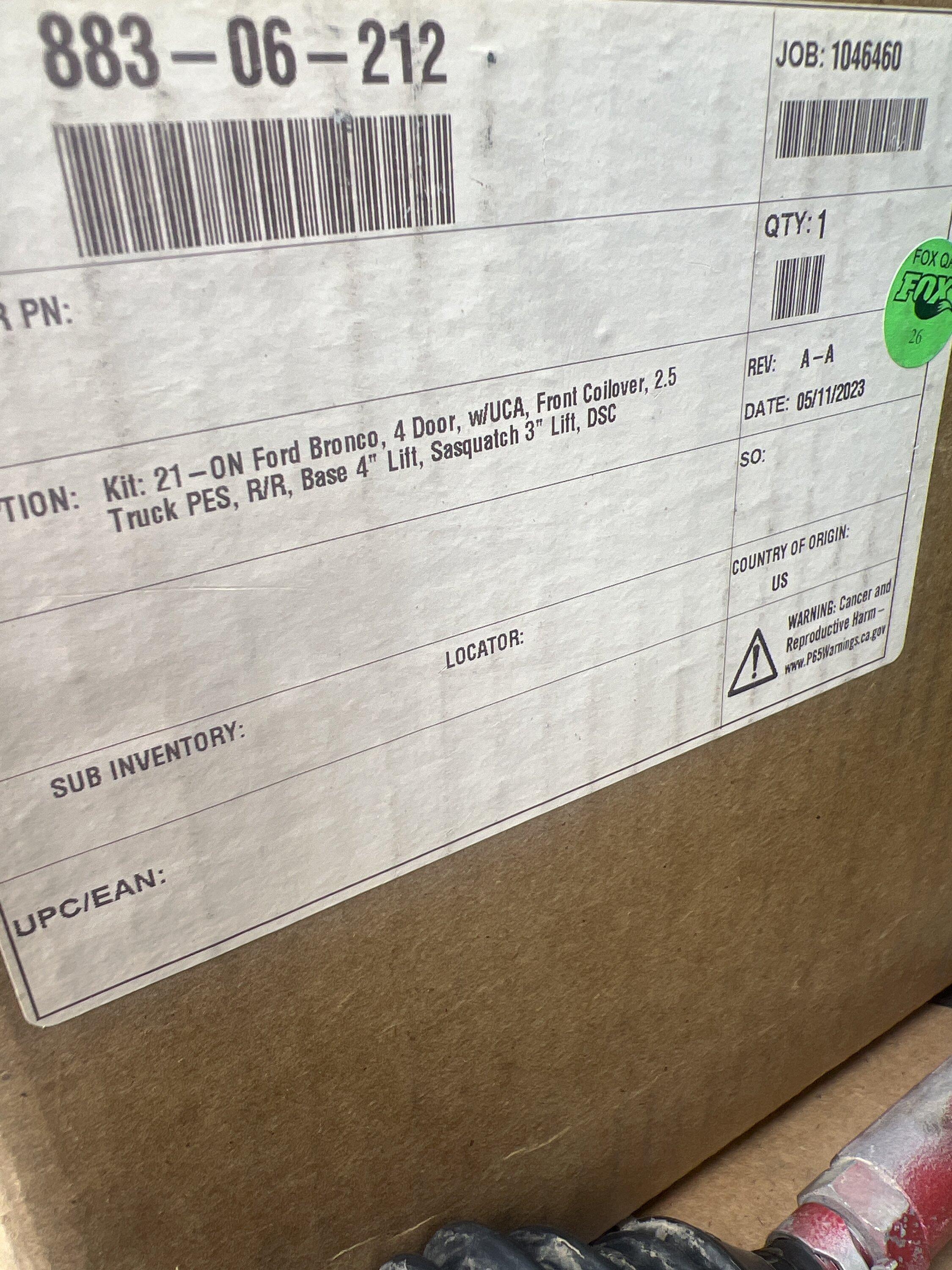

From the set I got built may 23 states for 4 door sas and non sas.
Way I read it they have a 2 Dr and 4 Dr set. 4 Dr covers sas and non sas. I have a 2 Dr and grabbed a 4 Dr set to comp for my added weight.
I couldn’t be happier with the shock upgrade. I actually like how it rides now. Night and day difference. I had to add 2” for height in the rear and dropped a inch in the front.
