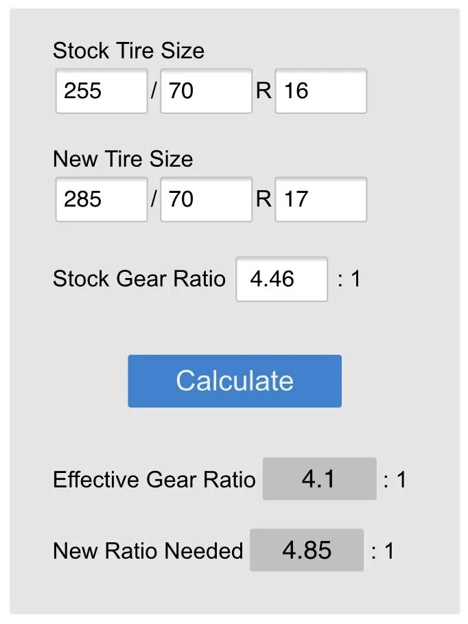

The mansquatch will have lower gears, 5.13 maybe?
That is a great looking bronco.
5.13 would get Mansquatch back to the same gearing as base.
Ford Bronco Not Mansquatch… womp 7A86F135-C3B7-4850-9C62-5A84DD0B6C7F
The 4.7 ratio on the Badlands manual isn’t quite there, it could use 4.88. The 4.7 does get it geared lower than the Black Diamond, so probably good enough.

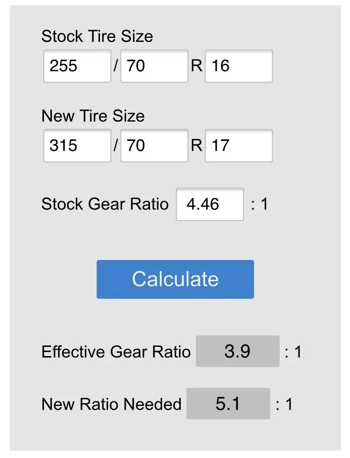

Nothing confirmed, I was saying that based on 4.46 gearing in the Base, 5.13 would get the ratio correct for 35” with the manual.
According to the tire size/gear charts I've seen, 4.70 is too much for 33s but fine for 35s. 5.13 would be better for 37s.

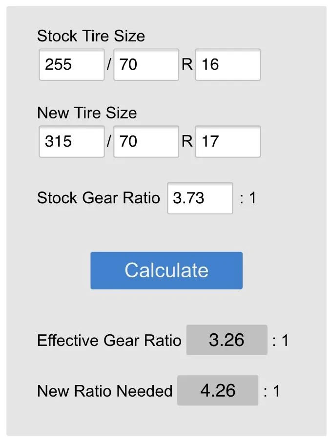

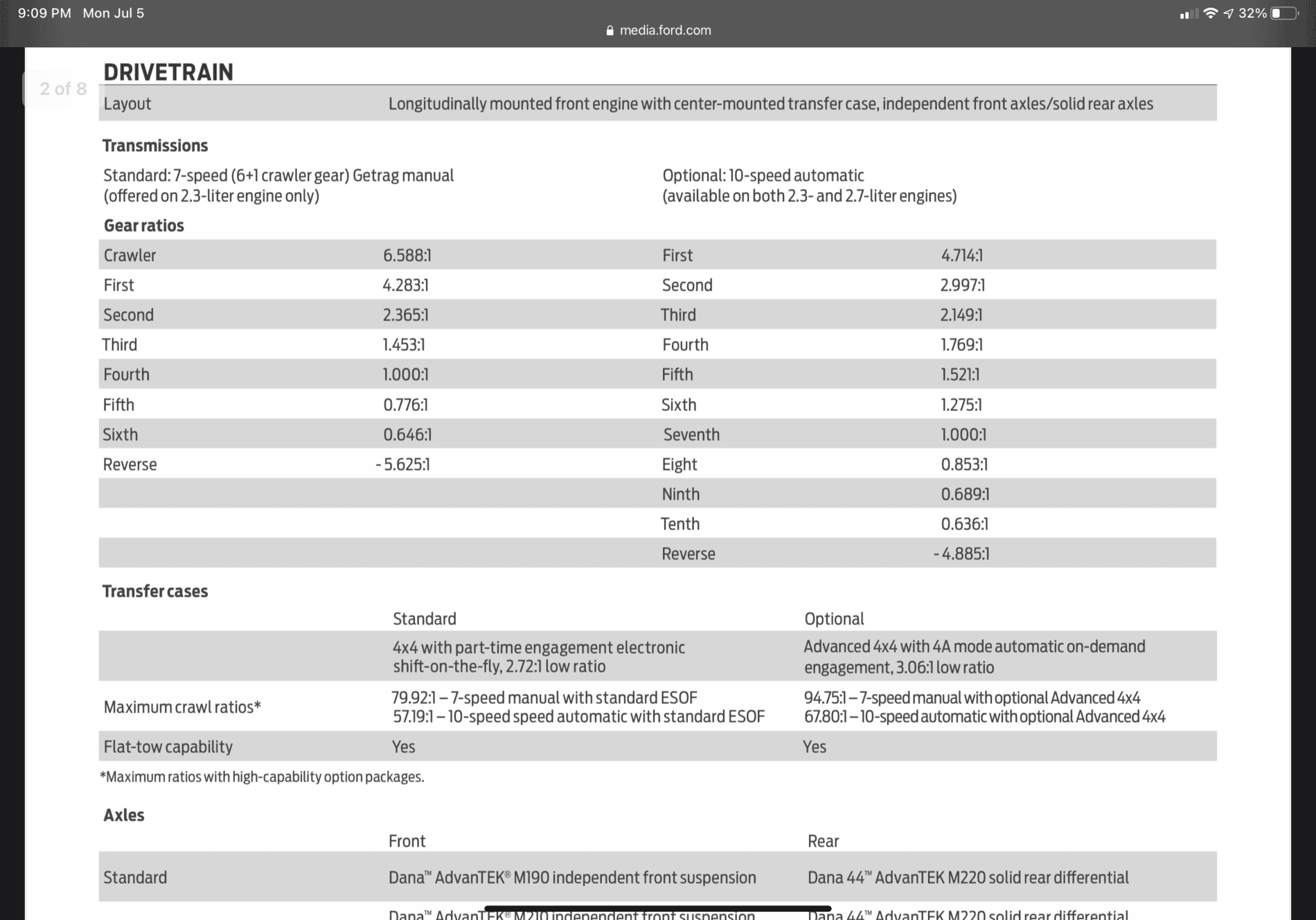

The Bronco manual has both 5th (.776:1) and 6th (.646:1) gears as overdrives, when that chart was developed most trucks were running a single .85:1 overdrive at best and were starting with 3.55 gears. Since the Bronco is starting with 4.46 gears on the base with 30” tires, the calculator I posted the results from calls for 5.1 gears to match. 5.38 would be the correct ratio for 37” tires.
The gearing on the auto trans is lower on the bottom (minus crawler) and higher on the top. That 4.714:1 first gear in the auto transmission makes it work with 3.73 gears in the base model. The Sasquatch with the automatic is geared at 4.7, whereas the calculator only recommends a 4.26 axle is needed for the tire size. Maybe the Mansquatch really needs the 5.38 for just the 35” tires.
