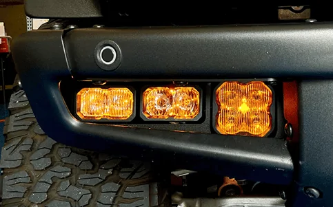

Back-light just adds an ambient backlight:
Ford Bronco Off road lighting advice please 1669391158866
It's separate from the main output. Just gives it a little look.
Fog lights with an SAE/DOT Fog Pattern are street legal (1 pair on). Anything above the bumper (even if it's SAE rated) isnt legal for on-road use unless it's an SAE Driving pattern and you don't have more then 4 forward facing lights on at any time (low beams + high beams if you have separate low/high OR high beams + driving pillars if you don't have separate lows and highs). Fun fact, thats why fog lights turn off on some trucks that have separate high and low beams.
