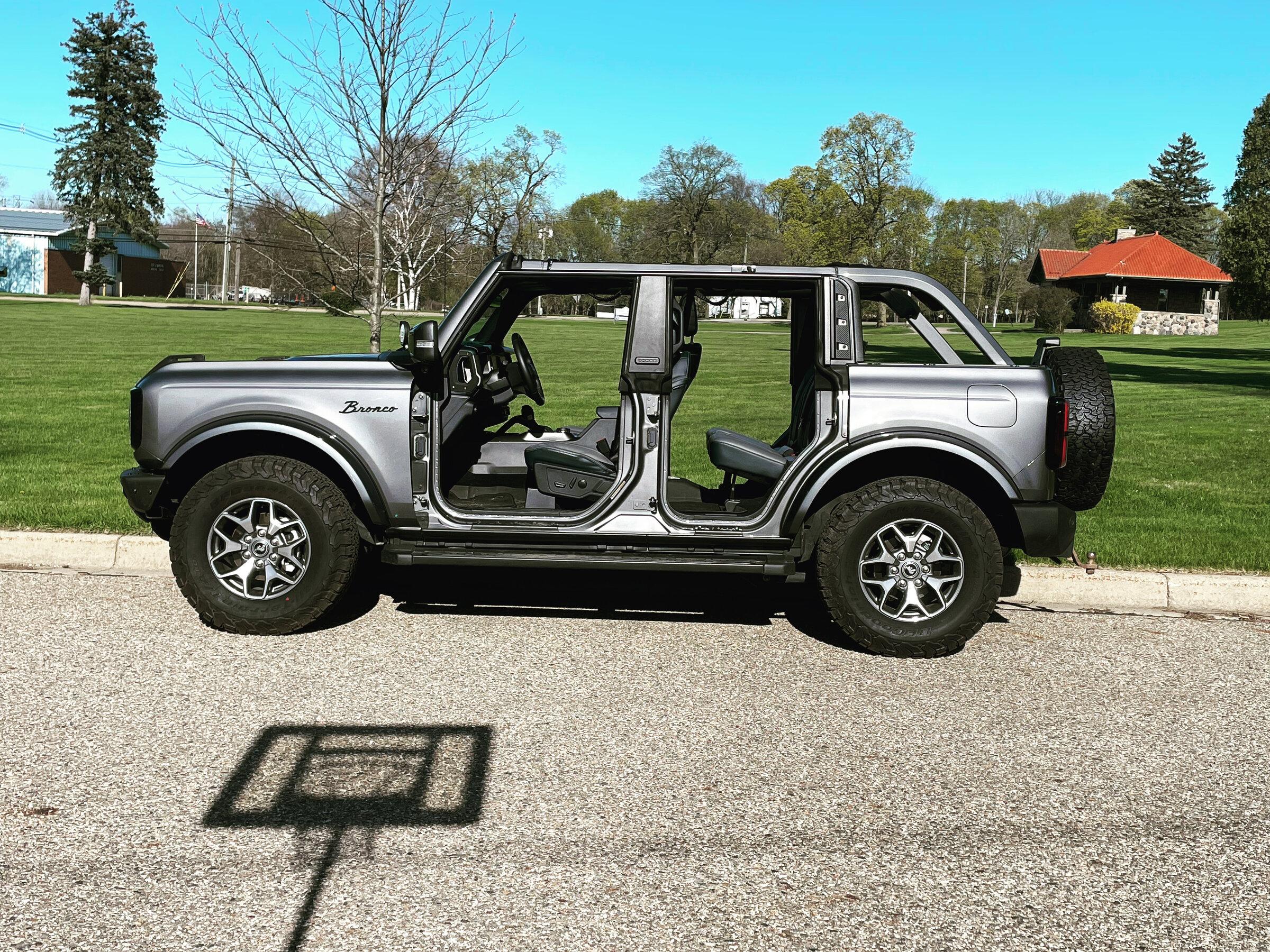

I put 295/70R17s (33.3 inch tires) on my non-SAS Black Diamond. It rubbed the rear crash bars at 60% lock in reverse so I removed them. Here’s a pic for reference. Wheels are 0 offset, so they poke more than the stock wheels but not too much IMO.
That looks great! Which wheels are those?

Any reason you didn't keep stock wheels? Looks or needed a different offset, etc?
I’ve always liked these Baja wheels, especially after seeing them on some EBs. It fit the vision I had in my head of how I wanted it to look. I would have gone with a positive offset if they made them that way, but I like the look of no offset better after the fact.

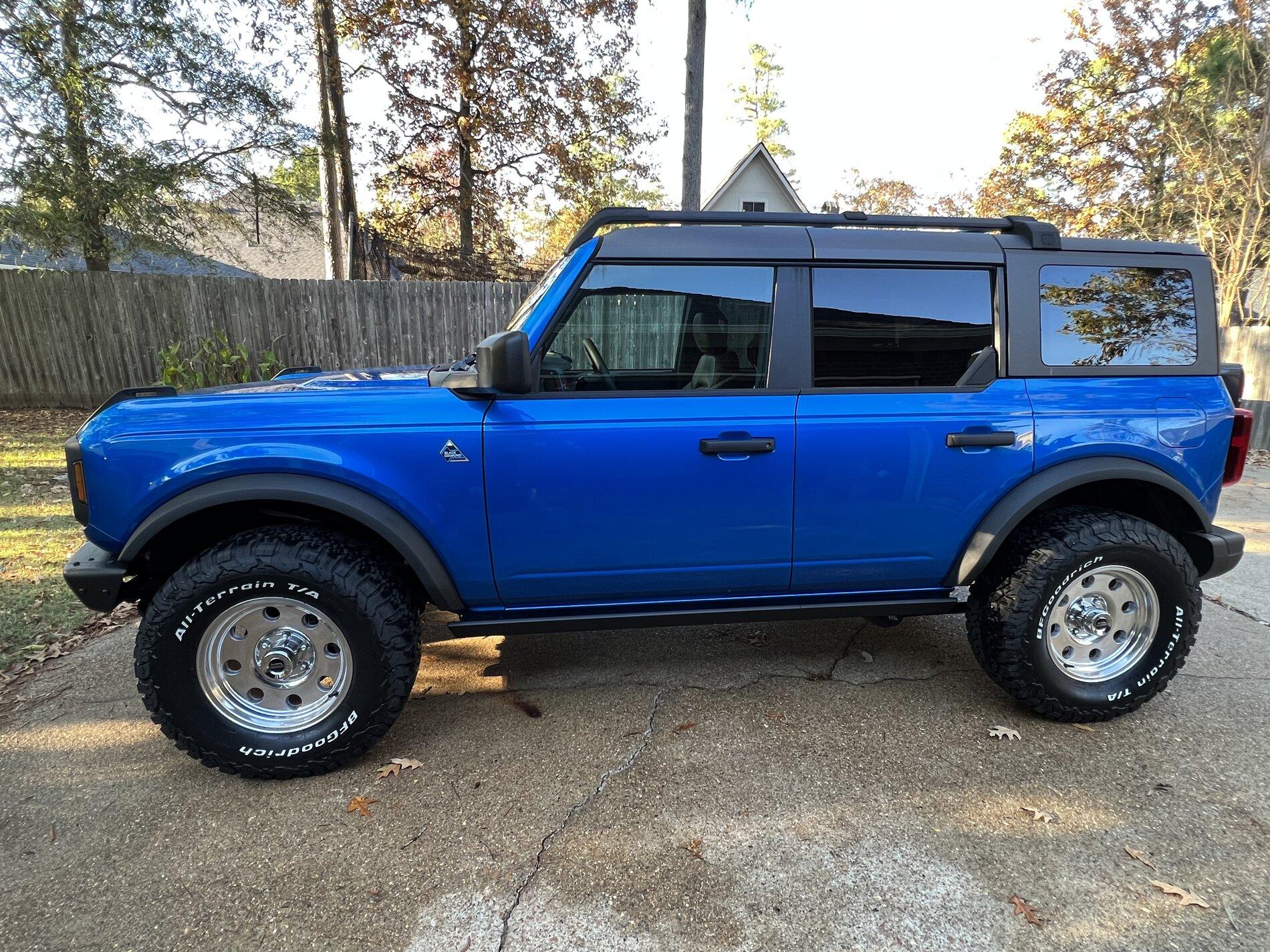

Removing the crash bars 33's will fit, I did it on my Base Model and I have plenty of clearance. Hope this helps!

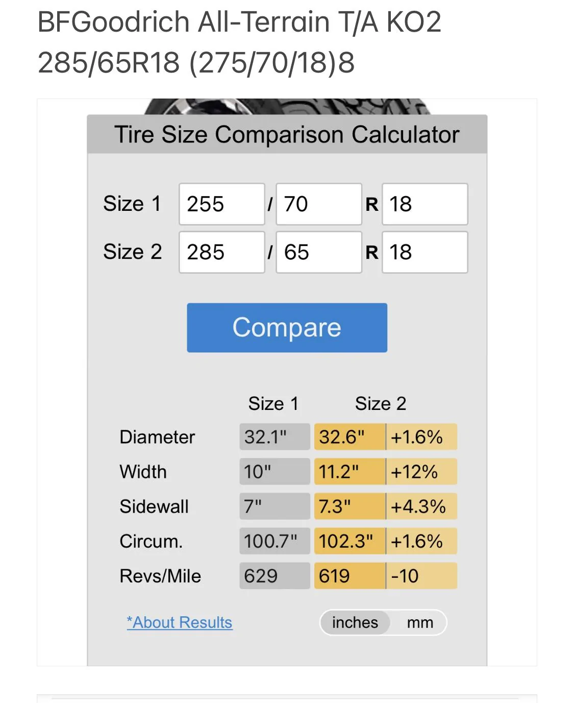

Stock badlands tires and wheels on my OBX they list as 32.8” no need to remover crash bars even at a true 33” there is a ton of room.

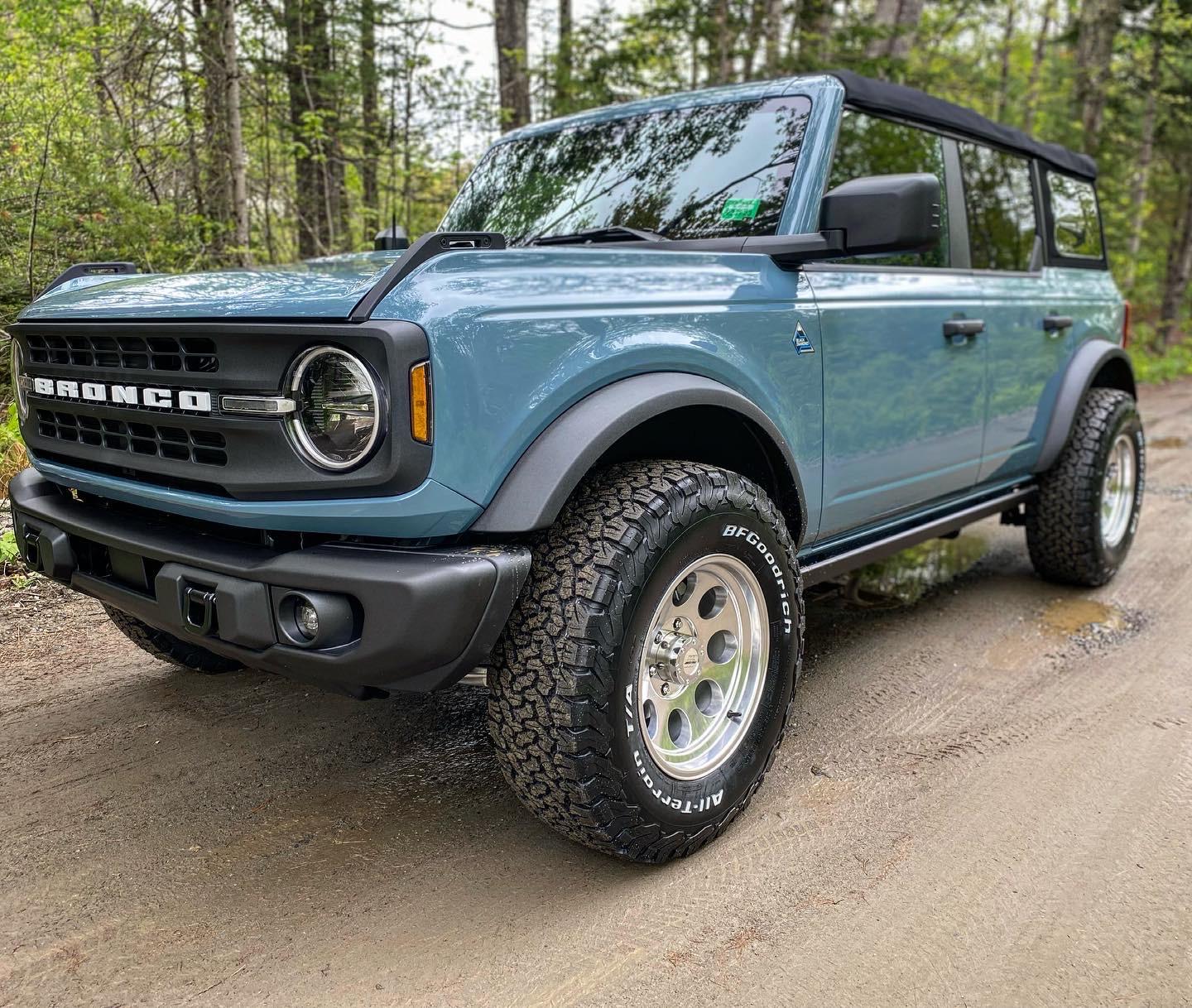

So to go with this, I have Pro Comp 69's 17x9 with a -6 offset and 285/70/17's and had to remove both the front and rear crash bars. Slightly smaller tire and a slightly wider wheel with a little more offset and we both have wildly different fitment.
-6mm doesn't seem like much but with an inch wider wheel it realistically changes the turn lock radius and made me remove both crash bars. 33's should absolutely fit on the stock wheels, but you might end up having to pull out some or all of the bars.
