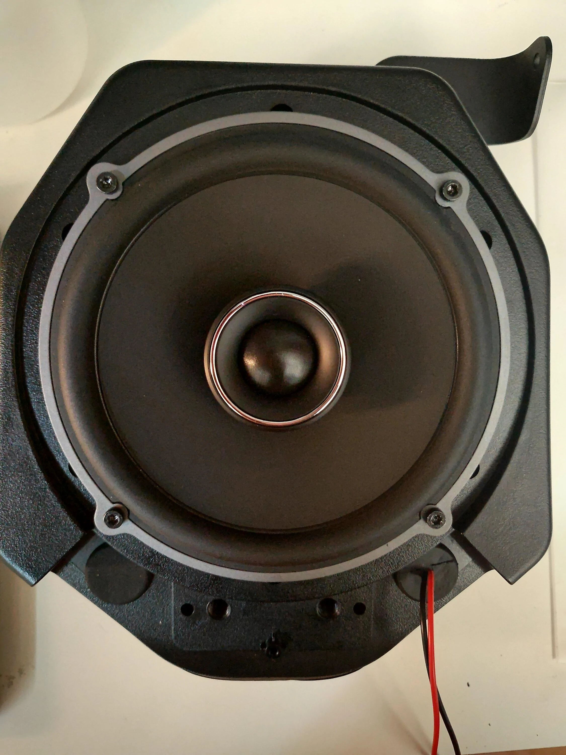

I've installed the SSV with a pair of Audiofrogs. Fits fine on the 4-door.

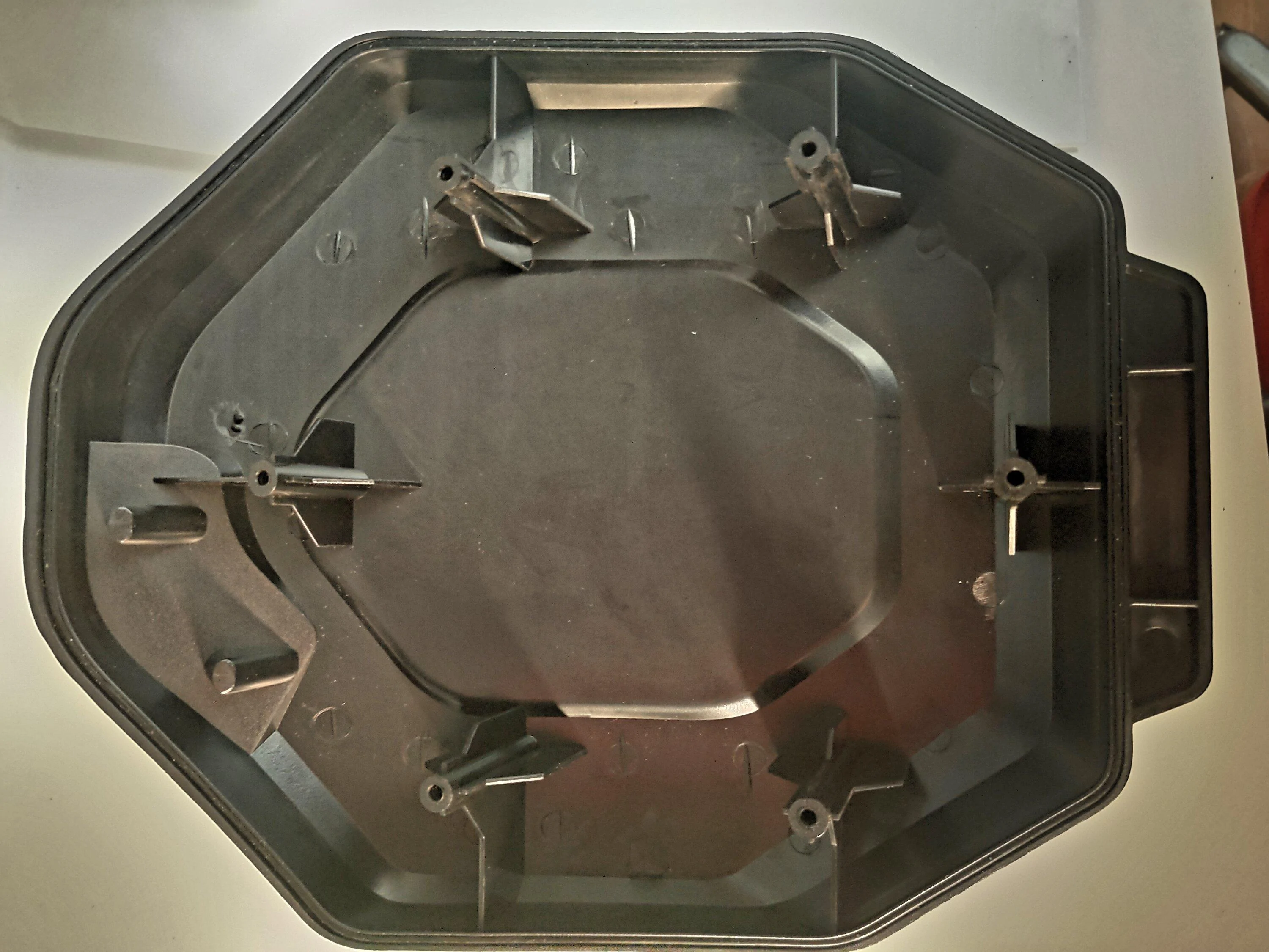

A couple of notes regarding the SSVs'.
The plastic is relatively thin with a large flat area on the backside. This area is resonant producing a hollow sound if tapping it with fingers.
Ford Bronco Planning my Audio Upgrade, does it make sense? IMG_20230520_205944

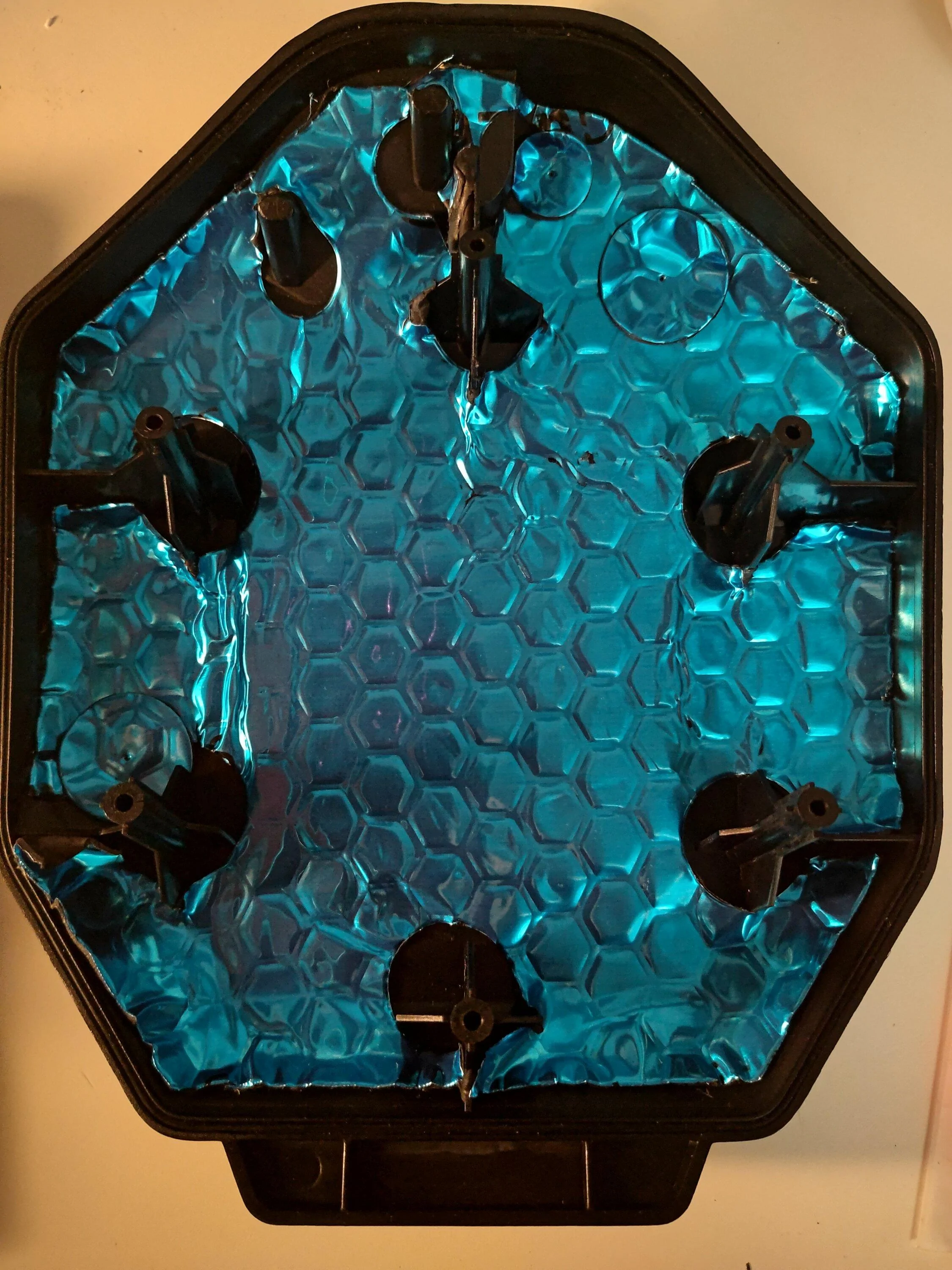

I didn't like the idea of leaving this surface as is. This is a good opportunity to dampen that surface with some CLD. Here, I've used some AmazonBasics CLD:
Ford Bronco Planning my Audio Upgrade, does it make sense? IMG_20230520_211615

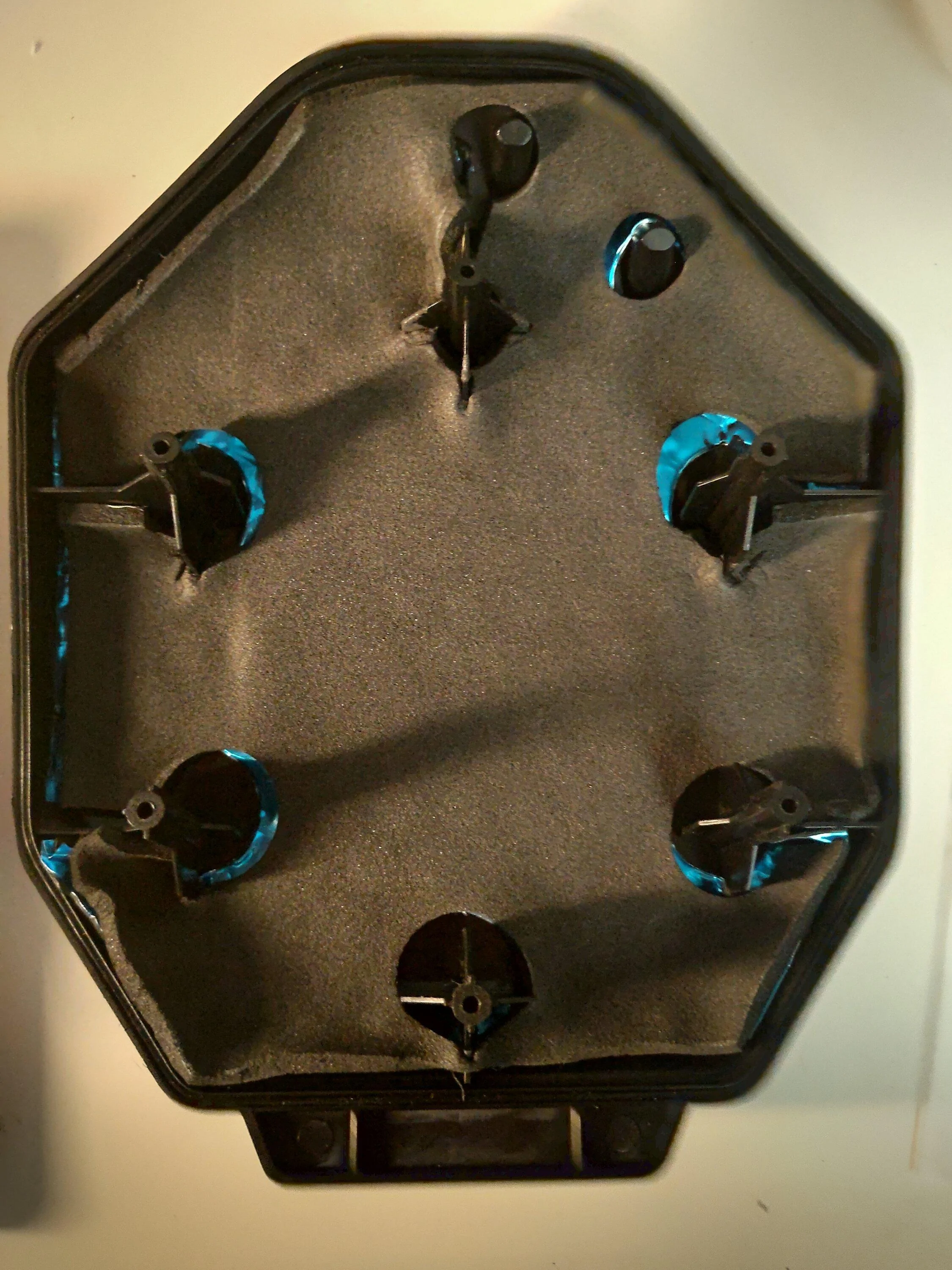

And then, a layer of closed cell foam:
Ford Bronco Planning my Audio Upgrade, does it make sense? IMG_20230520_212305
Ford Bronco Planning my Audio Upgrade, does it make sense? IMG_20230521_091939
The plan for speakers alone should provide you with an upgraded sound but, if you can afford to, I'd also plan for an eventual amplifier install as you've suggested (I don't have the non-bo system but would presume the head amp isn't great). @RagnarKon has some great install videos.
Awesome, that’s a great tip, I’ll definitely go in and add some CLD prior to install. Did the set you bought come with the foam or did you source that separately?
It doesn't come with the kit.
Sourced the CLD and foam separately via Amazon. CLD to add mass. The foam itself probably doesn't help a lot. Thinking is that it helps break up the reflective surface internally. Relatively inexpensive. Maybe an hour to do both.
