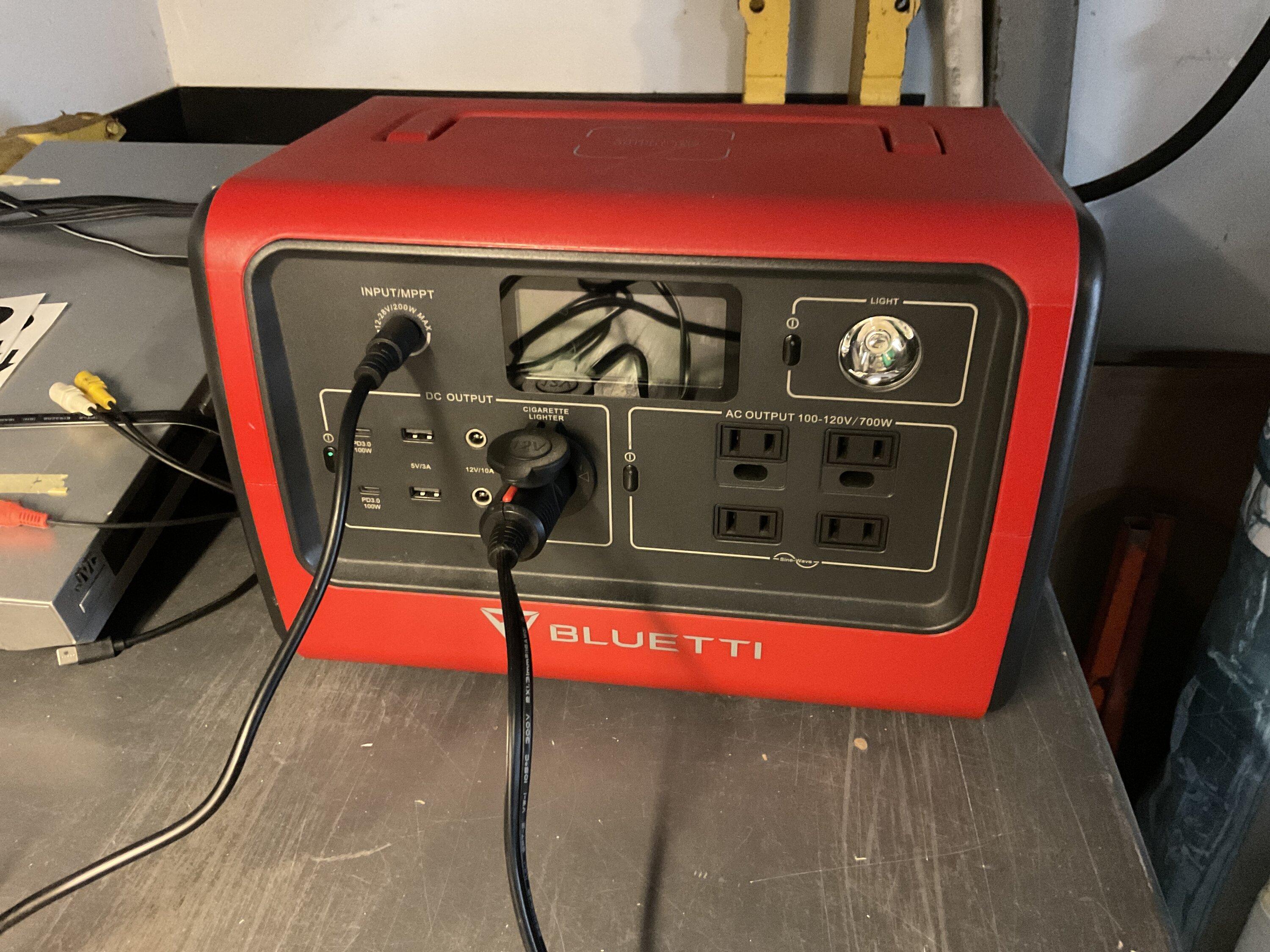

Like Chief, I use a portable battery bank. I use the Bluetti one. It charges while the truck is on from the rear cig. plug. Then when trucks off, it'll drain the battery from the Bluetti. I get about 3 days on my big ARB Fridge. You can see it in the walk-through video here:

Realistically the EB70 is about 550 watt hours useable. The fridge I’m running cycles on and off. Off 0 watts, on about 40 watts. If it ran continuously (closed up hot car….) it would eat 400 watt hours in 10 hours. At lower temps it would easily double that time, but about two days max. I bought 200 watts of solar panel to charge it while camping.
It also has a 120 VAC outlet. 700 watts max
