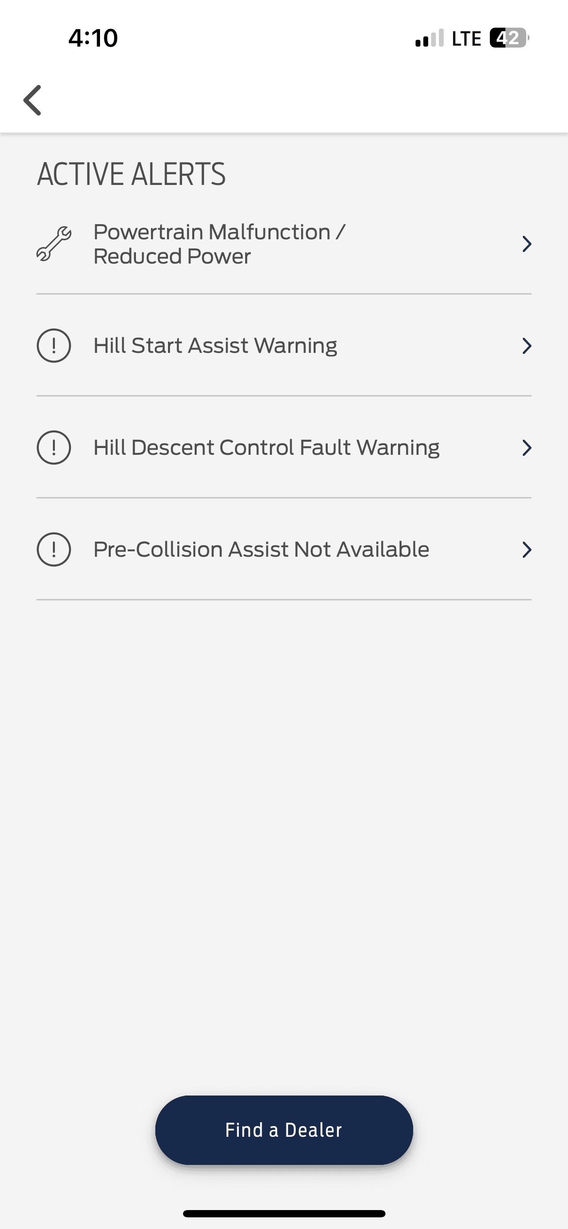

Got my two door manual big bend sasq at the end of February. After 200 miles had a powertrain failure (and other various 'assist' failures). Took it in for repair and the dealership replaced the battery.
One week later, same powertrain failure. Took it back in and they reseated a pedal cable that was loose, which didnt fix it, so they ordered a whole new accelerator pedal assembly. Been in the shop for a month now since they were backordered.
Just got word the technician replaced it this morning but the errors still exist.

Out of curiosity, do you know what codes it is throwing? Do they happen to be fuel pump voltage and injector fault codes? If so this will look like the Battery or Battery Junction Box and most likely be a PCM issue. Parts weren't available for mine through Ford so dealer ordered from another dealer that had the BJB in stock. Once they figured out it was the PCM and after several calls and emails from me to Ford Customer Relations, they pulled a PCM from assembly line for mine. I have a 2 door Big Bend Sasquatch Auto purchased early Feb and blended late Sept 2022. Might have been getting assembled from same batch of PCM's.

I know in some states it has to be in for the same concern multiple times to be considered for lemon law. A generic powertrain malfunction warning on your Ford pass doesn’t exactly mean it’s the same problem as before.
Obviously I don’t know the whole situation or the actual codes the vehicle has, just throwing that out there. It does sound like it’s all similar though.

Apparently the dealership found faults in APP 2, pin fit issues on connector C203 for circuit C2040... Replacing the entire engine wiring harness. Another 7 days out, which easily hits the 30 day total mark.
