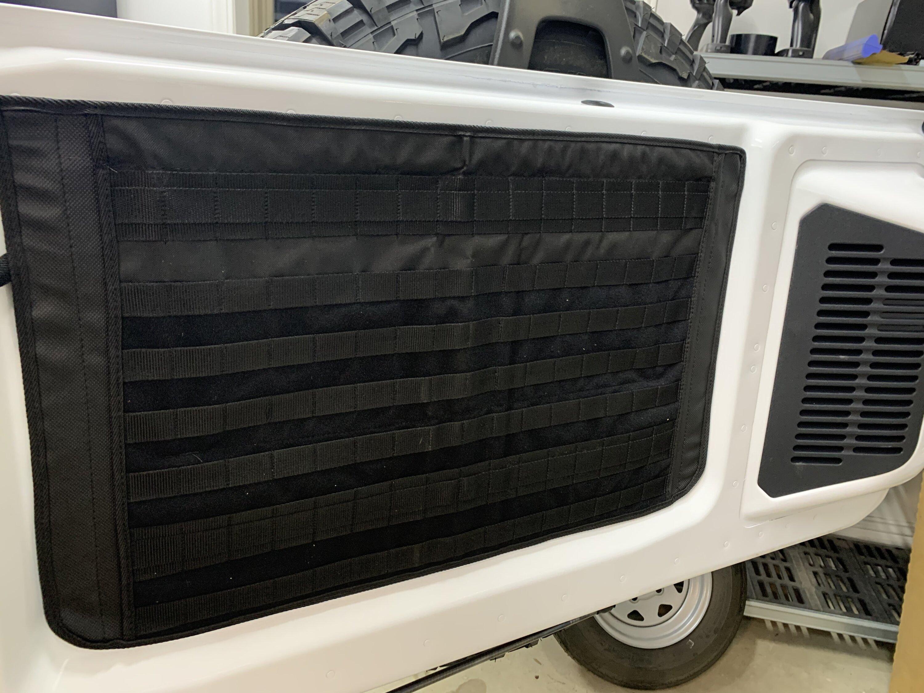

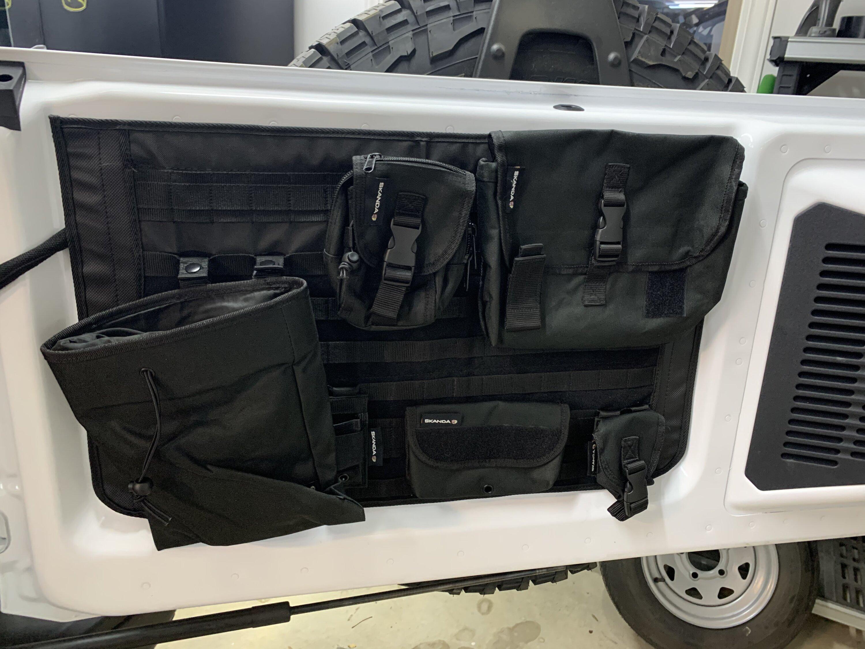

This is what I have on the inside.
Yep, that will definitely impede the vent flaps. With all the vent holes behind the molle bag that only leaves the one panel to vent. The vent flaps are located directly behind the molle bag (inside the tailgate).
I thought the plastic grate on the right hand side of that photo was the vent?
