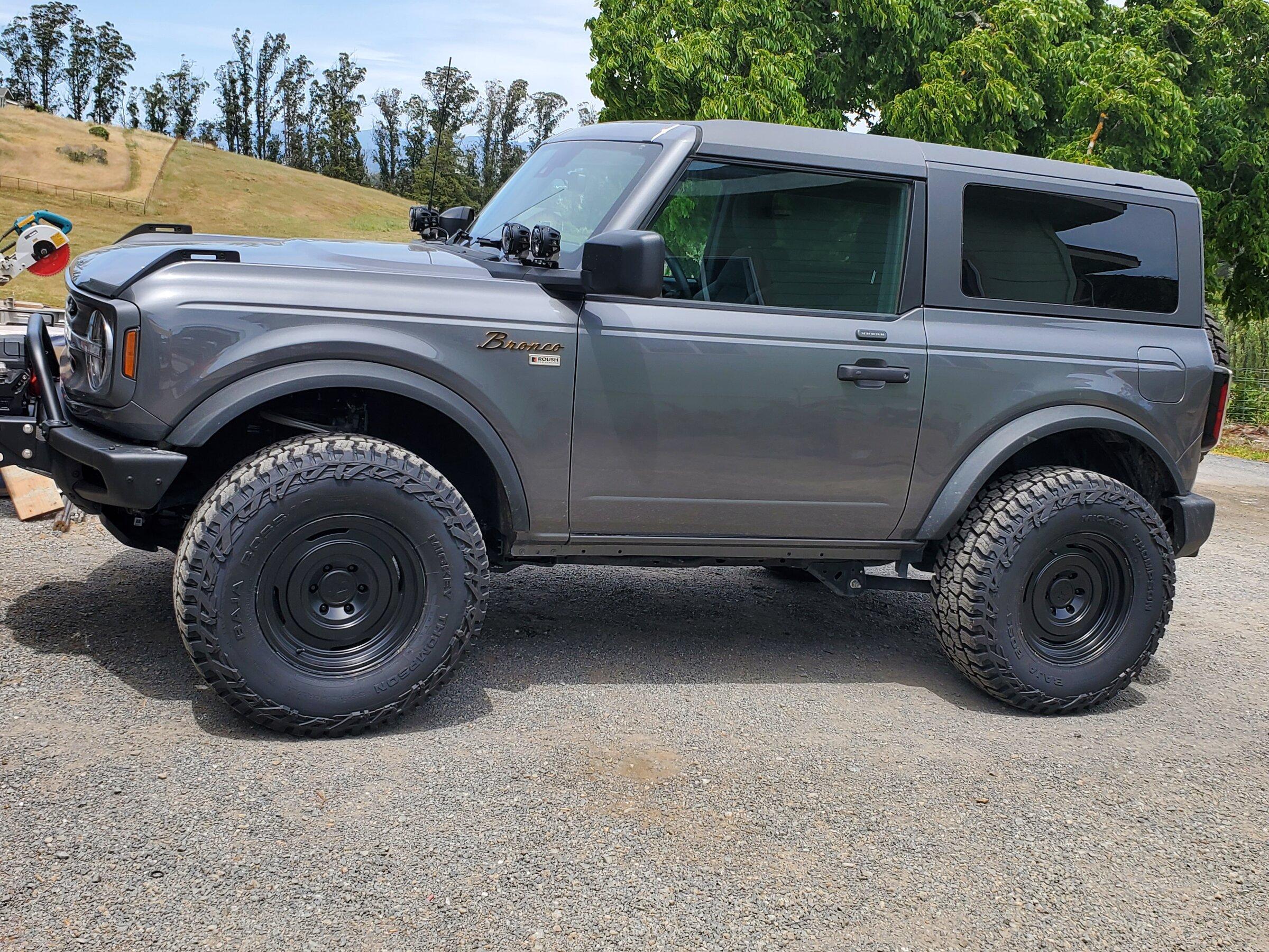

I was hoping I could get a little help. I have a big bend with 33” tires. I want to upgrade to 35’s but would like to keep my original wheels. What tire spec should I get? Or is it worth replacing the rims? Thanks in advance.
Here is mine with 35 12.5 17s with 2.5 front and 1.5 rear lift.
Ford Bronco Putting 35s on 20220516_133120
