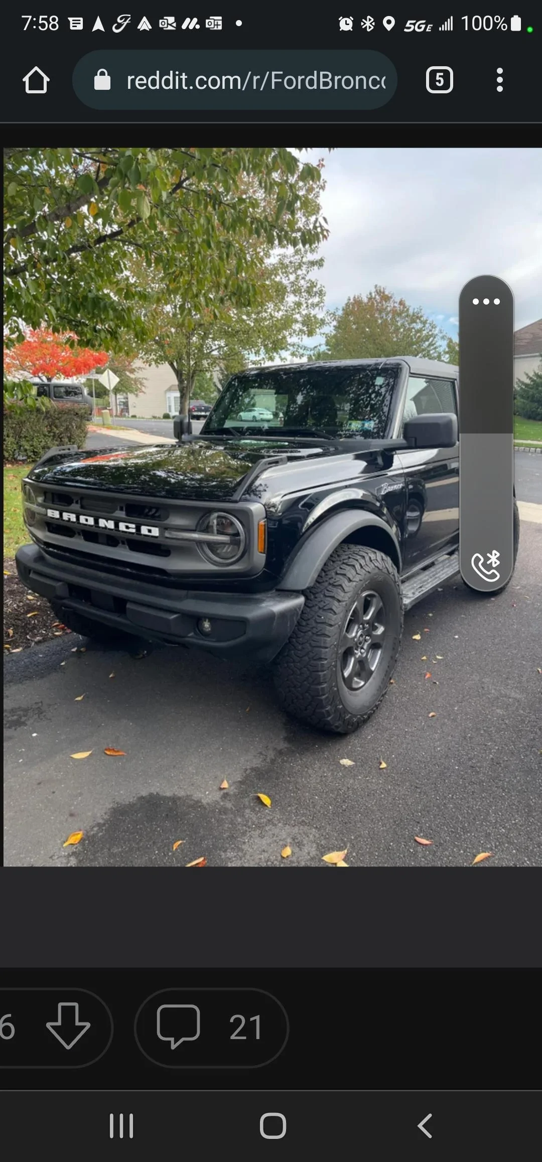

I've done some heavy research into the topic and reached out to @Spider Jeff he put 315/70/17 on his BB with stock rims. No rubbing, I found another person who put 37's with a lift and wheel spacers on the stock BB rims too.
Personally I just ordered a 1.5" spacer as well as 315's for my Big Bend. Should have them installed in the next two weeks. Ill post a pic then.
Attached I put the pic of a big bend wheel sitting on 37's. Last thing to keep in mind will be your gear ratio, 3.73's (like i have) might make your Big bend feel a bit sluggish off the line. Some people say they don't notice a difference, others say its the equivalent of turbo charging a civic. I guess it comes down to preference.

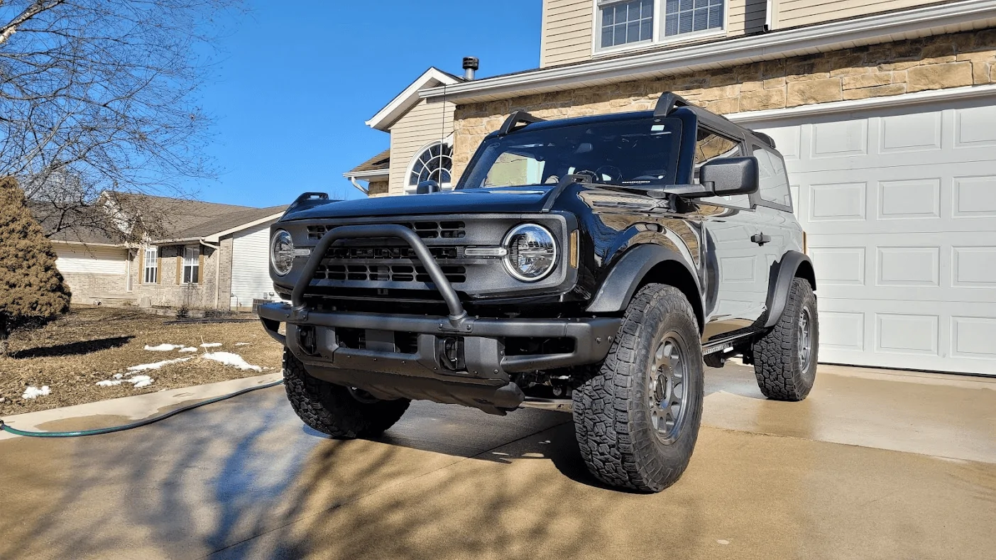

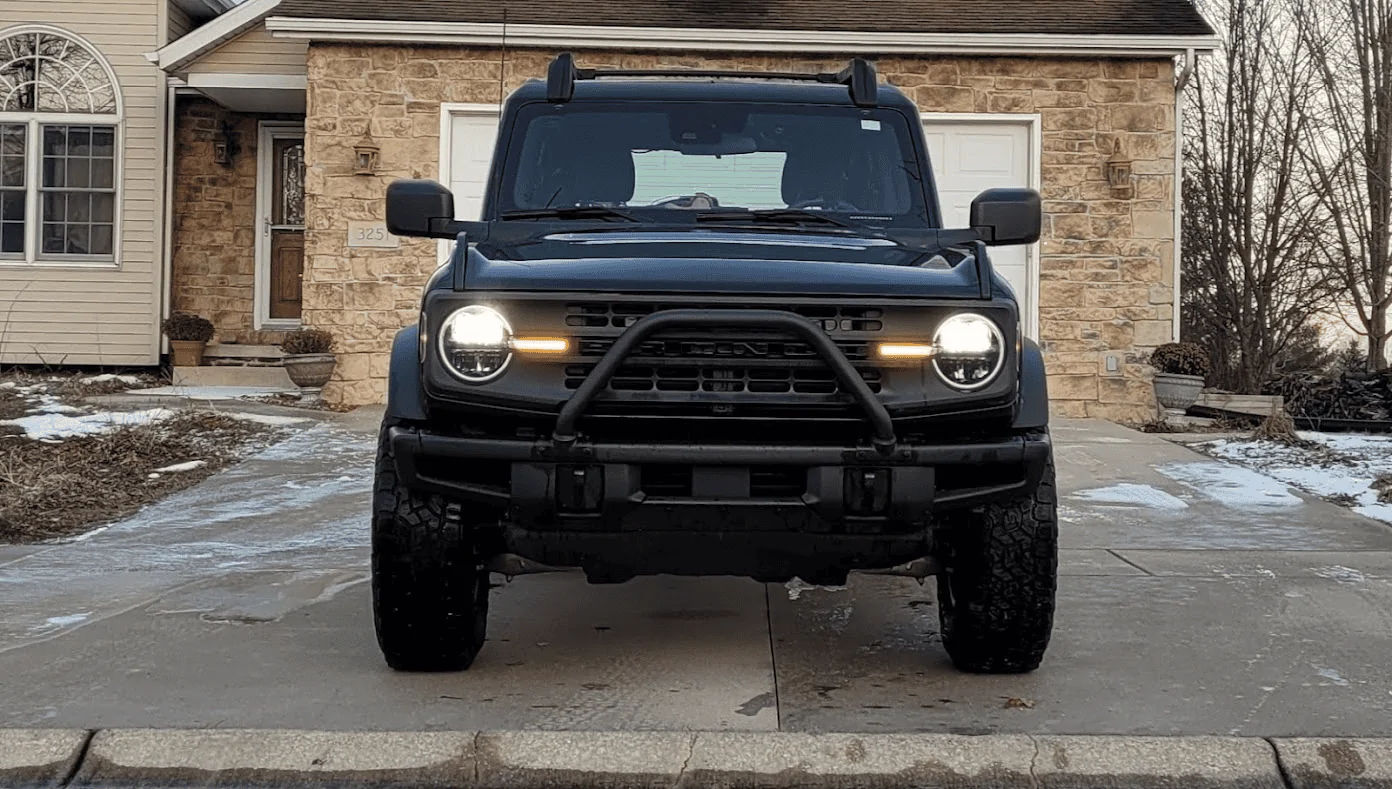

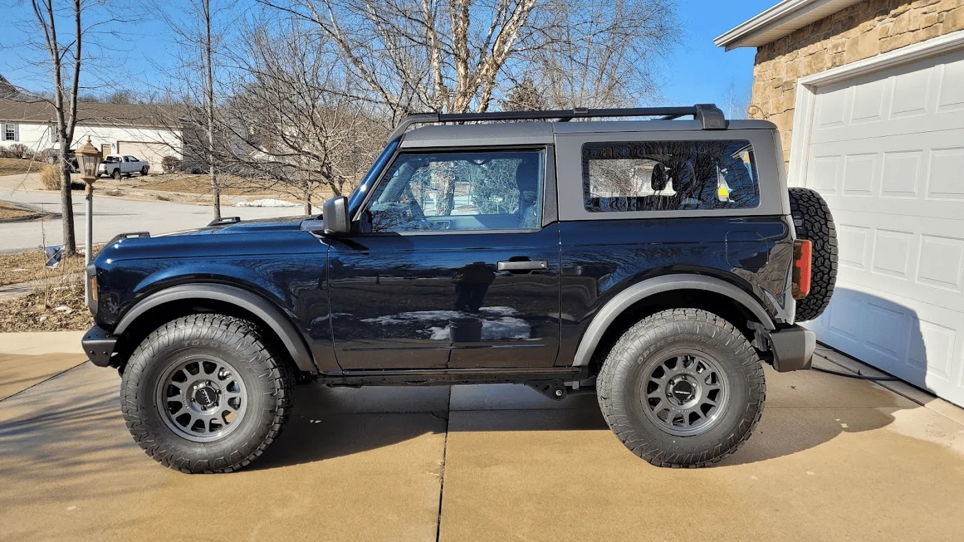

Howz about a 35 x 11.5-17 in Load Range C?
Toyo Open country AT3
I'm not sure what the draw is towards all these cheap, non name brand tires. If you need your tires to perform, get good ones.
I've had only bad luck with the cheapies.
I have these Toyo's on +35mm Method wheels.
No lift ...base suspension ... no rub.
Crash bars removed.
