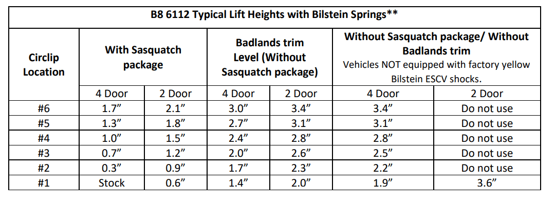

Is your Big Bend a Squatch or not?
2dr or 4dr?
I had thought the 6112's didn't fit right with standard Broncos ( non-Squatch ). Especially the 2drs, the fronts.
( Except the Ford Perf version....)
From Bilstein website:
Ford Bronco Quick Question about Bilstein 6112 1709521557507
https://cart.bilsteinus.com/results...id=8719045583113624869&Do=2750356406413899037
It's not that they can't be used. But that only the first circlip setting is recommended. The 6112's will provide a lift beyond what is supported/intended with other stock components when using any circlip setting above #1.
That is likely the main reason why the FP version exists in order to still maintain warranty on related parts.
Right, 3.6" minimum on a 2dr standard Bronco.
I'd think if you're going that route, so much would have to be replaced/modified, you might as well go with one of the higher end complete systems.
That's a hell of a leap from a factory Hitachi suspension.
That's why I asked about his original factory build.
