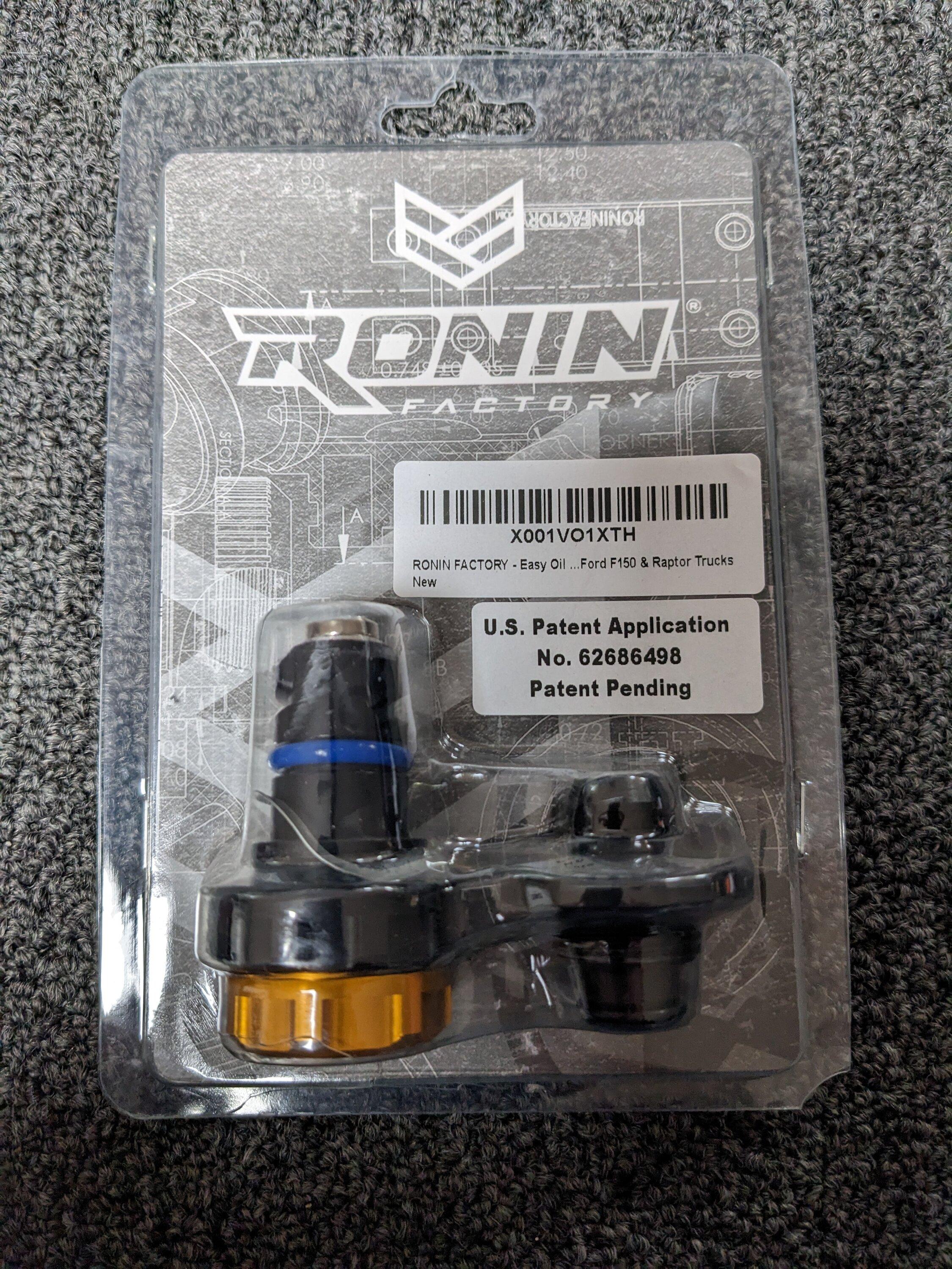

you still remove the plug once the initial drain is done or at least you should.
The whole point of those plugs is to avoid removing the plug on each oil change and to avoid the mess. I wouldn’t bother adding one if I still need to remove it every time.
I ran the Fumoto valve on my Cummins truck for a dozen years. It worked great and I didn’t worry about a few ounces that might remain in the pan, especially with 3 gallons of oil.

Just did mine at the first 2000 miles, didn't spill a drop taking the yellow plastic plug out. I let it sit for about an hour to fully drain. I reused the plug this time, next time will replace it with the same exact plug. I ordered the after market plug and decided not to install it due to the difference of what could be left in the pan.

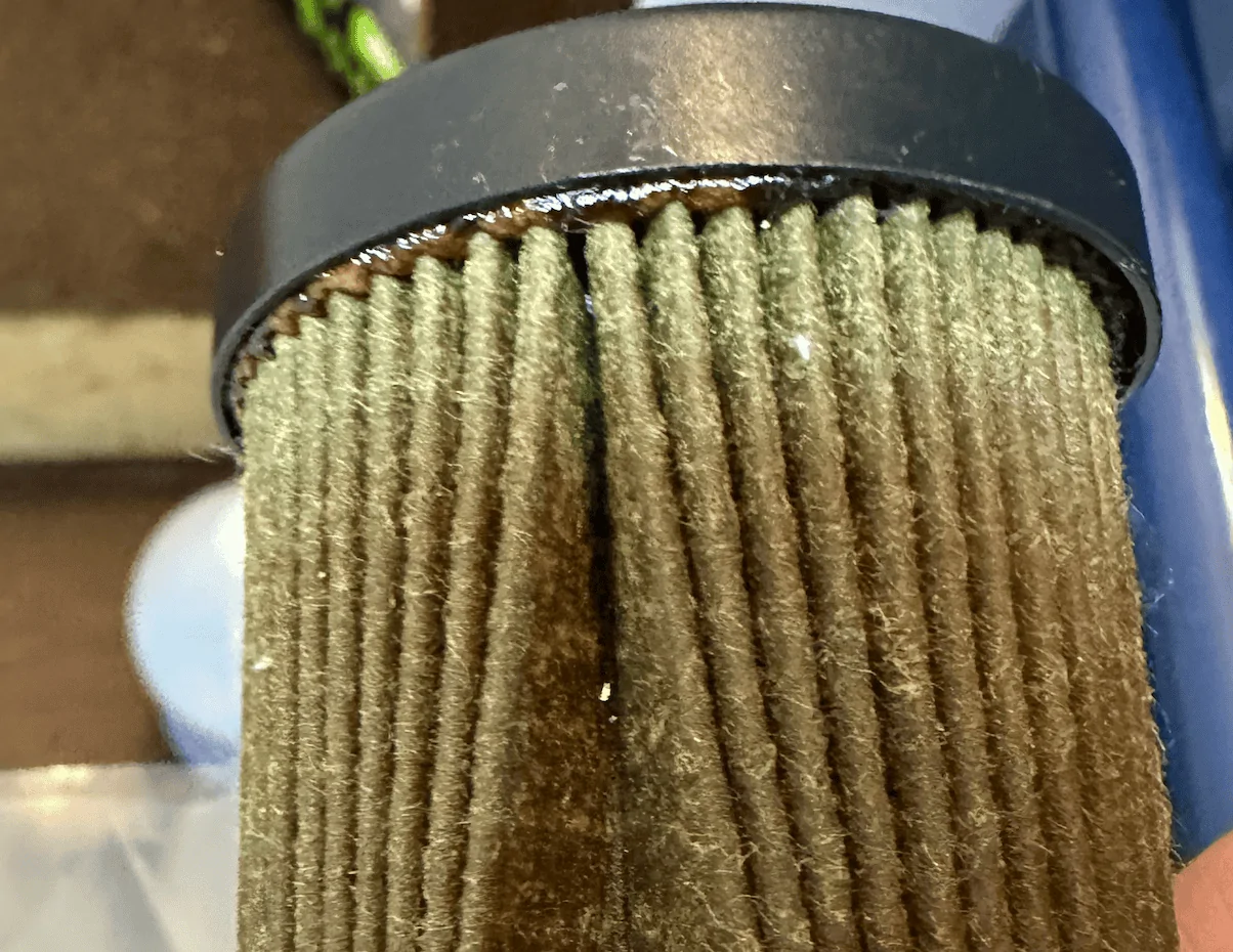

The sliver metal shavings were for sure in the membranes but not a crazy amount.
