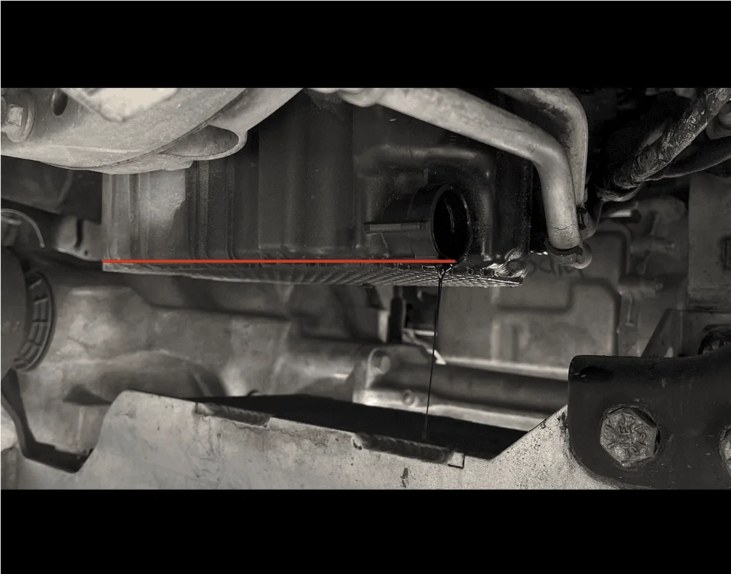

I'm doing my own also get one of these you will thank me later.
Ford Bronco Raptor First Oil Change - - Be Aware (or BEWARE!) PXL_20230211_001454109

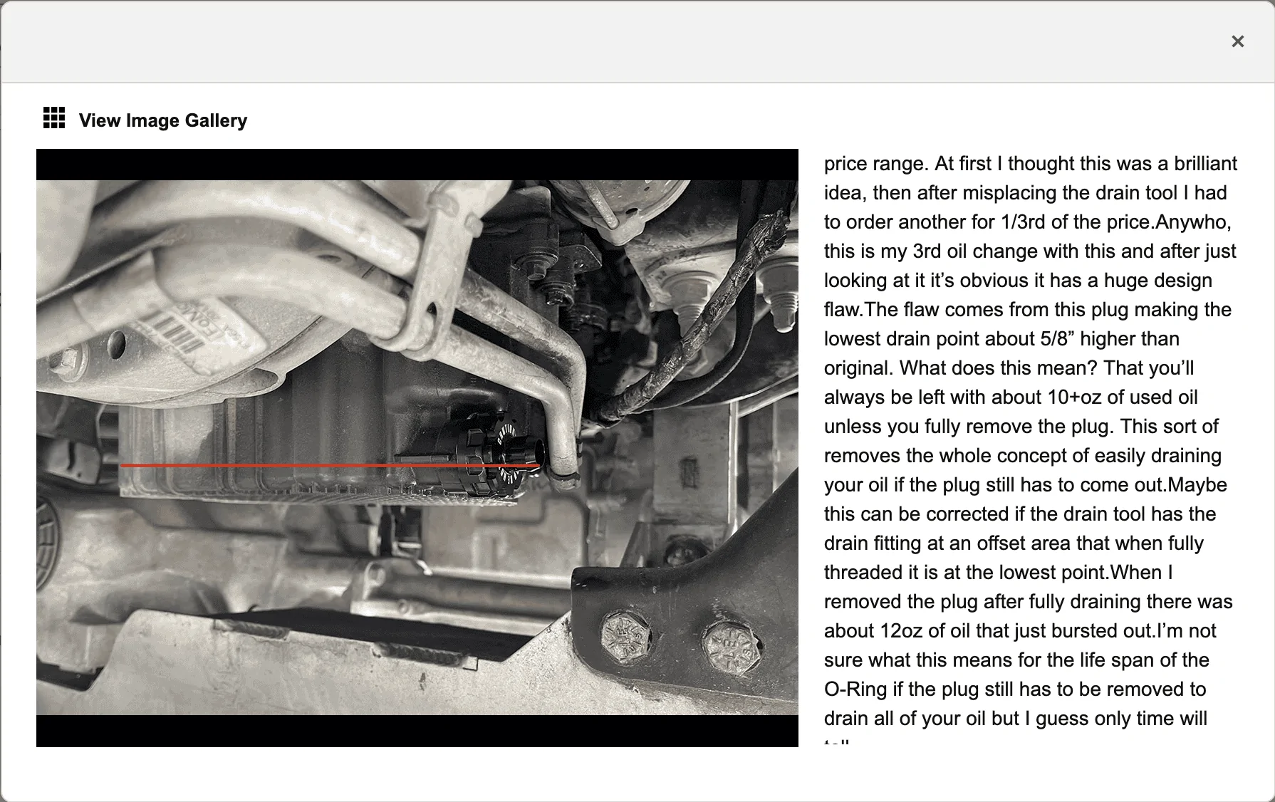

I am aware of these, Is the consensus still that they don't allow a full drain unless the bronco is leaning to that side? Based on there being additional height to contend with as a result of the plug itself in the pan? Never inspected the Raptor pan to know if this is accurate or not. Open to more info.

Basing that on reviews like this one, logic seemed sound:
Ford Bronco Raptor First Oil Change - - Be Aware (or BEWARE!) Screenshot 2023-02-10 at 18-27-06 Amazon.com RONIN FACTORY - Easy Oil Drain for 2015 Ford F150
Ford Bronco Raptor First Oil Change - - Be Aware (or BEWARE!) Screenshot 2023-02-10 at 18-27-27 Amazon.com RONIN FACTORY - Easy Oil Drain for 2015 Ford F150
you still remove the plug once the initial drain is done or at least you should.
