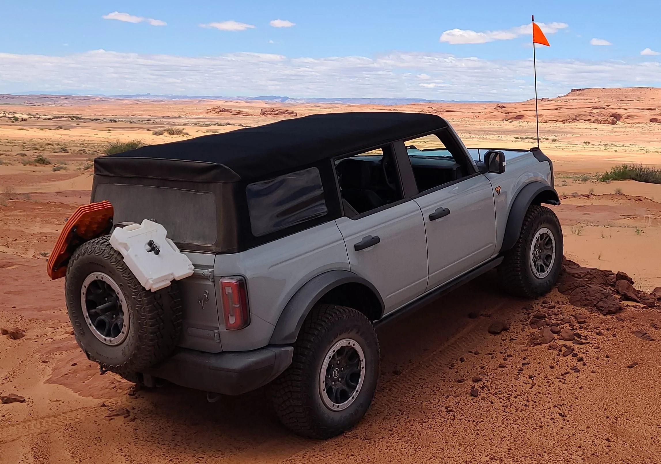

I had my had my tailgate fail at a United by Bronco event while opening it at an incline with about a 30lb load on top of the stock 35's while on trail. It now needs to be lifted to reach the latch. No external indications of bent sheet metal or hinges. Currently at the dealership..
Sounds like a reinforcement won't fix that next time, and need to be more mindful of only opening on the level...
Was that just a couple rotopax? strapped to the spare? i mean, just wow.
I too feel like I want to wait until hinge replacements are readily orderable.

4Maxtrax mini and a rotopax. Came out to right under the 135 lbs max load, so I thought I was safe. I theorize opening it at that angle or metal fatigue did it in after a little over a year or so of running that setup.
If that is the stock SAS rim/tire combo that is about 90...4 MaxTrax = 30, Rotopax is 4, 2.5 gallons of gas is 15, so 139...and whatever mounts used to attach the Rotopax and MaxTrax must weigh in at at least 10? You must be at at least in the 150 ballpark wet and I can image that would create some tailgate havoc.
These are my assumptions,
Stock Sas tire and carrier 87.5 lbs
Dry weight of rigging + maxtrax mini + Rotopax (39)
max wet weight 1.8 gallons on a 2 gal pack + rigging +maxtrax (54)
Total weight of 141.5 with max wet, 8.5 lbs (6%) over the load limit of 133. I have to drink about a gallon of water to get back to the max load limit.
Its right on the edge with those figures/assumptions above.
