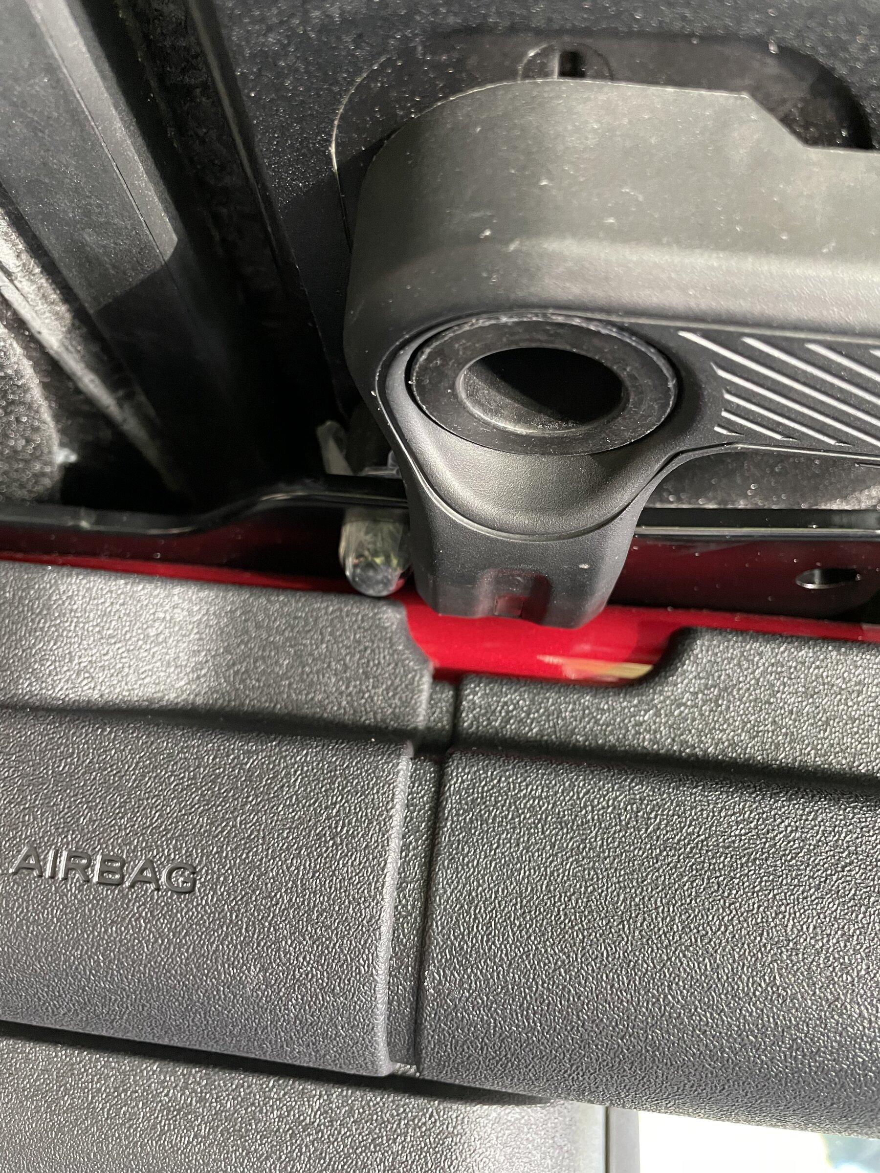

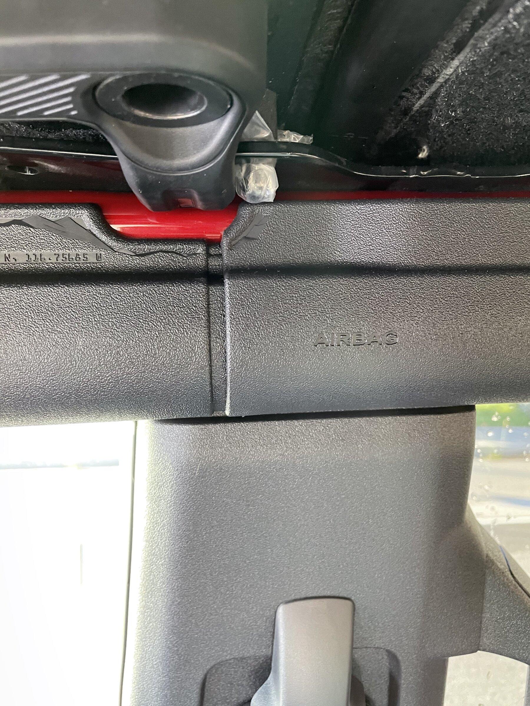

The rattle noise is from the guide pins, it will return. I made some plastic wrapper condoms for them and the noise went away. Pics below.

I thought those might be the culprit but not enough miles and time on them to easily see rub marks. Thanks for info and will use your fix or design my own. By the way 8/3 build shipped a month later and received 11/2, 900 miles on my BD so far.

My rattle top noises didn’t start until about 1,000 miles. It got bad fast, from several different pins eventually. This was a quick gas station fix, literally used some plastic from the garbage. I’ll make a more permanent fix eventually. I don’t foresee taking the top off much, these issues aren’t really worth the top off experience to me either.

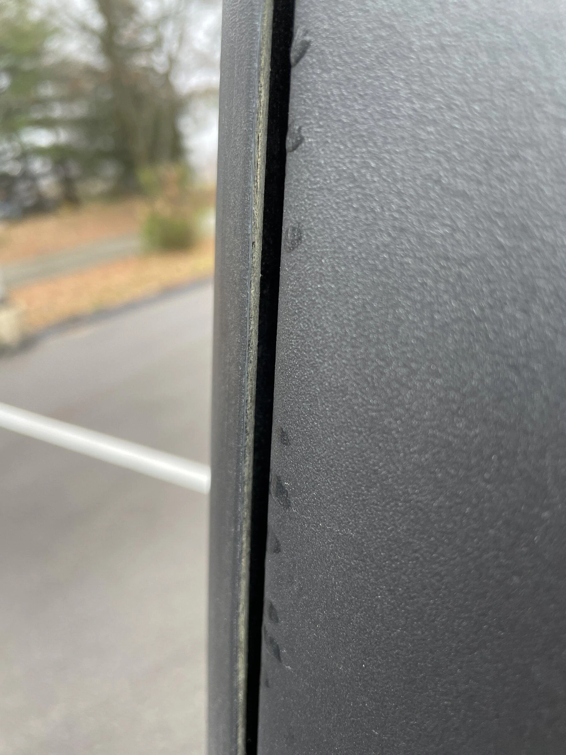

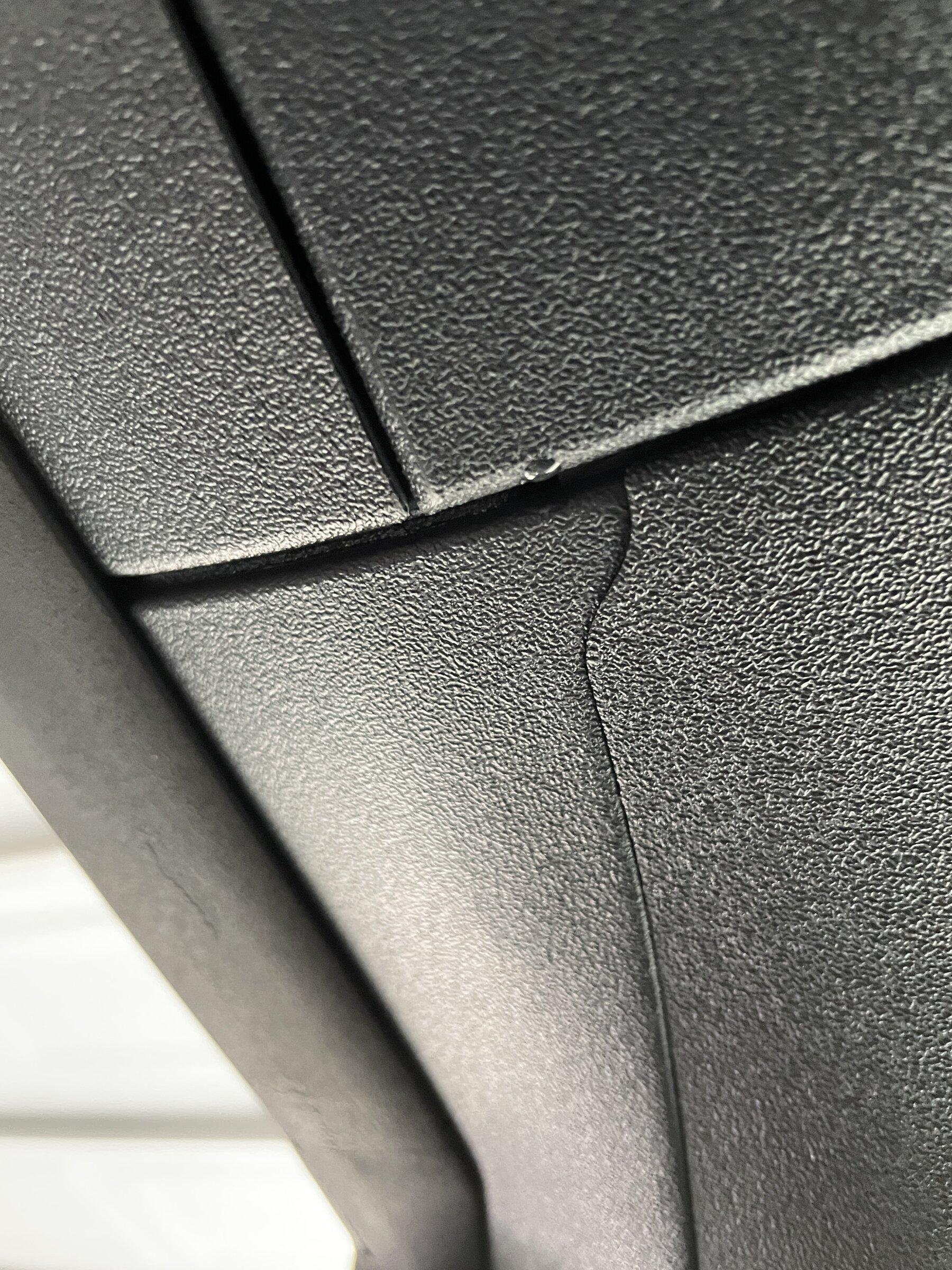

I took delivery mid December and had rough edges, honeycomb pattern and I’ve had a few drops of water come in. Working on figuring out what to do about this.

this looks exactly like the dealer mannequin 2 door I saw that arrived in October. The theory was it was a mix of MIC 1 and 2.0. The front panels and mid seemed great but around rear glass was unfinished and already splitting. If mine arrives like what you have I will be getting it replaced. This is unacceptable for $50k+
Update on my top, Ford has reached out a second time according to my dealer , if appears they are going to replace it. My delaminating has increased I also get water leaking out of the bottom of the rear glass , seems maybe from around the inside where the wiper motor is . It also leaked from the bottom of the plastic piece on the rear hatch glass from the inside when I open the hatch
