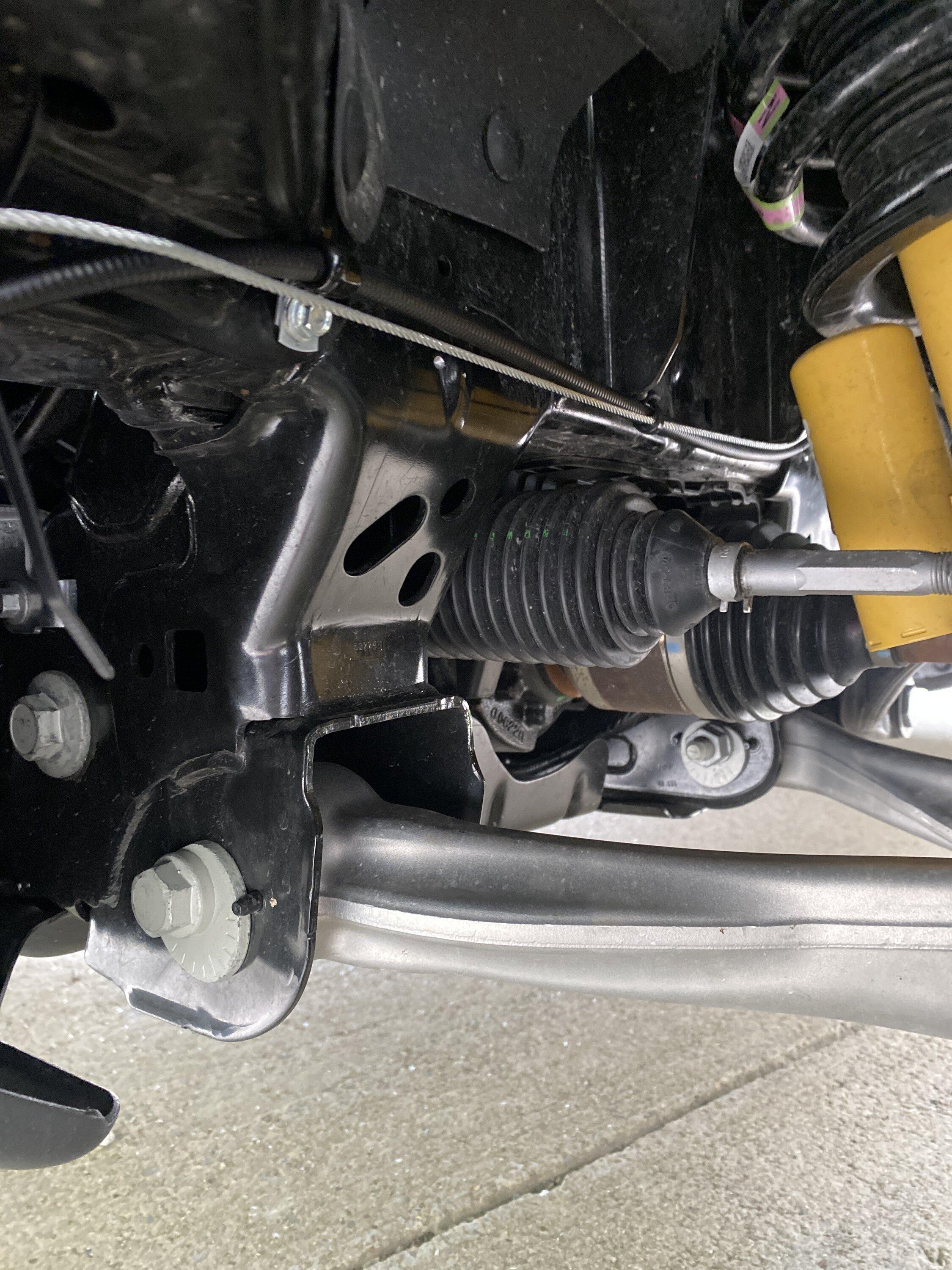

We use this. 2.7 Bronco. If you are somewhat mechanical you can do the install. The routing of the cable from brake pedal to the Ready Brake is not a straight shot on the Bronco. We have the Black Diamond and the skid plates, steering rack etc... make you need to figure a route that does not bind the cable. We did it over a few days with the Bronco up on blocks with front drivers wheel and wheel well liner removed.

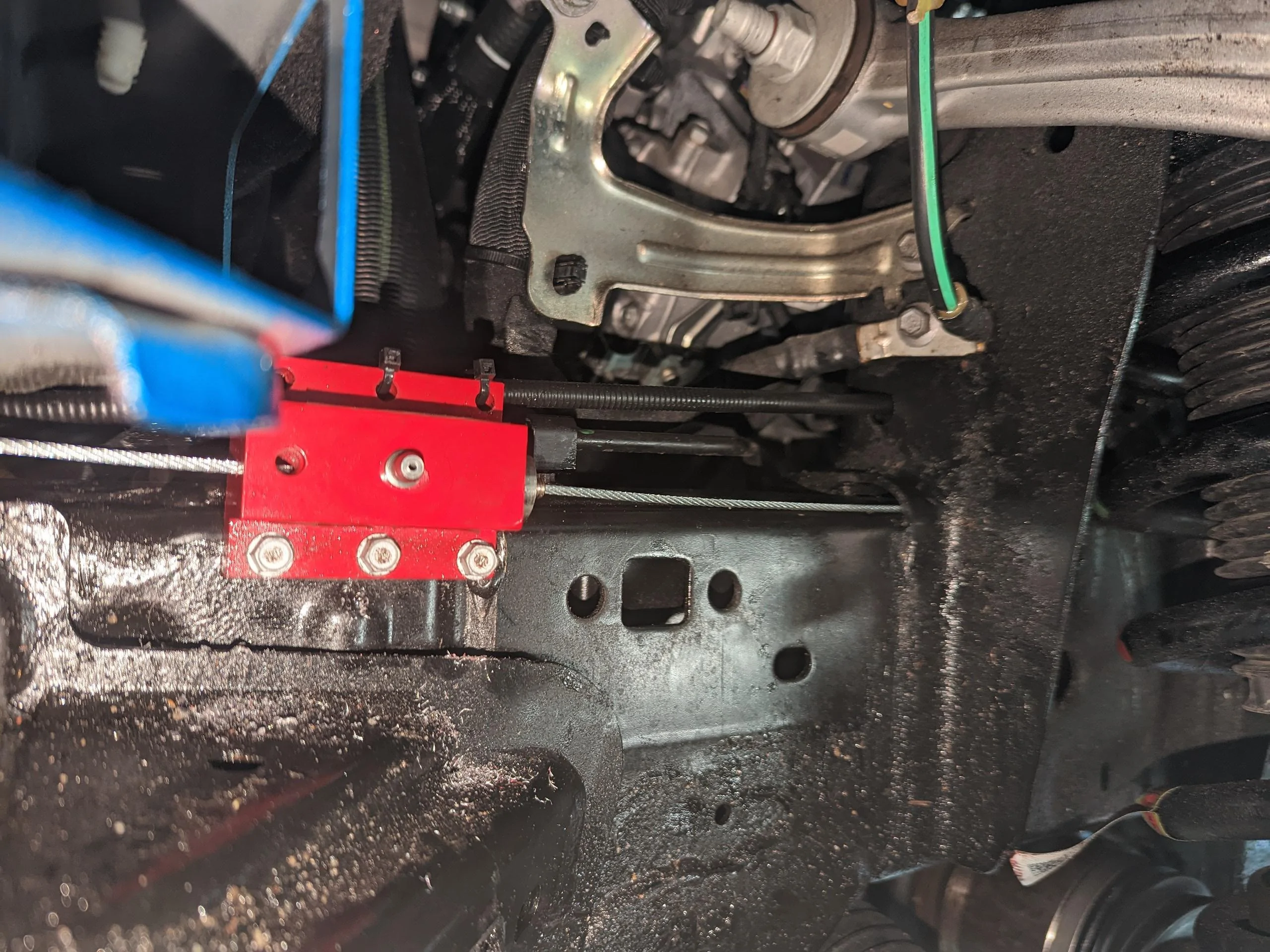

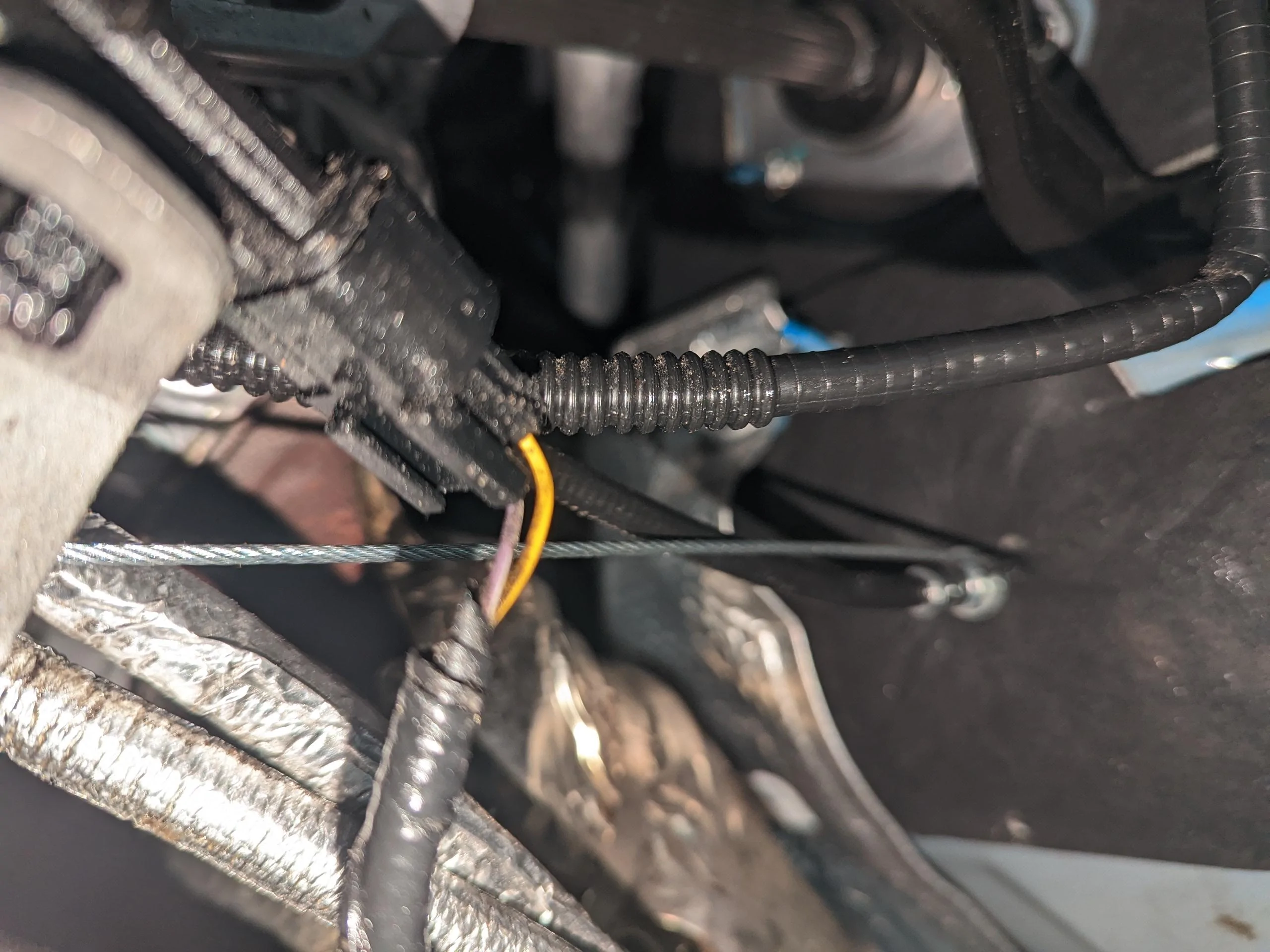

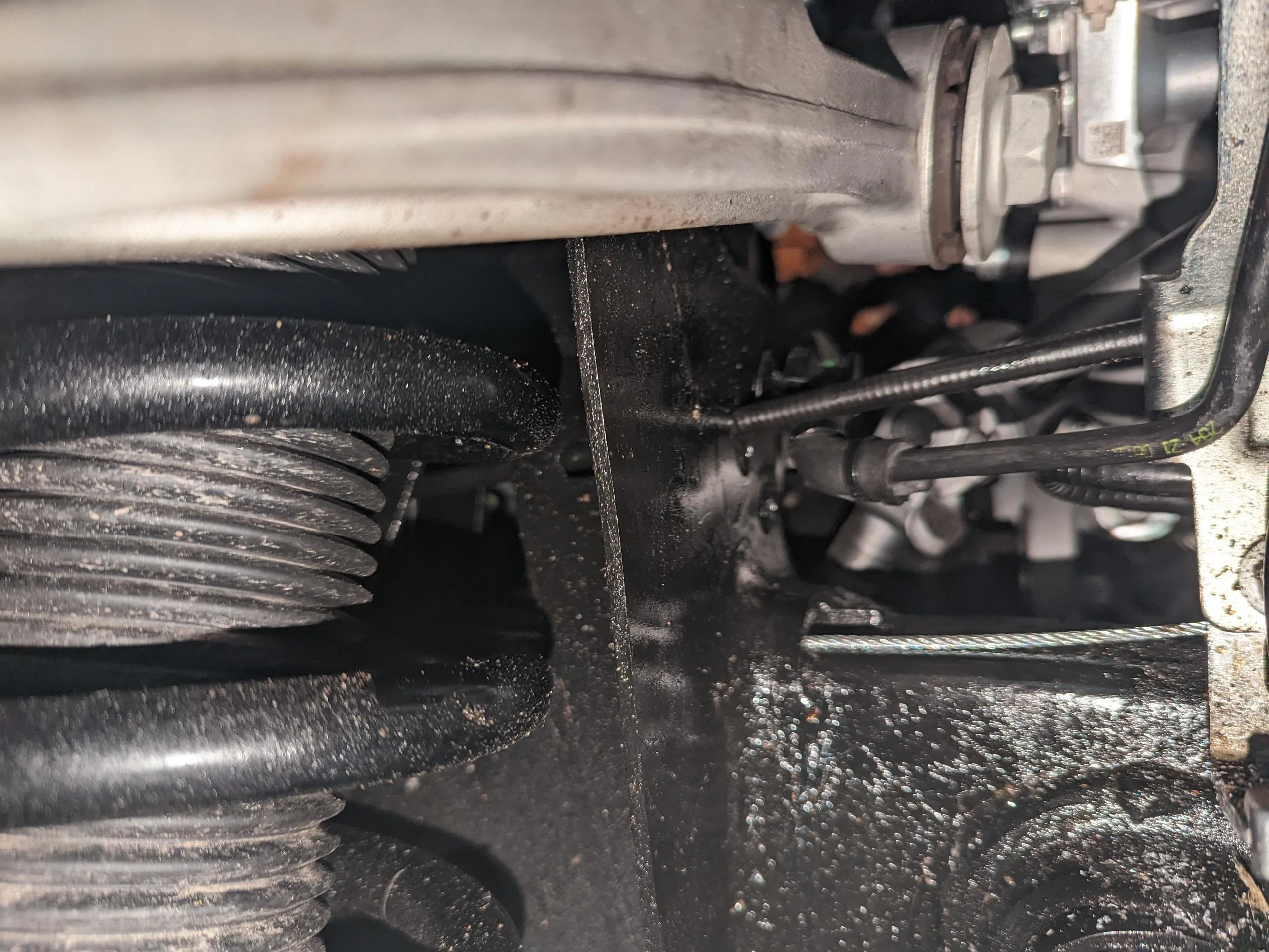

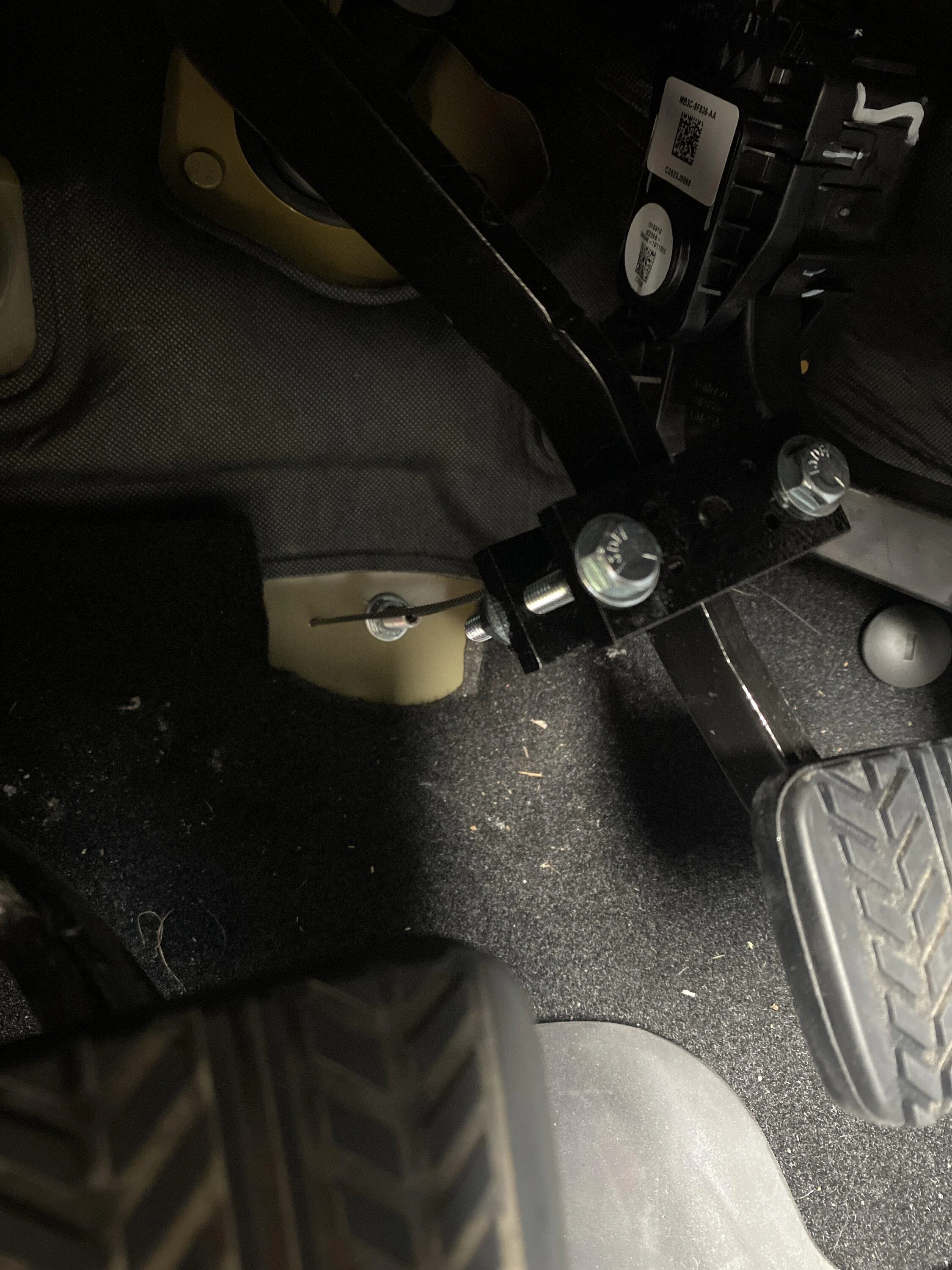

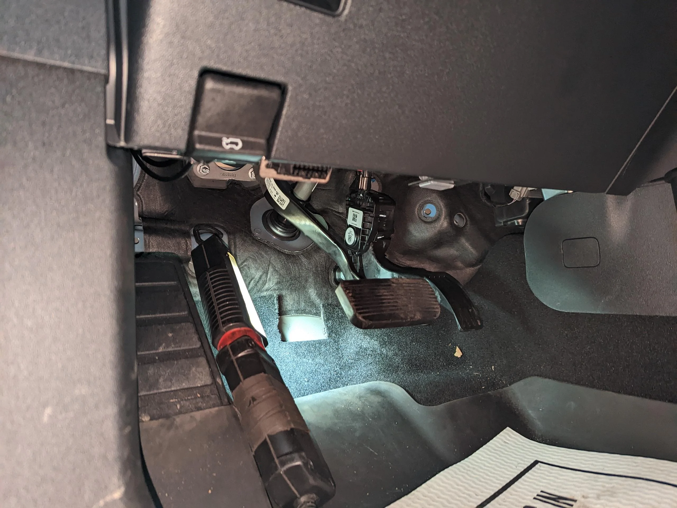

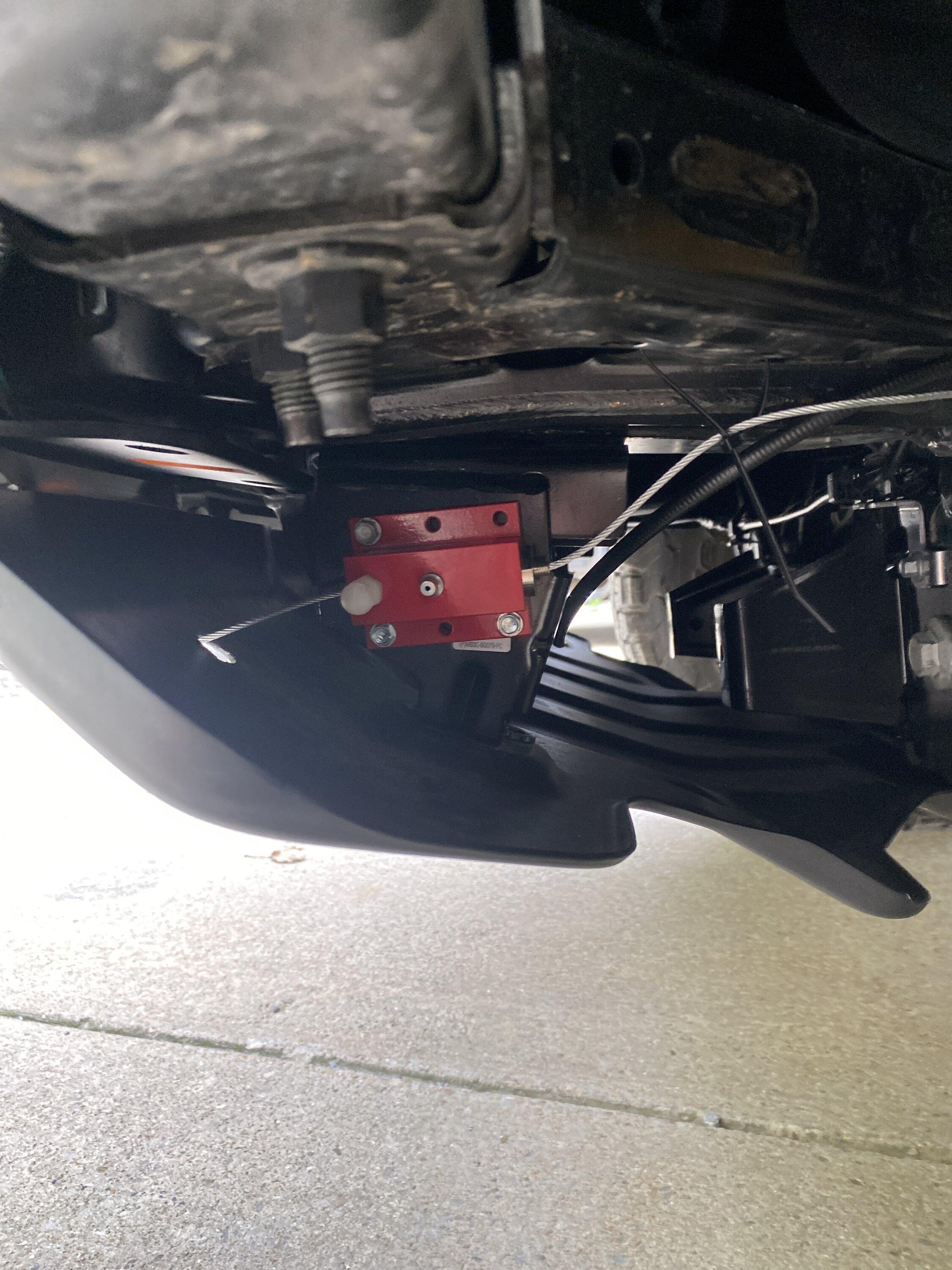

I’m doing the ready brute install this weekend so far easier routing than the jeep.
Ranbronc
Sep 22, 2020
179
183
Pa
Early Bronco
pictures of routing and drill hole locations when done...
might save me 2 hours staring at it trying to decide

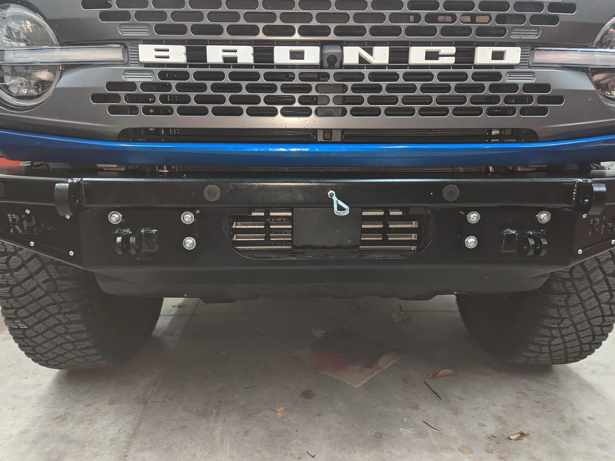

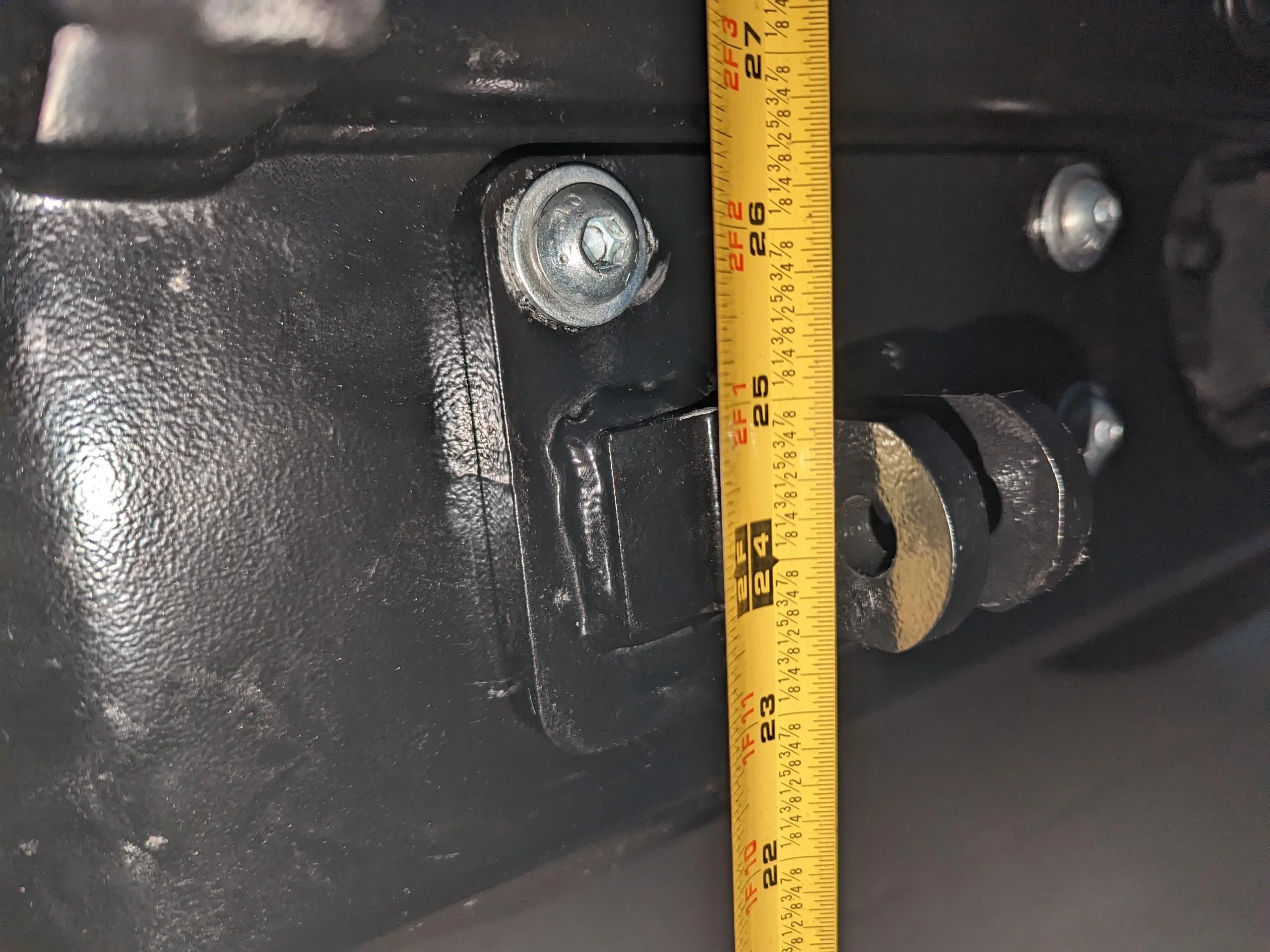

Thanks for the pictures ,helps alot.
is that a standard badlands? no sasquatch ?
what it the tow tab height?

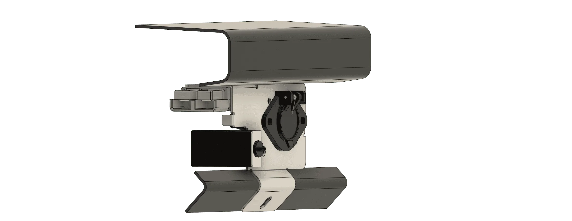

I bult a plate for the RV to TOAD 6 pin connector and breakaway switch if that is the connector mount you are talking about. I have the Modular Bumper but don't have the ACC so I'm mounting it right in front of the (empty) box for the ACC radar. I've actually removed the box to get clearance for the breakaway switch and 6 pin socket.
Ford Bronco Ready Brute flat tow setups Toad Wiring Plate Assembly v55 Back Sid
