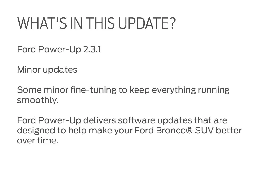

Oh well. So much for us all getting 12” screen upgrades 😆
My system is all out of wack. It’s now reverted to 2.3.1 and says it’s up to date.
It somehow had Auto Updates turned off - but, that’s new since last service. I turned it back on and made sure it was connected to WiFi.

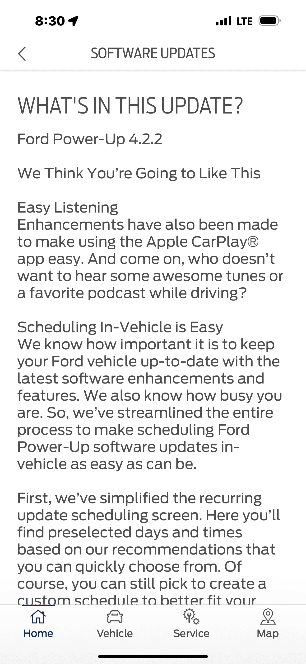

I got an update to 4.2.2 on the 13th for my 8in screen.
That may have been for the recall. Unfortunately I doesn't really say which update the recall will be included in. Did the update details say anything about it?
Just this boilerplate

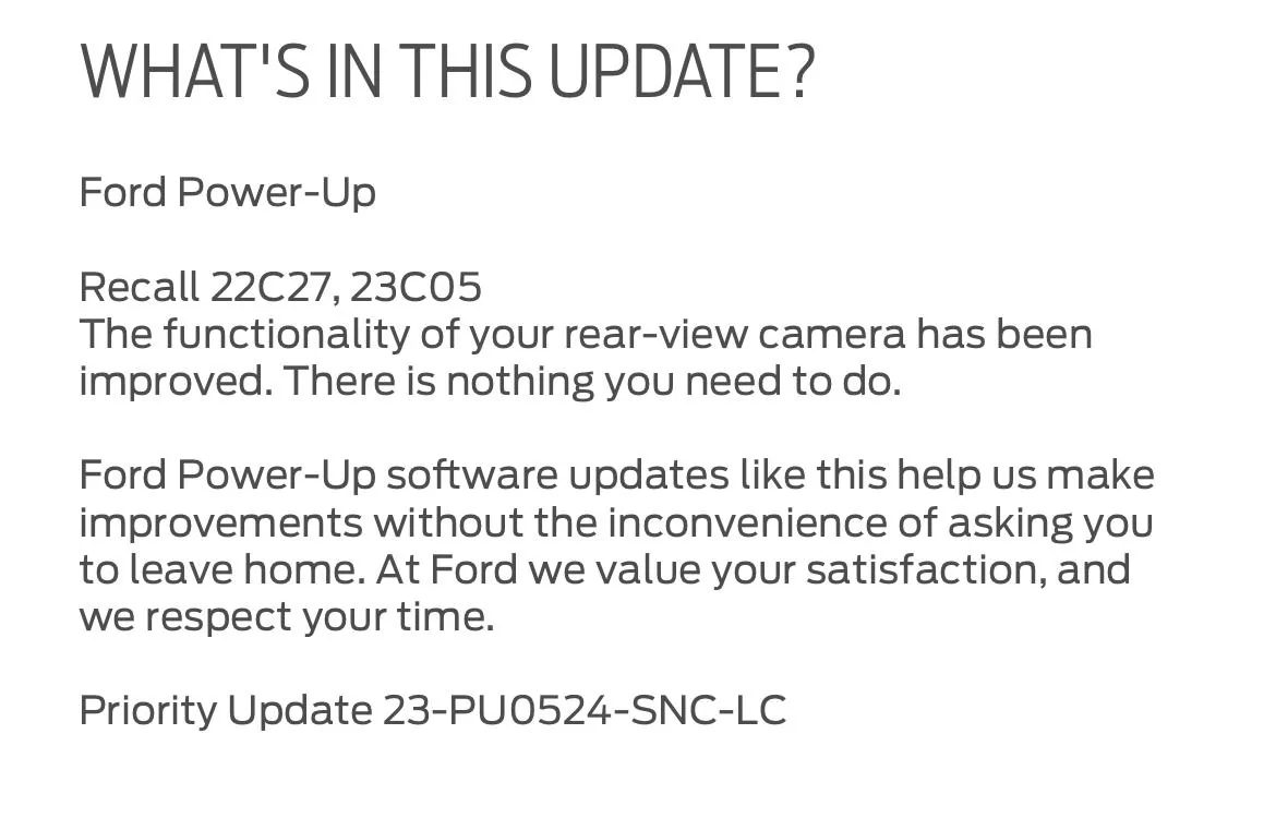

It’s weird. The OTA worked earlier this week - which means that’s the first update I’ve had since Sept 2022. But, it doesn’t give a version number like @Sherminiator. Just that the recall fix was successfully installed.
Maybe his wasn’t for the recall 🤷‍♂️ not sure.
