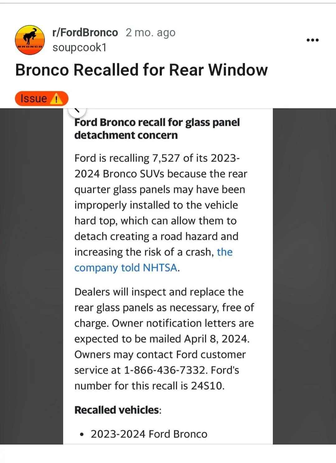

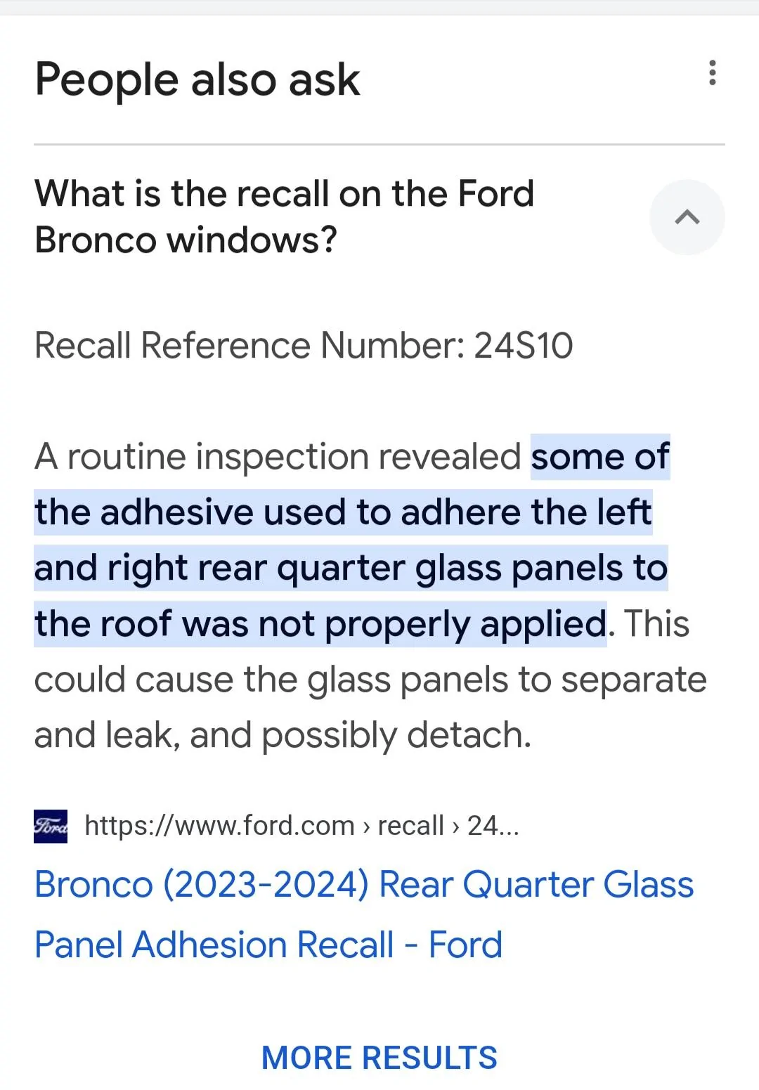

Saw this and people talking bout their experiences..mine makes noise like someone walked by and hit it, but nobody there, randomly
Ford Bronco Rear Window Explodes, No Clue Why????? Screenshot_20240508_203525_Chrom
Ford Bronco Rear Window Explodes, No Clue Why????? Screenshot_20240508_203011_Googl
