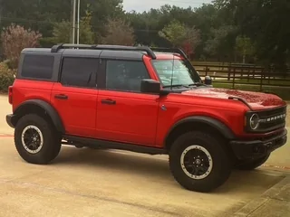

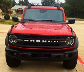

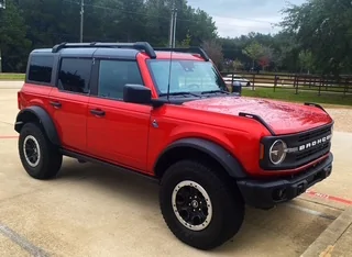

My thanks to the many people who have responded to my original message. Y'all have provided a lot to take in. Before responding further, I wanted to take some pictures of my vehicle, which are now attached.
After considering your responses, I think pillar lights are a good idea. They range in wattage from 20W on up. Since I am not racing or going off-road, the utility of these lights, depending on how they are focused, is to brighten the road ahead. It appears there are lenses that direct the light to the front and the side. How many watts do you think are sufficient?
Secondly, please have a look at the front bumper of my Bronco. The vehicle has OEM fog lights. Some are saying it's a good idea to add on a more efficient set of fog lights. With the bumper you see, is this possible? If so, what do you suggest?

Yes, your fog lights can be updated. IMO this is most impactful and least expensive upgrade path to accomplish what you want.
