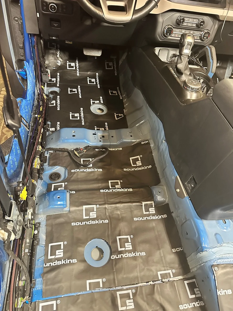

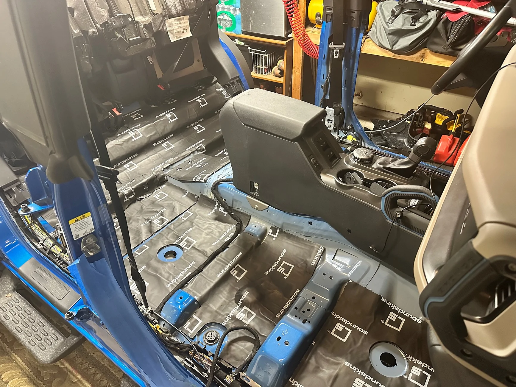

Question, does having the sound deadening underneath it affect that water drainage to the passive drains? I guess Im not familiar with the material, whether it would displace water or trap it in place...

I used a precut kit and it fit nicely around the drains. The deadening material is waterproof and water won't be able to get underneath it if it's installed well, so it shouldn't block enough drainage to make any difference.
