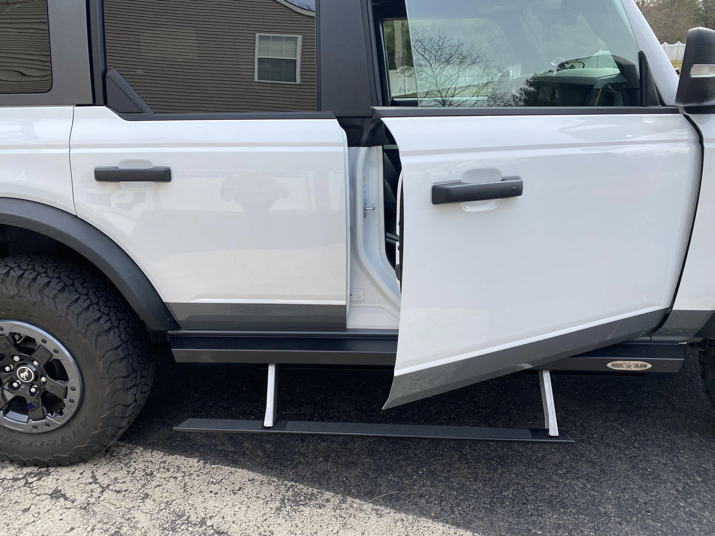

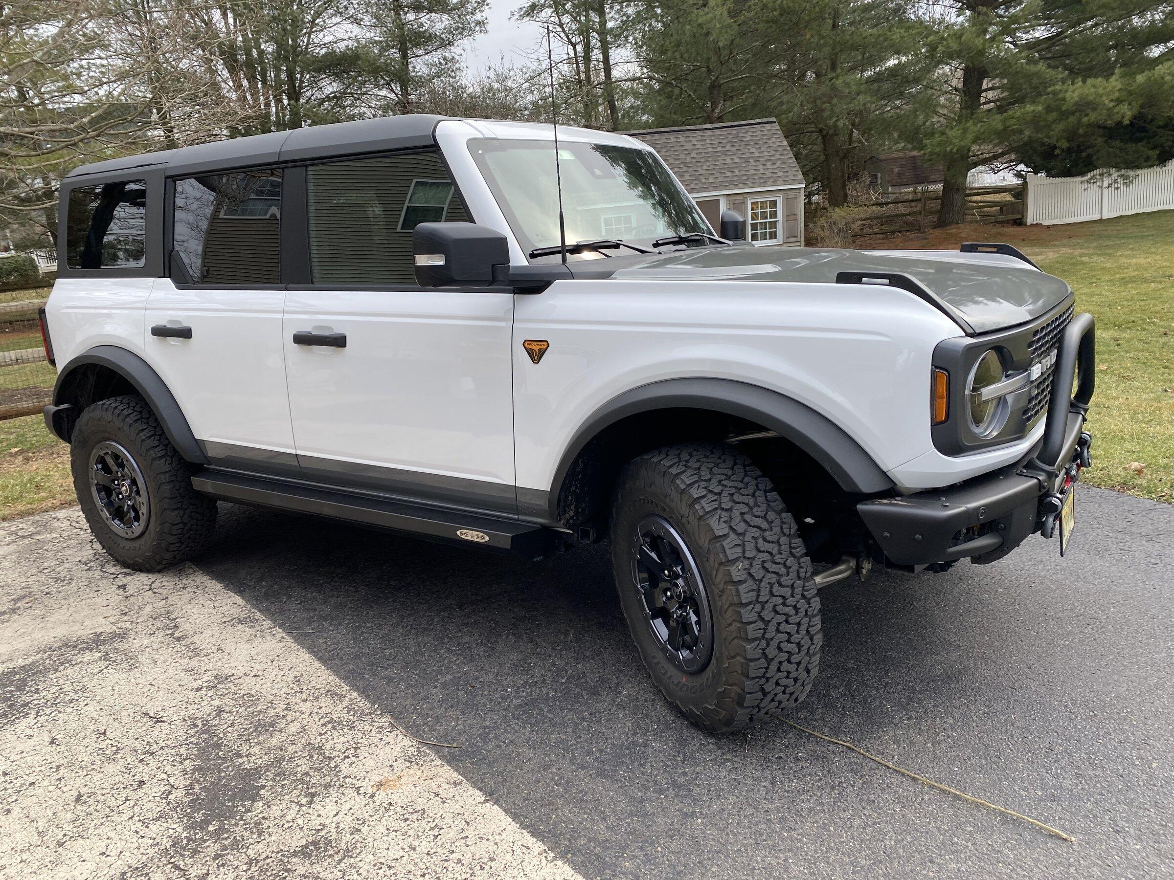

There is joy in Mudville, or at least my portion of NJ! Got my Rockslide Steps late yesterday and was able to get them installed by this morning. I called RSE to make sure they did not want us to use Loctite (blue) at least on any of the anchor bolts (they don't) and while on the phone they referred me to an awesome install video by Motoroso -
Ford Bronco Rockslide Engineering Steps - GROUP BUY has started! IMG_7054

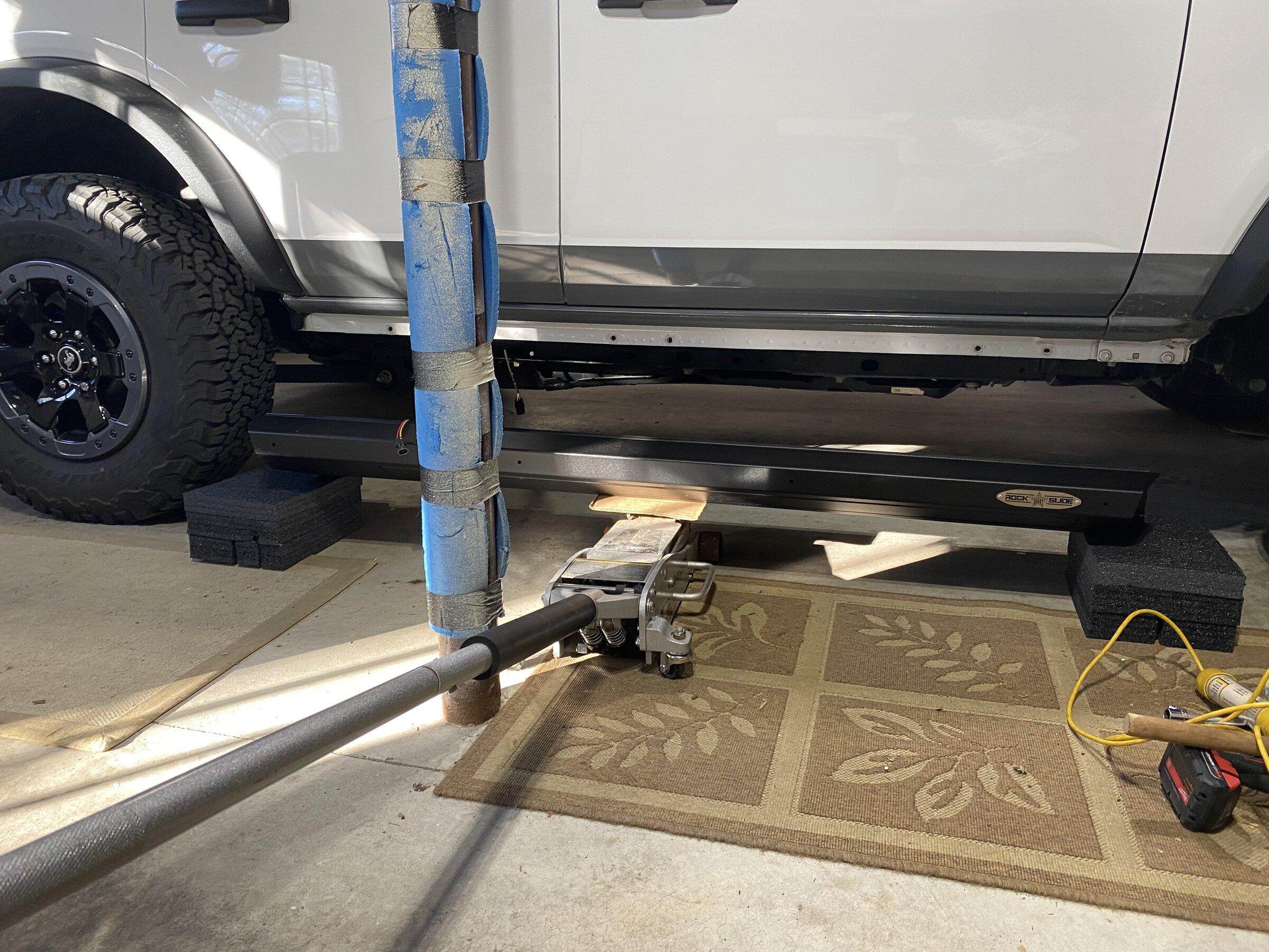

As you can see in the pic - the hard foam they use to secure the steps during shipping is perfect to position the step for using a floor jack to raise the steps into position. I just used a piece of the cardboard to keep from scratching and enable them to slide for slight adjustment.
It was so good I decided it would be useless for me to video my install. I will share a couple pics and pointers, though. They make note of making sure that you leave the brackets a bit loose and that when you move the steps into place with the pinch bolts, that you then tighten those up to draw it into place (using 7/16" and 1/2" deep sockets) and then torque them to 8 and 18 ft lbs respectively. Once those are in, place the bottom bolts (1/2", and use an impact driver and save yourself a lot of grief to attach steps to the brackets.
Finally, then you can go back and tighten all the body bolts and bracket bolts and it should all be snug and in place.
The Amazon longer magnets allowed for much easier placement and I did not have a single issue with any of the doors activating properly. My wife was overjoyed at how easy it was to get in and out now - well worth the money! Thanks for the great deal @Doetsch Off-Road!
