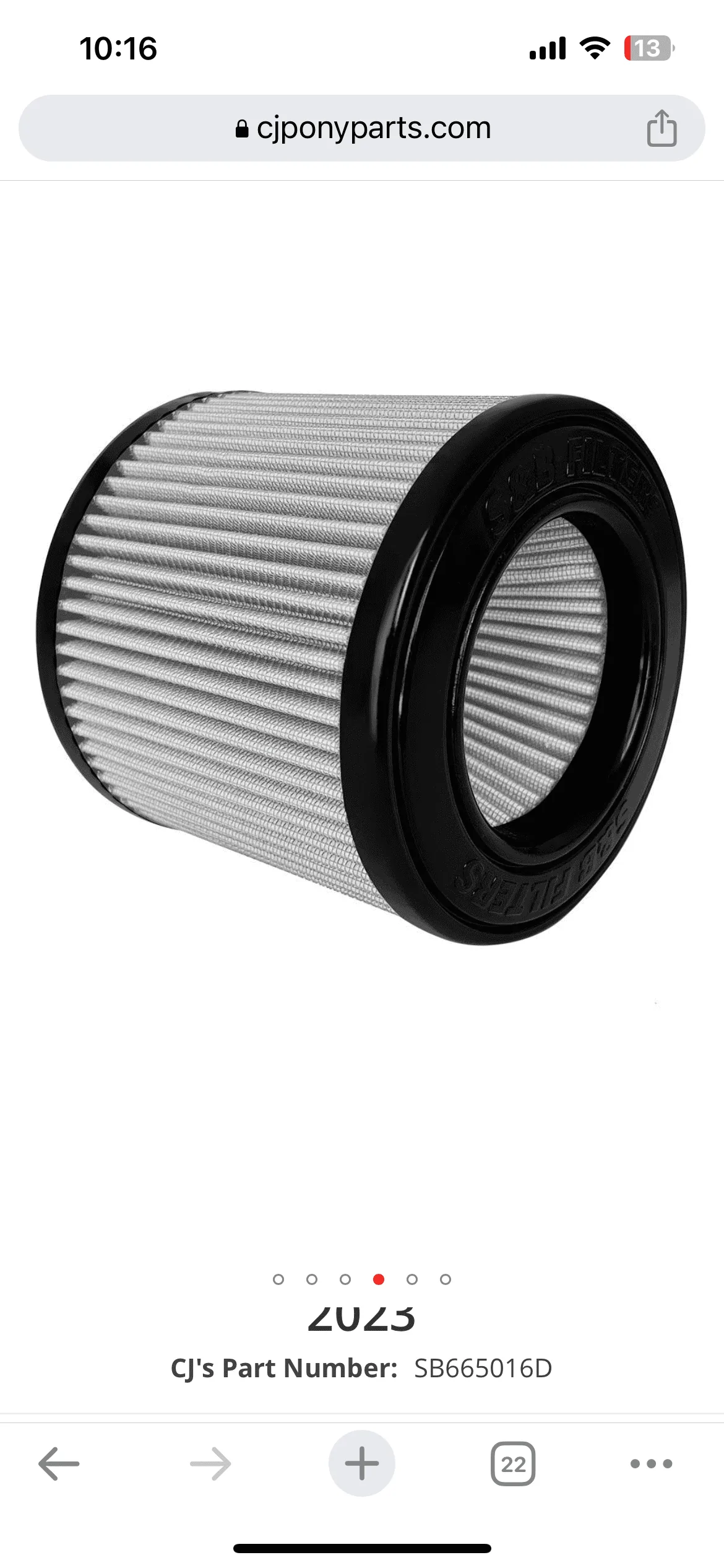

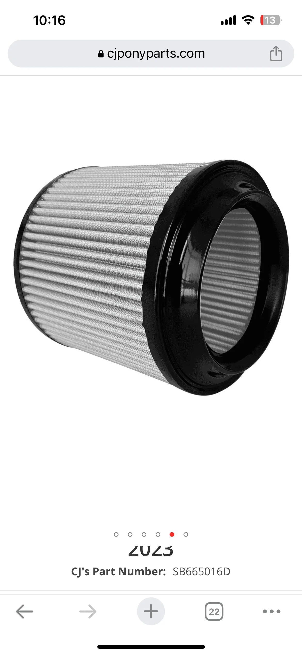

If I'm seeing what I think I see, the S&B doesn't have an end cap like the factory filter an has filtering area inside as well as outside. This could greatly increase the flow potential without reducing the filtering effectiveness.
you are correct.

I ran S&B CAI on my last two diesel pickups and the reason was twofold:
1. Stock was a Donaldson and though it was a great filter, somewhere in the $90 range back in 2015 to replace.
2. Took an hour, two men and a come-along to get it out and the hardest part was putting it back in.
I could do maintenance on the S&B in 15 minutes and with the clear cover it was easy to check.
