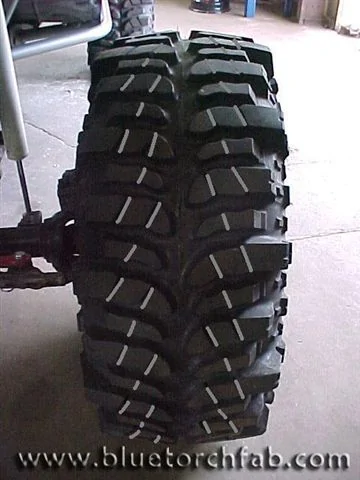

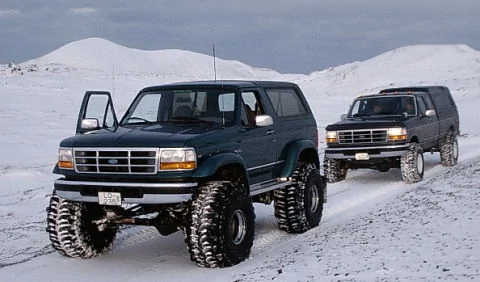

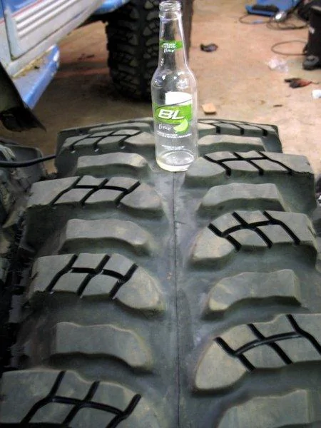

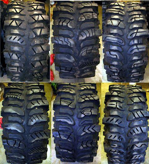

Super Swamper Boggers seem to work just fine in Iceland, best thing about Boggers is that the tread is so thick you can cut sipes in em with an angle grinder or a siping iron. Its really easy, i did it one year to a set 33x14s that had about 30% tread left. Got me through 3 more winters in my CJ5.
Ford Bronco sasquatch + snow 1996-ford-bronco-picture-with-f-250
This is similar to how i cut mine. Worked great, took about 2.5-3 hours for all 4.

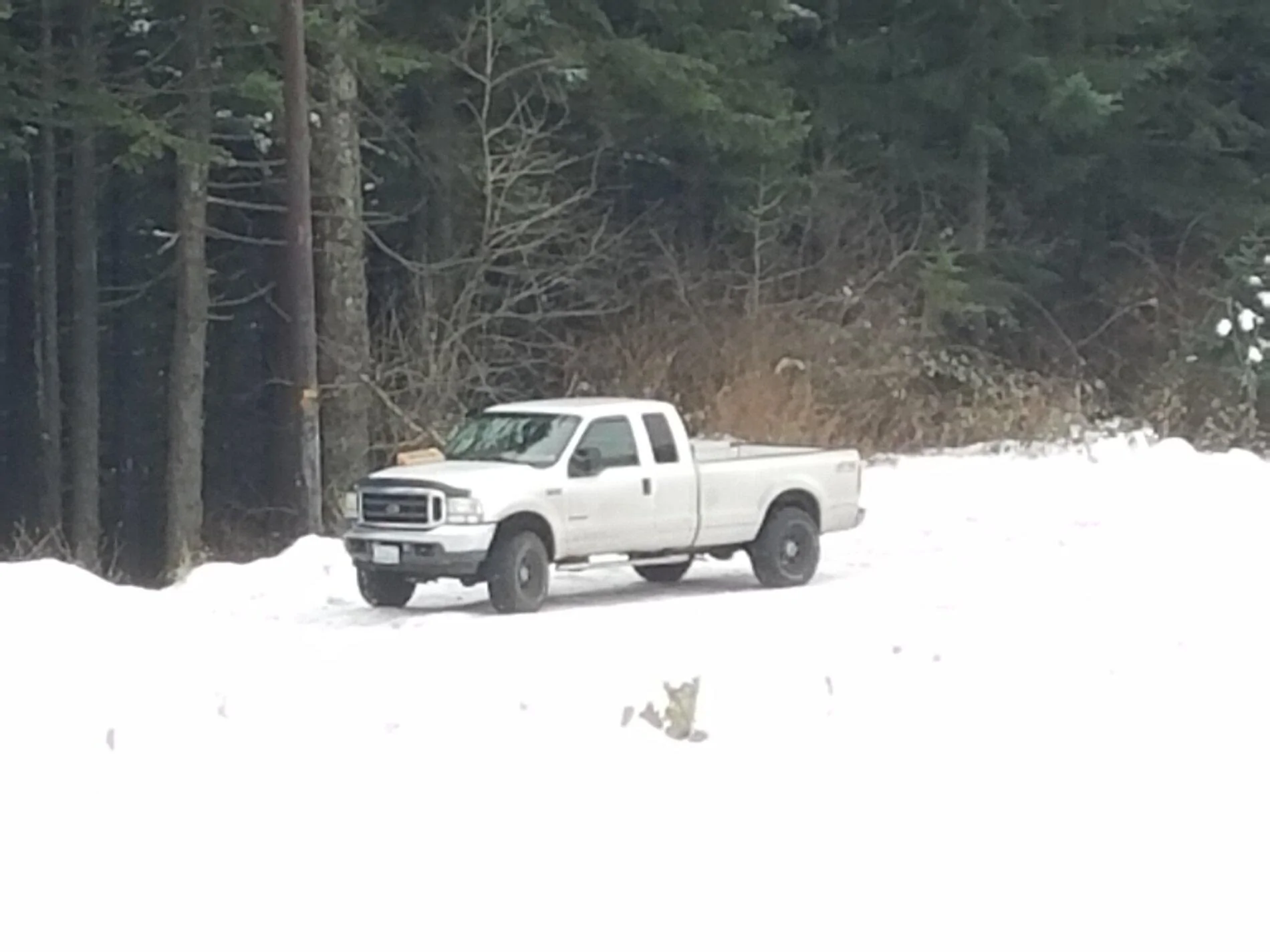

Ko2s on my F-250 and it does just fine in the snow
