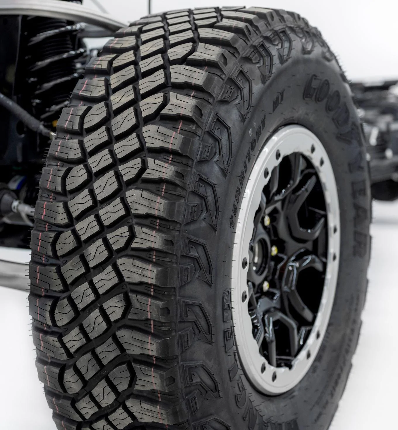

The Goodyear Territory M/Ts that come with Sasquatch look like they will actually preform pretty well in snow. Plenty of siping, and lots of individual tread blocks that aren't spaced too far apart.
They ARE NOT a mud tire. More like an aggressive all terrain.
That said. You will never do better in snow than a dedicated snow tire. And I DON'T mean a studded tire. I personally don't like studs, though they do have their place.
I actually run 37" Toyos M/Ts, which are a trash tire BTW, year round on my F250. If you know what you are doing, and know the tires limits, you can make a mud tire work in the snow. But it won't be ideal. I have to be super careful when it's icy with the Toyos. I'll actually just drive my car with its winter tires most of the time.
I will always recommend someone worried about snow driving replace whatever tire is on their vehicle with a DEDICATED, WINTER SPECIFIC tire when the snow flies.
Correct, these are multi-terrain (M/T) not mud tires. There is a thread somewhere in here that has 45 minutes with Goodyear tech heads talking about these as OEM specific for the Bronco.... Should be decent in snow but nothing matches a snow tire like Blizzak, but snow and rubber will always be snow on rubber. The best snow tires from Scandinavia, Haks (NOKIAN HAKKAPELIITTA), are covered in snow on the whole rotation of tire. The siping crimps the snow to the tire since snow on snow is the best traction.
