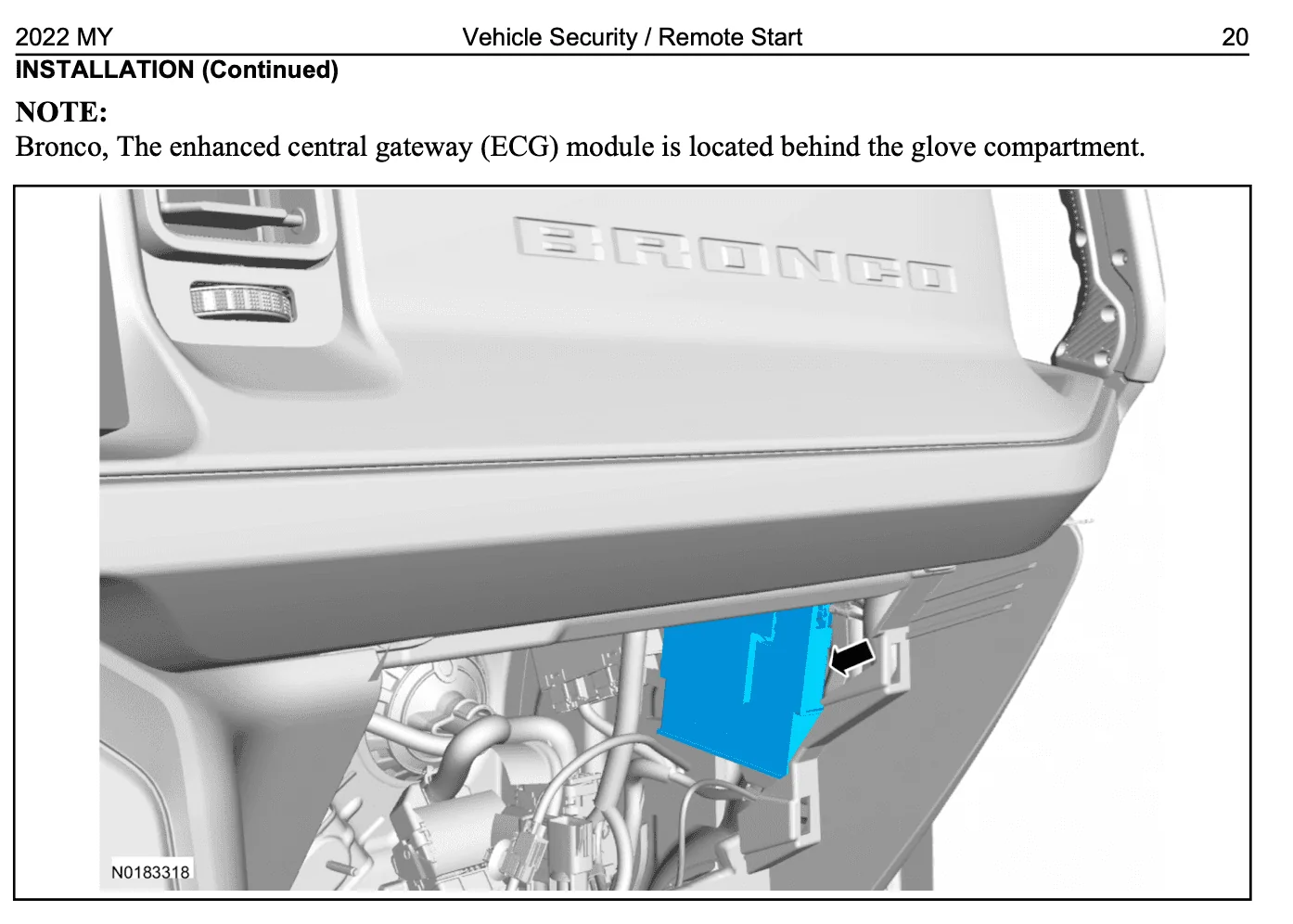

I think these are the DIY instructions. After looking through that PDF, the DIY is a lot easier than they make it look. You literally just unplug the harness from the module behind the glove box and plug the harness into the new security module. Then connect the other side of the module into the existing module behind the glove box.
15. Disconnect the Gateway Module electrical connector, plug the VSS T-harness into the back of the module and plug the other end of the VSS T-harness into the vehicle harness.
Ford Bronco Securialert Screen Shot 2022-04-28 at 9.53.31 AM
  1. Install and secure the VSS module to the instrument panel frame or wiring harness on the driver side of the vehicle to the left of the steering column.
    • Ensure the VSS module is positioned so the shock sensor adjustment knob can be accessed for later use.
    • Ensure the tie-strap is routed through the VSS module loops at opposite corners.
  2. Connect the VSS harness to the VSS module.
    • Secure the VSS harness with tie-straps.
