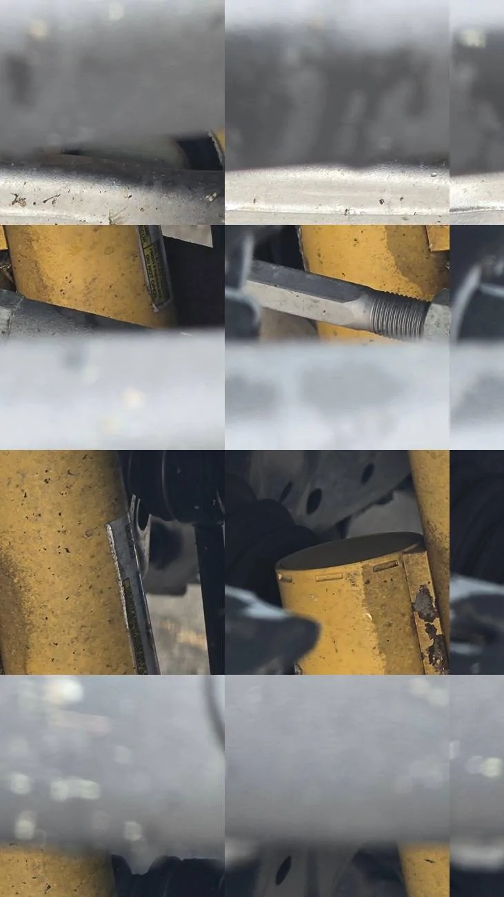

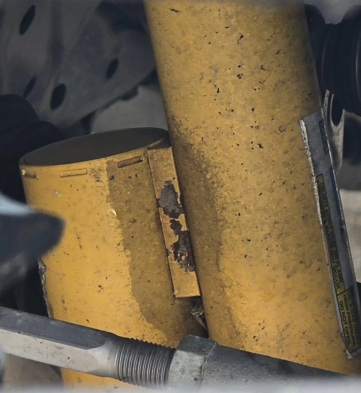

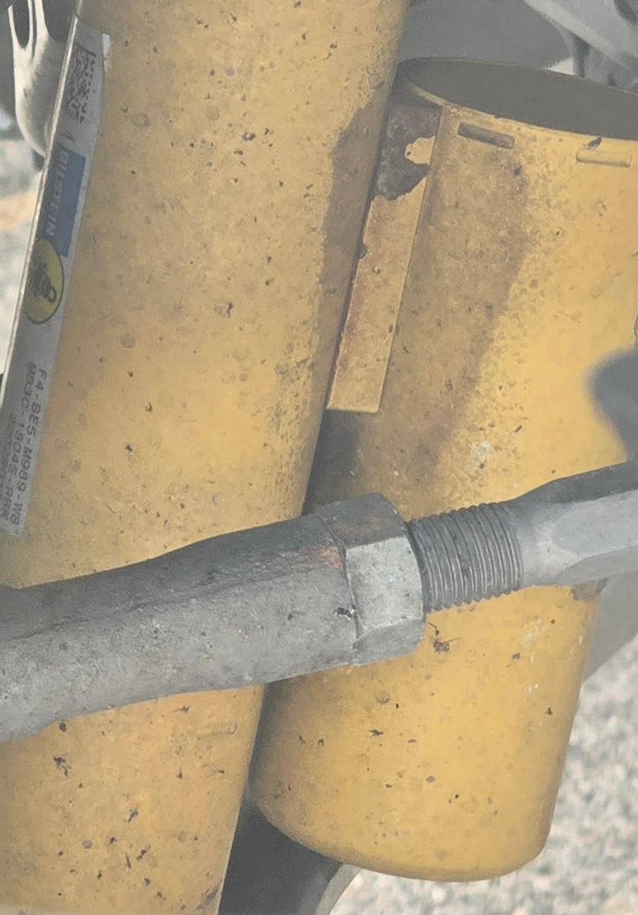

It seems like shocks are leaking or corroded. What do you think is this normal or definitely look into warranty?

I don't see any evidence that they are leaking, though it is hard to discern with the photo mashed up into individual quadrants. There is plenty of evidence of the paint being chipped and rust forming on the unprotected metal. Why would you think that would be a warranty item?

Those shocks are garbage, replaced my 1st one at 42k miles after it rusted and all the fluid leaked out. Once the others started going I replaced with different shocks.
Some of your pics do show what appears to be the fluid leaking out. I've heard some people have got warranty replacements, and some haven't. If you want to go that route contact the dealer and see if they go for it. But my advice would be to swap that garbage out for something better.

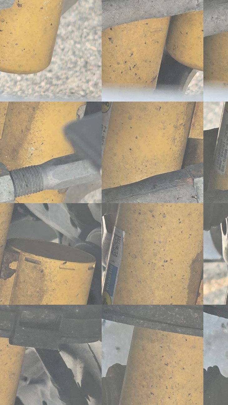

I don't know why the pictures keep uploading like that. Yes there's rust and small leak. How long does the shocks normally last. I never had a car need new ones until after 70k 100k miles. I wonder how people got it warranted
Typically they last a lot longer than 25k miles. But these (as many people have stated), were built to Ford's specs. They are cheaply made and there are countless threads on here about people having this same issue. Quite a few even had the entire reservoir pop off.
Since I have the Sasquatch package I just went with the Bilstein 6100's (no reservoir), they work with the squatch springs and I think I ended up getting them for under $1,000 off ebay. No problems since.
Well rust isn’t warrantable.
And that isn’t a leak, so it wouldn’t be covered at this point.
If the reservoirs fall off like many do and you’re still under 3/36, then it would be a warrantable issue.

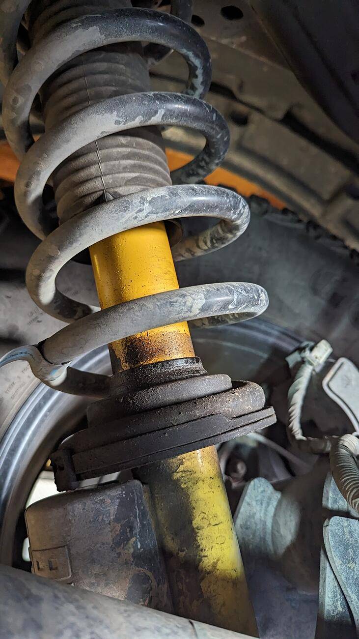

I got the rear right shock replaced under warranty at around 15k miles. The request was approved without asking any questions.
