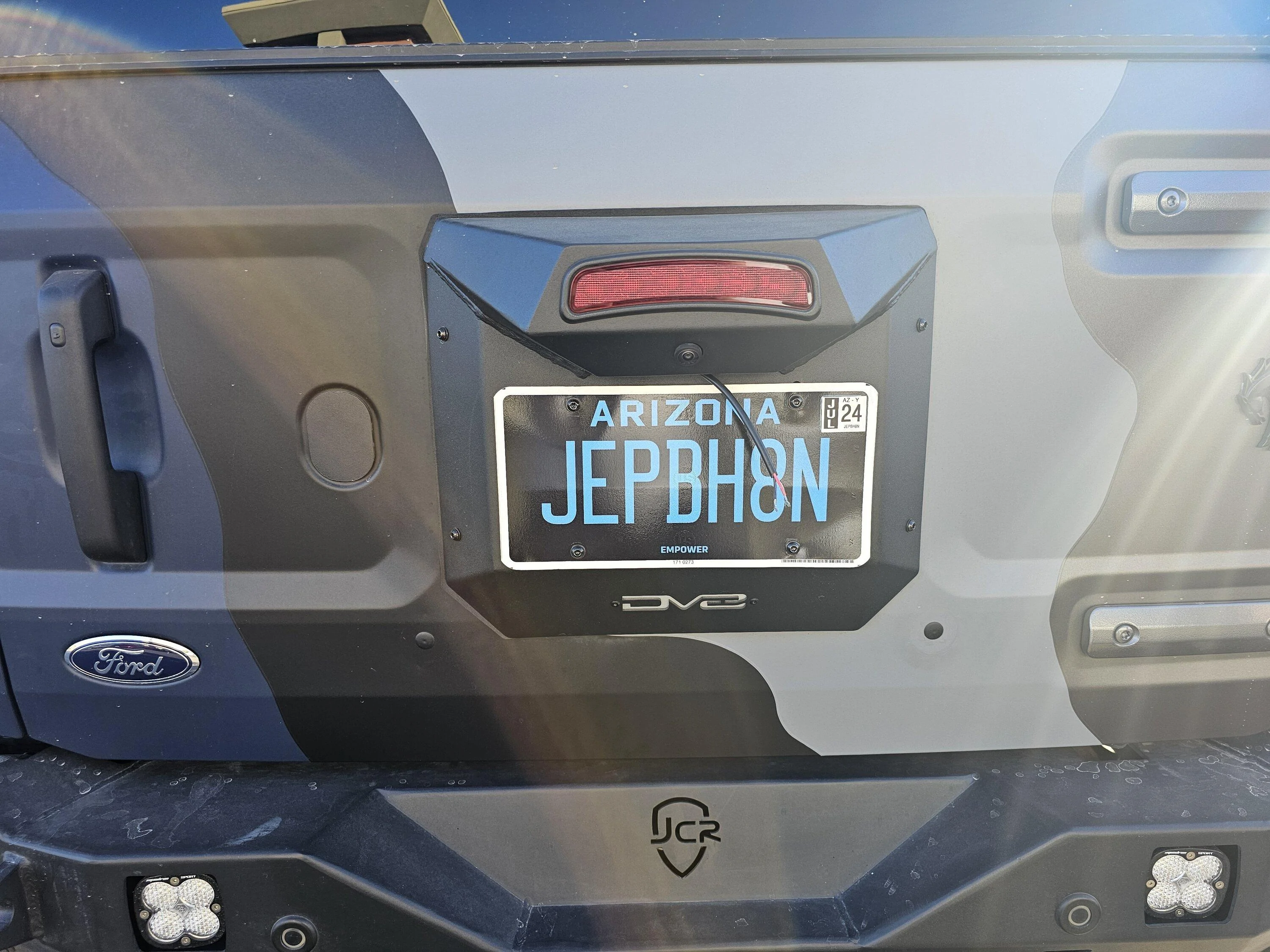

I do have some Baja Designs in my rear bumper, but they are not chase lights.
I sounds want some up a little higher perhaps.

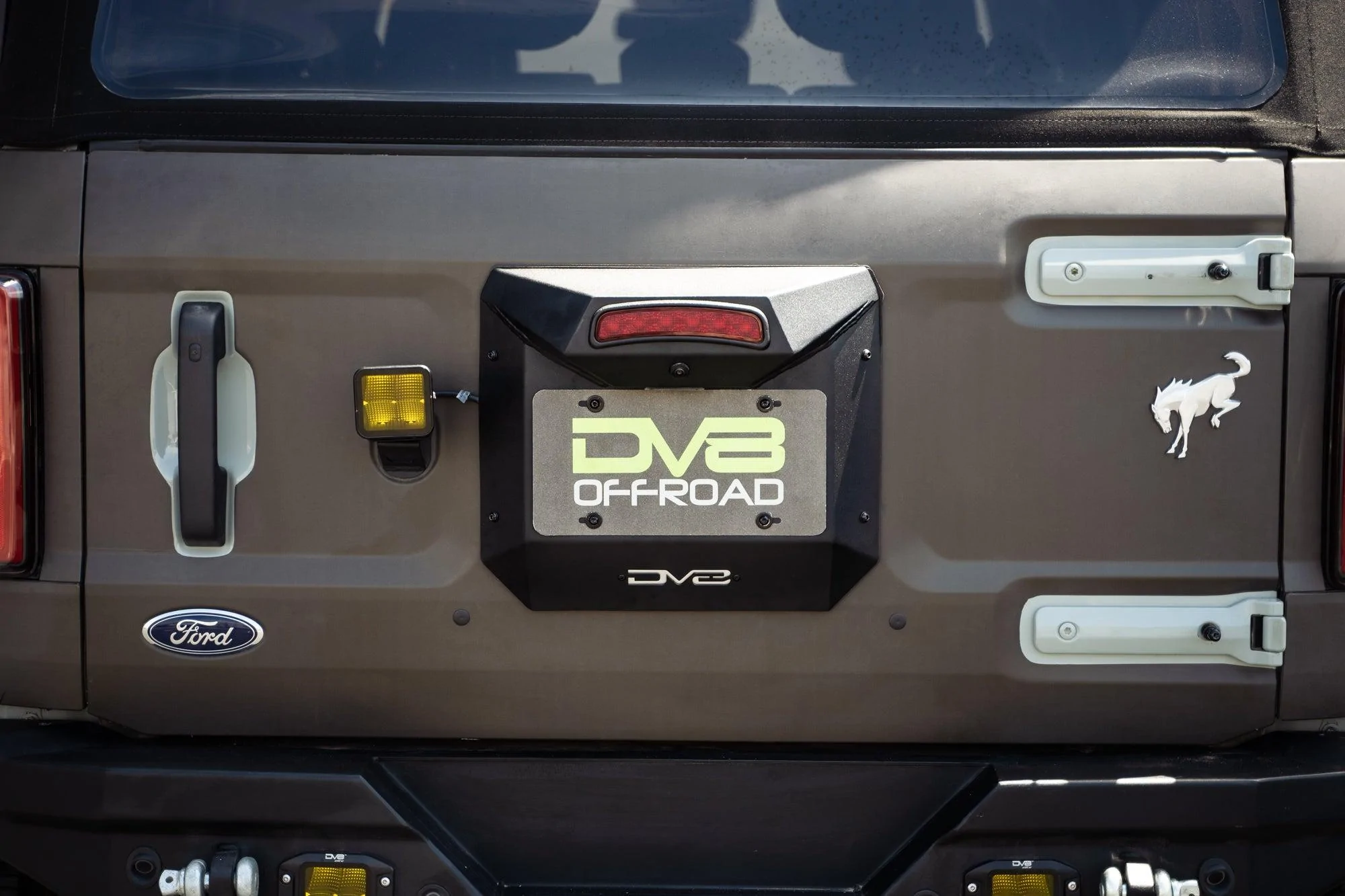

DV8 now includes a pod light mount with their spare tire delete kit that mounts into the hole left of the plate mount as seen here. I'd contact them and see if they'd be willing to send you one.
Ford Bronco Show Us Your Reverse / Rear Chase Lights! ord-Bronco-Spare-Tire-Delete_Installed-1_2000x1333
Now, personally, I don't care for the look of this as it seems like an after thought.
If it were my truck, I'd drill into the top plate of spare tire delete on either side of the integrated 3rd brake light and mount a pair of S2 Sport amber lights there.

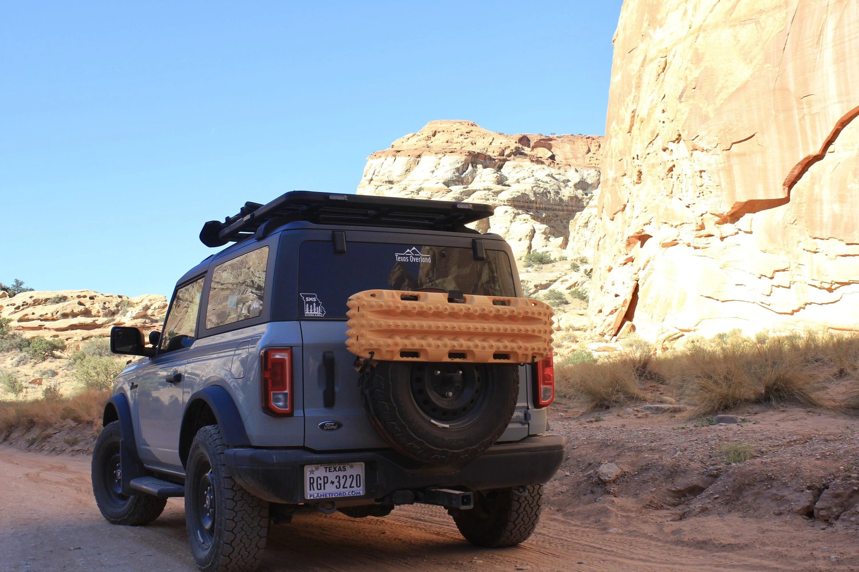

Notice the flush mount lights I installed on the roof platform. Rear lights are automatically activated when put into reverse. Rear lights and side lights can be activated with AUX switch.

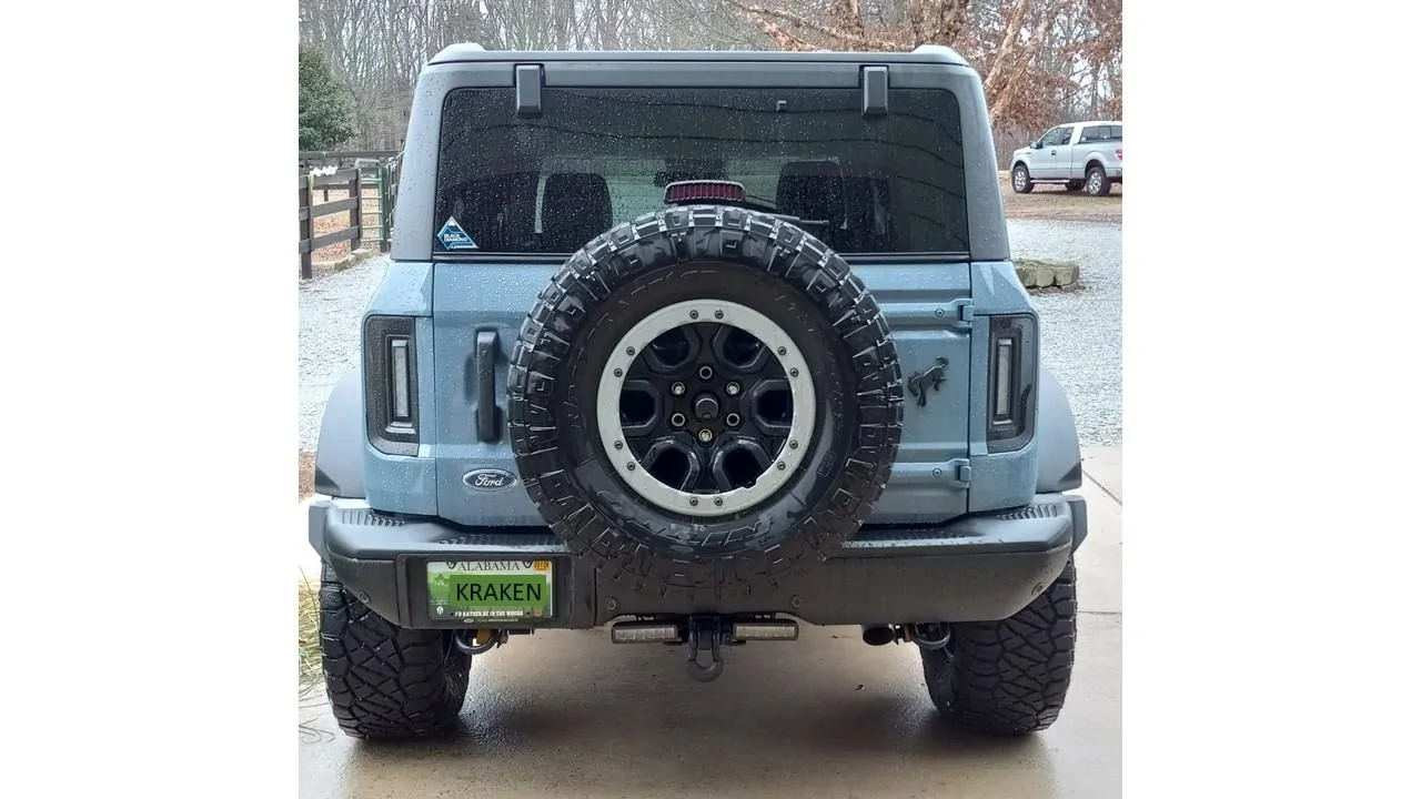

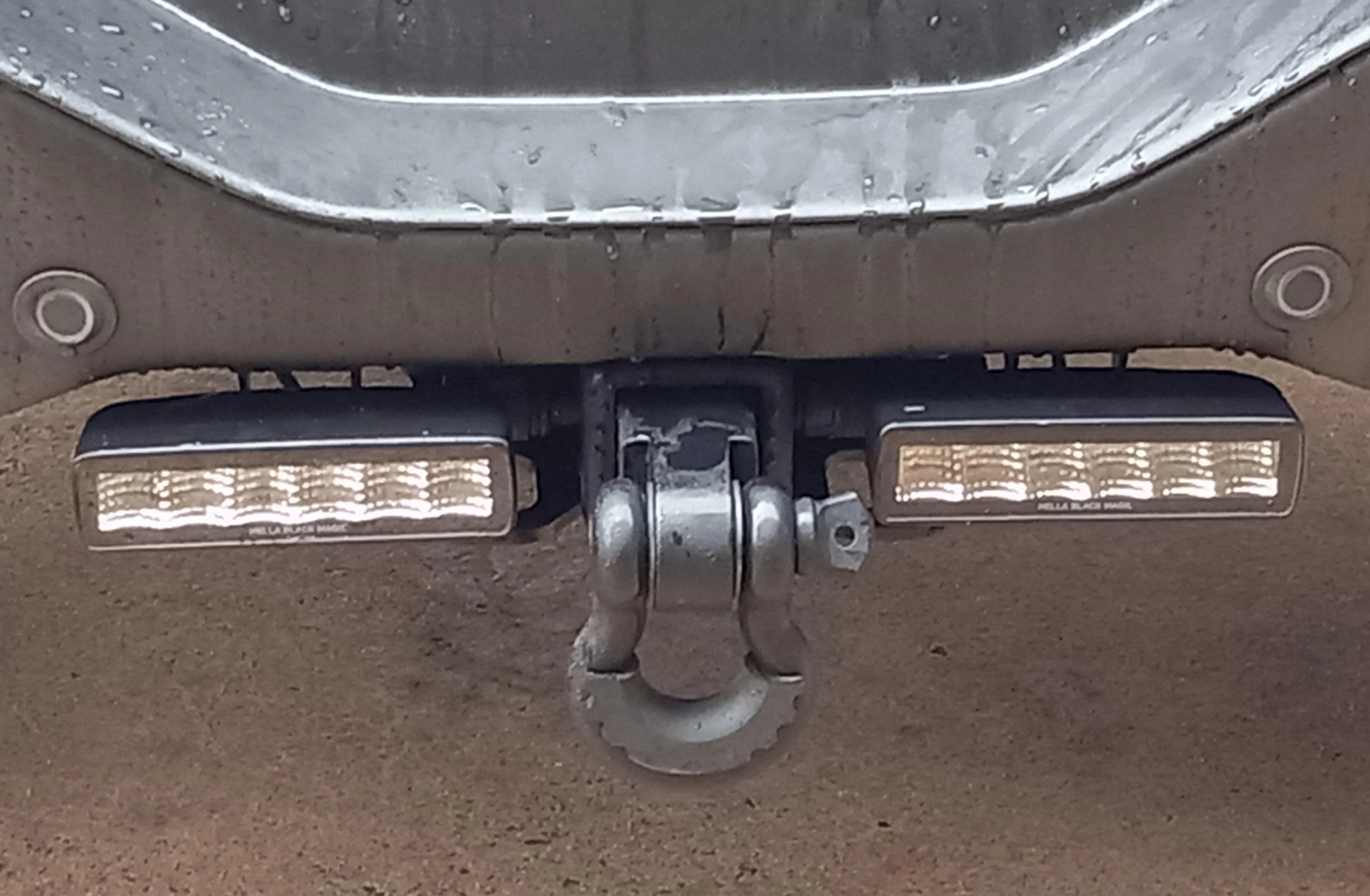

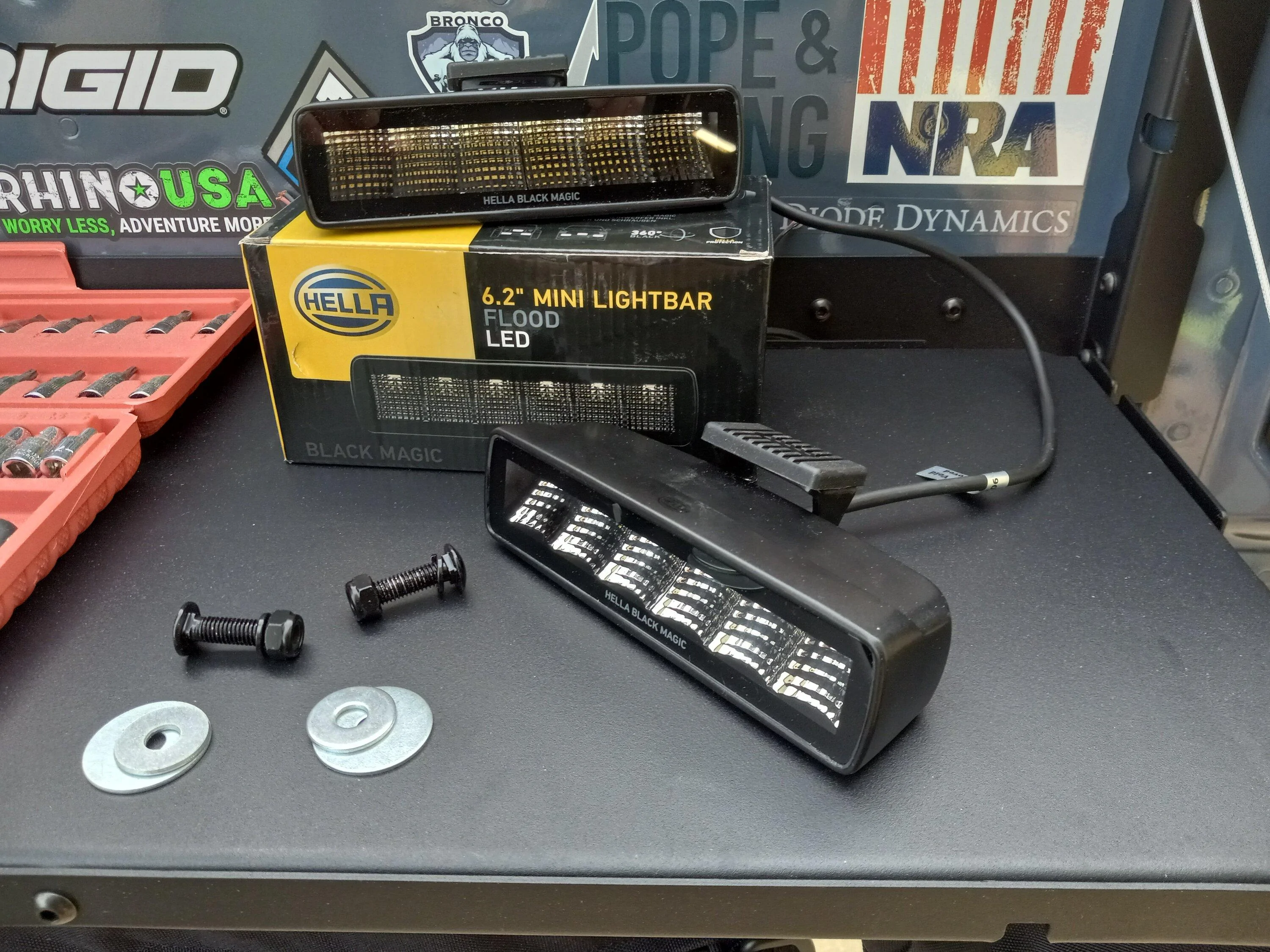

Thanks guys for the replies... definitely more ways than one to skin a cat. Here is my solution.
Two HELLA Black Magic 6.2 inch light bars tucked in on either side of the hitch. Drilled & mounted straight to the bumper with a couple of large washers as backing plates on the backside. I still need to get them wired... will be on AUX 6 switch only. I wanted the lights in the back to be bumper mounted so they would also provide lighting directly in the rear area with the tailgate open or closed. If these don't "tickle my fancy" I'll definitely go with a couple of flush mount lights.
