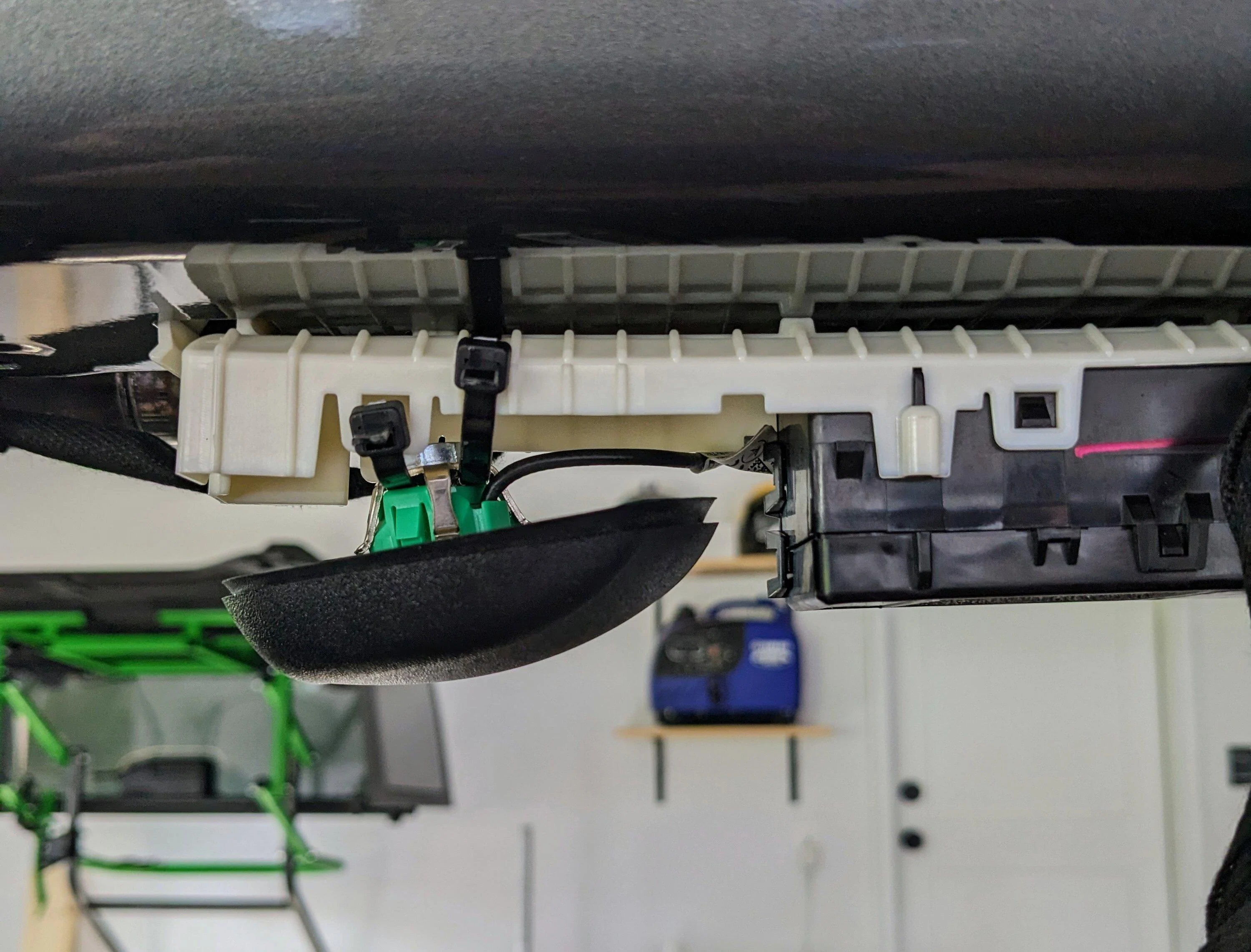

Update: so I followed the directions in the doc above and decided to just unbolt the antenna and then ziptie it off to the wiring that runs inside the rollbar (see below). This allows me to keep the antenna plugged in so there are no potential errors, etc. but now I have a completely smooth surface up top for strapping down kayaks etc. Works great.

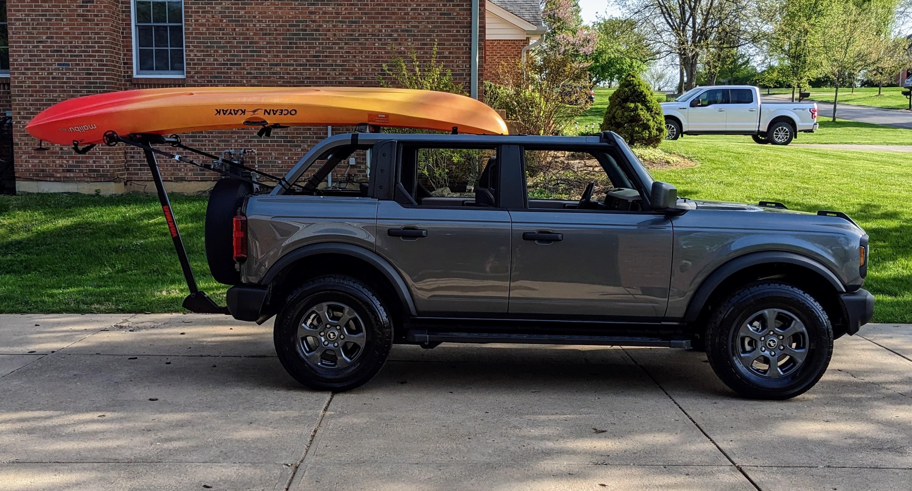

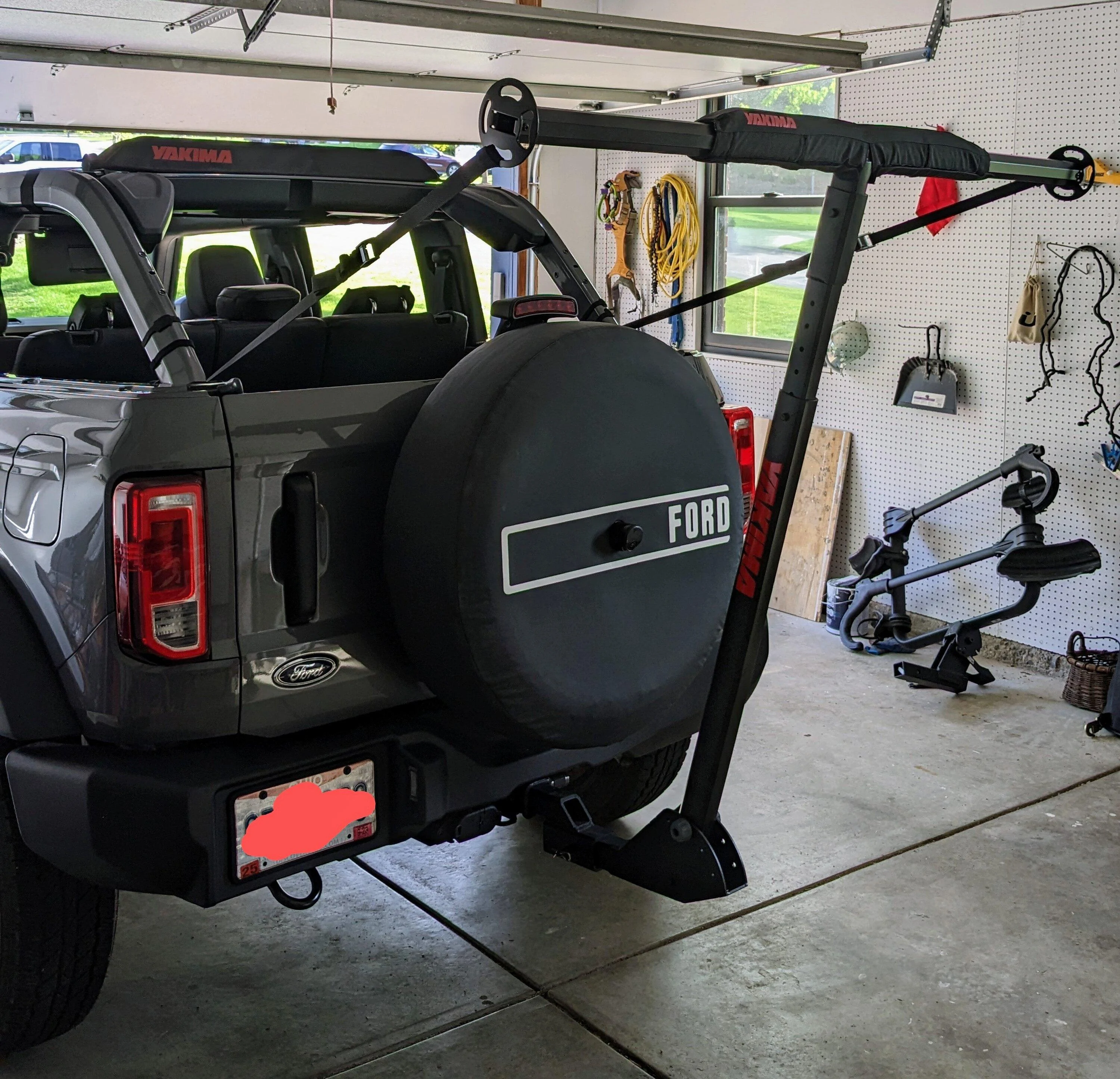

Based on your kayak set-up, I don't see how the antenna was in your way.
Black_Stallion13
Black_Stallion13
Dec 20, 2021
455
556
Cincinnati
Tacoma
The antenna is mounted on top of the rollbar from the factory so there is a big bump right in the middle of where the front kayak/rack pad in the pic below goes which inhibits everything from sitting nice and flat.
