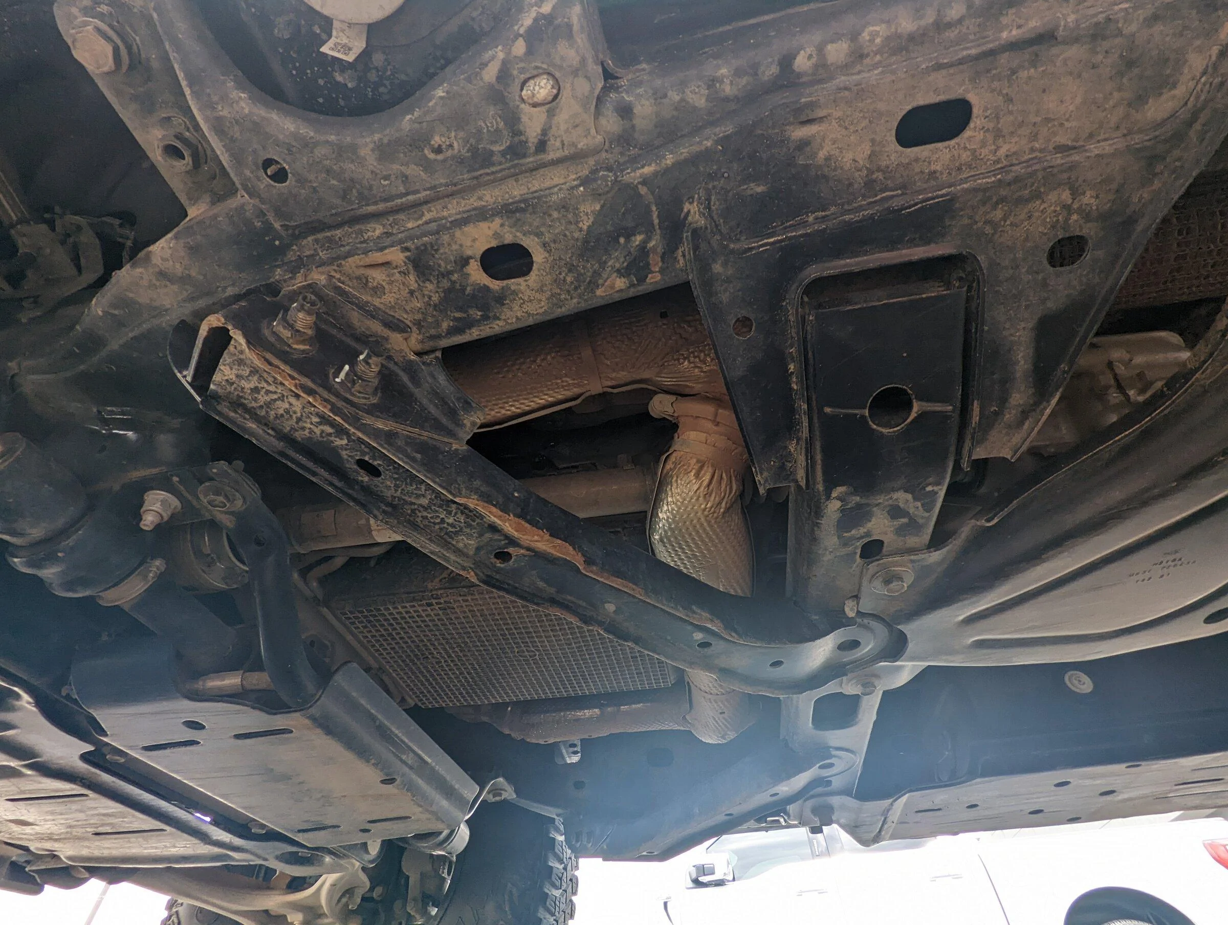

This is the damage I'm trying to limit btw. Oh and ignore the dirt, haven't figured out a way to clean under it yet :)
You can just cut them off, my bronco didn't even come with those bars. Looks like they are part of the factory off-road protection. Going to be interesting if these companies take those cross bars into the design between different trims
They only come on the 2.7L. Maybe the engineers thought the frame needed strengthening with all that power!

oh damn, I had no idea those braces weren't on all the Bronco's. I'm not as worried about abusing them then. Seems like you could cut them out and just get some flat metal skid there.
Actually looks like it wouldn't be to hard to do, you could weld straight to the braces as they un-bolt with the cross member.
Honestly man, these don’t look very damaged at all. It looks like they are doing exactly what they are designed to do… and I’d bet will be way cheaper to replace than an aftermarket skid plate will be, if you do get them really mashed up. Maybe a little rustoleum to make you feel better about their condition? I’d honestly just leave them as-is

Yea honestly once I realized they aren't even on other trims I'm way less worried about bashing them up. A skid would prob help with not getting hung up on stuff though.
