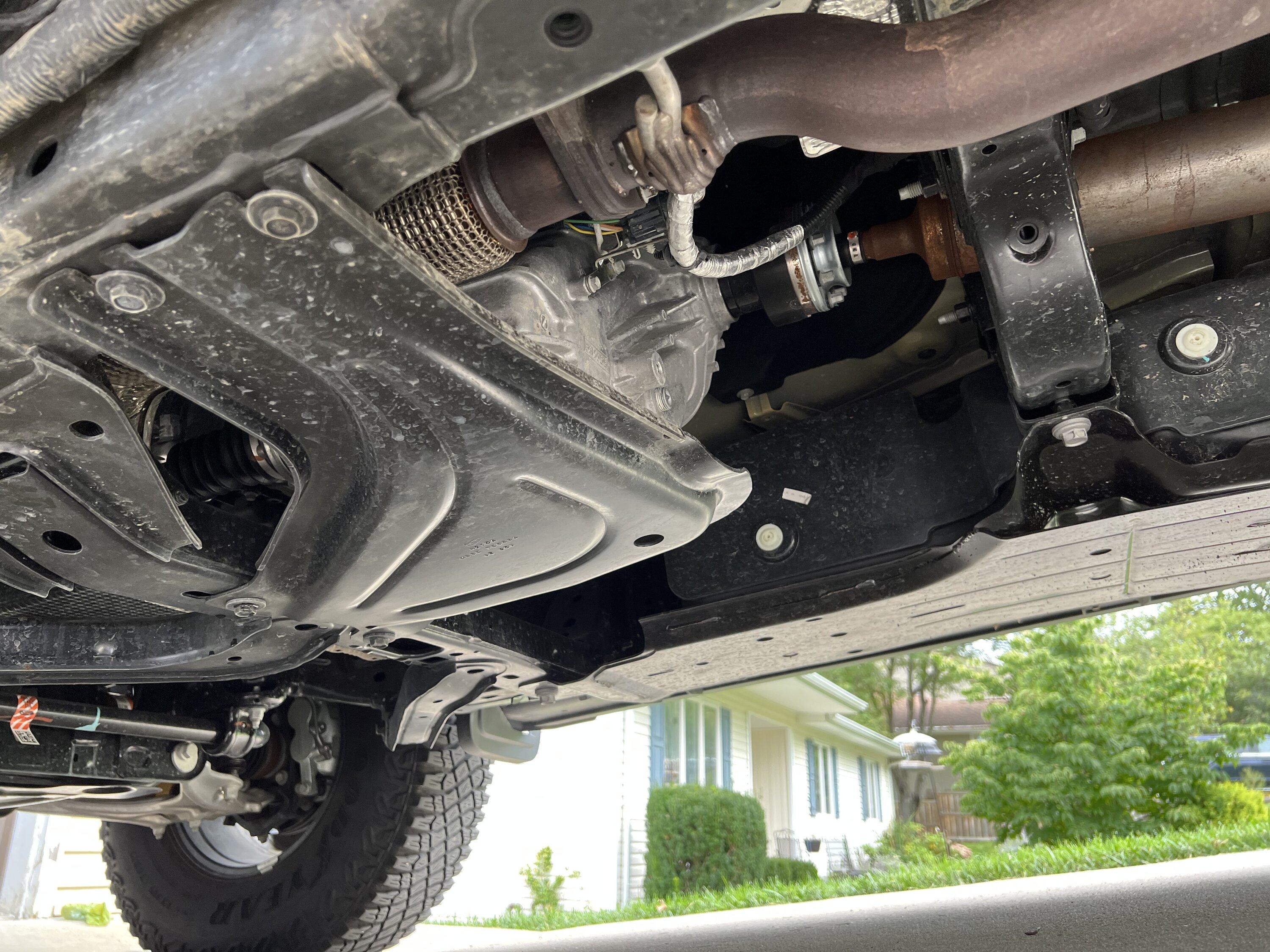

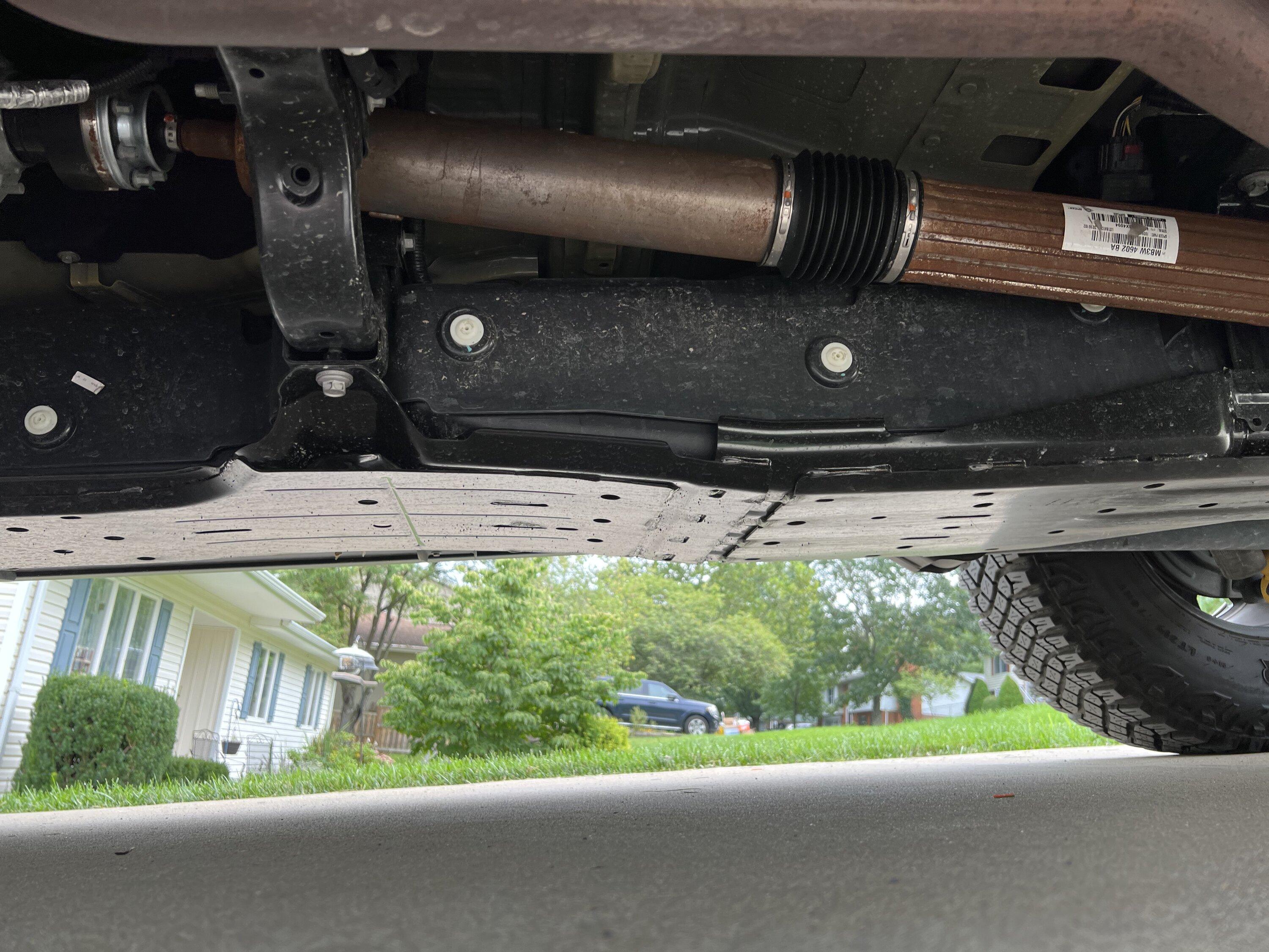

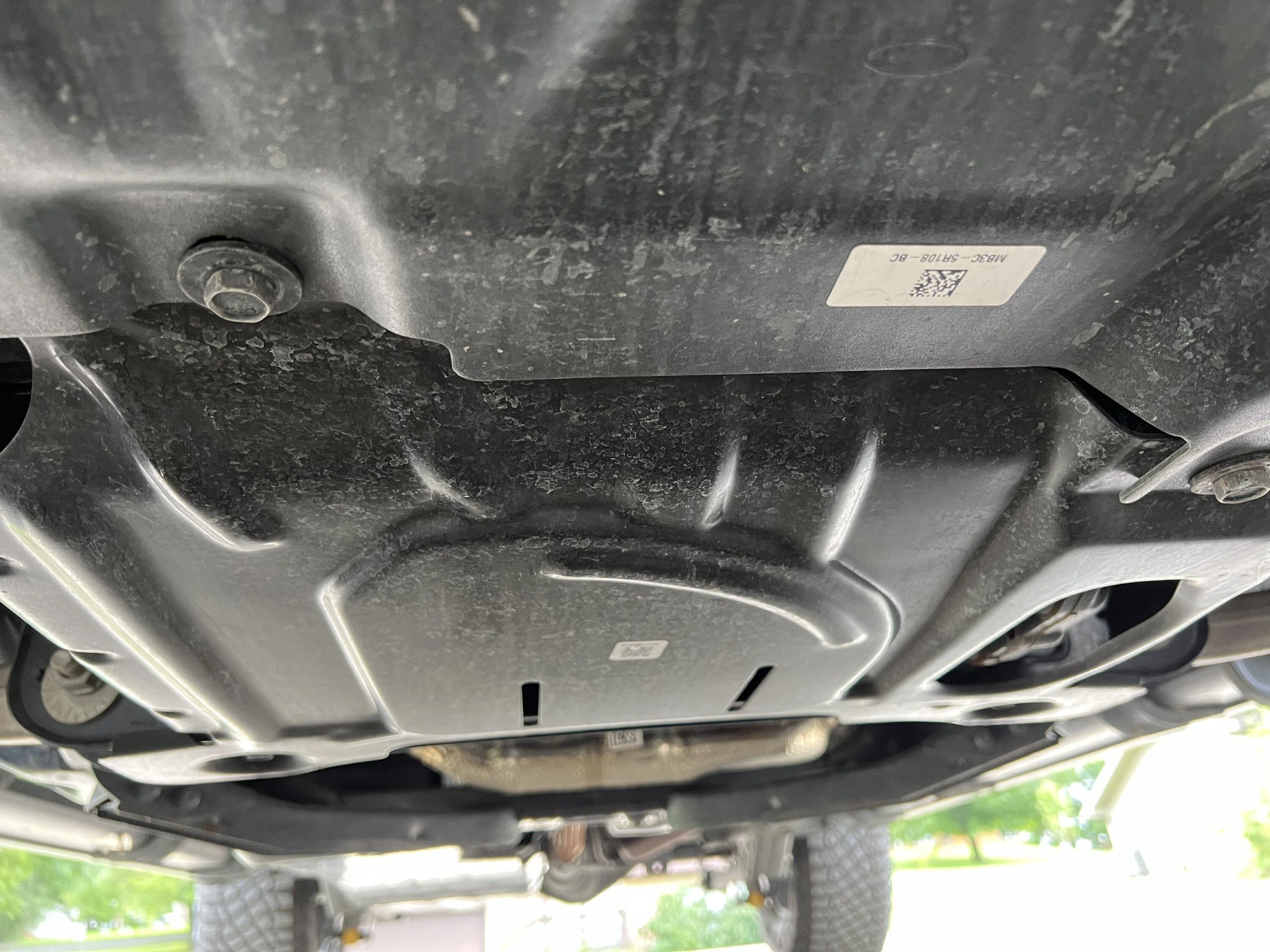

I do have mod bumper and steel front skid. So sounds like I’m missing transfer case and gas tank. Does BL have cover over catalytic converter? People have been cutting out catalytic converters and drilling gas tanks to steal gas! They didn’t offer full skid or disconnect as an option.

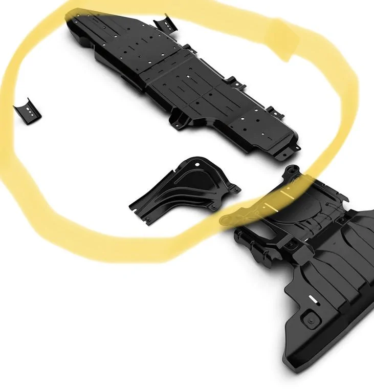

look’s like missing what’s in circle?

You are right, everything in the circle is missing on the OB with modular bumper.
